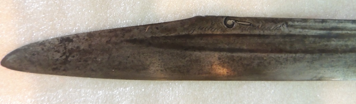

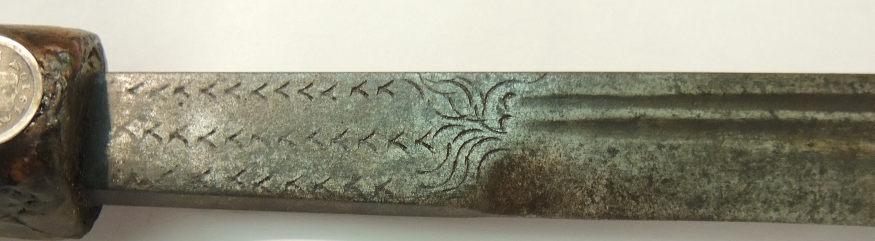

With fullers on both side of the blade, this is not a mandau...
Are both sides of the blade tapering towards the cutting edge alike?

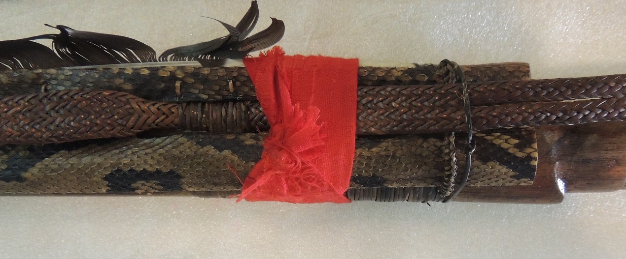

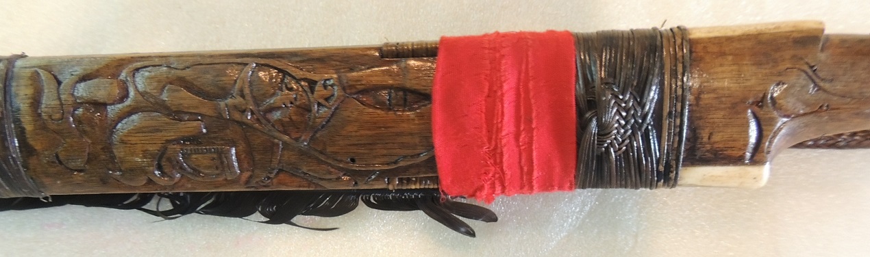

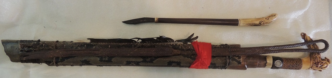

Here is the backside of the scabbard and close-up of the carvings.
The scabbard is varnished and it has bone decorations. Maybe it the original one, maybe not.

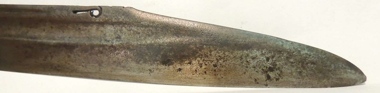

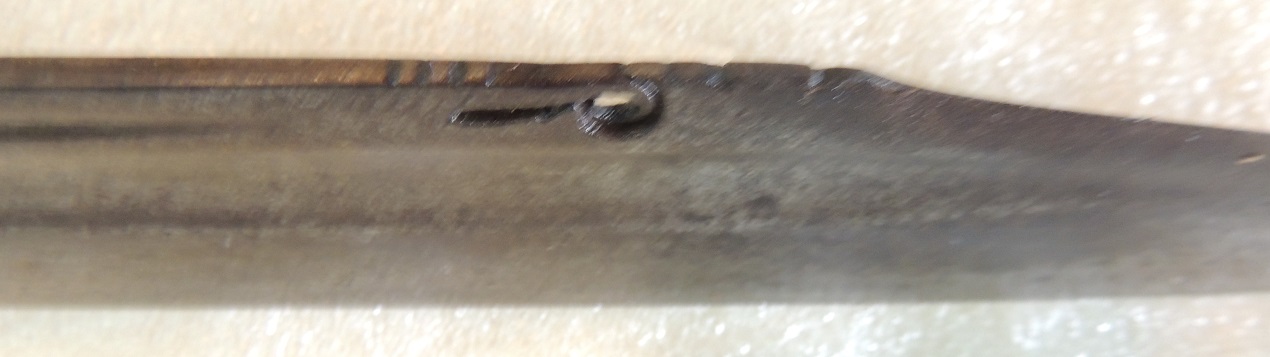

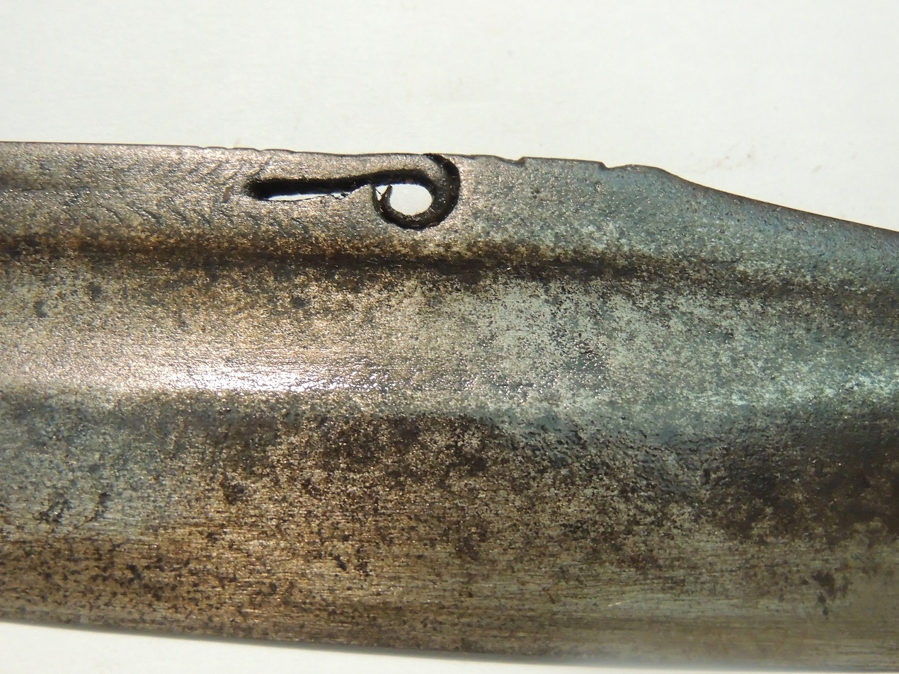

Here are some close-ups of the blade. The blade has modest decorations.
The blade has 2 fullers from each side, which is quite unusual.

Sorry, I'm not convinced this is an old style mandau, and probably more recent....

The reptile skin pouch is IMHO a very recent addition - that would not hold up well in a humid environment...
OTOH, the rattan belt is of very good quality and probably much older.
Probably assembled from different pieces?

Blade looks very old / pre 1900 possibly
Coins are dated, but are set in very recent resin.

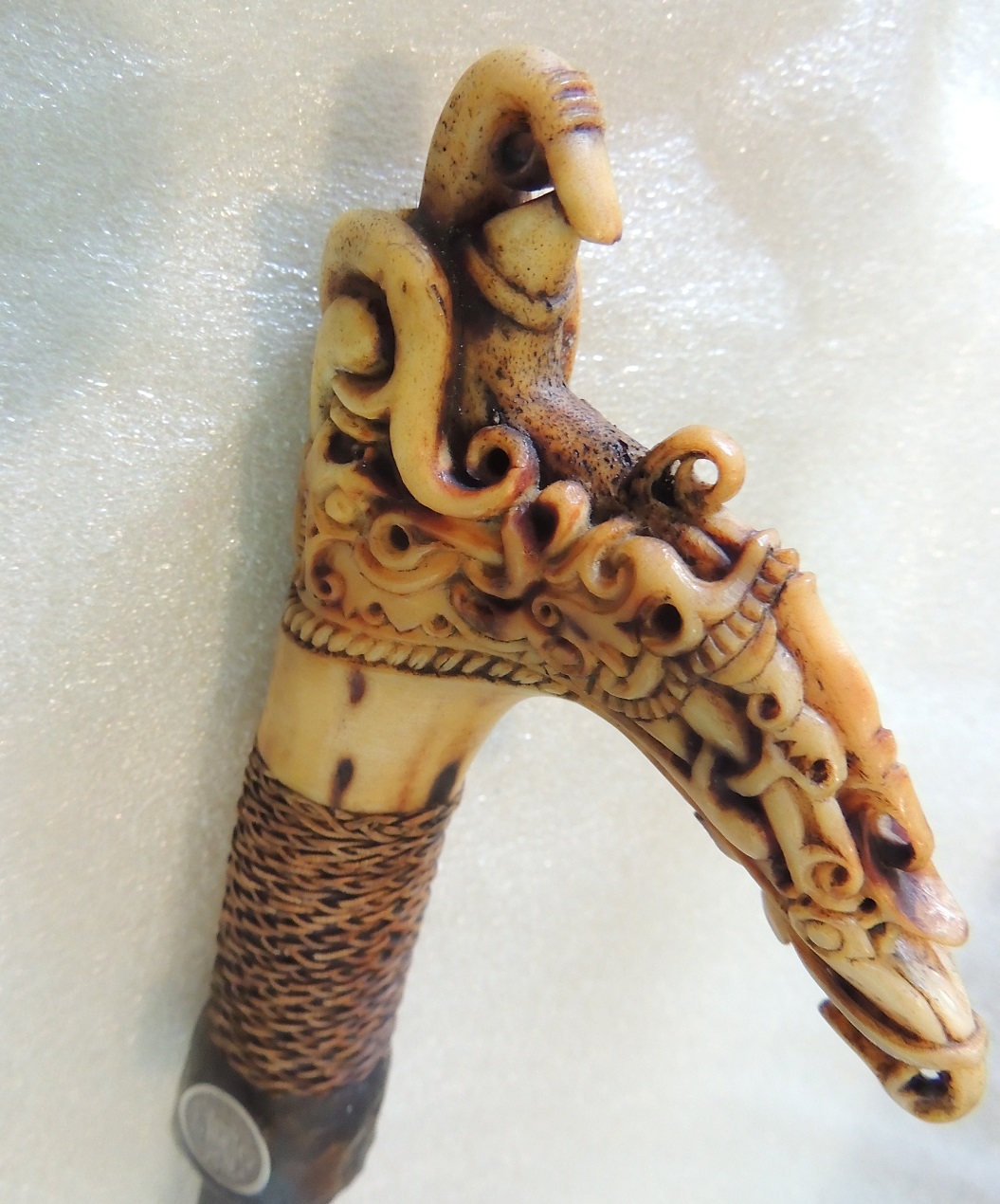

Handle is well carved, maybe it is old, but maybe of later date, might be upto late 20th century and made by a carver who still had the skills.

snake skin side scabbard. very recent and unusual material.
All together a very nice mandau. restored and completed in situ.

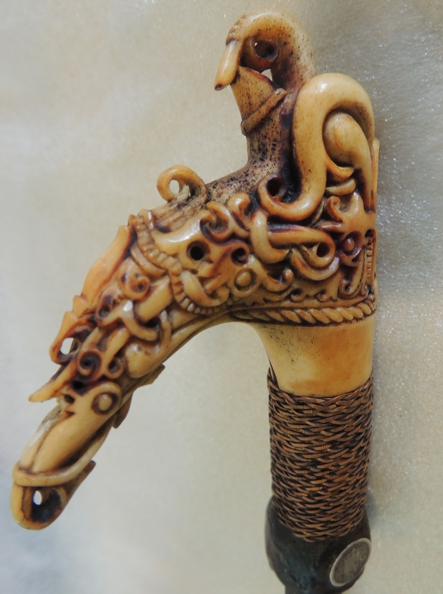

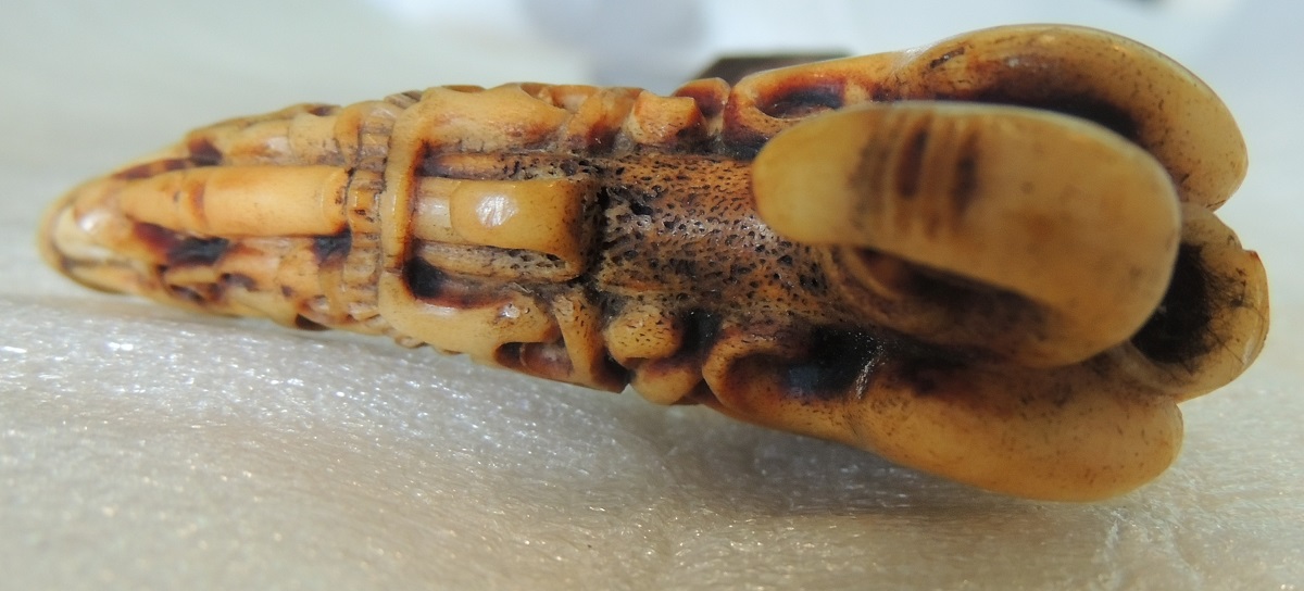

Here are some close-ups of the hilt.

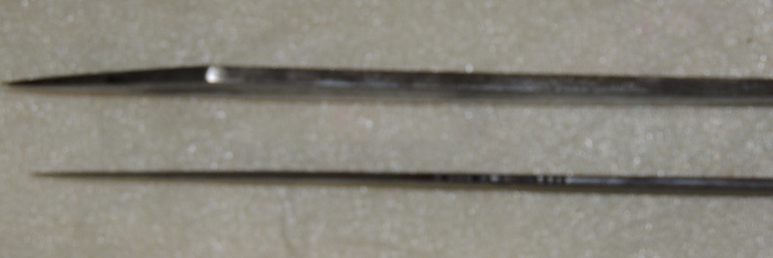

The last photo is a comparison between the blades of Sumba parang, up and mandau, bellow.

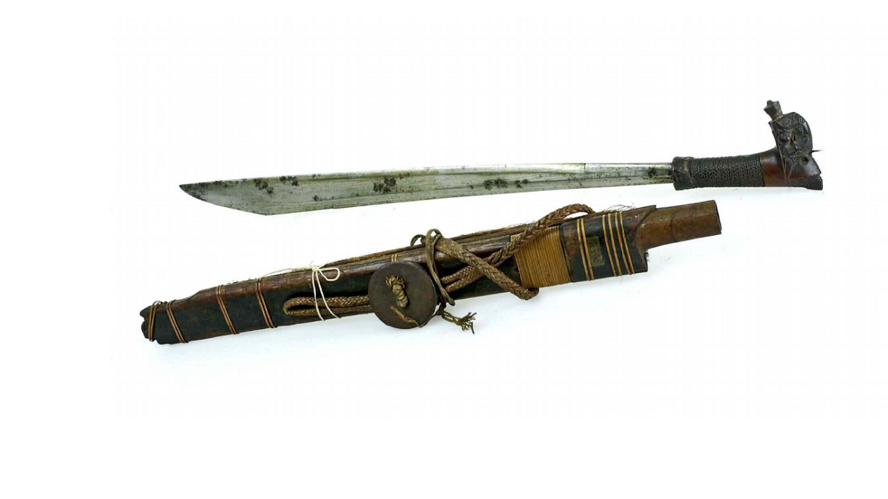

Posts: 18
Another mandau with fuller from Troppenmuseum:
Culture :*Dayak
Origin:*Southeast Asia: Insular*/*Indonesia*/*Kalimantan
before 1887*
approximately 67.5 x 5cm (26 9/16 x 1 15 / 16in.)*
Object number:*TM-A-2985*
Creditline:*Royal*Zoölogisch*Genootschap Natura Artis Magistra*
Medium:*Processing of animal and human materials*
resin*
wood*
iron*
rattan*
forging ( metal forming)*
cutting*
centurion is offline   Reply With Quote

The kabeala blade looks well preserved and does not seem to exhibit much distal taper while the Dayak blade tapers and probably lost quite a bit of substance to age.

The blade certainly is unusual which makes evaluation difficult. I get the impression that it is heavily worn and, thus, of decent age: The engraved decor is unusual - the somewhat rough craftsmanship may point to a local production. The decor at the tip is heavily worn which supports considerable age rather than late production IMHO.

scabbard carving style and quality looks old.
The varnish does result in an odd glossy look and appearance of more recent origin.
Can the carving style be attributed to any specific region?
Also the red fabric, of course.
I like the red fabric.
Really makes me think it was refurbisched for local use.

This should be Ngaju Kayan. Similar hilt is mentioned in the Quer Durch Borneo book as from Mahakam area, Long-Glat, located on Kayan river, photo enclosed.

Python skin should be a recent addition, as I saw details like these on new mandaus.

The TM example seems to be a real mandau. Also Iban mandau often show a narrow fuller like your upper one on the convex side of the blade; (right-handed) mandau have a (left) concave side and a (right) convex side - basically the blade profile is a bit shaped like a spoon. Yours has a symmetrical profile on both sides though.
There are blades basically resembling a mandau but with symmetrical profile/edge all over Borneo: in northern Borneo these would probably be referred to as gayang, in some Iban areas possibly as tilan(g) kamerau/kameran (cp. this thread for a discussion on the uncertainties!), and in the SE maybe as parang Negara. Thus, there are huge areas with pretty much undocumented terminology which may not only change from ethnic (sub)group to the next but possibly even from village to village. So it's probably best not to place too much importance on the "name game"...
Of course, there are also variant names for typical mandau blades. Arguably, these may be functionally closer while the symmetrical blades may show somewhat more diversity. OTOH, maybe the symmetrical blades are just remnants of older traditions while the asymmetrical blades could represent a somewhat younger development/fashion.

Unfortunately, catalog in Tropenmuseum has only one photo per item, so we cannot see the other side, and half of the mandaus are depicted with blades in the scabbards, and we cannot see the blades at all.
