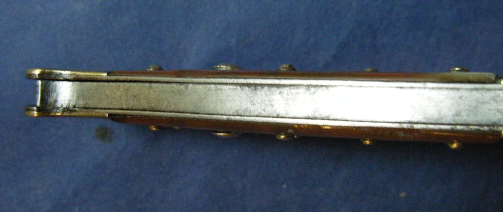

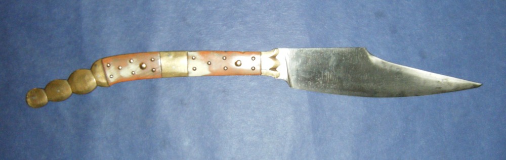

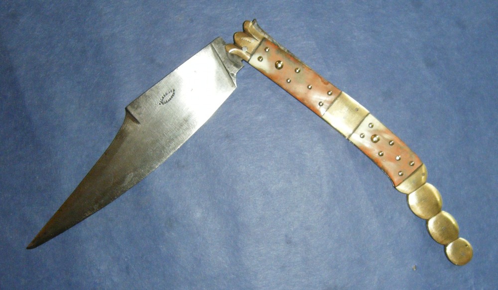

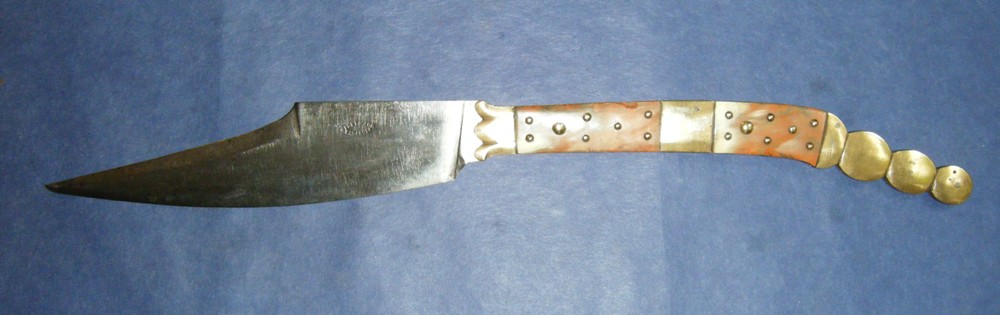

Hello dear members,
I've bought my first navaja but my knowledge about this knives is very rudimentary and I hope that I get some answers to my questions from more knowledgeable members.
So far I know are this sort of navajas associated with France but this one is stamped clearly with Zaragoza which is in the North of Spain. The other inscription I can't read.

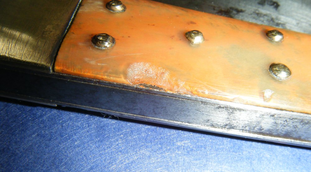

My questions: Is it a Spain navaja? How old is it? What is the scales material? Could it be celluloid?
The knife is opened 40,5 cm long, closed it is 22,3 cm, blade 19,5 cm and 4,5 mm thick at the base. Weight is 247 gram.
Thank you in advance for all comments!

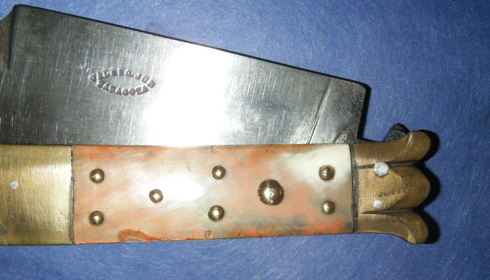

carlos
Posts: 751
The blade is engraved Jun Valero, in some spanish forums says that valero imports this types of navajas from Thiers, France, to the spanish market.

Location: Australia
Posts: 685
As Carlos said, the current informed consensus is that they were made in France and distributed in Spain by Valero Jun. I am inclined to believe that this was indeed the case.

Thank you Chris!
So it's a "Spanish" navaja in French style. Or a French navaja worked for the Spanish market.
Age early 20th century? Handle scales from celluloid?
Thank you for sharing your knowledge!

Location: Australia
Posts: 685
Originally Posted by Sajen
Thank you Chris!
Hard to say how widely these knives were distributed, but I very much doubt if they were made exclusively for the Spanish market as their general shape and style was not "Spanish" at all. The French did produce knives similar in style to the ones that were made by Spanish cutlers at the time, but these are numerically in the minority.
This knife was made, according to Forton and other sources, late in the 19th century. The handle scales were usually bone.
I'll add that Forton's books are the definitive resource on these knives and no other extant work even remotely approaches their content. Unfortunately they remain untranslated.

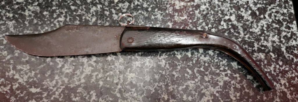

Old 18th December 2018, 09:11 PM   #17
cookyboy1
Join Date: Jul 2017
Posts: 7
Default Navaja
Love your navaga ,I don't know much about these knives so if you and other members can help identify this one I have I would be very greatfull.
