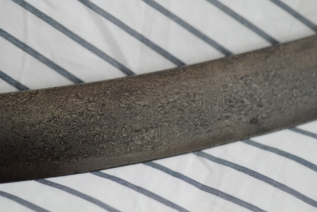

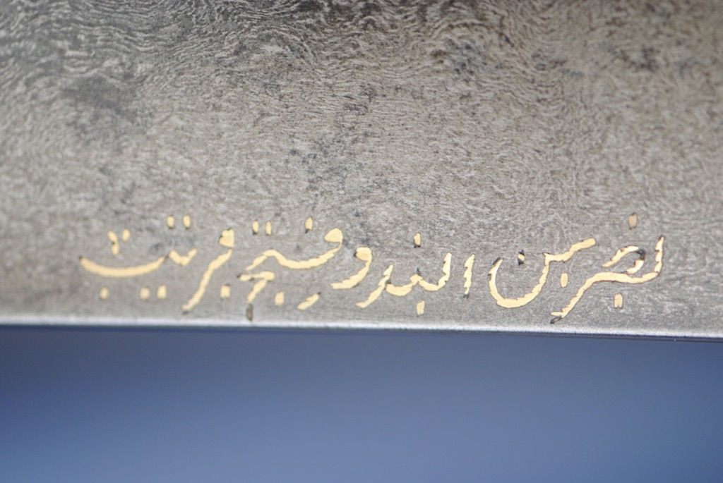

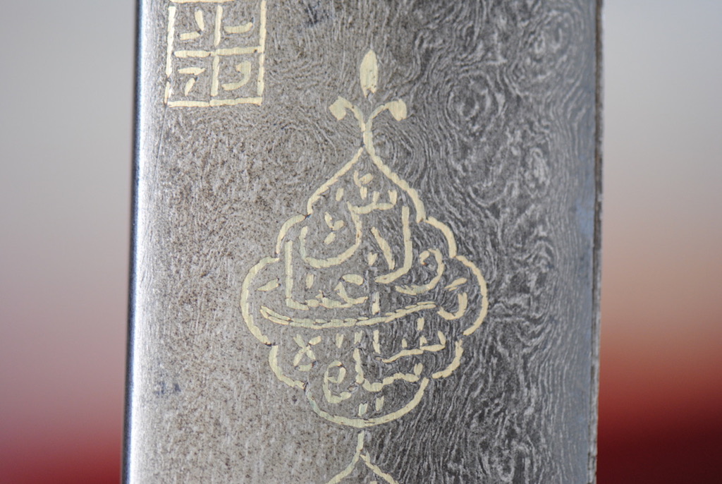

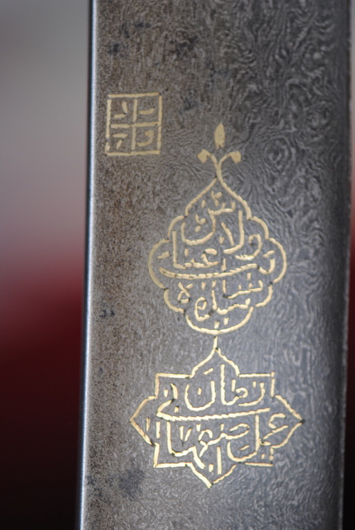

Please see attached some close up photos I have taken of the calligraphy on a Persian sword that I own.
I was wondering if anyone can help with the translation of the various parts of this calligraphy.
Many thanks for any help.
Will

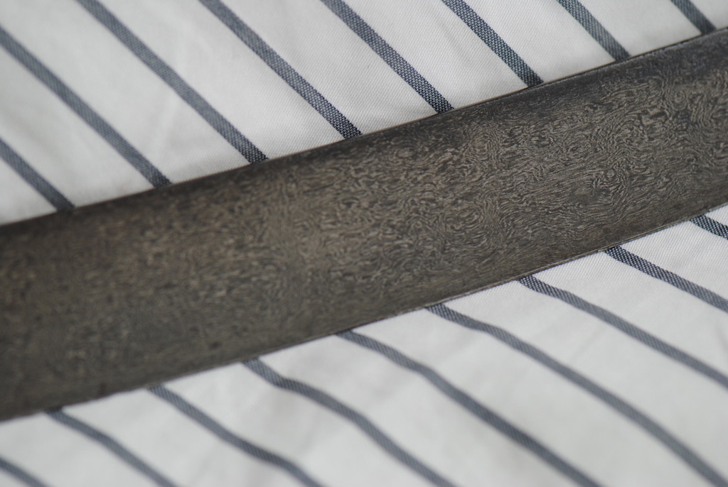

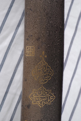

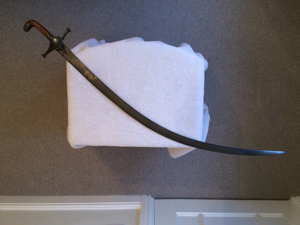

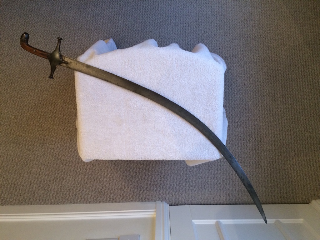

I have uploaded obverse and reverse of the sword, and also some close ups running along the blade.
The cross guard is also made of crucible steel, but there is the faint trace of a gilded pattern on it.

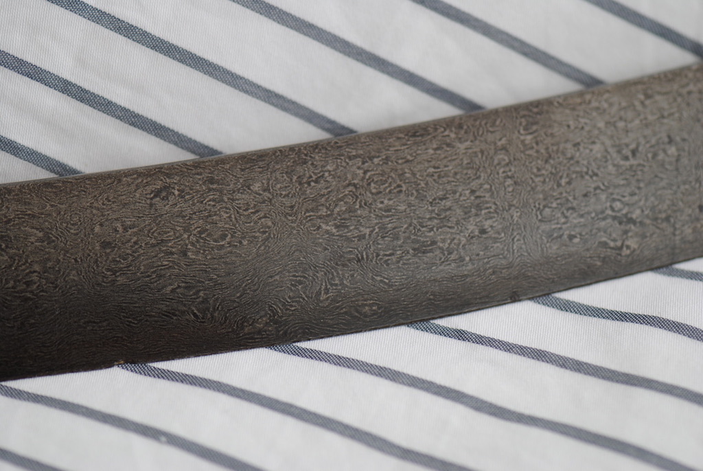

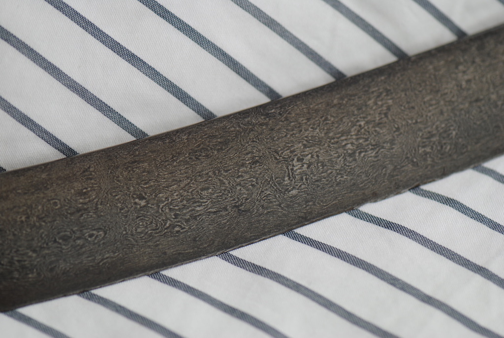

That is a Shamshiir and is expertly done in a dominant ladder pattern. I will have my interpreter have a look at the script although it is bound to be one of the standard famous artisan style inscriptions even though to me what is just as important is the magic square treatment ...Talismanic and great to see on this blade.

Some points on the Translation. As with many translation puzzles I always try to get a couple of translators to have a go at these cartouches and inlays... They are so interesting.
Firstly I have broken it down as the more difficult are in the cartouch but the lower one appears to give the makers name The Work of etc... I will try to have that done in due course...…Whereas there is Persian in the cartouche the long line of work below is from the Holy Koran and is in this case Arabic.
On the longer line of Arabic script I give an example phonetically as nasrun min allah wa fathun qareeb which means essentially ..With Gods help we will win this battle. I think that is a reasonable line of writing to have on a blade...

Dear Ibrahiim,
Thank you for taking the time to help me with this, I am indebted to you.
So the Arabic script running along the blade says: "With Gods help we will win this battle."
The upper cartouche and lower cartouche look slightly more complex, but I await with great anticipation the views of your translator friends.
The talismanic square I find fascinating. At first I thought this was a date of some kind, but am now intrigued that it has a far more cryptic and spiritual meaning.

There is no Abu. It say Amal e Zamaan e Isfahani. the other seal says Banda e Shah e Welaayat , Abbas. please search my other posts in this regard, as I need to get back to studying, good looking sword by the way.

According to local lore, Zaman Isfaghani was Assadulla’s pupil.
