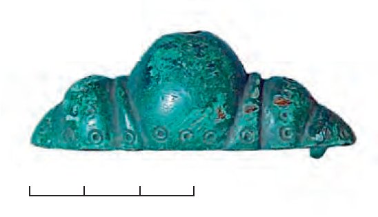

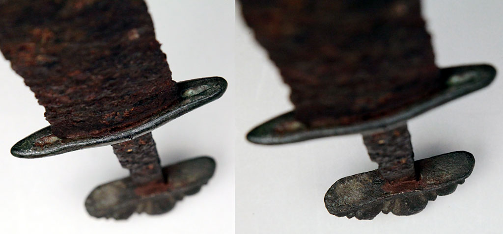

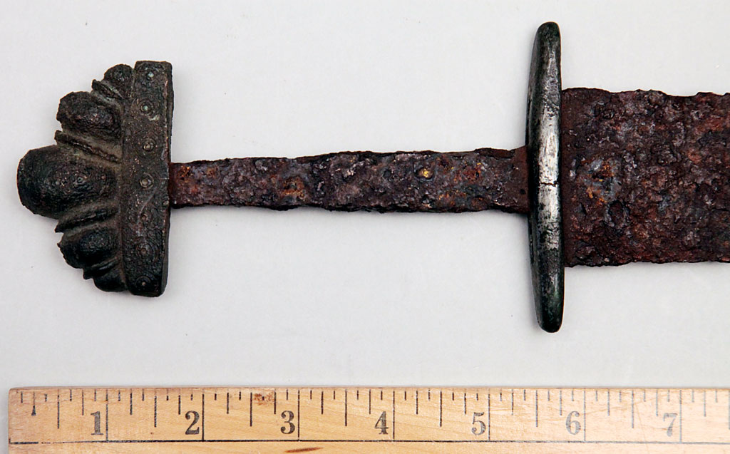

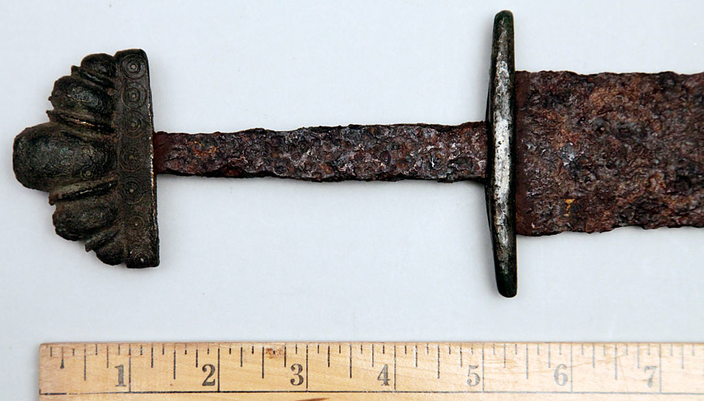

It is always frustrating to find a sword that does not fit into the classification schemes that one knows and this is one of those swords. The fairly heavily encrusted double edged blade does not appear to have a fuller and the encrustation prevents detection of pattern-welding, if it is there.
Overall length is about 32ľ inches and the blade measures 27Ľ inches in length. The pommel and upper guard appear to be a single casting of bronze and the end of the tang is exposed at the tip of the middle lobe. Dot within circle within larger circle 'raindrops' decorate the pommel. The non-matching slender guard appears to be made of silvered bronze.
There does appear to be some genuine age here, so I do not believe this to be a modern fantasy. The theme of lobed pommels started well before the Viking Age and this hilt does not fall into the expected Viking types. The theme of 'raindrops' may be seen in many cultures and times, and one of those is the Migration Period in central Europe which is what I am thinking about the origin of this sword.
Your knowledge and comments are invited.

Mark,
I find your attribution most compelling! Thank you! Though not included with my photos, the aperture for the tang at the top of the pommel is very similar to that in the second photo that you have shown, though perhaps a little bit smaller and this upper hilt does appear to be solid. Also the dominant bulbous central lobe as seen in all of your photos is often associated with an eastern European origin in the Viking Age, so why not in closely following times?

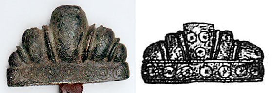

In your last image, the similarity between the sword presented in this thread and #6 was striking (and searching the place name gave me only one hit: original paper Artūrs Tomsons: Ornamentation on the Hilts of Couronian (T1) Swords from the 11th-13th Century).
I have generated a side by side comparison of the pommels, brightening the image so that at least one 'raindrop' is evident on that central lobe as well. The cross guard still remains a mystery as the cross guards shown in the cited paper are more robust and consistent with the upper guards.

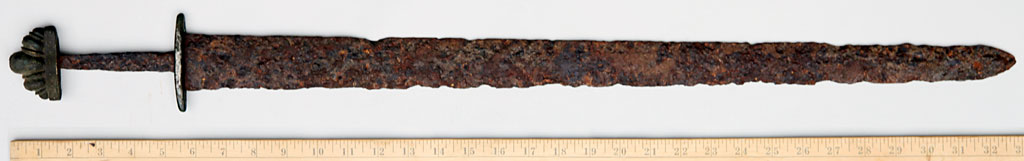

So, off I went searching for 'Couronian sword' and I found a picture of this very hilt featured on the Hurstwic site; following that clue and having to rely on Google's cache of an old SFI thread from 2008, there is someone looking for information on this sword. I am assuming that Arthur Thomson from Riga, Latvia is the author of the paper above and he was looking for more information on the sword being considered here. He remarked 'To my mind it seems that it can be of Eastern Baltic origin and can be dated approximately to 11.-12. centuries. I am writing an article about Couronian swords and any info could be useful!'

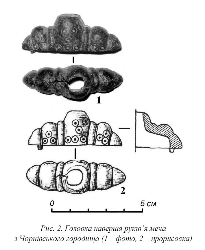

Salaams Lee, I commend this webpage to Forum https://www.tf.uni-kiel.de/matwis/am...tr/ib_4_2.html and have copied in the ancient artwork as below ~ The bulk of webpage content is at reference and is essential reading.

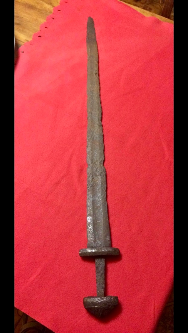

Viking Baltic sword ! Usual type . Nice example ! Quite different from Nordic exemplar ! Here one from my collection .
Old 21st November 2018, 09:01 PM   #12
BerberDagger
BerberDagger's Avatar
Join Date: Jan 2007
Posts: 247
Default Pics
Here pics sorry

Drool - a very nice classic of Nordic type, type H I presume. Is there inlay or pattern-welding of the blade or covering decoration on the hilt?
