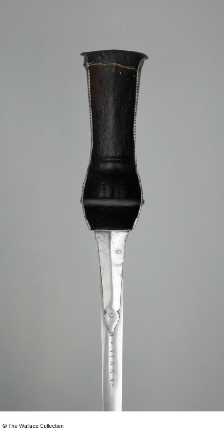

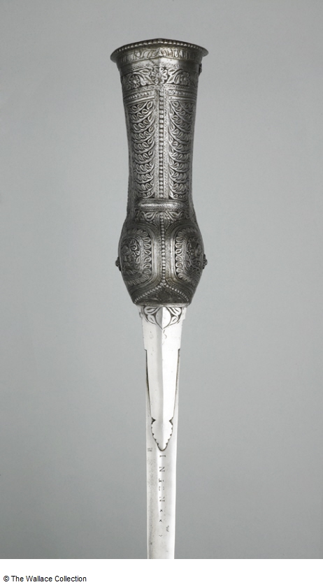

First an interesting look at the choreography of fighting with two Dandpata at the same time; please see https://www.youtube.com/watch?v=qV25-ORDeUg and imagine being in the arena trying to fight this technique.
Secondly a look at http://wallacelive.wallacecollection...ype=detailView Abraham Stamm blade on a PATA; By the way PATA means paw in Portuguese) ; The blade clearly marked with Stamm on one blade surface and Solingen on the reverse. Stamm was active between 1700 and 1729.
Finally, Please note ; Another Stamm appears at http://www.vikingsword.com/vb/showth...ighlight=stamm . Quite usually his blade stamp is two; STAMM STAMM. That may also be the case at the bolster at the throat concealing the full inscription at para 2 above..

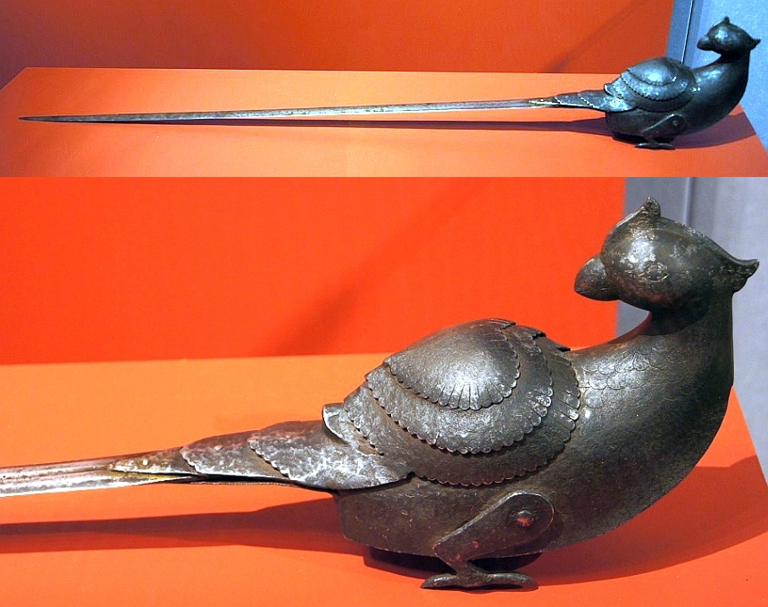

I have never seen birds on these weapons before..

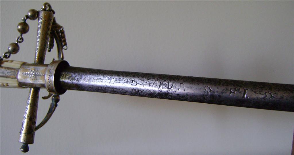

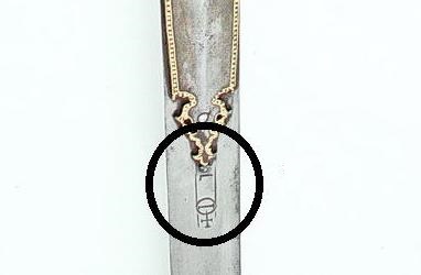

Fernando,
I am really not sure, as it looks as if on the blade, just under the langet, there is an 'L' - see your detail picture of the blade, post 27. So maybe there is an inscrpition under the langet.
Jens

While this question was from some time back, isnt this pata Fernando is referring to looks like a dramatically cut down European blade and the 'L' is likely the last letter of the name on the blade. The cross and orb device was usually used in a motif fashion to close a phrase or wording or in cases a name. Looks 17th c.

Jens, if i was an imaginative person, and based on the blade being European, i would venture that the "L" is the last letter of Portugal. And this should take me to ask you if there isn't also a letter emerging from the langet on the other side .

Yes Jim, a name could be hidden behind the langet - but we will never find out, as I am not going to take it apart - thempting, but no.
Ok Fernando, I have hakan a pictire of the other side, here it is. It looks as if there is an 'E' just under the langet.

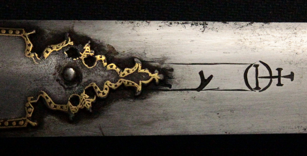

Thank you Jens for the great image on this. In seeing these up close it appears these lines, the cross and orb and whatever those letters are have been drawn or inscribed into a kind of simulated fuller. That last letter looks like a lazy 'Y'.
To me this suggests probably an Indian made blade estimating the markings often seen on European ones. The character of the globe and cross is very artistic compared to the European ones, and it seems usually not used as a terminus like this, but appears on its own. I do know of some cases where it does occur like this but usually it is an anchor in this place.

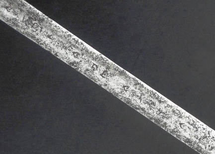

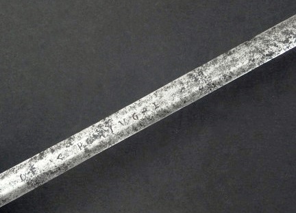

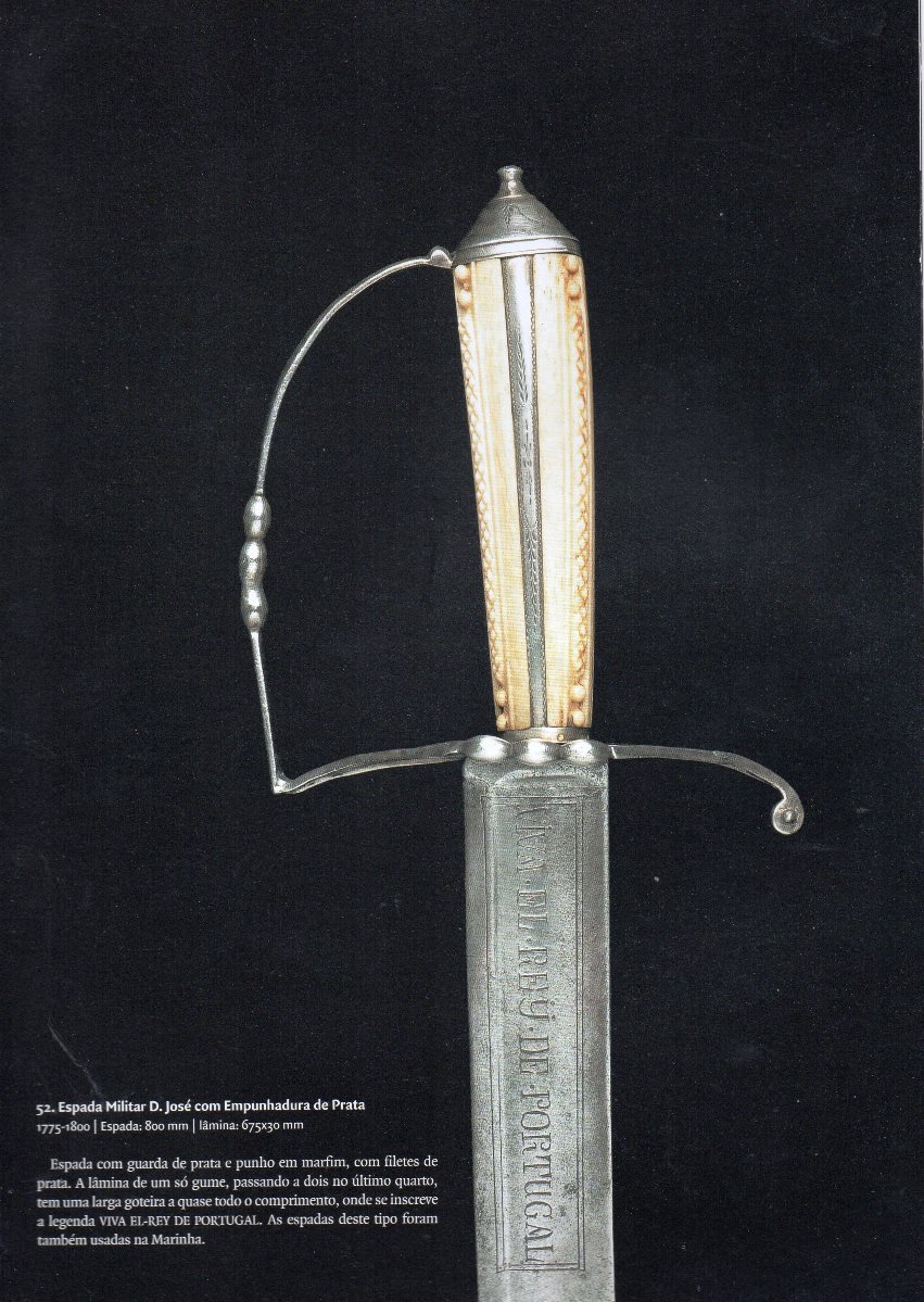

... Ok Fernando, I have hakan a pictire of the other side, here it is. It looks as if there is an 'E' just under the langet.
VIVA EL REY
DE PORTUGAL

As you put it Jens, this is a maybe .

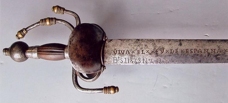

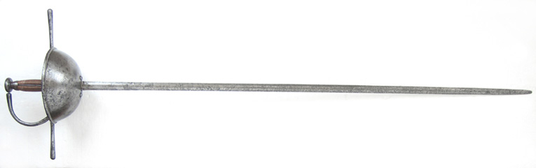

Here is a 'bad' example of sword for the case, just to show you the clear text.This sword is from the XVIII century, whereas this type of inscription must have started to appear by the second half XVII century (or post-1640), as a patriotic acclaim during the restoration of the independence.
The inscription 'good' format is in the second set of pictures, where in a cup hilted sword/rapier of my little collection you may (hardly) discern the faded inscription divided one half in each side of the blade.

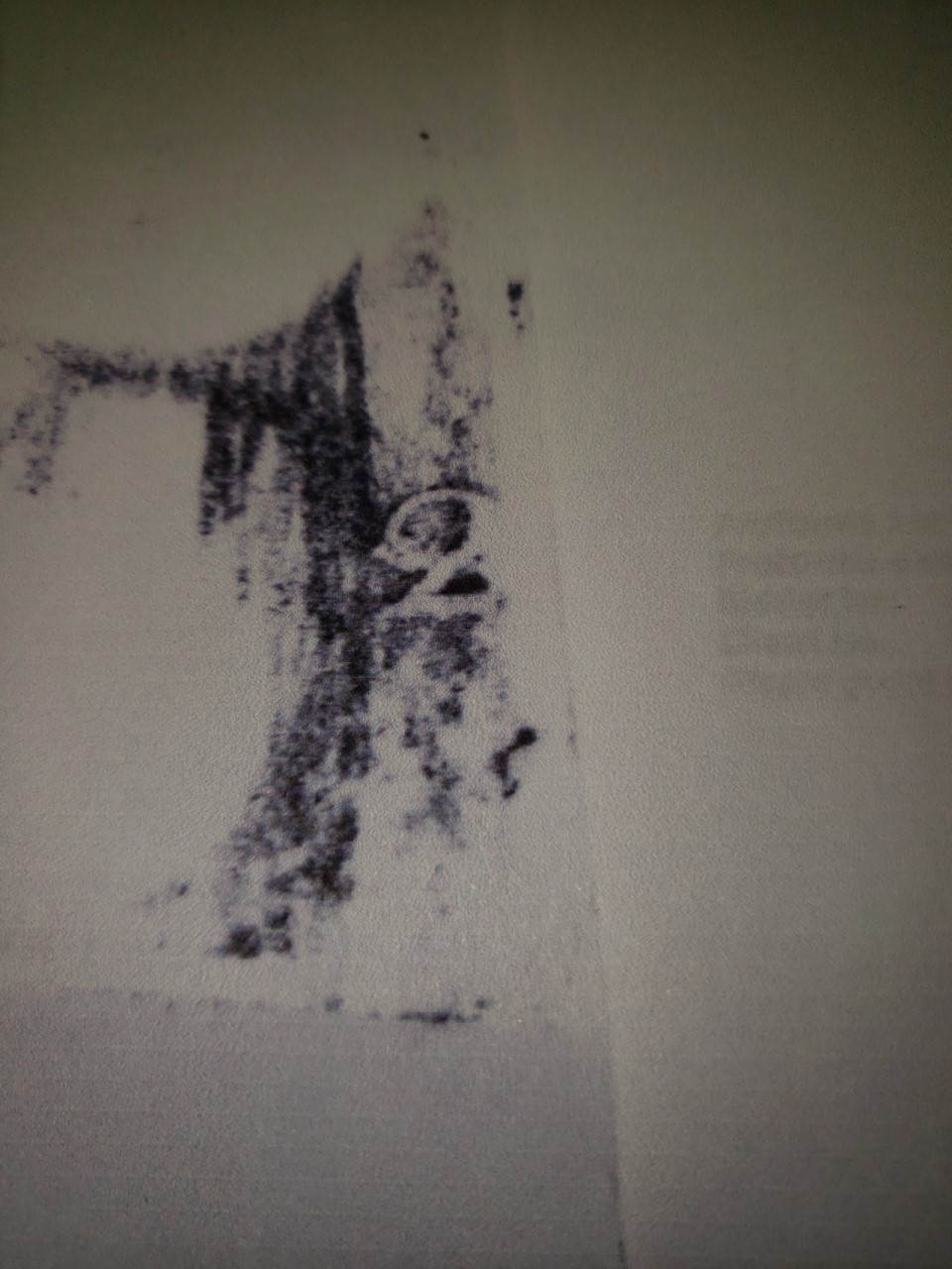

im not sure you have enough space ,I used white paper with carbon paper and got impression of number 2 under langet

Having looked at the blade once more, I still think it is an Indian copy of a blade from Portugal
It is interesting to notice that a lot of the blades looking European were in fact made in India.
I very much agree with Jens. The 'globus cruciger" (globe and cross) seems 'artistically' applied in a rendering of that typically seen on German made blades, and probably what can be seen of a notable inscription theme on Portuguese swords. As the Portuguese were key in the post contact trade in India from 16th c. the numbers of blades extant must have been significant and ready subject matter to be copied by skilled Indian smiths. In later situations many of the blades were Solingen made though with the same themes.

I would not mind subscribing your thoughts, Jens. That "Y" looks like a bit of a fantasy ... not to speak of that sort of "cross and orb" symbol approach.

Actually the concerns over whether this blade is European...….and by the presumed inscription being Portuguese or Spanish seem entirely moot at this point, as has been well pointed out......the blades of both were typically by this period made in Solingen.
The apparent consensus is that the presumed inscription (artfully applied) is most likely on a blade made in India and that it is probably in imitation of something seen often on earlier European blades. As Portugal had presence in India primarily in western littoral in many locations since early 16th c. (known collectively as Goa)….it seems most probable that a Portuguese inscription might be the model for such inscription.
While the cross and orb is most commonly known on German made blades, we can presume that the model being copied is from a German blade.
While possible of course that a Spanish blade might have been at hand....the Spanish had no presence in India directly ….the Portuguese did ….in Southern India …...the regions where the pata prevailed.
As far as radiological examination of the inscription, one of the only enactors of that process that comes to mind is Dr. Cyril Mazansky (author of " British Basket Hilt Swords") who wrote an article on the x-ray examination of a basket hilt sword off a shipwreck in the Caribbean. Other than that the most usual application has been studying the metallurgical properties of blades in the study of wootz by Dr. Ann Fuerbach et al as far as I recall.
As noted , this requires profound connection to those with the very expensive equipment in use, and would be very expensive. As the dismantling of an historic and valuable sword would compromise its integrity in degree, this might be an alternative but with risk, expense and less than guaranteed results not worth it.
As we know the inscription is spurious, and that the blade is almost certainly not European.....I think it best to accept it for what it is....
a beautiful pata with Indian blade and artistically applied European inscription and motif.
