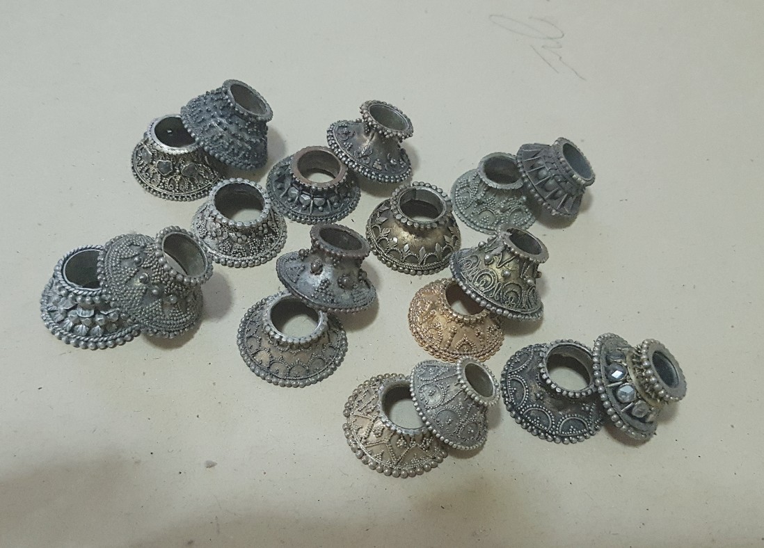

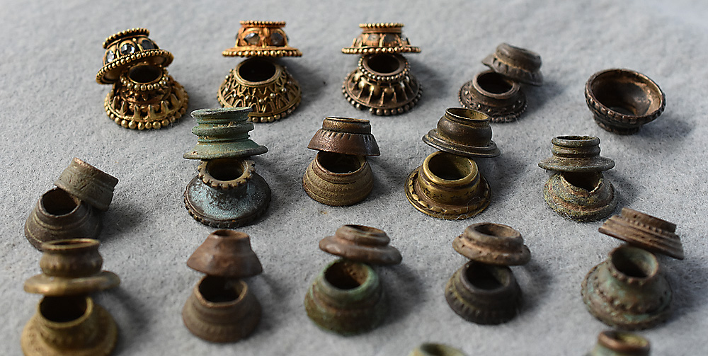

Hi,
They are some mendak that I think from East Java and Madura.
Joe

Originally Posted by Bejo
Hi,
Joe
Nice mendaks collection, thank you! It seems to me that some pieces may be from Central Java but not a big deal!

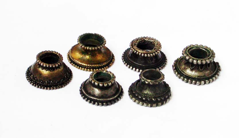

I agree Jean. Here are some mendaks that were presented here a while back as East Jawa.

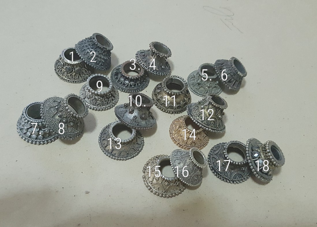

Hi,
If you don't mind, which of those mendak are maybe from Central Java? I upload the picture with numbers.
I still have confusion in determine mendak number 18. It looks like Jogja mendak, but I also feel like it is from East Java.
Thank you,
Joe

Old 2nd September 2018, 06:37 PM   #6
Posts: 7,218
Well, my understanding of traditional East Jawa mendaks is that that they are generally plainer and not usually bejeweled.
I could be wrong, but i would place #18 as Jogyakarta.
Of course, the bottom line for our friend Athanase here is that no one is really currently making East Madura style mendaks and antique ones will cost quite a bit so he will probably be best off settling for a more available style of Javanese mendak which will in the end still look much better that what is currently in place.

Joe, if you have access to the reference book "Keris Jawa" written by the late Haryono Haryoguritno, please have a look at pages 280 & 281 for viewing the various styles of mendaks from Central Java.

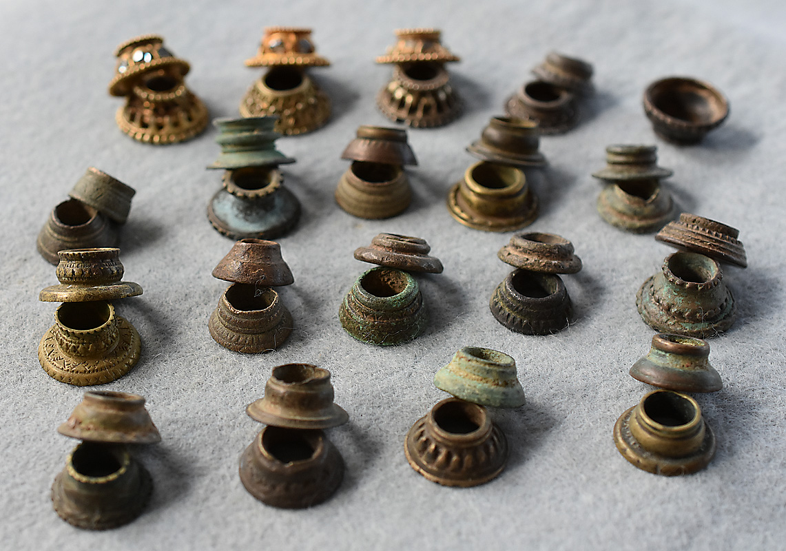

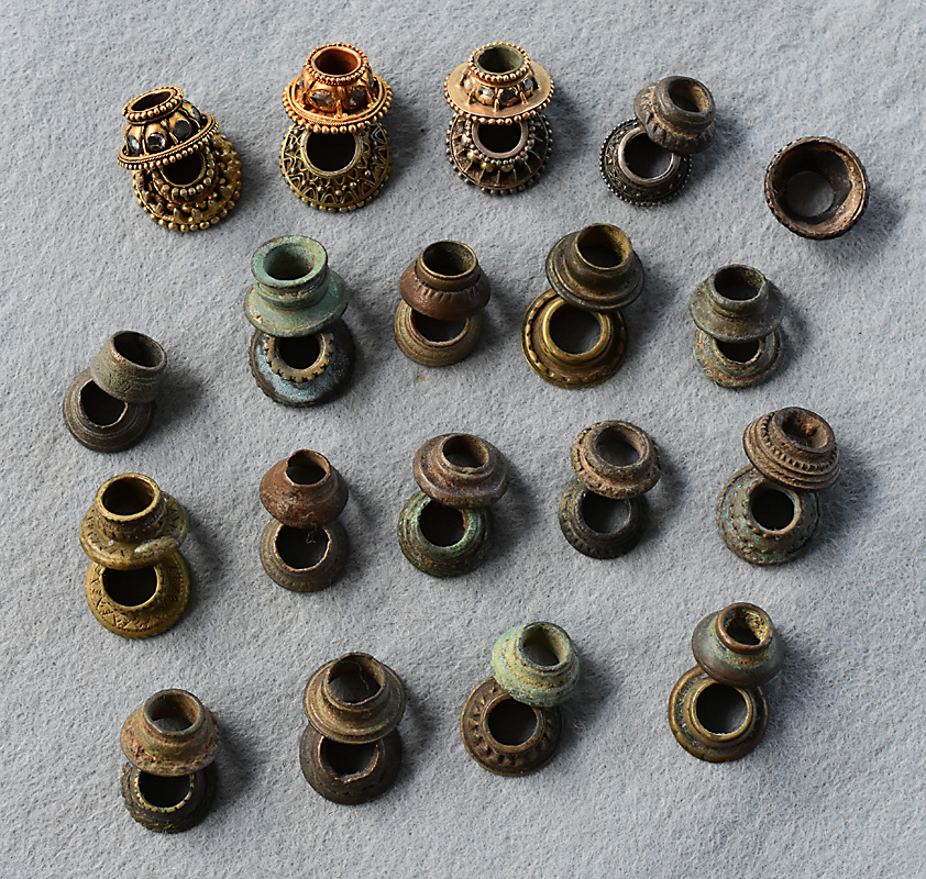

East Jawa/Madura mendak can look like Central Jawa mendak.
Central Jawa mendak can look like East Jawa/Madura mendak.
Solo mendak can look like Jogja mendak and vice versa.
Pesisiran mendak can look like anything at all.
Far East Jawa mendak --- like Blambangan --- can look like Bali wewer or incorporate elements of wewer design.
You need to look at the way a mendak is made to have a reasonable chance of guessing where it is from, for example, nearly all East Jawa/Madura mendak are made as a little cup, that is, no internal supporting construction. With mendak that have internal construction you need to ensure that they will fit the recess on the bottom of a hilt, or that where there is no recess, that the internal construction does not interfere with a neat seat onto the hilt base. Above all, you need to ensure that there is harmony of proportion and design, and that is not always easy.
Then, of course, we have solid cast or turned mendak, and they can be a real problem.
Personally, I have a bit of difficulty in looking at a picture of a mendak and saying it is one thing or the other, without qualification.
Here are some cast and turned mendak, some extremely old, some were excavated, and a few fine quality standard mendak for comparison.
