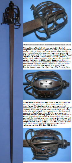

Here is the my Tunisian sword described by Teodor.It sports a British dragoon blade second half of 18 century.
Also shown the original British sword with a similar blade but in its original garb.
Thom Richardson in his book " Islamic Arms and Armour", p.70 based on the collection of Royal Armoury in Leeds defines Tunisian swords as " very rare"
Not for nothing one with intact crossguard but without a scabbard was sold at Czerny's for 1000 euros + 28% premium.
https://classic.liveauctioneers.com/...967484_a-sword

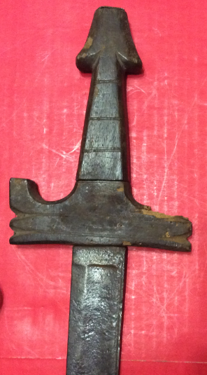

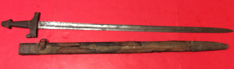

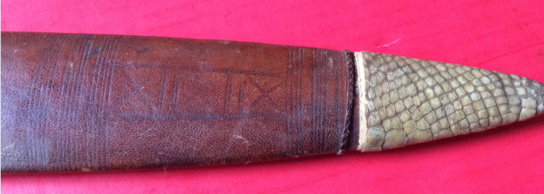

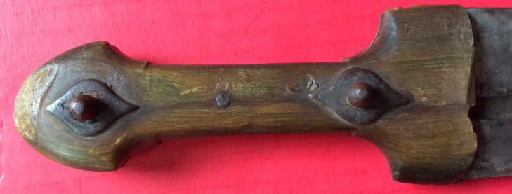

I have a classical kindjal of a Shapsough form ( very heavy and wide blade), with a “Sudanese” leather scabbard. Definitely not a Caucasian or Turkish production:-) I think it is an Egyptian Circassian Mamluk one.

Sorry for the late response: trivialities like job, family duties etc. got in the way:-)
But here it is: blade 15" long, 2 3/8" wide near the handle. Was sharpened and resharpened many times.

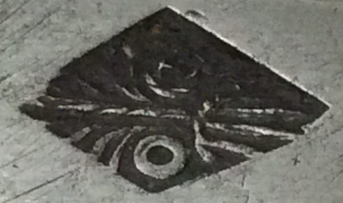

If you can read the stamp, I shall be much obliged.

Ariel, Thank you for the images. It is really very hard to read this. I will ask a friend for it.

Is this one better?
Old 1st September 2018, 01:28 PM   #25
Or this?

The inscription is not clear, we could not read it unfortunately... "Great kindjal", anyway

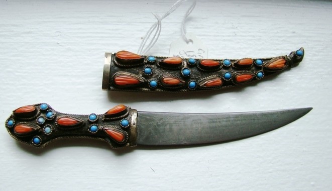

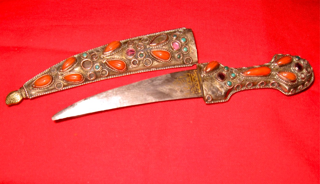

What is about this ones? http://www.vikingsword.com/vb/showth...ht=egypt+coral
