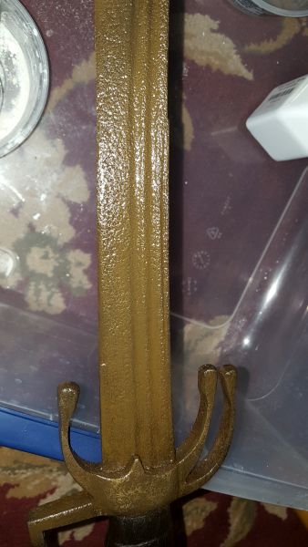

Thank you everyone for the replies. These are a few pictures of the blade and the handle. The shiny stuff on the handle is oil. I decided to apply olive oil and wrap it to let it soak in.
kamals is offline   Reply With Quote

kronckew, it's a beauty. A pity about the aggressive sanding. I almost caught myself doing the same thing! I started a bit of sanding with 2000 grit paper then stopped myself before I did any real damage. I just got a bottle or Renaissance De- Corrosion fluid, it was expensive but so far seems to be helping. Last week, before that I tried Metal Rescue Rust Remover Bath brand, painting it liberally on the blade and guard then saran wrapping it all for 48 hours. Then I took a brash brush to it. It helped some.
These are all from June 15th

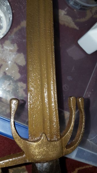

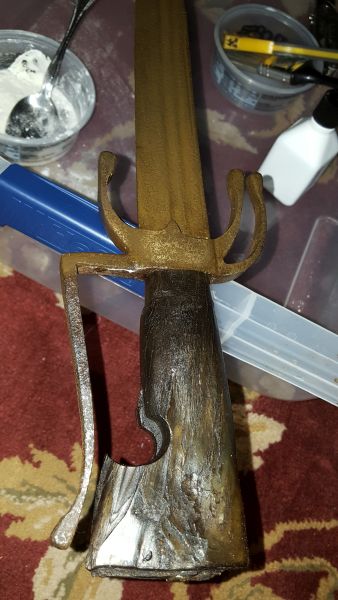

These are from tonight. The rust is somewhat gone from the guard, though there is deep black pitting.
In the previous photos the glossy stuff on the handle was oil. Unfortunately it deeply darkened the horn. Which is, itself, pretty badly de- aminated (I'll try to get a good close-up picture of the handle).
Cheers everyone, thanks !

An update - I've tried the Renaissance de-corrosion fluid, sparingly applied with a paintbruch, and then brass brush scrubbed after a few minutes. and then repeated, in 2 inches portions.
It's working remarkably well in a short period of time, I only gave it a go for a bout an hour then wiped the rest and oiled it. There is bare metal showing but large portions of black pitted metal. It looks like some sort of evil fantasy blade now
I think I'll try letting the Renaissance de-corrosion blue fluid sit on longer. It evaporates quickly so maybe adding another later with a paint brush would help, and giving it 10 minutes to work.. I'll try again in a day or two and post pictures.
