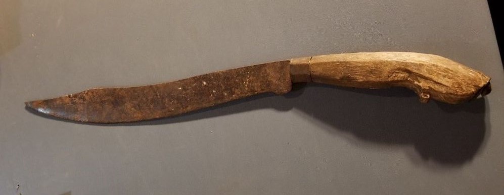

Just won this. I'll post photos once it's here, and cleaned up a bit. In the meantime, here's the link to the completed auction w/photos.
Looks like some sort of Luzon bolo to me, with the side/top faceted semi-figural horn hilt, plate-reinforced peened tang, faceted ferrule to match hilt, pinky cut-out, general shape, etc. Any other ideas on it? I wonder how in blazes it got to the bottom of a mine shaft in Butte, Montana?

I've been so free to post some pictures from the ebay auction. I would call it bolo, itak or matulis. Personally I wouldn't hold on to much on a specific name. Robert, Ian or Jose will be able to tell you from where on Luzon this piece coming. I don't think that the damage of the hilt is insect bite but coming from moisture. Here you can see similar pieces from my own collection: http://www.vikingsword.com/vb/showth...highlight=itak
Old 8th April 2018, 12:15 PM   #5
Posts: 9,725
And I forget, I personally wouldn't try to restore the hilt, I just would oil it.

This is an Ilokano knife with a "double-clipped" blade--a common knife style. The hilt with a small "pinky" notch is also typical of Ilokano work. The wooden(?) hilt is in rough shape and has been "weathered," but overall I don't think this knife is particularly old--probably post-WWII. Knives of this style were common bringback items by U.S. servicemen in WWII and later.

Yup. Going through stuff already posted here (including yours), I'd picked up a few of the Ilokano characteristics to look for (which is how I spotted this item). One thing that caught my attention as a deviation from the usual 1940's-and-later Clark-area bringback is the elevated protrusion at the ricasso (similar to some of the examples that Detlef linked). What (if anything) does that characteristic tell us about the provenance? At this point, my ignorance of such details is vast.

Good question! The "nub" at forte on these knives is interesting and I'm not sure if it is an Ilokano feature or is shared more widely. I'm inclined to think the latter, although there are many Ilokano blades that have this feature. So far, it has not been linked to a particular region. A decade or so ago, some of our older members who no longer post here described knives from Batangas with the same feature.
Your question needs more research.

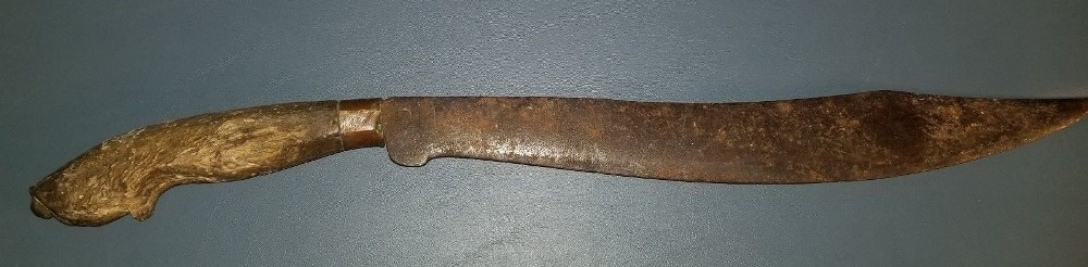

Here's some photos. As you can see, restoration has begun. The hilt is horn, not wood. The most proximal part of the pecked-out design spells out "PHILIPPINES", and the blade is right-hand chisel-ground.

Should be a V-grind on an Ilokano knife. The inscription is typical of post-WWII knives from Central Luzon.
