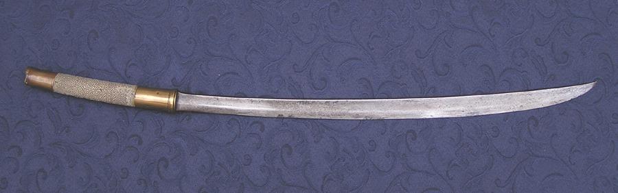

From what I remember of the Greaves-Winston typology there was three main Burmese types.
1. Bama/bamar - Ethnic majority of Myanmar, which the swords hand a short handle and curved blade
2. Kachin - northern minority group, whose dha featured a short hand, straight blade with square tip
3. Shan - northern minority whose dha, featured lotus bud pommel, medium size handle and curved blade

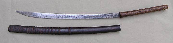

Example: Greaves-Winston typology
http://dharesearch.bowditch.us/0050.htm

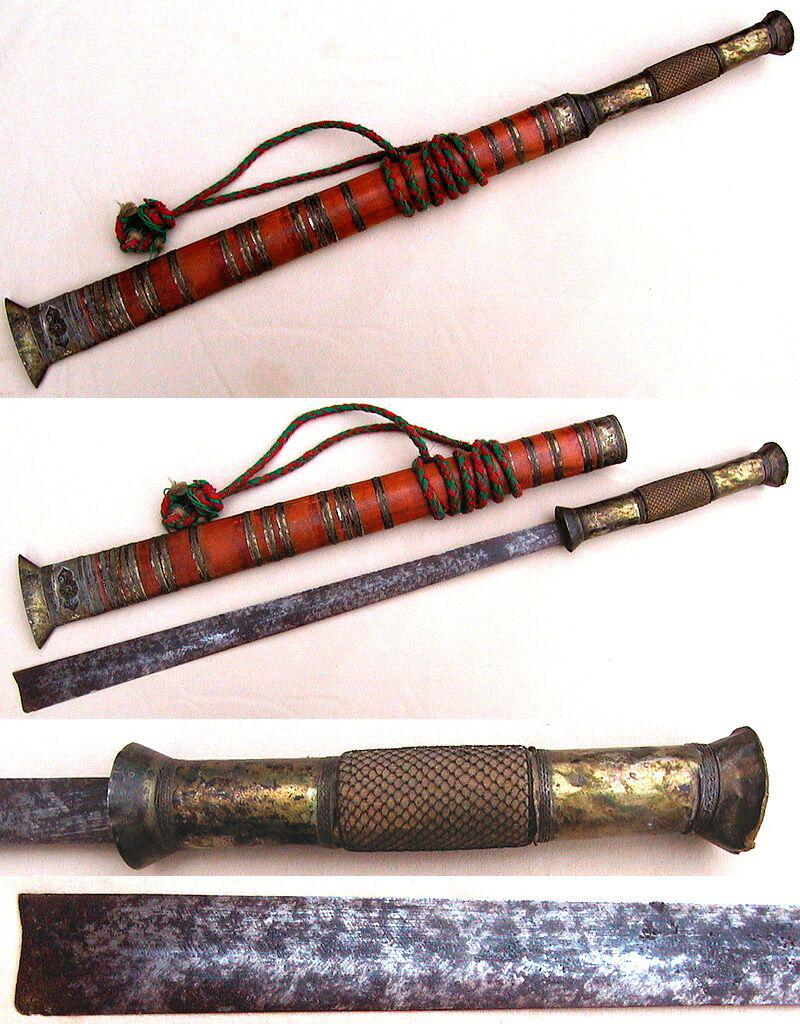

http://dharesearch.bowditch.us/C0034.htm

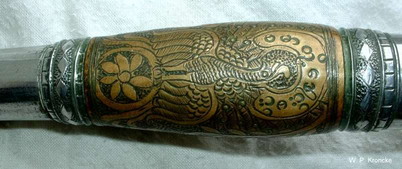

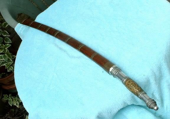

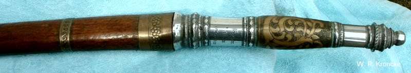

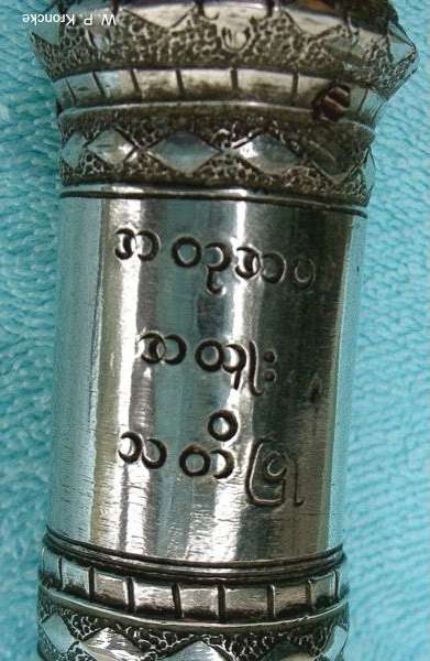

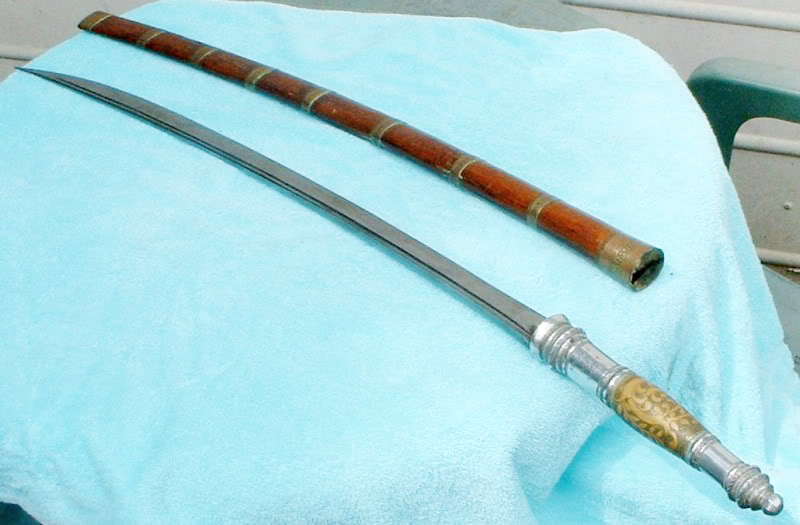

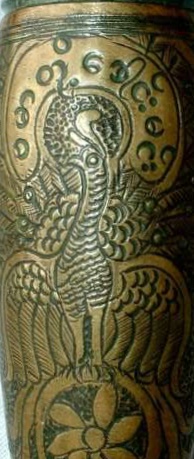

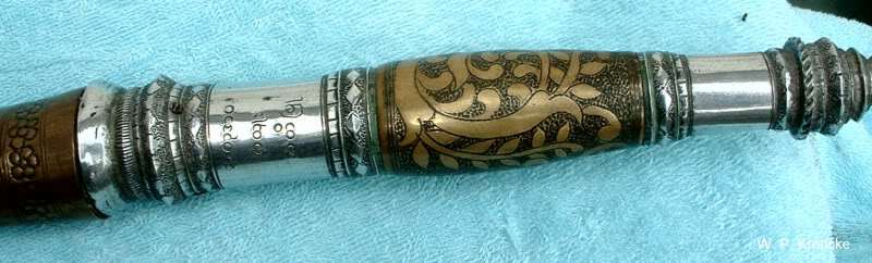

My humble offering, silver and bronze grip inscribed in burmese with a Phoenix bird. shortish grip & ornate pommel. Last time i posted it, no one could translate. Any additional info would be appreciated.
Wayne,
Not so humble IMO. Very nice dha with an unusual hilt. I cannot translate the Burmese script unfortunately.

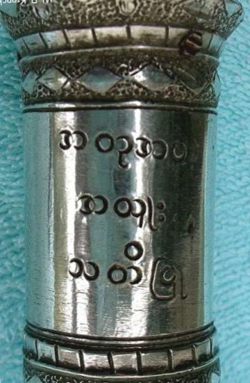

Hello Wayne,
I called in a favor and a friend translated.
Old 5th April 2018, 07:50 PM   #21
Nathaniel
Nathaniel's Avatar
Posts: 865
“King Peacock of Burma”
Old 5th April 2018, 07:51 PM   #22
Posts: 4,250
Thanks., I suspect the bird may have been added later. I do not think it was a 'royal' sword, maybe just one given to someone & decorated later.
So it is the royal Peacock (not a phoenix ) I suspected it might be a peacock.
Any more accurate translation on the inscription on the silver bit?
Old 5th April 2018, 08:56 PM   #23
Nathaniel
Nathaniel's Avatar
Posts: 865
“beware of fraud/ fake”
ie..beware of fake/ imitators of swords with peacock logo?.
Makes my day. I'll watch for copies on eBay.
