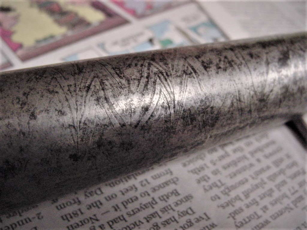

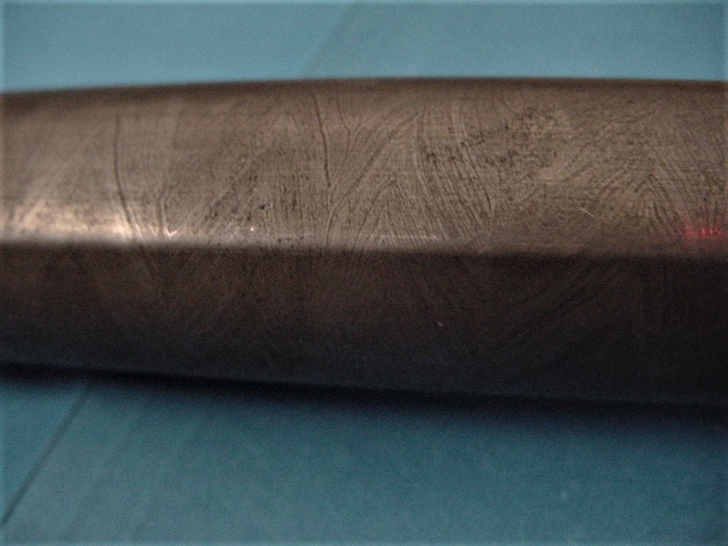

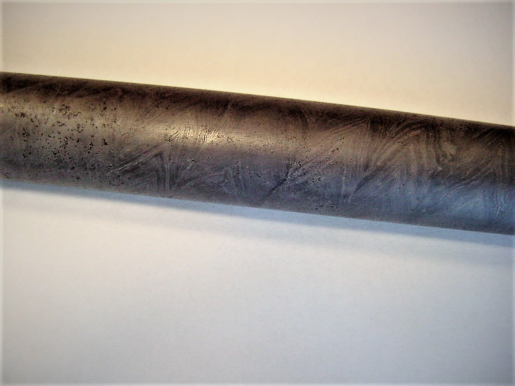

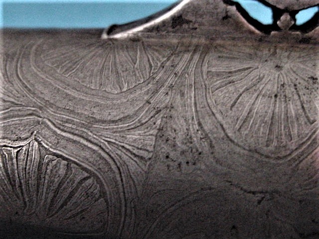

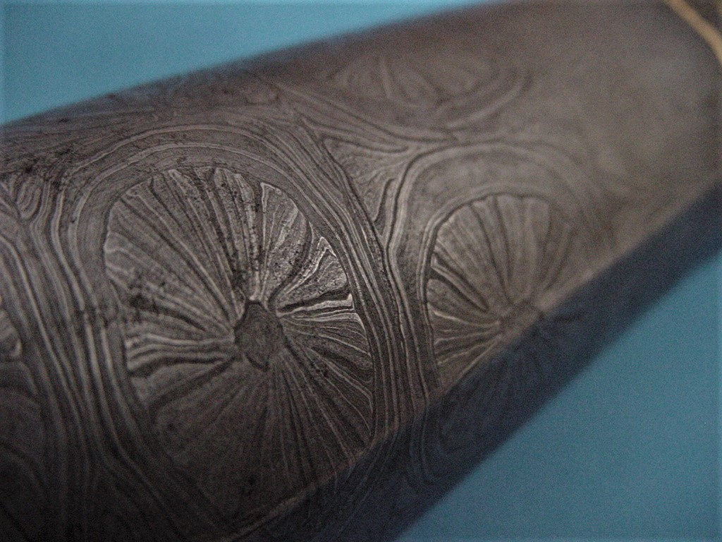

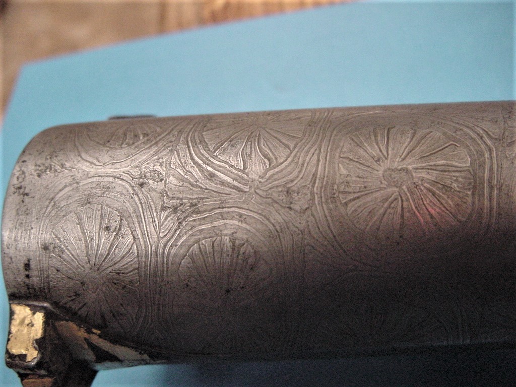

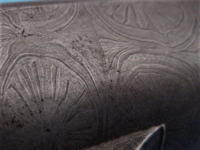

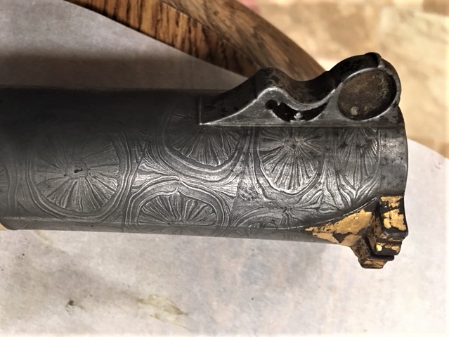

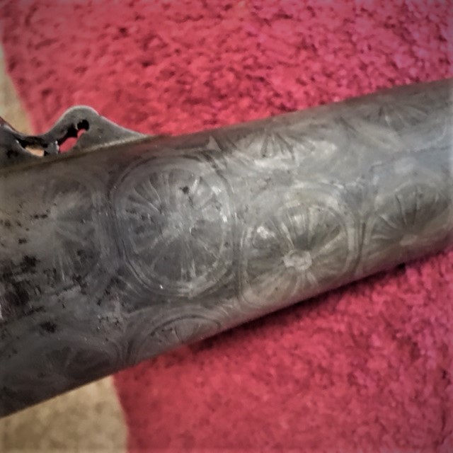

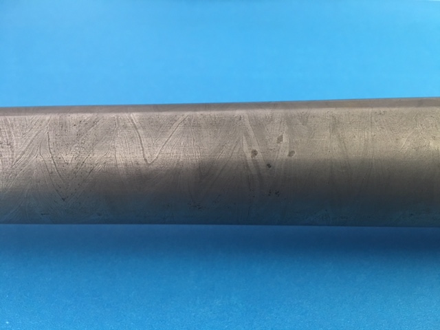

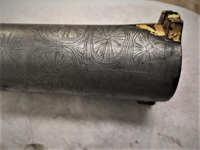

Archer,
Just saw the thread...quite a complex bit of welding there. The difference I see in this to other "orange section" welding (the round converging part) is that the center has a coil or jelly roll.

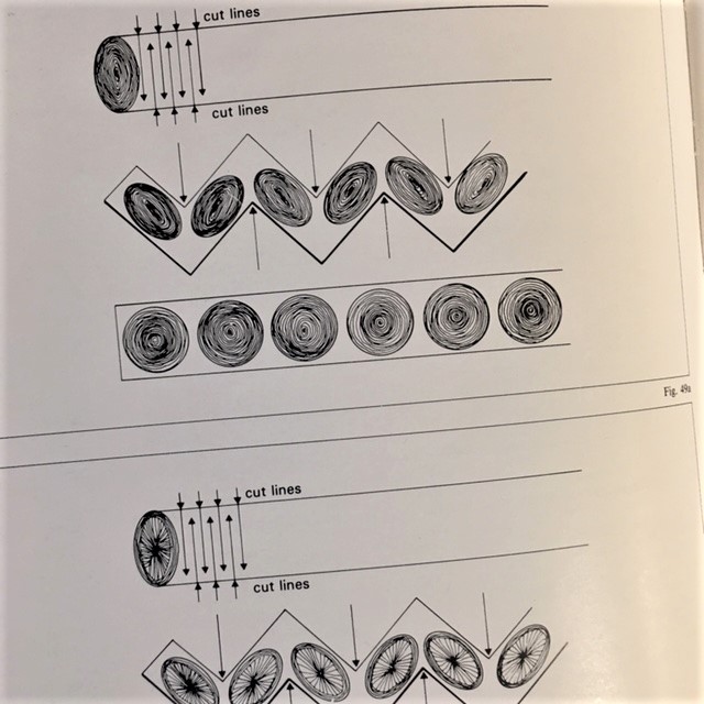

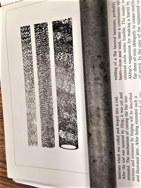

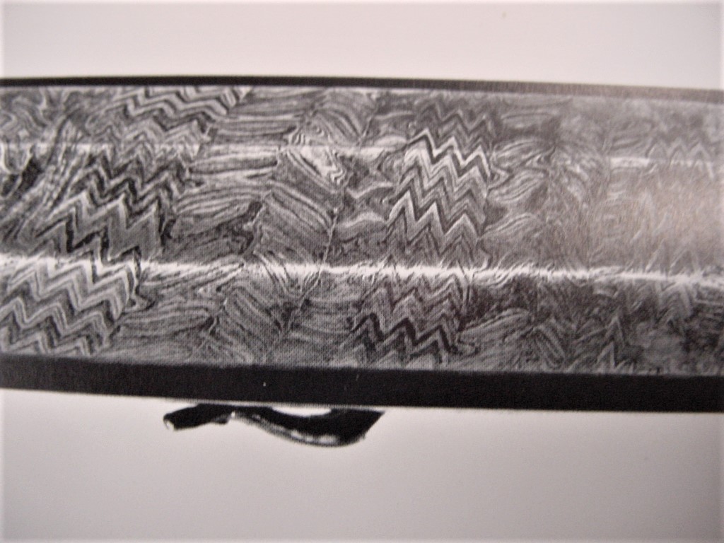

The zigzag are good, not as "ziggy" as the one in Dr. Figiel's book, but that does not bother me.
I would not mind some macro photos of the orange sections..a few of them to compare how the pattern evolves.
Makes me want to make one.
Ric
