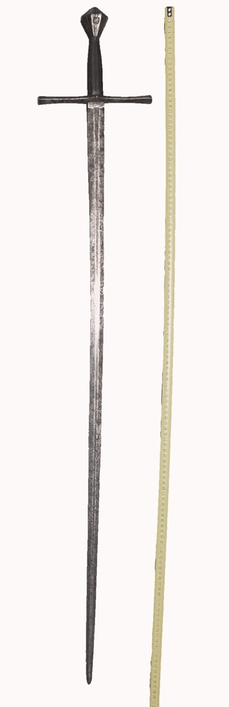

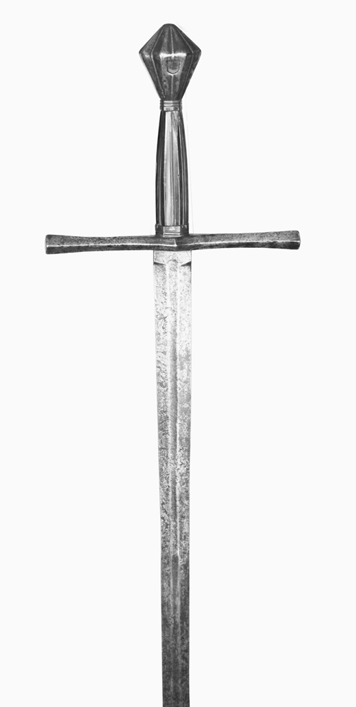

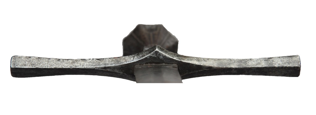

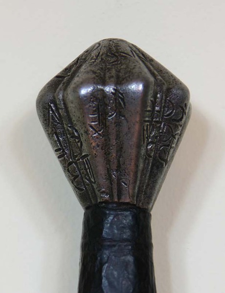

Default Estoc sword of type XVII ?
O.L. 127.5 cm ; blade L. 109 cm; blade width at cross 3.2cm

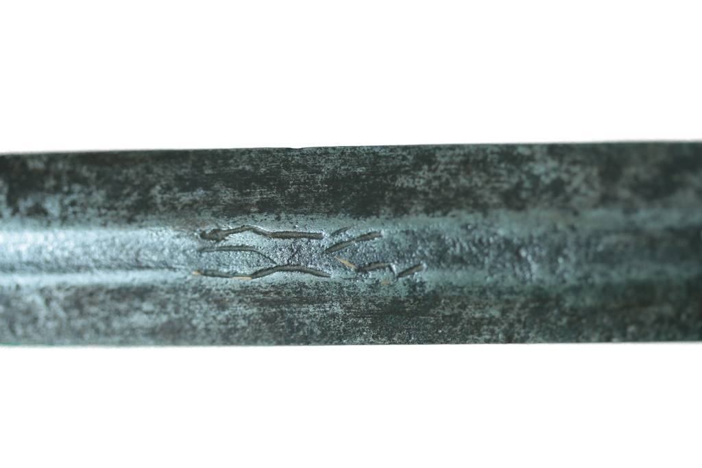

Passau wolf mark in one side.
Grip: made from horn (about 11 cm)
Blade: flattened hexagonal section With a Fuller running from the cross till the tip.

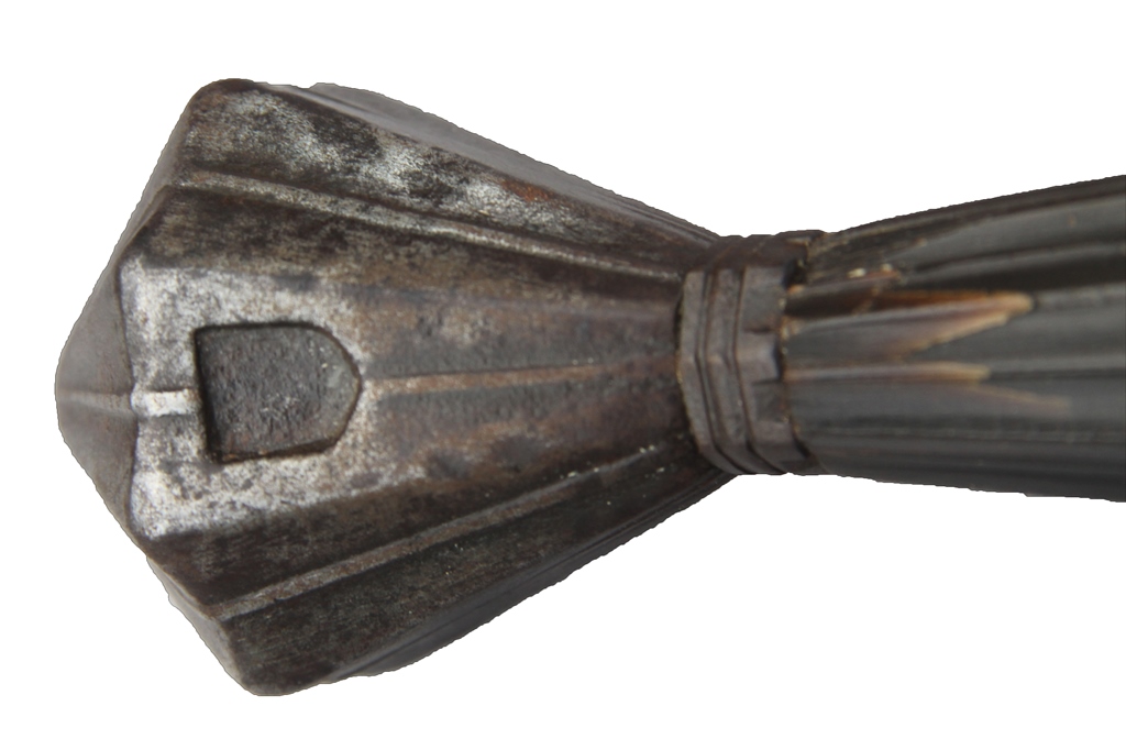

Pommel: Oakeshott type T
Cross guard 20.8 cm of square section
Type XVII would be the nearest type of Oakeshott who could correspond to this sword.
Période 1470-1530 ?
Any comment on it will be welcome.
Best
Cerjak

Hi Cerjak,
what a beautiful sword! I am looking since years for such a sword.
In my opinion this is a cavalry sword (in german "Reiterschwert" for "Rider sword").
An Estoc is more massive and normally with a triangular or square cross section, designed for powerful stabbing through plate armour. Or more precise, designed to find the gaps in the enemy plate armour.
Roland

Hi Roland,
Many thank for your comment.
Do you know other riding swords with similar simple cross guard ?
Best
Cerjak

Hi Cerjak,

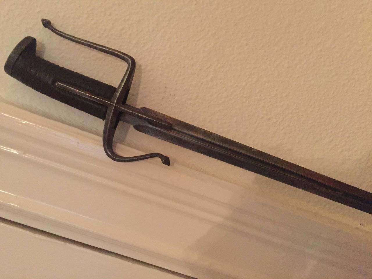

until now i only found this sword from 1547. I am sure, that an Estoc has no groove in the middle.
Your example of the ridingsword is quite unusual.
Can you check the weight please? The ridingsword weighs around 1450-1650 Gramm. The quality and value of a ridingsword is normally much higher than an Estoc.
I can see four possibilities:
1: a riding sword
2: a very early rapier

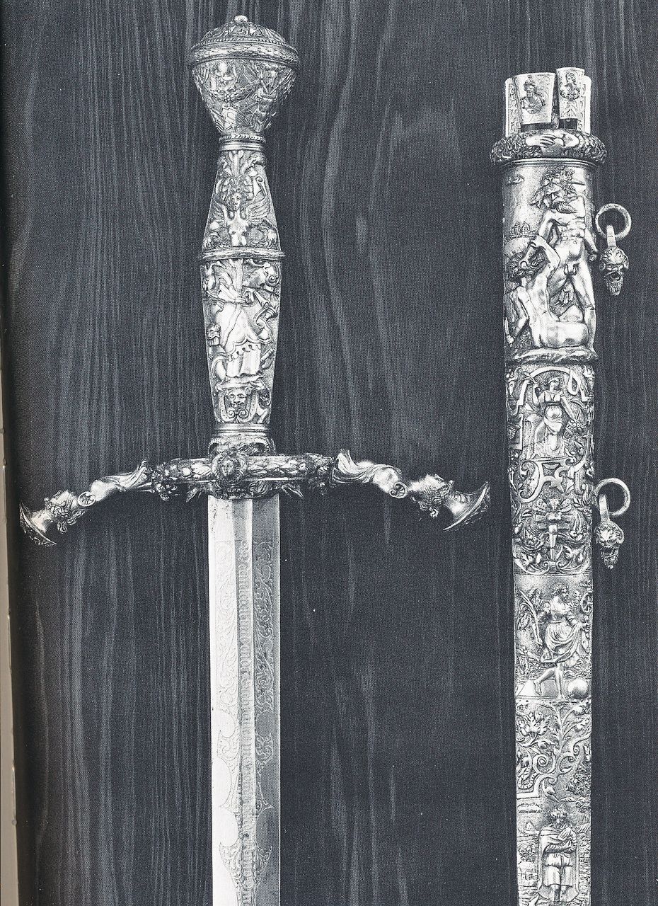

3: a symbol of authority (like the sword below)
4: a composite piece (improbable)
Best wishes,
Roland

HI Andrea
This sword is about 1260 gr.
Also the point of balance is 10 cm from the cross.
This sword is very well balanced Cornelistromp who had it once in hands could confirm it.
Best
Cerjak

Hi Cerjak,
with a weight of 1260 Gramm, a blade length of 109 cm and the balance point you described, i would classify it as an early rapier.
The rapier is a further development of the longsword, the so called "hand and a half sword".
Roland

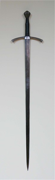

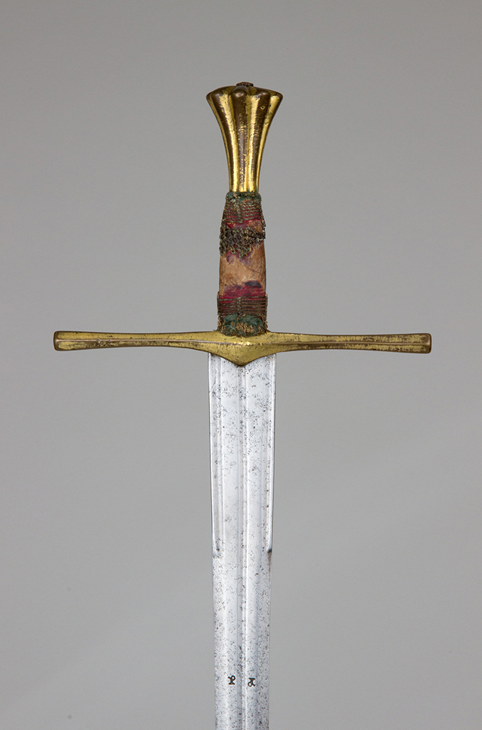

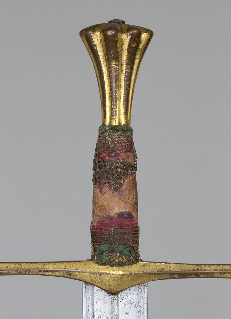

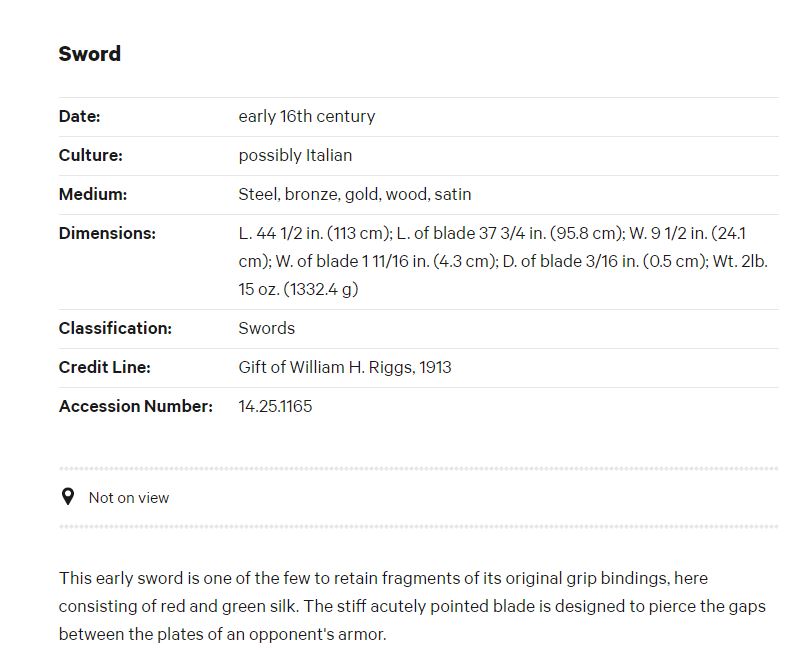

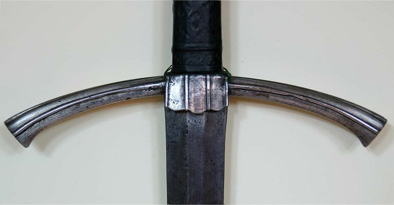

This sword in the metropolitan Museum has the same type of cross guard.
Of course the geometry of the blade is different but I believe that the 2 swords are from same the period and origin.
http://www.metmuseum.org/art/collect...t=sword&pos=33
Best
CERJAK

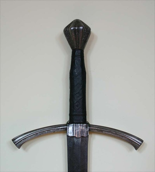

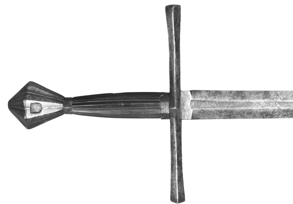

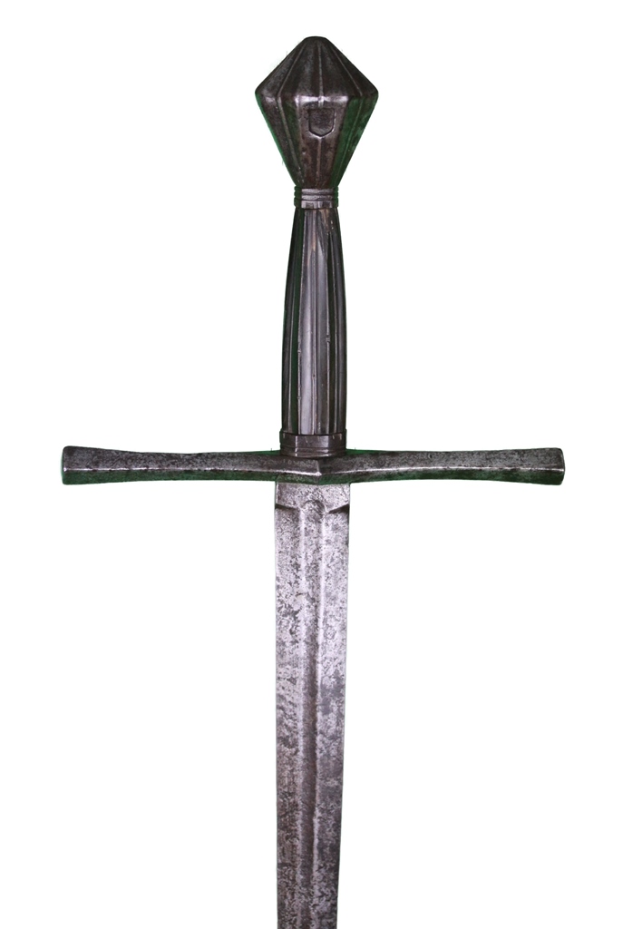

Default an example with same type of pommel and blade
an example with same type of pommel and blade geometry said to be Circa 1490

Even though I agree with Roland that the typical estoc blade was triangular or square/diamond shape, I have seen estocs with fullers. Less common, yes.
Considering the rather long dimension, I would be inclined to put this nice sword in the same group - by application - as the more traditional estocs.

I think it is a Reiterschwert with that blade length and width, and with the fuller reaching all the way down to tbe tip. The quillons and tbe pommel indicate this sword was made for fencing. Are the edges of the blade sharpened for cutting with? As far as I’m aware, estoc blades tend to be longer and thinner with very sharp and solid (fuller, if any, ends higher up the blade to increase strength) tips. They are made for thrust rather than cut. The steel had to be especially hardened for their purpose.

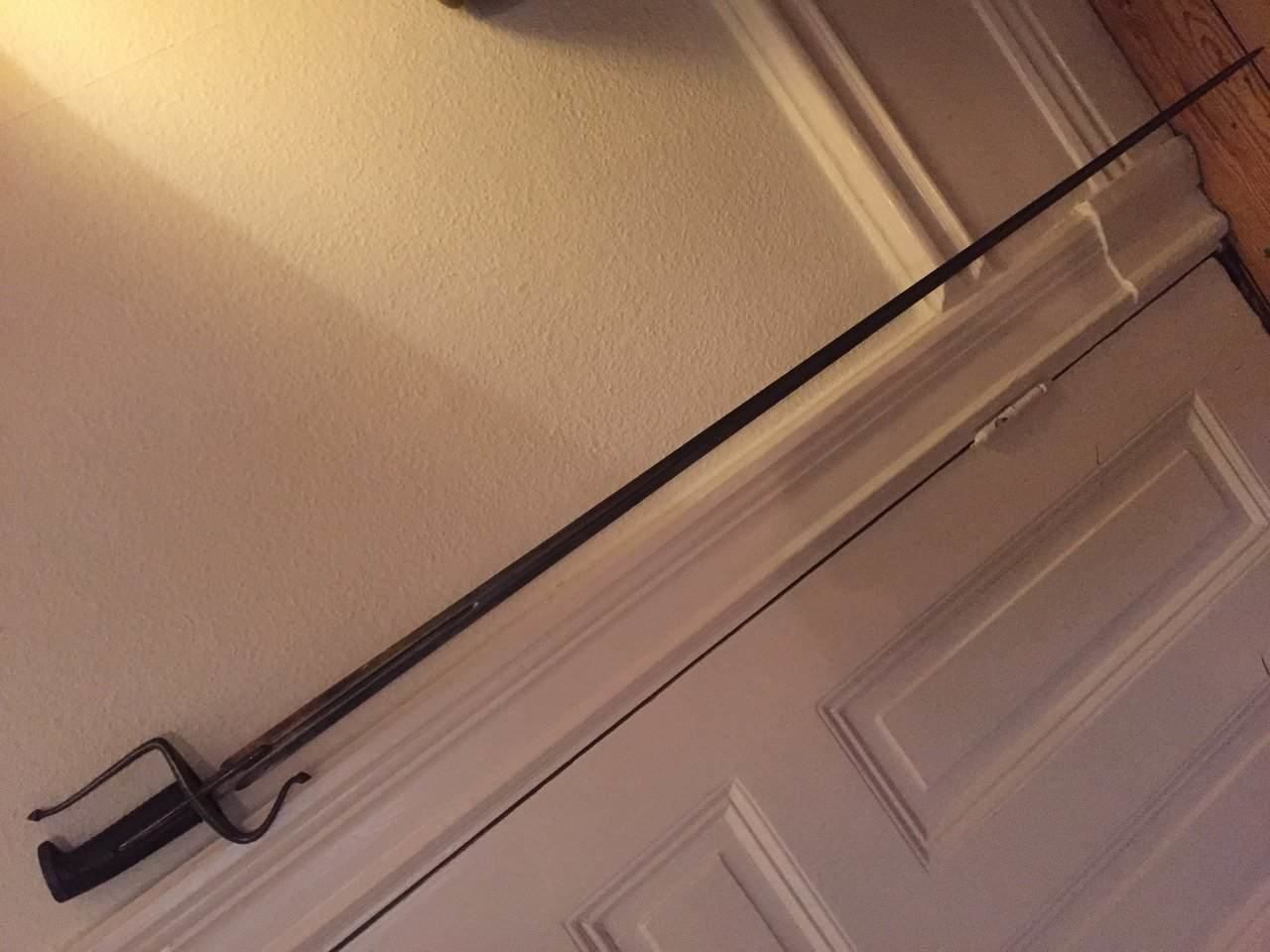

I read Cerjak’s post again more carefully and the sword is very long with an overall length of 127.5cm and blade lenghth of 109cm. This seems to suggest that it could be described as a ”longsword” although the hilt is not that big? Cerjak describes it as ”well balanced” and it weights only 1260g, which suggests that it was made for fencing with despite its considerable length. Are the side edges sharp? Then we have the grip made from horn which is a material more common for hunting equipment.
Cerjak also posted a picture of the sword from the Metropolitan museum with gilded pommel and quillons and silk covered grip, which seems to be made for tournaments. Then Tordensiöld posted the fascinating picture of combatants with huge estocs, equiped with special grip supports on the blades. I wonder if Cerjak’s sword could be a special duel/tournament sword?
The estoc changed its shape and form over the centuries that it remained in use. The sword pictured below is a much later Hungarian estoc/panzerstecher/koncerz from the end of the 17thC. These were used mainly for penetrating chainmail, which which were still in use by the Ottomans at the time. The sword is overall 120cm long, blade length 109cm, width at forte 2.4cm, width at ricasso 1.7cm. The blade is diamond shape in cross-section with a sharply pointed tip but the edges are not sharp. The blade is rigid stiff. It has a fuller near the hilt but this is only 19.5cm long. These were used by mounted hussars who would charge the enemy at speed with the estocs. The idea was that the tip would enter a ring in the chainmail, and then the momentum of the charge would expand or collapse the ring, enabling the estoc to penetrate deeper.

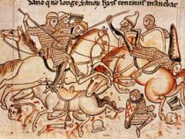

In the drawing below it seems as the mounted rider to the left is penetrating his enemy's mail with an "Estoc" type weapon rather than an lance:
Tordenskiold1721 is offline   Reply With Quote

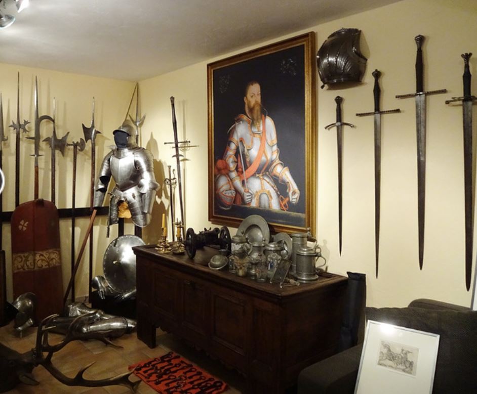

Nice room, Cerjak. I especially love the halberd rack.

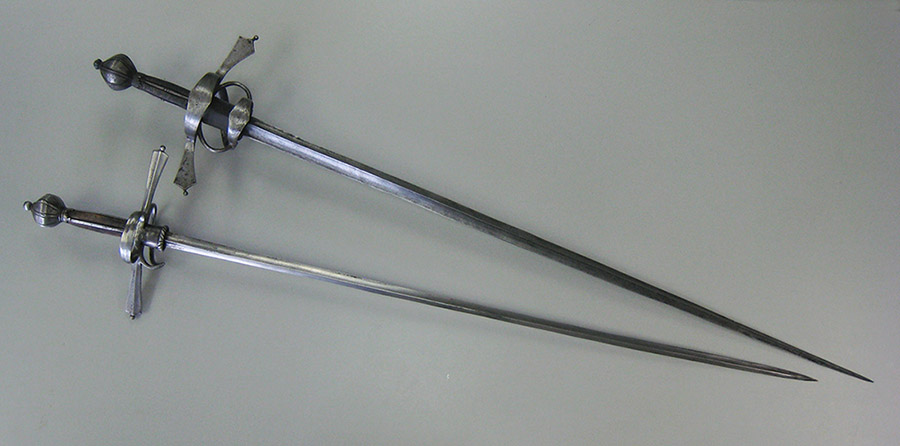

That sounds good! For starters here is the pair of the more traditional Saxon estocs.
Foxbat is offline   Reply With Quote
Hi Vitrix
This room is not my room but only some pictures I found on a similar sword

Hi Vitrix
Reference to the dealer were you can see more detailed photos of the same sword is:
http://www.antik-sammlerboerse.info/
The items:
http://www.xn--antik-sammlerbrse-d0b.de/

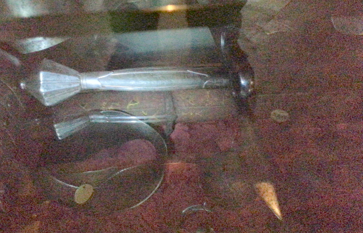

Old 30th January 2018, 07:30 AM   #25
cornelistromp
cornelistromp's Avatar
Join Date: Mar 2009
Posts: 1,071
similar pommel in stibbert Museum Firenze.
best,
jasper
Old 30th January 2018, 09:38 AM   #26
Cerjak
Cerjak's Avatar
Join Date: Jan 2012
Location: FRANCE
Posts: 1,065
Many Thanks Jasper
very interesting I hope to find a better picture with information about this sword
Best
Jean-Luc
