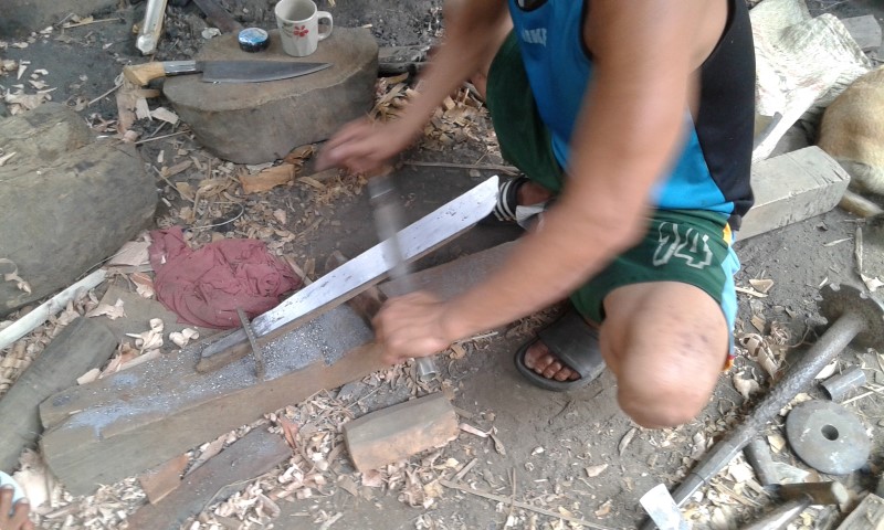

for exampe even today the fugao do not know what a metal plane is so they in history hammered their blades smooth and then smoothened them on a stone. but in the lowland migrans tagalogs visayans ect took with themform what is now indonesia when they mograted the metal plane.. so they will plane their blades smooth with a special tool when they are soft .
like you plane wood.

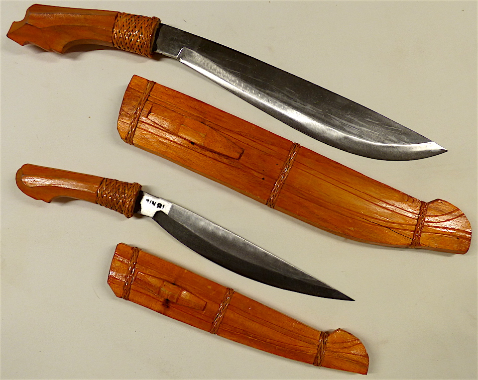

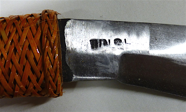

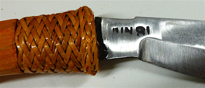

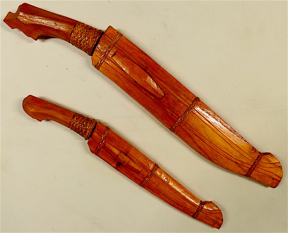

Just to add some context to current Filipino knives, here are two that I believe are from Mindoro and were made recently. They are almost identical in style and have the same mark ("MIN81") stamped at the base of the blade. It appears they were made at the same time by the same person.
These are high quality blades, both well sharpened with a single bevel to the edge (in the manner of most Visayan knives). The handles are good and tight to the blind tang. Good working knives, practical and inexpensive, that would serve as a weapon if necessary.
Ian.
Old 18th December 2017, 09:30 AM   #12
I have a pair of those too, garabs, nice working knives, right-handed chisel edge (single bevel). Also, have a similarly edged, scabbarded and gripped ginunting and a pinute sword. I gather they are HC tool steel... All made by DaSilva.

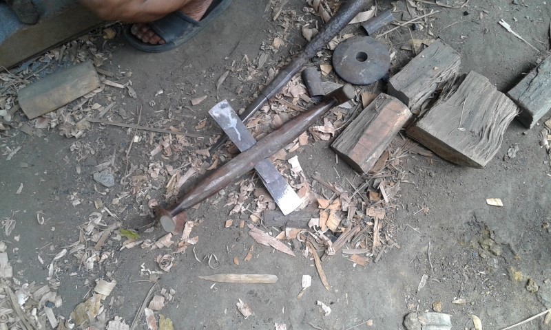

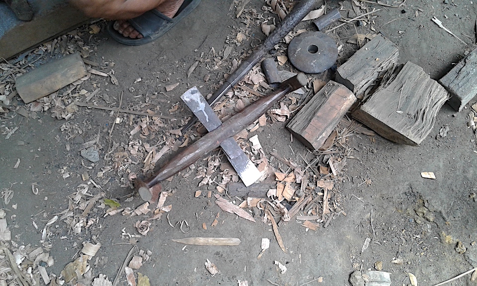

Posts: 497
Originally Posted by Ian
Ausjulius,
Thanks for the information. Some of this I did not know. Do you have a picture of a metal plane--I'd be interested to see one and get an idea of how it was used.
it is an example of a Visayans metal plane
if you want i can find videos of it being used
Ian.
hi, yep they look ok , but they are not native mindoro knives they are made by settlers. probably visayans form the lowlands.
but the general rule of thumb is the further from modern life you go in the phillipines the more likely youll find a good knife.

Old 27th December 2017, 04:23 PM   #20
Posts: 4,735
https://ibb.co/m3keKw https://ibb.co/deiS6b
Thanks ausjulius. Interesting looking tool. It appears to be used like a draw knife or shaver. I would appreciate a link to the video you mentioned.
Ian.
PS: I've attached the pic in your link for the Forum's files--these links tend to get broken and we lose good information in our archives unless the pics are uploaded to this site.

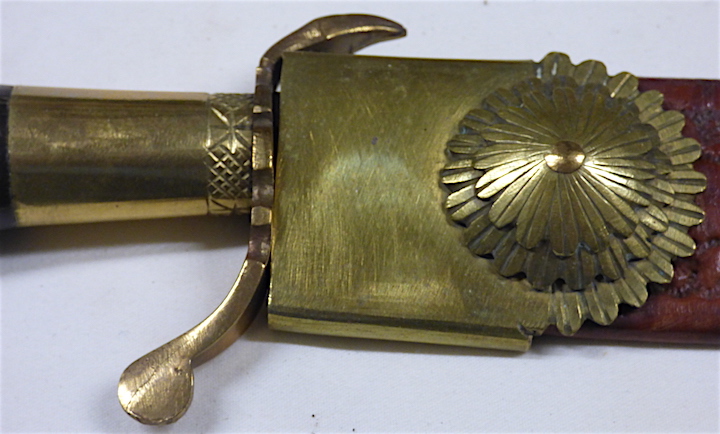

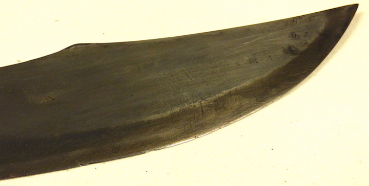

Posts: 4,735

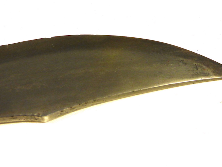

Here is a relatively recent (late 20th C.) Ilokano knife which is well made. The blade shows a clear hardened edge that I think reflects quenching rather than an inserted edge. The sheath is nicely tooled leather with brass fittings. Hilt is made from horn with metal inserts.
This example reflects ongoing skills in the manufacture of certain Luzon blades.
Ian.

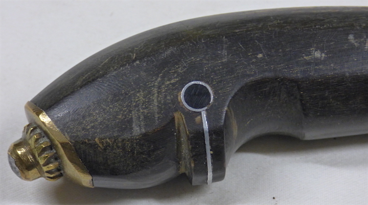

Old 29th December 2017, 07:39 PM   #27

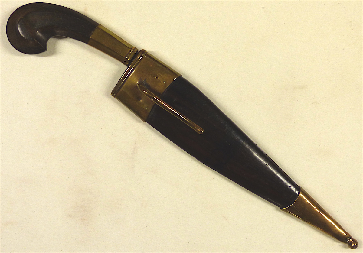

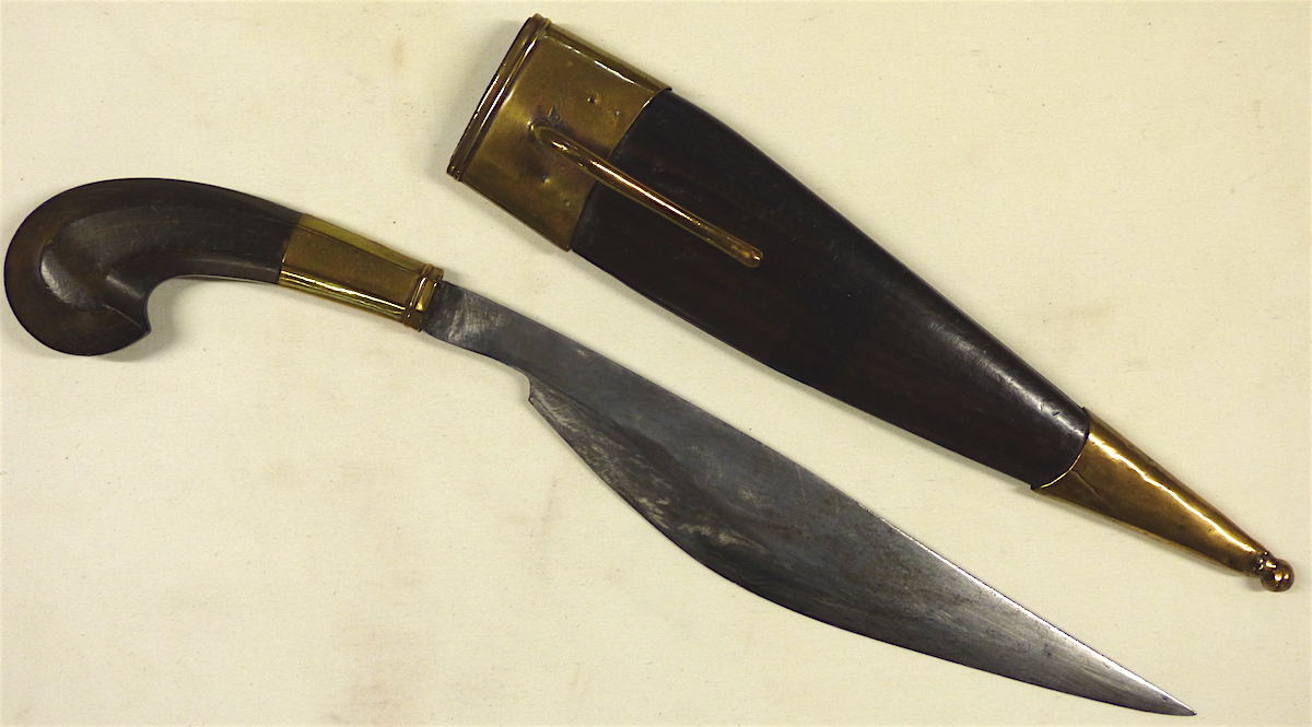

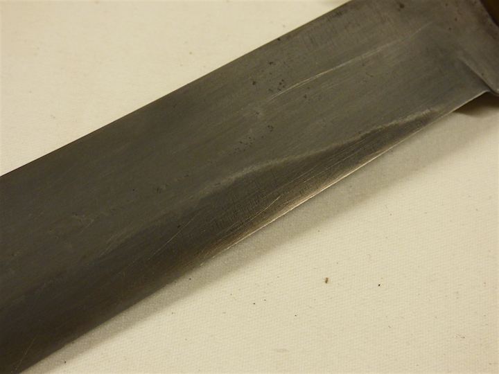

Posts: 4,735
Another mid- to late- 20th C. piece. This is a Visayan plamingko from Panay. Again, an excellent blade with a hardened edge (I've not etched it but the hardened edge is apparent in the hand, although not seen in the picture). Good quality hilt and scabbard as well. Nothing fancy, just a well made and very functional knife--just as effective as a gunong.
Ian.

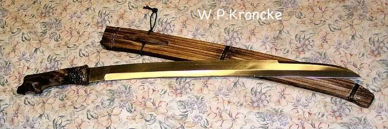

Old 30th December 2017, 08:48 AM   #28
Philip
Philip's Avatar
Location: California
Posts: 1,036
Having restored, polished, and cut things with a lot of antique and recent-vintage SE Asian and especially Filipino knives and swords over the years, I can say that they all, being handmade by craftsmen, are highly individualistic in terms of their metallurgical quality. It's almost impossible to generalize by type.
I've worked on old Moro kerises that would truly impress the Spanish colonizers of centuries past for their resilience and temper, not to mention the pattern-welding. Others have less going for them -- forging flaws, or excessively soft cores that take a set easily. Some edges are quenched and tempered very hard like Indian crucible steel, others have a softer and tougher edge like a machete, and a few are just plain soft. And there is no hard-and-fast correlation between steel quality and the artistry of the hilt. Campilion blades are prone to even more variation, understandable since it is quite difficult to temper such long and thin blades in pre-industrial conditions.
Some collectors tend to disparage central and northern Philippine knives for the less-careful finish quality, but many of these are really well-tempered, sturdy, and efficiently designed. It's hard to beat a good talibong for a combo of cutting and stabbing efficiency. Battara is right about the availability of industrial steel in the 20th cent. contributing to greater consistency in the finished product. Nothing wrong with jeep and truck spring steel... A Thai knifemaker told me that Japanese leaf springs from light trucks made up through the 1970s are lamellar, a type of "san mai" construction and that is why they were popular material for dha blades made in Aranyik.
