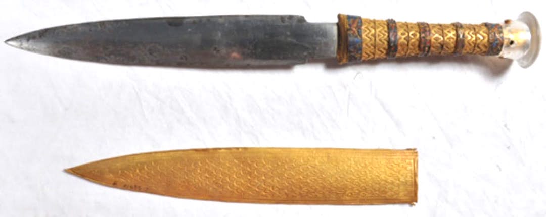

Greetings folks,

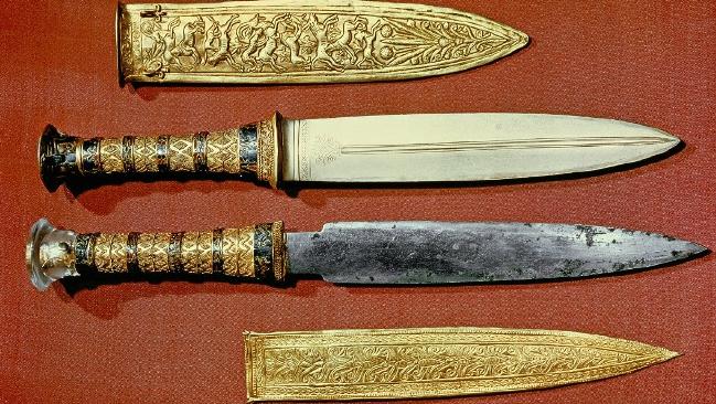

Here is a link to a short article discussing the new finding that iron blades on bronze age weaponry were not from smelting but from meteorites:
https://newatlas.com/bronze-age-iron...eorites/52474/
Here is a picture of the actual burial dagger of the Pharaoh Tutankamun. Notice the iron blade:
Old 15th December 2017, 07:44 AM   #2
Roland_M
Roland_M's Avatar
Join Date: Aug 2014
Location: Germany
Posts: 528
Originally Posted by Battara
Greetings folks,
Yes it is nearby, that this early iron blades were made from meteorites.
In this case the humans must have had a giant genius, because the Tut-dagger is pretty obviously differential hardened and how in all the world had they found out this technique with small amounts of iron from meteorites? Differential hardening is a completely different world compared to bronce.
Maybe they had larger ammounts of iron than we think. Iron from vulcanic activities?
Roland

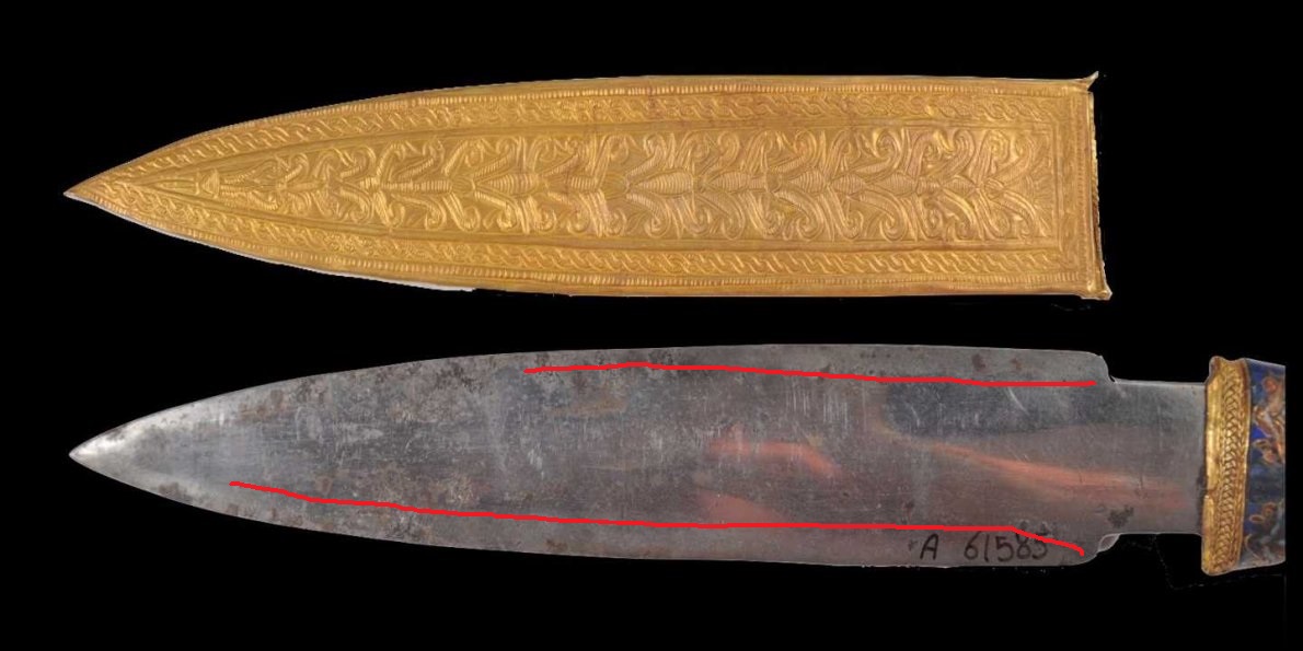

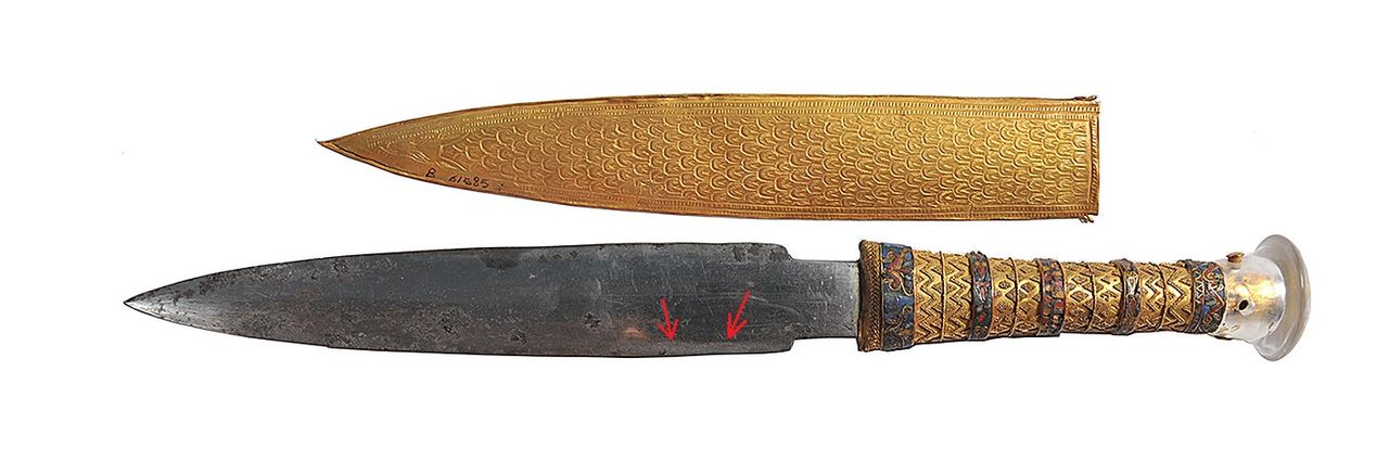

Hello Roland,
Can you please substantiate the asertion that Tutankhamon's blade was differentially hardened?
Marius

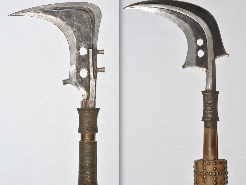

PS: I attach a couple of example of blades that display a difference in oxidation around the edge and are NOT differentially hardened (if you take a Magbetu knife from the photos below and clean a little bit more the forging oxidation from the surface of the blade, you may end up exactly with the type of visual effect you noticed on Tutankhamon's blade).

Hello Roland,
Marius
Hello Marius,
I can only judge by the pictures, I never had King Tuts dagger in my hands.
But almost every picture of this particular dagger shows a brighter area around the edges, which is normally a sign for a complex heat treatment.
King Tuts dagger is fully polished, your examples only have a grinded/polished cutting edge, typical for Africa. The upper curved blades are artificially blackened.
To be 100% sure, I need to polish and etch this dagger .
My personal theory is very simple. I believe, that there was a unknown sophisticated culture like the fictional Atlantis, which brought the knowledge to Egypt and other parts of the world.
Roland

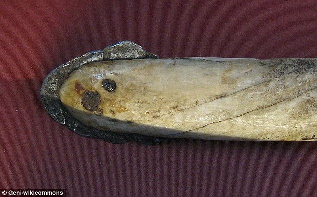

There are instances of Inuit peoples making iron spear/harpoon points etc from fallen meteorites (beaten out cold)...
Yes, many collectors including myself have a tendency to underestimate the capabilities of ancient or native cultures.
But compared to the King Tut dagger Inuit people iron works are cold hammered, realtively simple and not much bigger than a thumb nail.
http://www.dailymail.co.uk/sciencete...s-weapons.html
King Tuts dagger is an evidence for sophisticated working on steel 1000 years before the use of steel was wide spreaded.

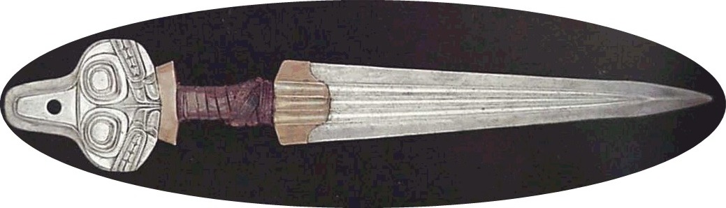

More than spearpoints and harpoons, the Tlingit supposedly forged this "Killer Whale" dagger (really more a short sword) out of meteorite back in the 17 century. That's certainly not pre-iron age for much of the world, but pretty advanced technology for these northern tribes way back then.
http://juneauempire.com/art/2015-05-...hidden-history
That said i must say that i am really not completely convinced that the method with which the King Tut dagger was determined to be made from meteorite is 100% fool proof. The make-up of this blade is still all of elements that can be found terrestrially. That it is similar to the make-up of know meteoric blades makes this more a maybe for me than a sure thing.

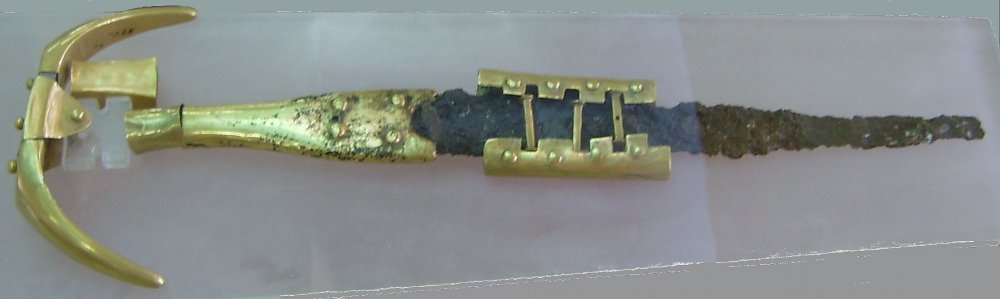

The Alacahöyük (in Anatolia, present day Turkey) dagger, overall 18.5 cm, gold mounted iron blade, about second half of 3rd millenium BC. Currently in the Museum of Anatolian Civilisations in Ankara.
I got the photo from Wiki Commons and the information from the museum guide book.
Old 15th December 2017, 10:16 PM   #14
Posts: 7,253
Yes, that's the dagger.
I had two measurements in mind for this, one was 20cm, one was 30cm.
I took the 20cm as blade length, the 30cm as overall length.
My source was probably one of several books I have somewhere on the European Iron Age, I cannot remember correct titles or authors and I do not know where they are, and its not important anyway.
As for dating, I'd guess that as with many archeological finds, opinions can vary, and in this present case it is of no moment, the important thing is that iron technology was around a long time before KT played with his dagger.
This pic is the dagger I was talking about.

Old 16th December 2017, 03:06 PM   #24
Posts: 7,300
Originally Posted by kronckew
The chinese qing dynasty (17c) traded with the tlingit and their coins are found sewn onto tlingit armour. not a far stretch to consider chinese iron/steel being used in their blades. the chinese were selling 'native' design blades all over their trade areas. (phillipines as another trade partner comes to mind).
Trade routes were much farther afield and well developed much further back than we think, and we find they were even further back the more we discover new evidence. heck, even the early romans preferred silk clothes.
Wayne, there is little doubt that there was indeed trade with the Tlingit from outside sources, including the Chinese, however, if you read the article i link to you will see that the Tlingit have a long oral history attached to this blade that includes the name of the person who forged it and the actual place of the meteorite fall that they gathered the material to make the blade from. While oral histories can indeed be incorrect at times the one surrounding this very important sacred object seems likely to be true.
This photo from the Alaska State Library Historical Collections is part of the Vincent Soboleff Photograph Collection, ca. 1896-1920. The description of the photo reads "The man holding the dagger is Gusht'eiheen (Spray Behind the Dorsal Fin) of the Killerwhale House of the Dakl'aweidí Clan in Angoon. The dagger he is holding was made by a man named Kucheesh, from a meteorite that fell near Klukwan. When it's brought out in public the words to announce its arrival are "This came to us from the sky."
Old 16th December 2017, 07:31 PM   #25
Oral history sometime leaves out bits. I don't disagree that the blade could have been made with major additions of a sky metal. it would have been easier to include it with some chinese supplied stock during the forging, the inclusion of the source of the chinese sources into the story would have detracted from it's traditional spirital message. It's a big No-No to try to shave off a bit for testing tho.
That dagger is gorgious by the way, they had quite good skill and artistry.
Old 16th December 2017, 09:07 PM   #26
Posts: 7,253
Ariel & Marius.
I know a little bit about working with meteoritic material because I have worked with it.
Using fragments of the Arizona meteorite, I have made small billets of clean ready to use meteoritic iron, these small billets could have been made bigger if I had had sufficient meteorite, or they could have been made into very small blades as they were.
However, I used this refined meteoritic material to make damascus blades by incorporating it with iron and steel.
Two small billets of meteoritic material that I made were given to a Pande Keris in Solo with instructions to make two keris. The first keris he made was unsatisfactory and it was sold, the second keris he made is a part of my collection.
I worked with pure meteorite and the product I produced was pure meteorite, which was later combined with other material. There is an easier way to work with meteorite than the one I chose, but I worked with the pure material because I considered this to be a matter of work ethic.
The easier way to work with meteorite is detailed in a text book that was prepared at the request of the Surakarta Karaton. We are uncertain exactly which ruler of Surakarta ordered its preparation, but it was probably Pakubuwana X, and the Empu providing the information was probably Jayasukadgo.
In this text book, the meteoritic material being addressed is the Prambanan Meteorite. The method detailed involves making a small, thin-walled iron packet, putting small pieces of meteoritic material into the packet, closing the packet, bringing it to weld heat and then taking the weld. This initial weld will unite the pieces of meteorite, after which the material can be cleaned (refined) in the usual way.
It would be possible to weld two pieces of meteorite in a charcoal forge, but they would need to be fairly large pieces, it would be virtually impossible to weld small pieces of meteorite in a charcoal or coke forge. If a single large piece of meteor was available, this would be easier still. I had only very small pieces of meteorite to work with, and when I was working with this material in the late 1980's, it was very, very expensive material. I used a gas forge to weld and refine it.
To return to the question of what raw material was used in early iron blades, and how it was processed.
Meteoritic material will break up under the hammer. It is necessary to bring the pieces of meteorite together while they are still in the fire, they will then stick together. Then it is necessary to tap them together on the anvil until the adhesion is firm. If you hammer in a normal fashion they will simply fly into a thousand pieces. Once the first weld has been taken it becomes progressively easier. You add a small piece of meteorite at a time until you have a good sized lump, then fold and weld until there are no little star-like sparks generated at weld heat. It is not rocket science, it is simply application of logic, together with a smidgen of knowledge.
There was an overlap of bronze working technology and iron working technology. There can be no doubt of this. Since there was an overlap, it seems reasonable to assume that early iron artifacts, whether blades or something else, might have been produced by casting technology similar to that used in bronze production.
However, bronze production rested firmly upon the ability of potters to produce vessels capable of withstanding temperatures of 1700F.
To me, the big question is if the potters at this time in history were able to produce vessels capable of withstanding temperatures of 2800F.
However, a small fire in an earth depression and given a continuous infusion of air by the use of bellows can reach +2800F without a great deal of difficulty.
As Ariel has noted:- Occam rules.
The easiest, most obvious way to do something is usually the way something is done.

While it is true that the Ancient Egyptians did cold forge meteoritic material to produce talismans, they did not begin to produce iron tools and weapons until about 500-600BC, when iron smelting technology became available.
Egypt at the time of Tutankhamen did not possess the technology to produce a blade like the KT dagger, but the Hittites did, and there were diplomatic and marriage ties between the Egyptian court and the Hittite court.
