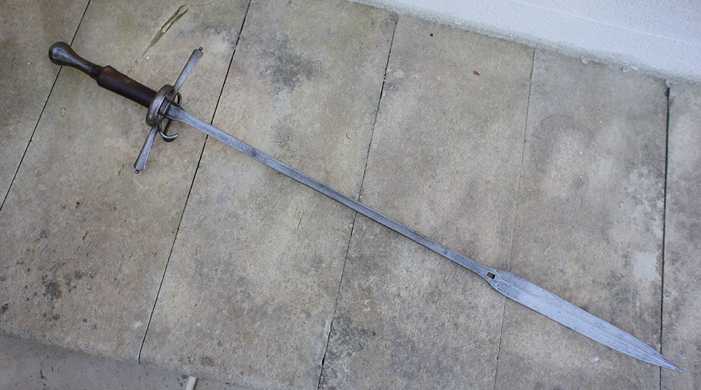

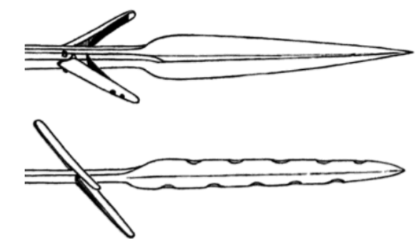

Boar swords were quite common in the 16th and early 17th centuries in Europe. Unlike the boar spears they sported sword hilts, usually in the typical for that period styles, like this one.
The term is less popular, but if you do a search on it, you will find them. Here, for instance:
http://karabela-arms.com/index.php?r...product_id=114
Often simply called Hunting Swords.

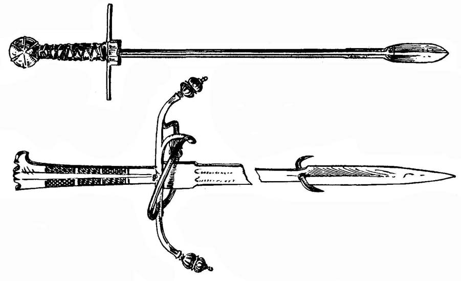

Here's the typical example of that class of weapons.

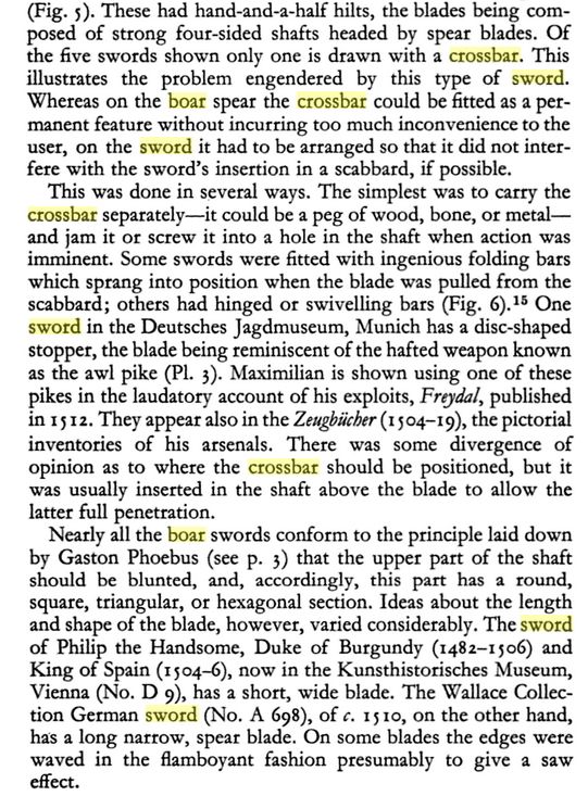

Originally Posted by kronckew
Came home and found that book on my shelf... but it doesn't show much, unfortunately. A couple of pictures of cross bard, not clear how exactly made.
Foxbat is offline   Reply With Quote

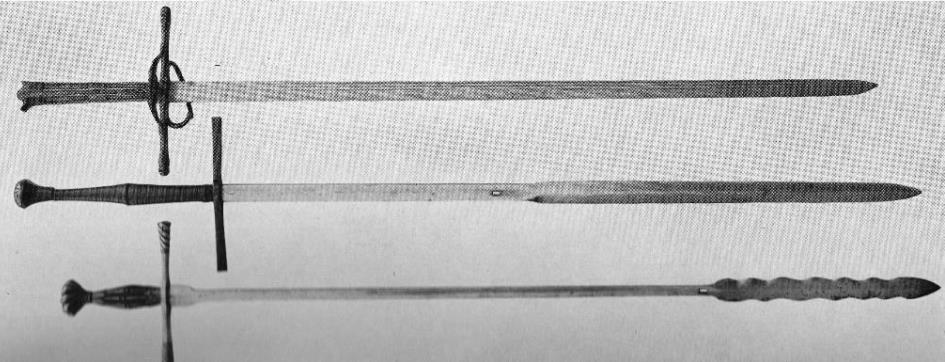

this is a so called German "Sauschwert" (sow sword) and here is the only picture of the spines I can find.
Roland

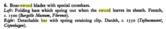

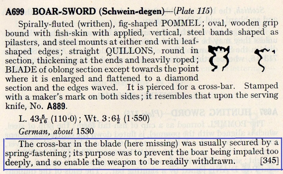

I've seen a modern recreation of the boar sword sketched above by an experimental historian. Apparently the cross piece was made to be removable, possibly screwing together, rectangular on the main piece to fit the slot and prevent rotation, but drilled & tapped for a mating screw on the opposing arm. Each had a shoulder behind the bit that went through the slot to hold it from both sides. Unfortunately there was no pic of it unattached to the blade.
Screen dump: for those of us without the whole book and a picture of the crossbar on the original museum piece at
https://guywindsor.net/blog/2016/10/...swords-me-too/

In any case, it appears rather difficult to spot one of these swords complete with their cross bar, worse a technical description of these devices, even worse that there is more that one system; although certainly not the 'horn' like version, in the discussed case. Cross bars or 'travincas' (as we call them here) made of wood and bone were materials already used in prior hunting spears (ascumas), in a manner that they were firmly binded to shafts, as scabbards didn't take place to conflict with. It seems more consistent that steel (iron) was a material that prevailed in hunting swords when cross bars started their appearance in the XVI century. We can see that when Emperor Maximilian in 1526 ordered a set of miniature paintings, only one of the five huntsmen had a cross bar fitted in his sword.
Foxbat's splendid example has some similarities, at least in what concerns the orifice for the cross bar, with those in Wallace Colection (plate 115); the author assuming how the (missing) cross bar was usually secured; somehow consistent with the right hand sketch in the above linked work.

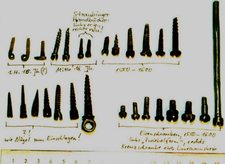

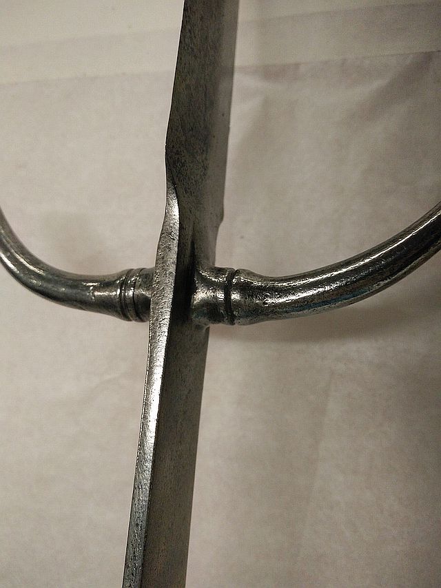

Courtesy Michael Trömner (Matchlock)

Originally Posted by Foxbat
Thread-cutting machine tools - yes, later, and yes, the screw thread can be cut by hand, but the internal, female one requires a tap of some kind.
I presume these developments have been studied and documented, I would be curious to see them.

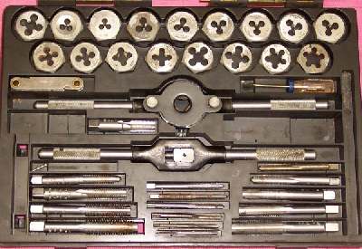

a tap is just a hardened screw with lengthwise channels cut in it for the shavings. as i mentioned, the male screws in wheel locks would have engaged matching tapped female ones. they would not have made individual screws with a file. they'd make a tap, then drill a hole, tap it and cut channels inside or drill holes partly overlapping the threaded hole to make a die. then harden it, and then make zillions of screws with the die, and tap zillions of holes with the tap, all closely matching & mating (till the taps & dies wore down, then they'd make new ones)
the spring bar latching one would be easier to make. they don't need to be particularly tight and immoveable to work as intended as long as they don't easily come off.
here's some we made earlier (my uncle was a master tool and die maker)

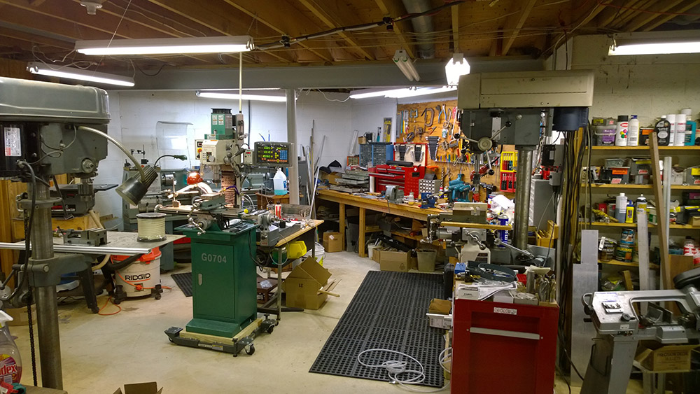

Same here. I have a lathe, plus other machine tools, in my basement - use them as great relaxation tool! I have cut internal threads, but only in fairly large diameter holes - 1/2" at least, for anything smaller I use taps.
Here's part of my basement. One of the challenges here is to make the part not look like it was made on a CNS mill. I have some experience making parts that look old for some restoration projects.

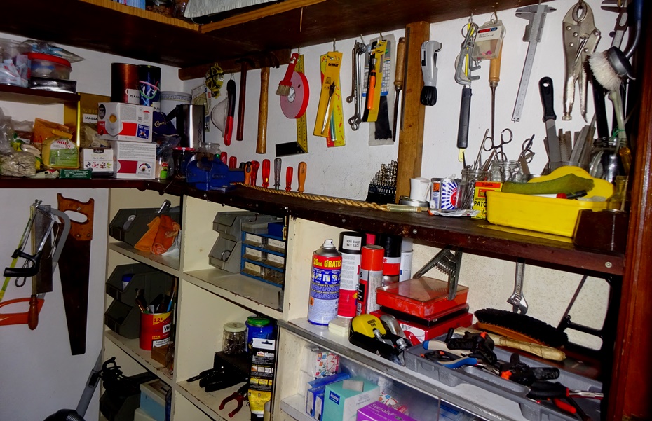

Rather huge and nice facility, that of yours. Mine is more on the space saving mode, cohabiting with groceries and other stuff .

Mine is smaller than Fernando's. the kitchen and dining room table are my work areas, hand tools hidden in closets and drawers wherever there is room. only powered tools are a dremel and a worksharp linisher. there is a 'man cave' workshop in the community centre just across the road from me i can use, they have some power tools, drill press, band and table saws, sanders, grindstone, etc. i'd prefer a lathe, milling machine, forge, power hammer and a real full sized slack belt sander/linisher.

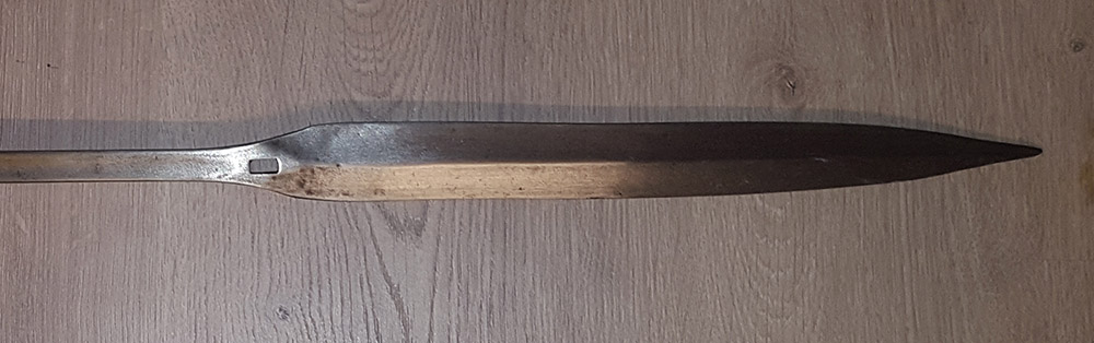

Can you show us your entire sword ... without the cross bar, of course ?
Old 14th December 2017, 07:26 PM   #29
Foxbat
Foxbat's Avatar
Join Date: Oct 2012
Posts: 69

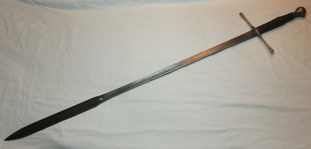

Here is the seller's picture, I don't have it yet, it is on its way.

Wow ... what an impressive beast !!!
