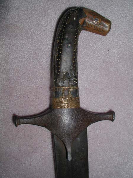

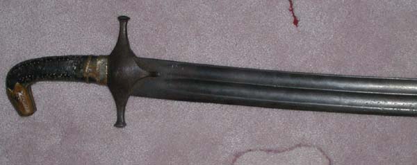

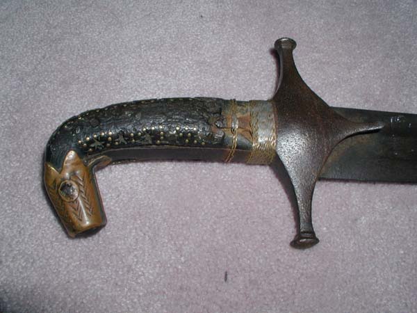

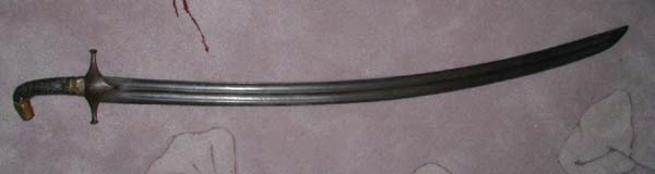

Hello all
Any comments on this. Bit tatty in the grip but all there and the blade is very tasty.
I love local auctions
Cheers
Andy

Is that intruders blood we can see on the carpet

A great, serious fighting sword, congratulations. To me, however, it seems Syrian rather than Turkish, and also I am not quite sure if "shamshir" would be an appropriate name for a fullered, slightly curved blade. But then, I do not know what else to call it as saif appears to be too generic of a term.
Teodor
Old 10th March 2006, 08:33 PM   #4
I fully agree with Teodore: Syrian. This is based on the down-turned pommel and wire covering the upper langet.
The blade , I think, is trade, Persian.
I have seen a lot of such swords, Syrian, Afghani etc and had the same question:this is not a shamshir in a strict sense , because it is not curved enough, but what should we call it? Yes, Saif is broad and generic, but I just cannot find another word.

The hilting certainly is Syrian type, though Dimashq or Damascus type would be more accurate since that was where most of these were done.
The blade, however, is not Persian work. It is either a European trade blade or a Caucasian copy thereof; Elgood addreses this specifically in his Arab arms book.
Ariel, as to terminology-- are you asking by what name the original (ostensibly) bedouin owner would call this sword, or how it should be categorized by English-speaking collectors in the present?

You may be right as to the origin of the blade. Markings would help a lot.
As to the name, I guess even the locals might have called it different, just to distinguish it from other types (as, for example, large kindjal in Georgia is
called Satevari etc). Also, is there any specific "European" name? I guess not, but just in case...

Well shamshir is what the auction house were selling it as but from their identification of various other pieces indicated, they knew absolutely nothing.
I have other shamshirs with much more curved blades, in what I consider the classic style but as you all say, this one doesn't really fit that.
Could be a European blade, has the build of one and its certainly heavy but I've checked and there are certainly no markings.
As regards the pommel, the way it comes back towards the guard, is that typical Syrian? Others I have seen seem more like a simple right angle.
What period would we guess this is?

No, its not blood on the carpet....intruders would be caught in the tiger traps in the garden, before they got that far

as all of you guys have said, this is a Syrian saif, not a turkish shamshir. The blade however, is most likely Hungarian. Ive seen hundreds of Syrian saifs, with Hungarian blades (marked hungary), like this one. There seems to have been some strong trade in blades from hungary to Damascus. Ive even seen one Nejdi Saif, on Hermann historica a few years ago, that had a signed a Hungarian blade.
EDIT: after looking at the pics closer, I think its more likely a local copy of a hungarian blade. The double fullers on hungary blades usually ended straight and uniformly towards the forte of the blade. This one however, is different. I may be wrong though.

The right angle is usually Persian, the acute (turn toward the blade) is usually Syrian , and the obtuse (away from the handle) South Arabian.

The style of this sword , with a baldric, is S.Arabian or Egyptian. I would still suggest the Syrian/Lebanese influence. The remark that it this sword is appropriate for dancing is hardly a compliment.
In general, the book on Arabian swords whence this illustration comes is, IMHO, pretty lousy: just a bunch of pretty pictures but nothing authoritatively academic. Some non-Islamic swords found its way into it, the terminology is incomprehensible (ie different jambiya blades and handles are listed with particular names without and explanation or justification )etc.

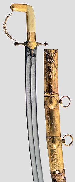

Thanks alot Jeff for that pic. As you can probably see, that sword has new fittings, but seems like its got an old Hungarian blade.
I also had many other pics of Syrian saifs with hungarian blades (they seem the most common type of non-persian trade blade), but I deleted them all.
This is another one, however its a "full" antique:

The last one is a Bedouin sword (Sinai, Negev, Transjordan).
They used any blade they could put their hands on...
I would be careful attributing any blade to Hungary without unequivocal evidence: inscriptions.

Jeff confirms what several have said; Elgood takes up this subject in some detail, more Forumites ought to consider it.
Don't recall whether it was in Elgood or elsewhere-- bedouins referred to a particular type of blade as majjar which certainly supports the contention that they distinguished Hungarian from among other blades. The word exists in Hungarian of course, as well as Turkish and I think passed thence into Arabic.
All manner of European blades were traded through the Porte, both Eastern European, Caucasian copies thereof, and others. I am not aware of any record of their being traded in Arabia directly by Hungarians.
As for the term Kurda I would argue that rather than deriving from the Huingarian for "sword," it is a variation on Gurda which as we know refers to Caucasian-made blades specifically.

There seems to be some insistance that there must be marks on this blade, so I have decided to attempt to clean it. Though it has a very deep and dark pattina, i'll just have to look and see what I can find.
I know who to blame
You say, durring this period, Syria was under Otterman rule. As I think I asked, what period are we talking about here?

Well the blade has been cleaned on one side, sympathetically and we have no markings. Otherside may yet reveal something but I dont think they are there.
Hoping Brian will come out of hiding for an opinion

i can humbley offer that i feel the blade is european and the pommel cap is a later addition. other than that, will happily agree with whats been said already.

These blades begin to appear in shashkas in the NW Caucasus in the mid-late 18th century, appear more commonly in all manner of Caucasian, Ottoman and Arab weapons by the mid 19th, and finally, appear in profusion in bedouin sabres by the early 20th-- therefore for purposes of this discussion they are probably best bounded between 1800-1900.
Eduard Wagner shows a number of such blades in Eastern European and Austro-Hungarian Empire mounts as early as the late 17th-early 18th century, though the earliest examples bear a far more pronounced (i.e. raised) backedge. The binding characteristic among them all is their distinctive fullering and what Wagner calls cabalistic markings. Stamped maker's marks or signatures begin to appear wth frequency at the forte and occasionally upon the tangs of these blades after 1850. Clauberg was a big producer, as was Knecht, whose mark was a close helmet. Both were German, so far as the term defines them, not Hungarian, though originally it is from Hungary that the form derives, and to Poland where so many were locally mounted.
Fullscale export from Europe to the MidEast, Caucasus, etc. via the Porte (i.e. Istanbul) probably began to occur about the 1850s, though the form was definitely popular in the Ottoman sphere from at least a century before. Caucasian "copy" export production probably began a decade or two later-- a classic reaction to the popularity of an imported luxury product which was available through a single source, in short supply and therefore pricey. The village of Amuzgh in Daghestan was especially well-known for a broad range of blade types. These were intended to pass as Euopean, hence were not locally maker-marked, in fact it is probable that the increase in marked blades out of Europe in the late 19th century was in reaction to these Caucasian copies.

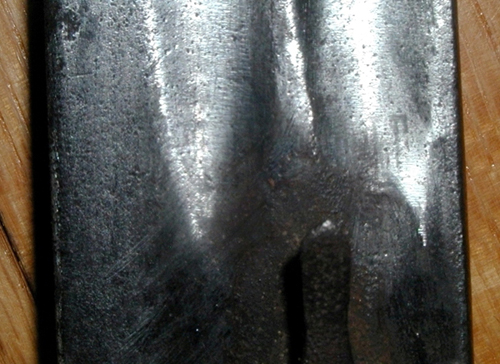

Well, I have to confess my surprise!
I cleaned the one side of the blade and nothing and then wonderd if I could be botherd to do the other side, especially as pattina was nice and there didnt appear to be anything underneath.
But then I did, just to balance the thing out and I've found something.
The photo really is as good as it gets, so a full word is unreadable but its clearly a block capital European text. Very shallow and worn away but its there.
So I guess, it certainly is Hungarian trade blade. Well done
I'm now wondering whats under the pattina of all my other swords!!! as this certainly wouldnt have shown up without the serious cleaning.
Cheers
Andy
