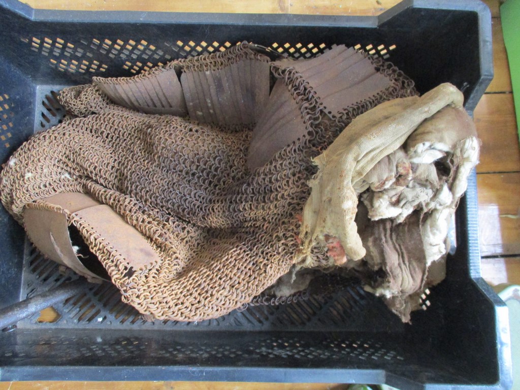

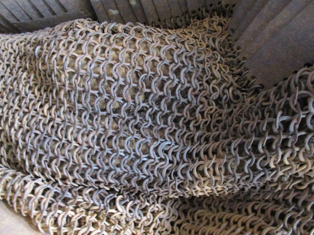

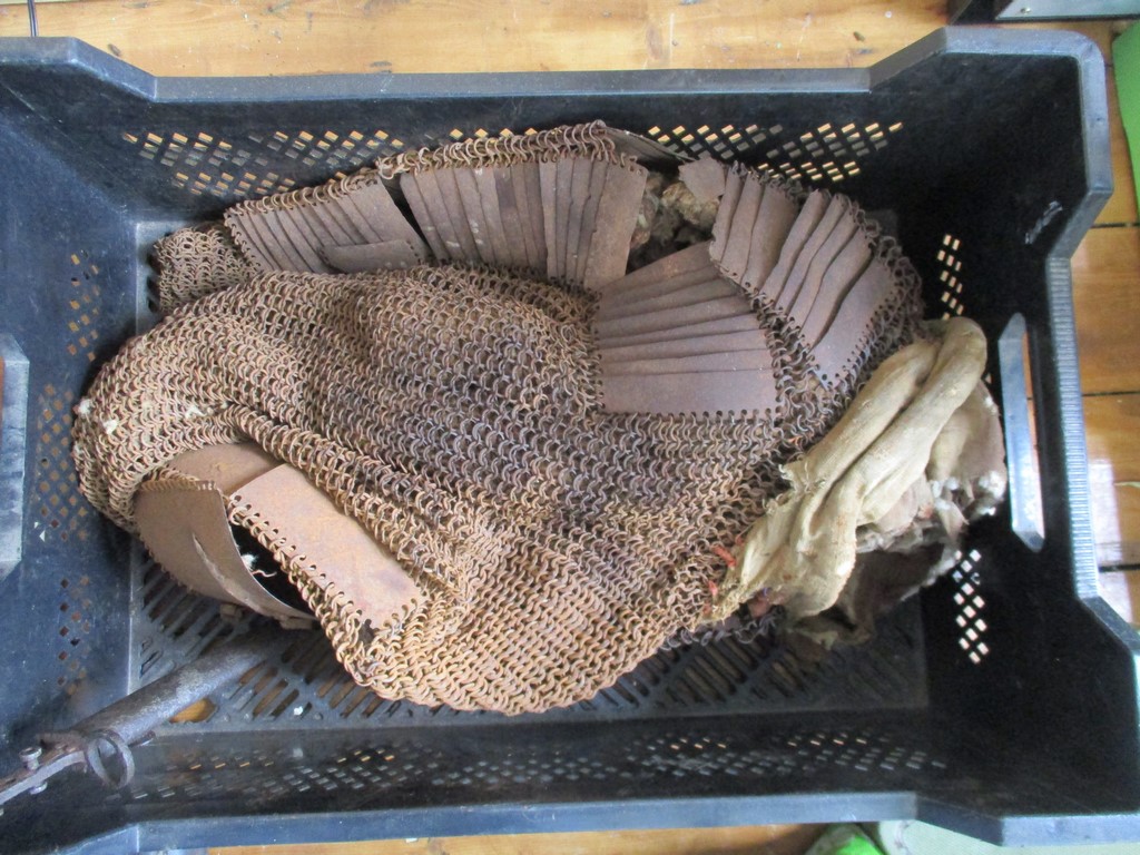

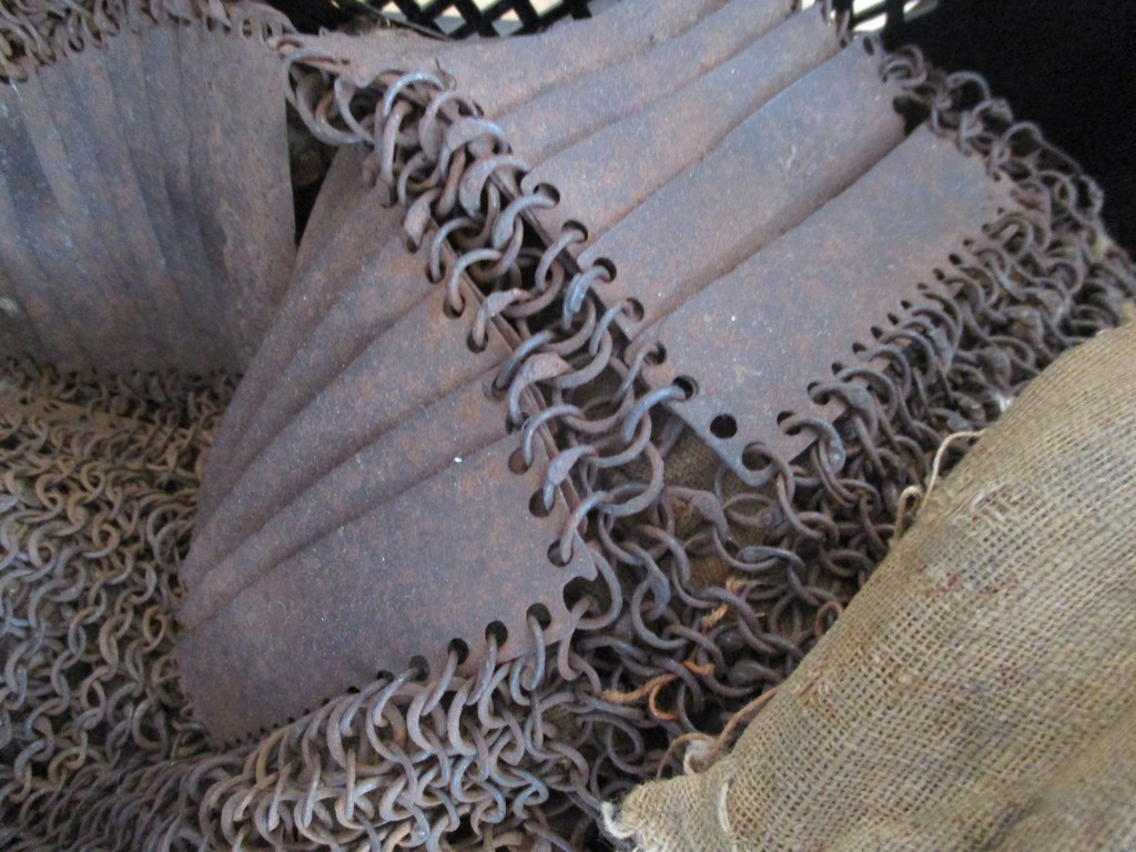

I have a potentially nice full coat of Indian riveted chain mail with most of its kapok padded liner intact . It is rusty but perfectly sound . I would like to both conserve it and enhance its appearance for display. Do any members have any tips ?

basically it is dirty with an ingrained layer of old brown rust powder and dirt .When that is rubbed off the appearance is so much better ... but how to do this on such a scale and should I be using wax or oil , soft cloth or abrasives or what ?
