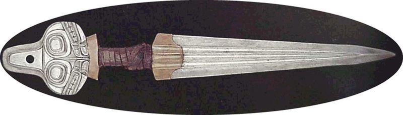

Thank you Boedhi Adhitya for reminding everyone that terrestial iron is considered very magickal in keris making, probably as much if not more so than meteorite. In fact, iron is a material that has been considered very powerful and magickal by cultures all around the world for a very long time.
Thanks also for the link to the article on Innuit meteorite blades. Isn't it nice that when Perry discovered the source of their iron that he set out to steal it all.
I did not mean to imply in my earlier response to Pusaka that 70% or even pure meteoric blades were not possible to forge, just that i doubted deeply that you would find such a make-up in a keris. I have seen such blades before, including this marvelous blade below. It is apparently in the hands of Harold Jacobs, an Alaskan native American. He states that it was one of 2 blades made from a fall near Klukwan many generations ago by a man names Khu ch'eesh. It is 27" long.

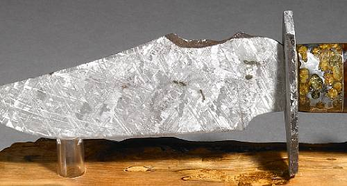

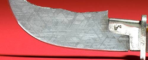

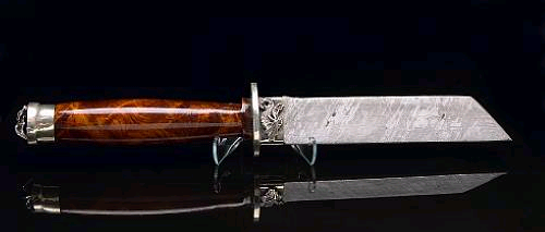

Old 27th December 2011, 03:30 AM   #50
HERE ARE 3 EXAMPLES OF KNIVES WHERE THE BLADES ARE MADE FROM A SLAB OF NATURAL UNFORGED METEORITE. THEY ARE JUST SHAPED AND POLISHED MECHANICALY. TWO ARE FROM THE GIBEON METEORITE AND PART OF THE OUTER SURFACE OF THE METEORITE WAS LAFT NATURAL UNWORKED OR POLISHED. I HAVE NO IDEA HOW THIS TYPE OF BLADE WOULD HOLD UP, BRITTLE, NOT TAKEING OR HOLDING A GOOD EDGE
AT ANY RATE THIS DOES SHOW METEORITES COULD HAVE BEEN WORKED USING PRIMATIVE METHODS SO A OLD UNFORGED METEORITE BLADE IS NOT OUT OF THE QUESTION.

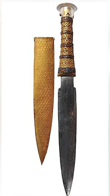

Old 2nd June 2016, 07:46 PM   #51
I JUST RAN ACROSS A CURRENT ARTICLE ON ONE OF THE DAGGERS FOUND IN KING TUTS TOMB. THEY ARE SAYING THE IRON BLADE IS LIKELY MADE FROM A IRON NICKEL METEORITE. A PICTURE OF THE DAGGER.
A link to above:
http://onlinelibrary.wiley.com/doi/1...aps.12664/full
I was surprised that the authors of the paper seemed unaware of the use of meteoric iron in the Indonesian culture.
Old 3rd June 2016, 03:50 AM   #53
Posts: 7,287
Originally Posted by Bob A
A link to above:
I don't think it is so much a matter of being unaware of meteoric use in Indonesia as much as that their focus is more on the use of that material by ancient peoples.
The remarkable thing about this dagger is that it was created at least a century before the acknowledged start of the Iron Age and many centuries before edged weapons were commonly made of iron.
