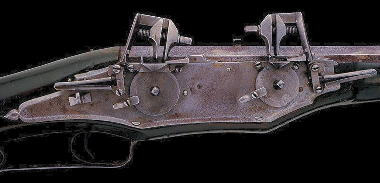

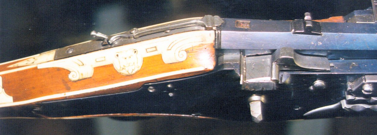

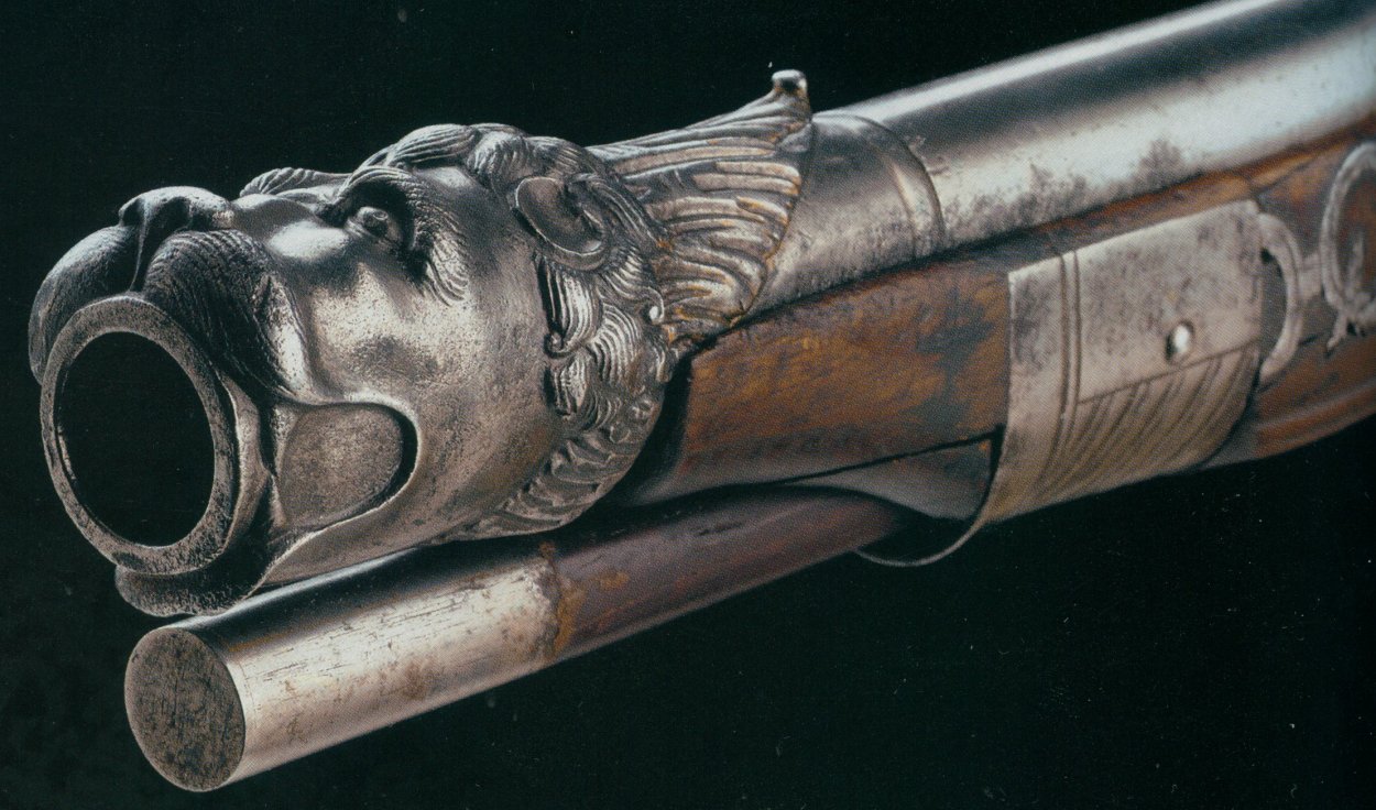

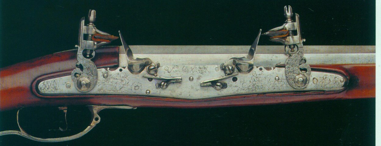

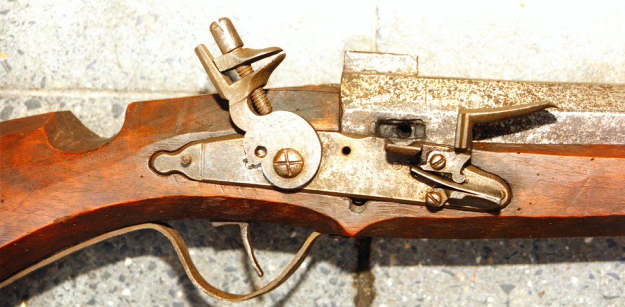

I couldn't find to much information on superimposed firearms on this forum, so i hope i am not repetetive
Not to much information from my side for the moment, only pictures i want to share. Hopefully this will spark some discussion

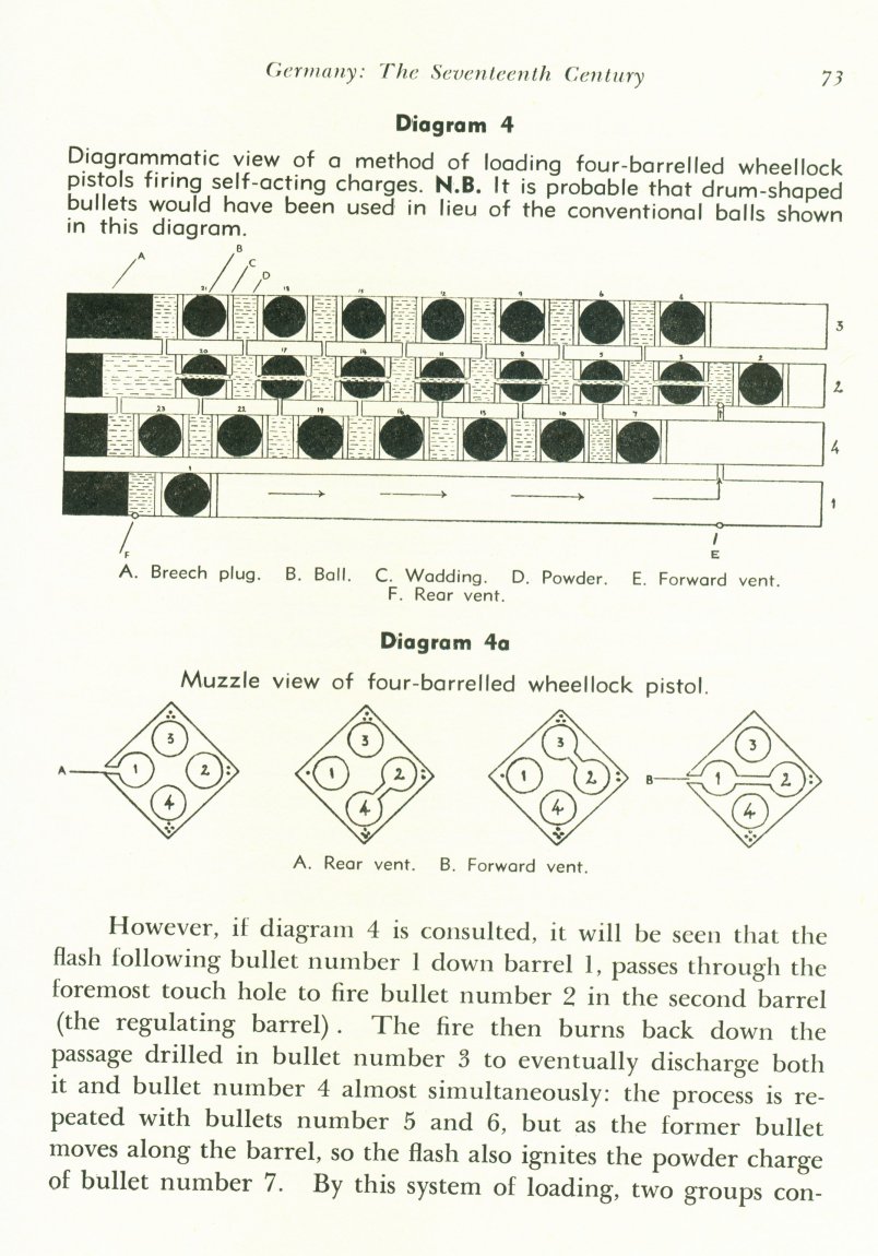

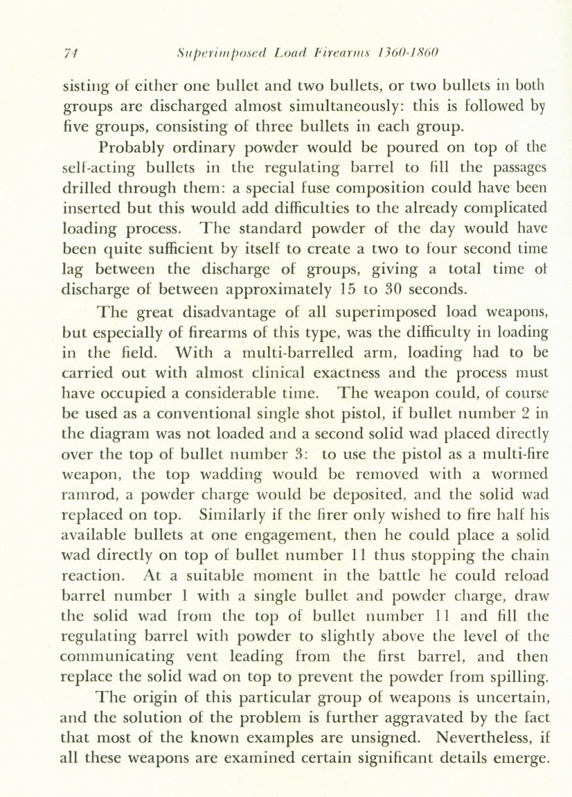

Attached please find a scheme of the superimposed load principle of a four-barreled mid-17th c. wheellock carbine, from D.R. Baxter, 1966.

Just to say that I think that the two arms of the beginning of the thread, are not superimposed loads, but two guns (barrel)
Fernando K

Although I did not author this thread: exactly, Fernando K, thanks!
Of course these are locks from over-and-under-barrel guns, not from superimposed-load firearms.
Marcus?

correct again, ouch not a good day for me.

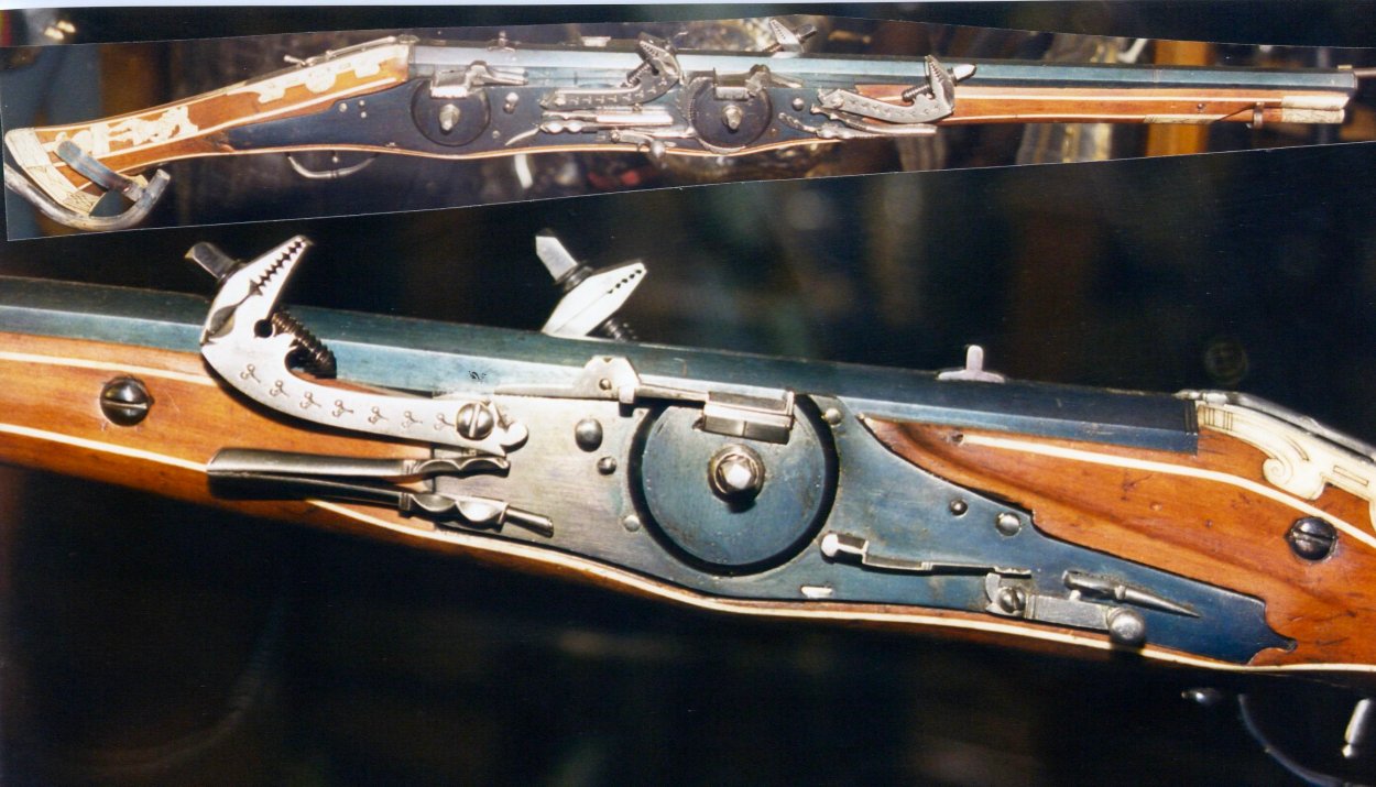

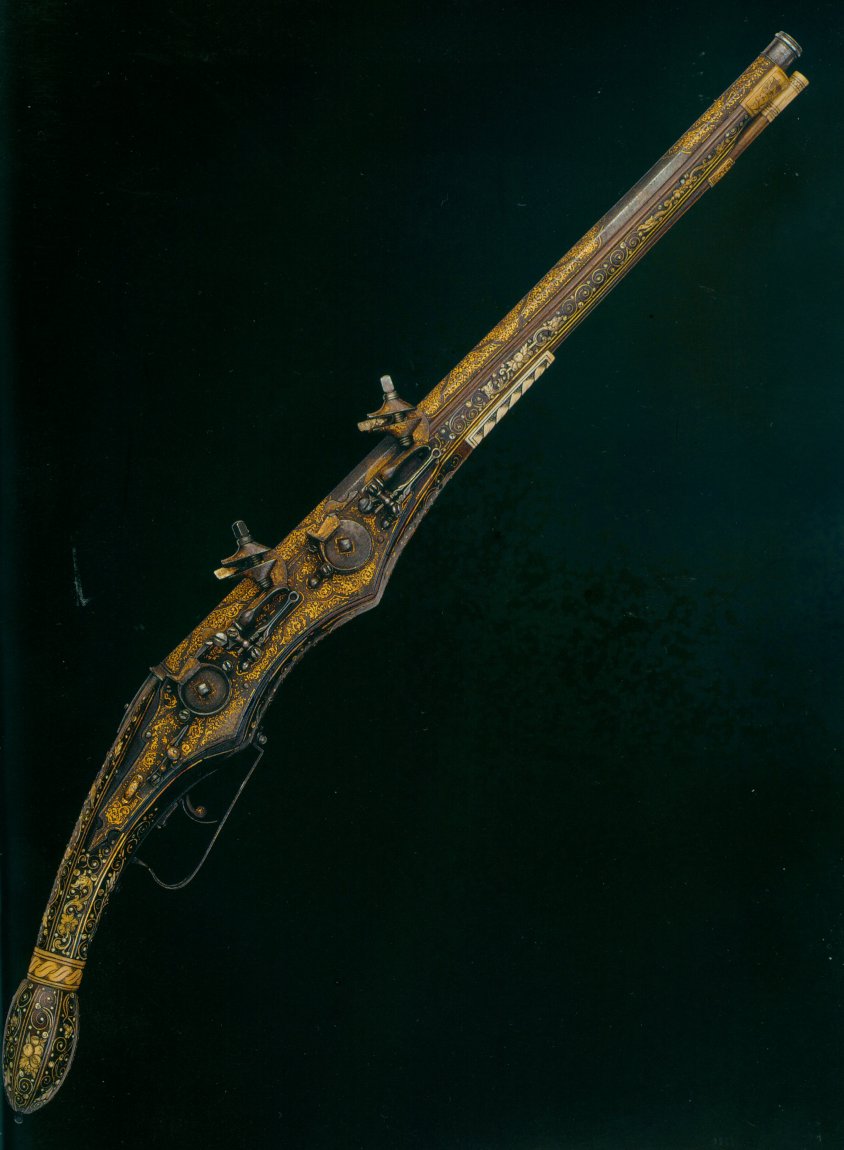

quit right indeed, especially since manpower was very cheap and even a "simple" farmer in a feudalistic society would have been able to shoot with the same accuracy as the pistol with the superimposed load (train of bullets / "roman candle" ).

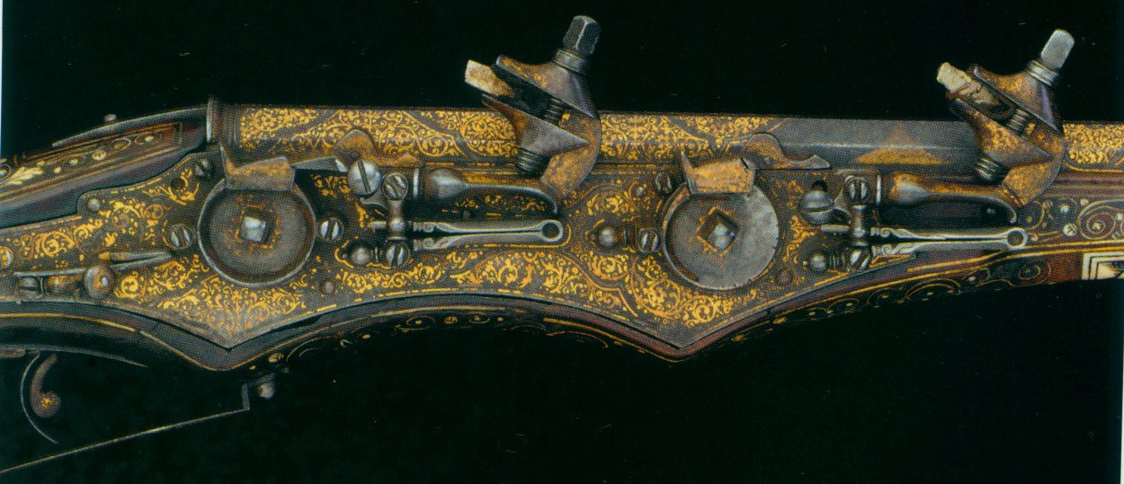

Some other pictures than, quit a neat pistol, but horribly imbalanced i think (book: wheel lock firarms of the royal armouries, Craeme Rimmer, page 25)

Some twenty years ago, I handled another triple-shot superimposed-load wheellock pistol from that same series by the very same maker, preserved in as-new condition and retaining all its original bluing, in the world-famous Habsburg Collection in Vienna, while the museum was closed to the public.
It was rather ill-balanced but please remember that these actually were arquebuses and were always held with two hands, with the buttstock touching the cheek!
The date assigned by Graeme is exactly correct: ca. 1555, most probably Augsburg.

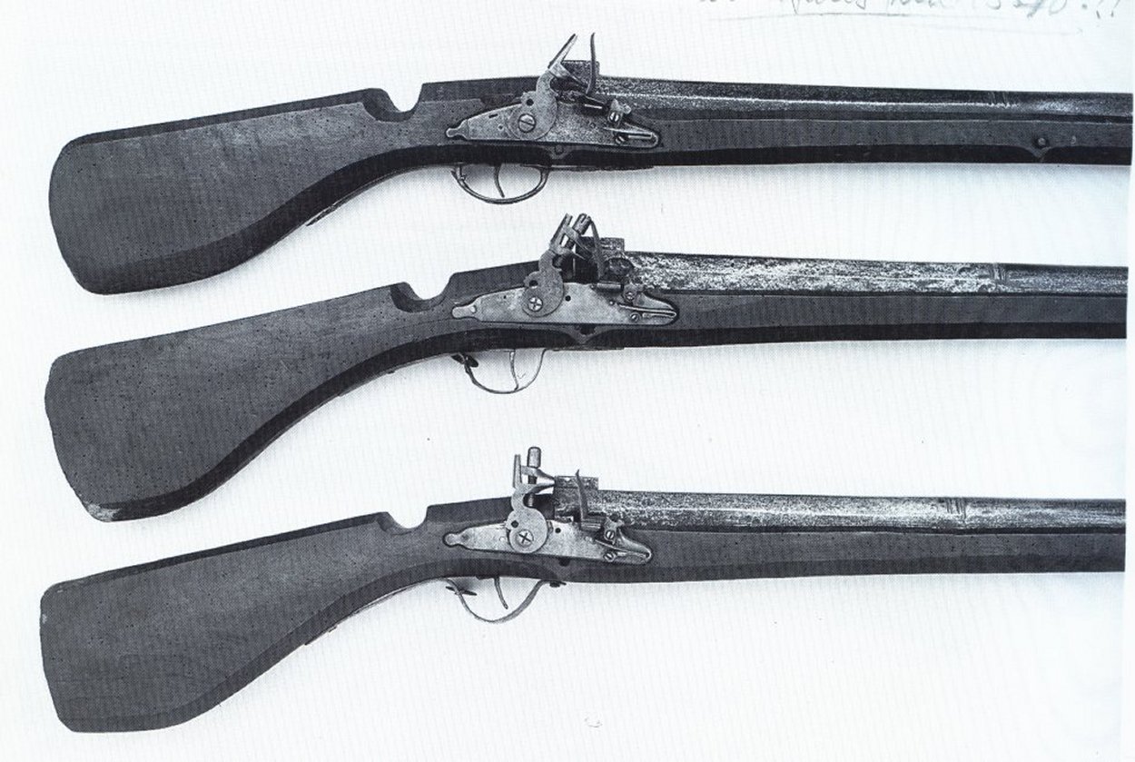

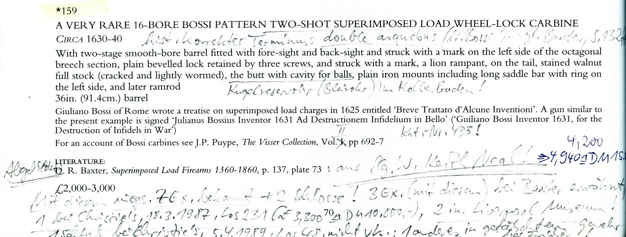

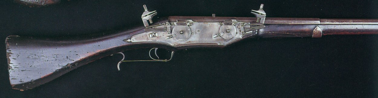

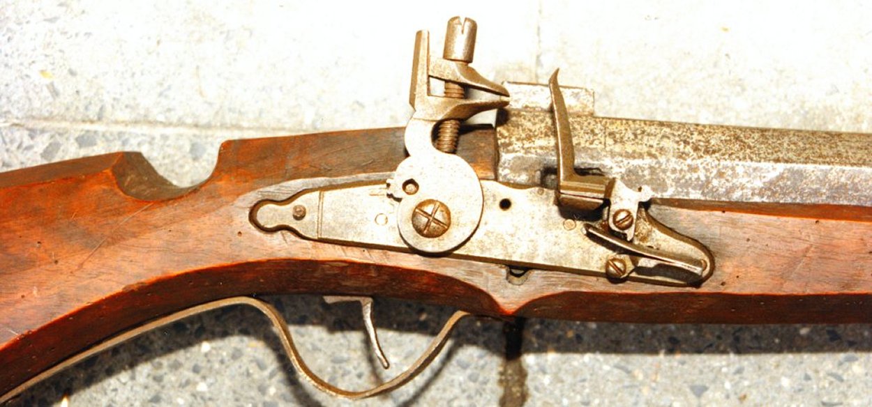

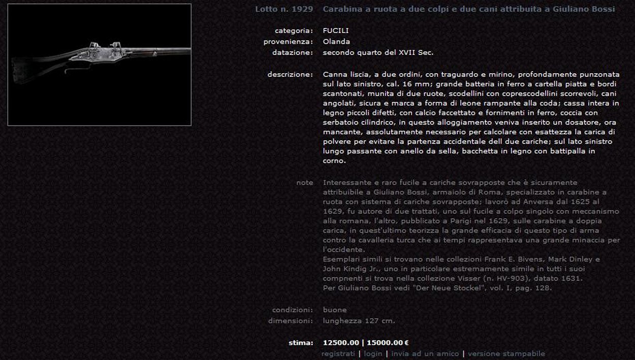

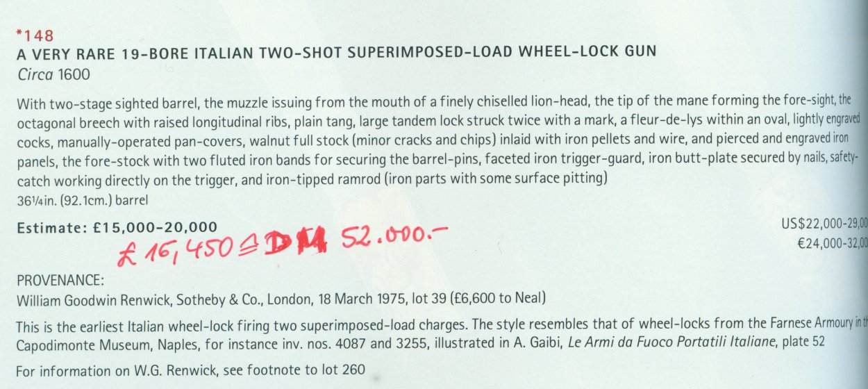

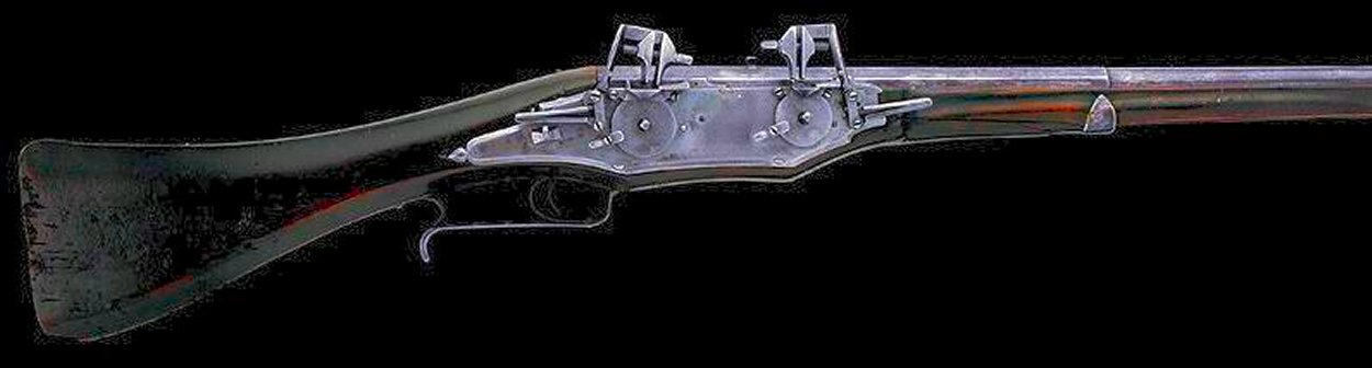

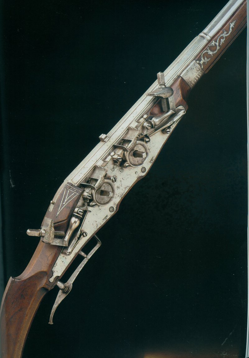

I would like to add that the inside of the first detached wheellock mechanism posted by Marcus in this thread is for a ca. 1630 North Italian two-shot superimposed-load military carbine on the Bossi system.

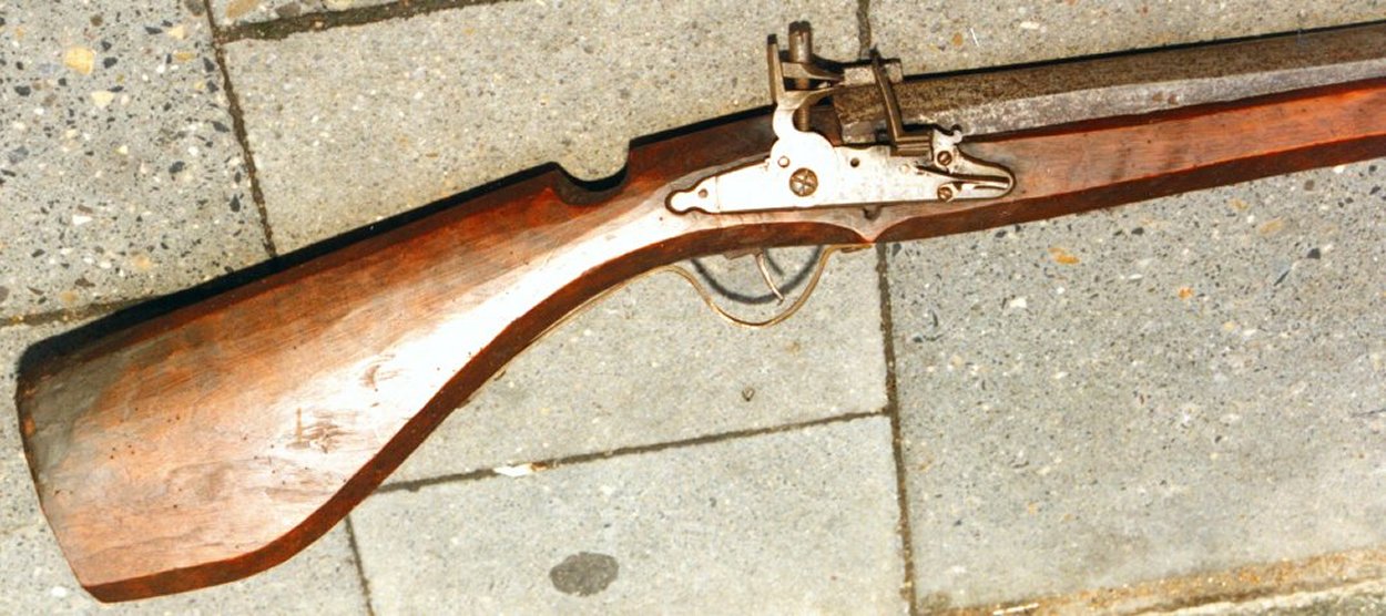

I attached images of a Bossi carbine, formerly in the W. Keith Neal colln., from a Czerny's sales catalogue, and of three other superimposed-load wheellock guns from the W. Keith Neal colln., Christie's. Please mind that the flintlock musket, French, ca. 1640, obviously has severe working problems in both its locks as the cocks are not in the correct upright position for half-cock but they lean forward too much so that each flint actually touches the steel instead of standing clear off it!

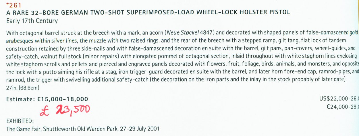

And the description to the ca. 1640 flintlock superimposed-load musket.
m

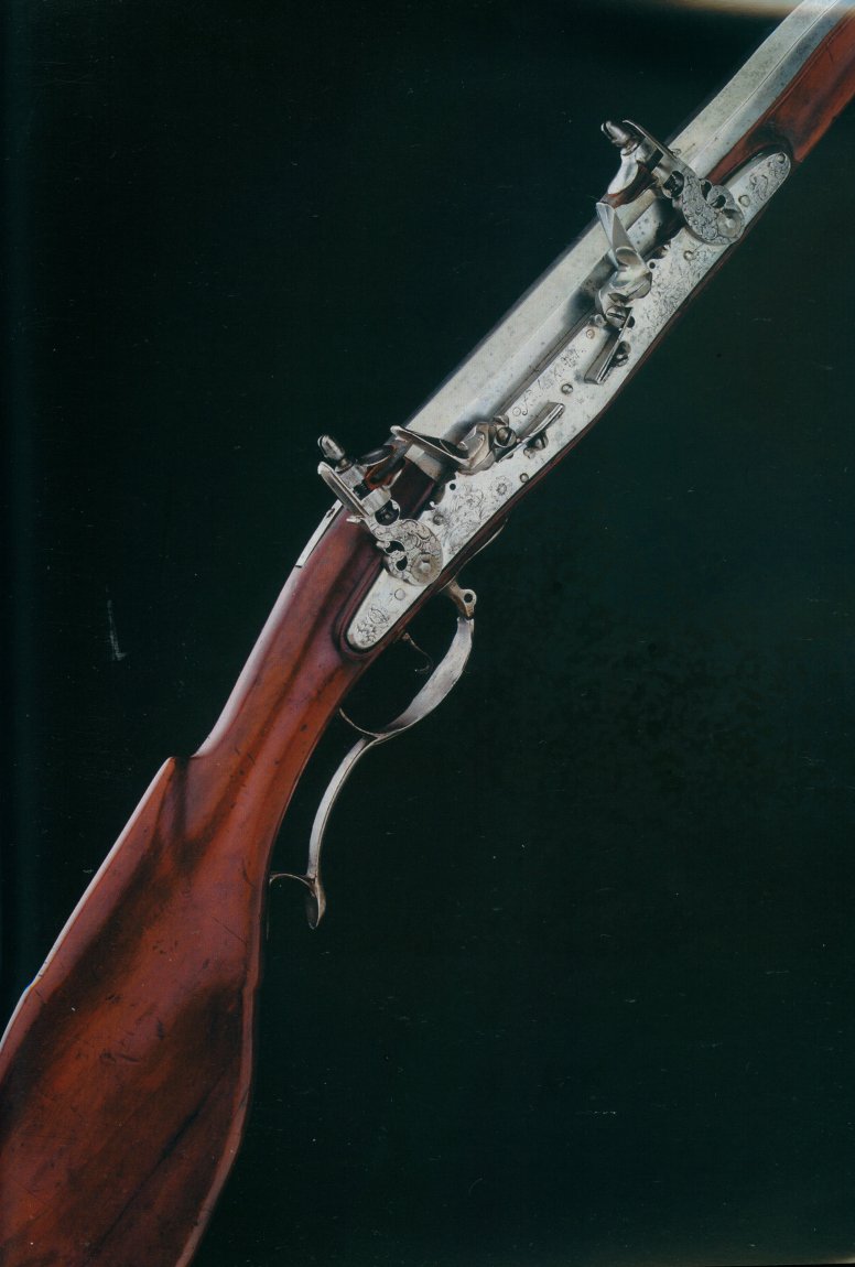

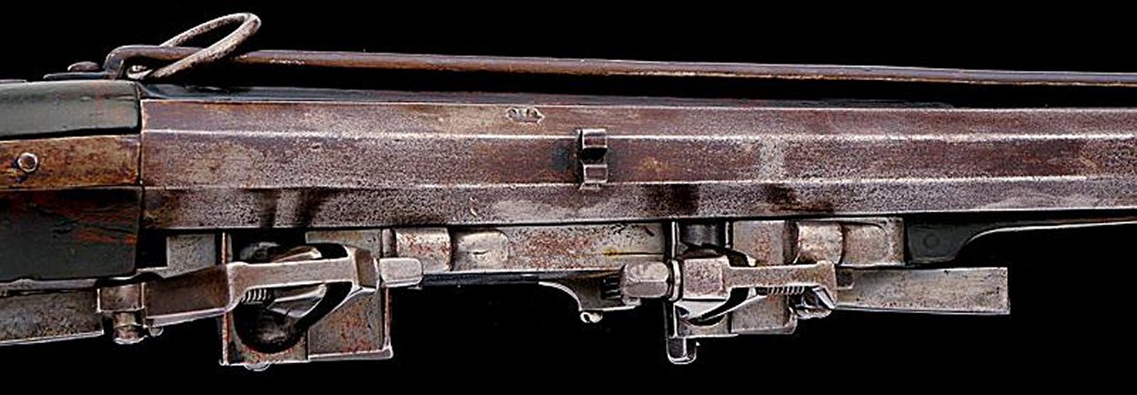

Another image of the fine military carbine on the double-shot superimposed-load Giuliano Bossi system, sold from the W. Keith Neal colln., Christie's, 12 Dec 1997.
It fetched 15,000 Deutsche Mark, auction fees included.

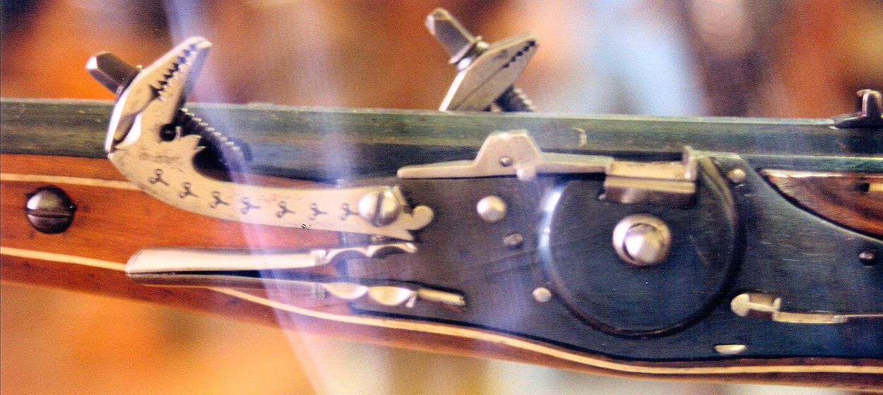

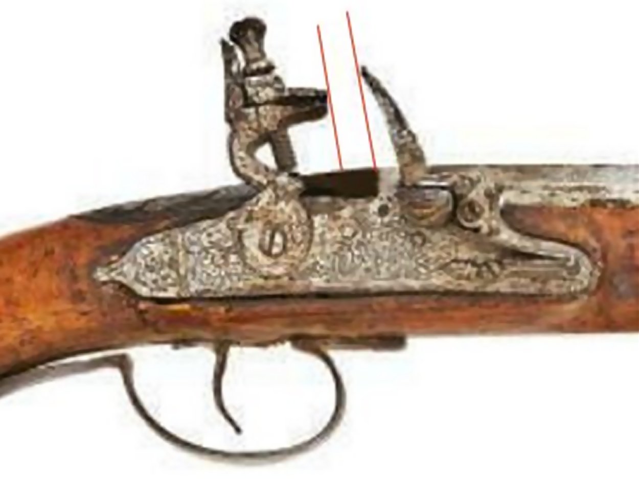

Just an aside concerning the last picture attached in post #10:

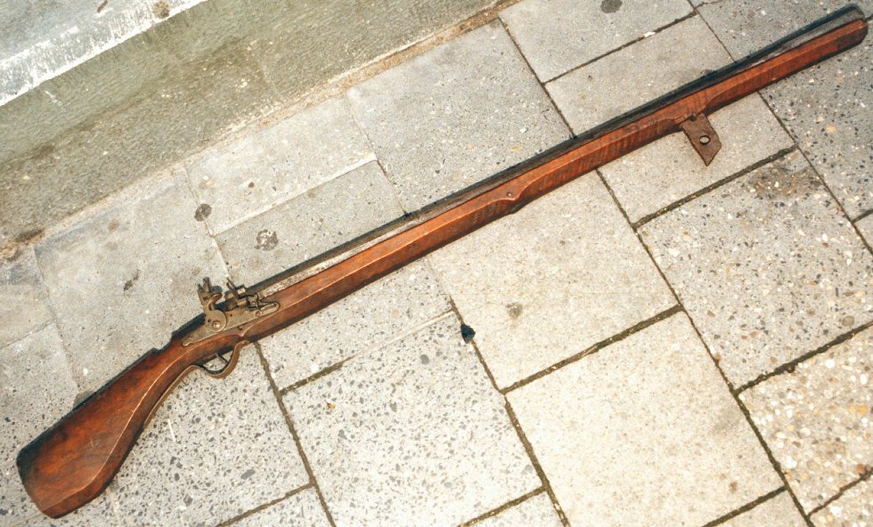

The cock and steel of this ca. 1655-60 flintlock carbine are absolutely in the correct angle for mid-17th c. half-cock position demonstrating the malfunction of the superimposed-load flintlock gun in the above post (repeated here)!
m
m
And another instance of a ca. 1645 Westfalian flintlock haquebut (wallgun), the barrel about 100 years earlier, ca. 1540, the cock and steel (frizzen) in the absolutely correct position for half- and full-cock.
From Christie's Schloss Dyck museum sale, part I, April 15, 1992, lot 48. I bought it at Christie's sale and for about ten years, it stayed in my collection.

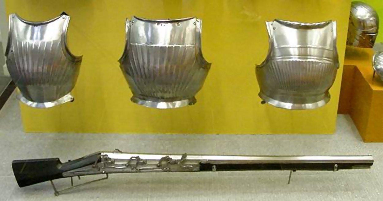

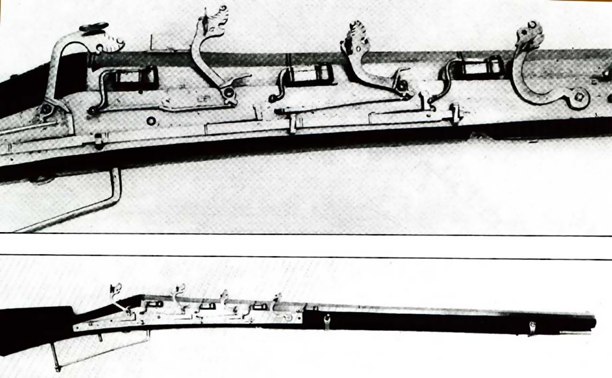

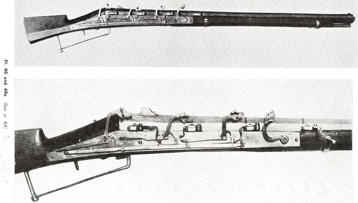

Default A Four-Shot Superimposed-Load Military Matchlock Musket, ca. 1600-20
In the Koninklijk Leger Museum (Army Museum Brussels).
Please note the fact that - as is the case with many unusual and experimental guns! - all the serpentines are shaped and work differently! While three of them are snapping matchlocks and are released by the small, short trigger, the forward serpentine that initiates the first (topmost) shot is activated by the long tiller trigger that actually acts as a guard for the small trigger.

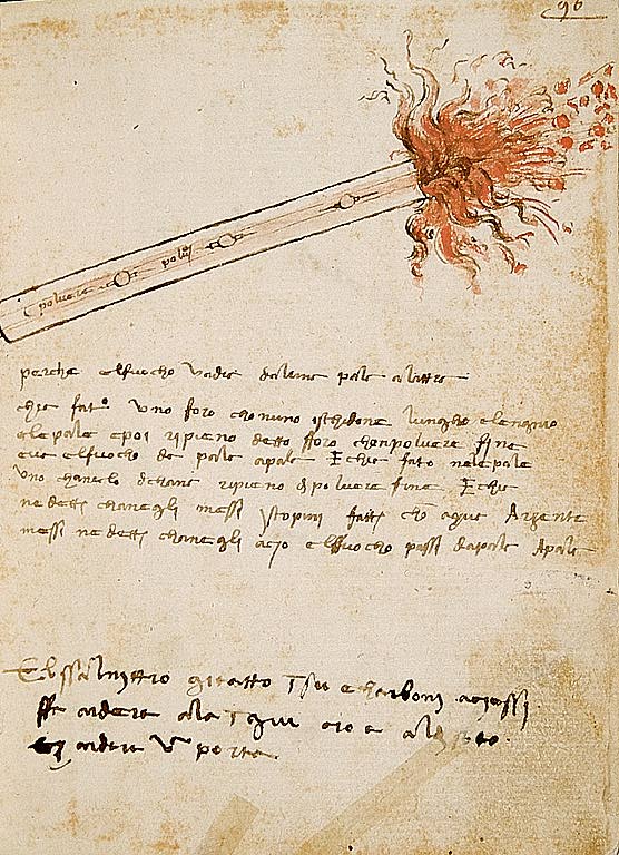

Superimposed charge drawn by Ghiberti Bonaccorso (about 1500 year)

Great catch, Alexander.
