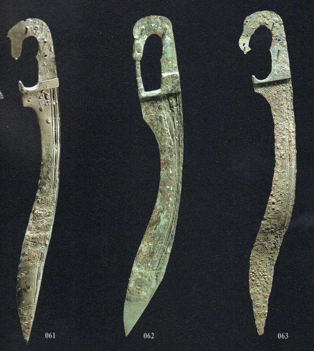

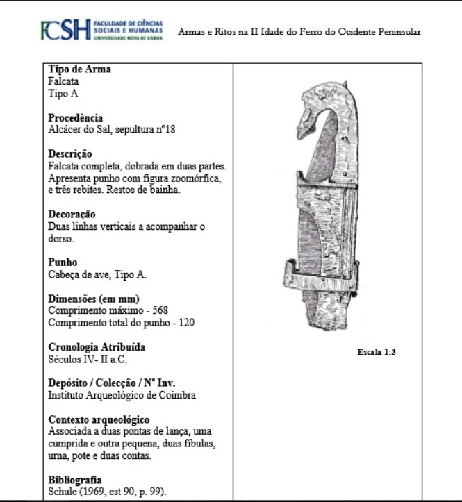

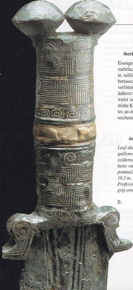

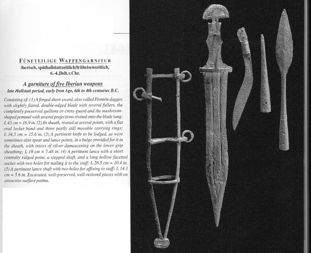

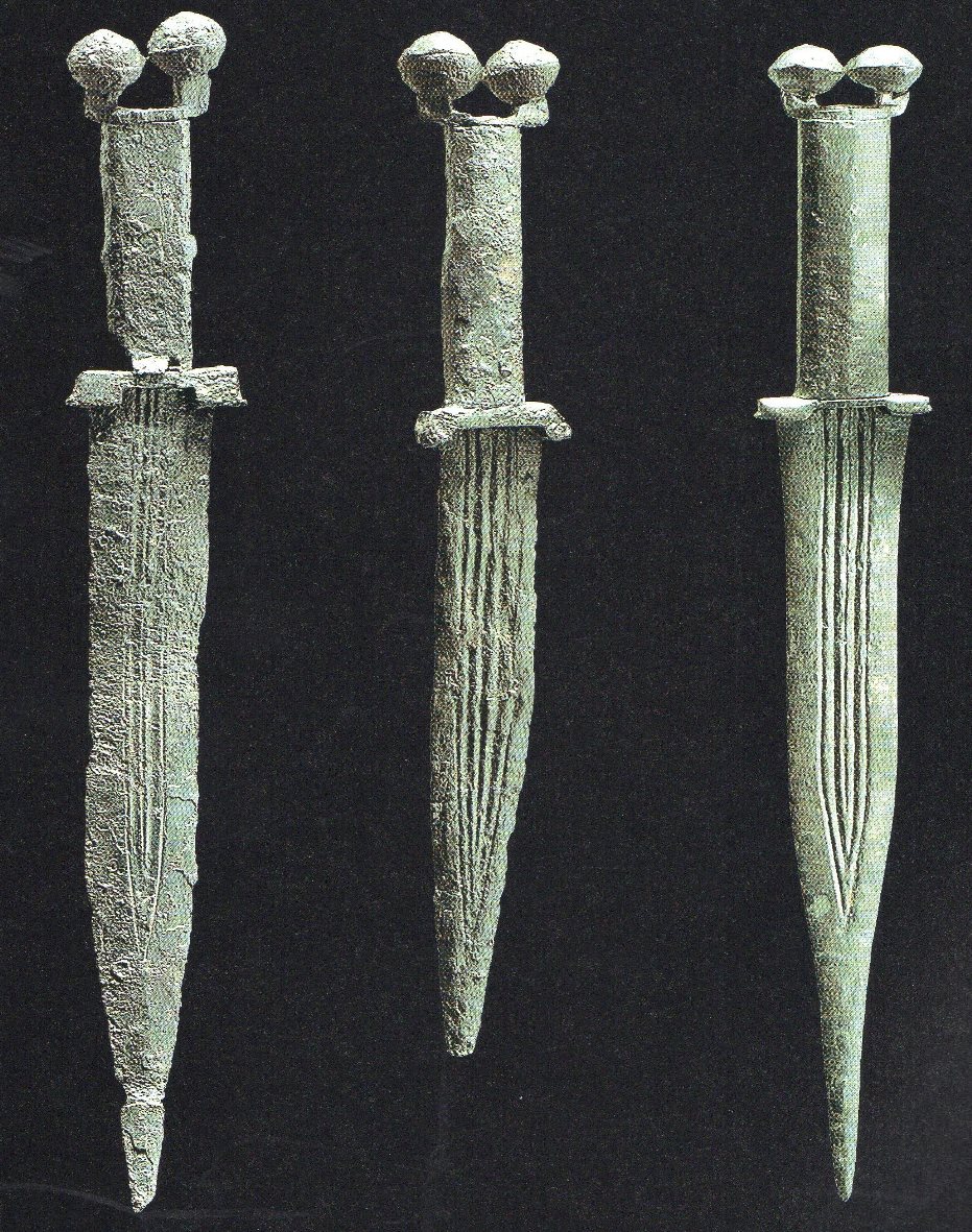

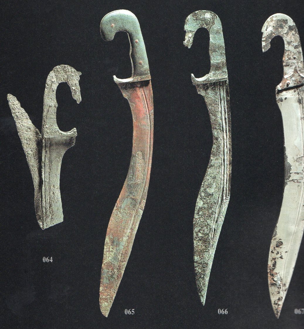

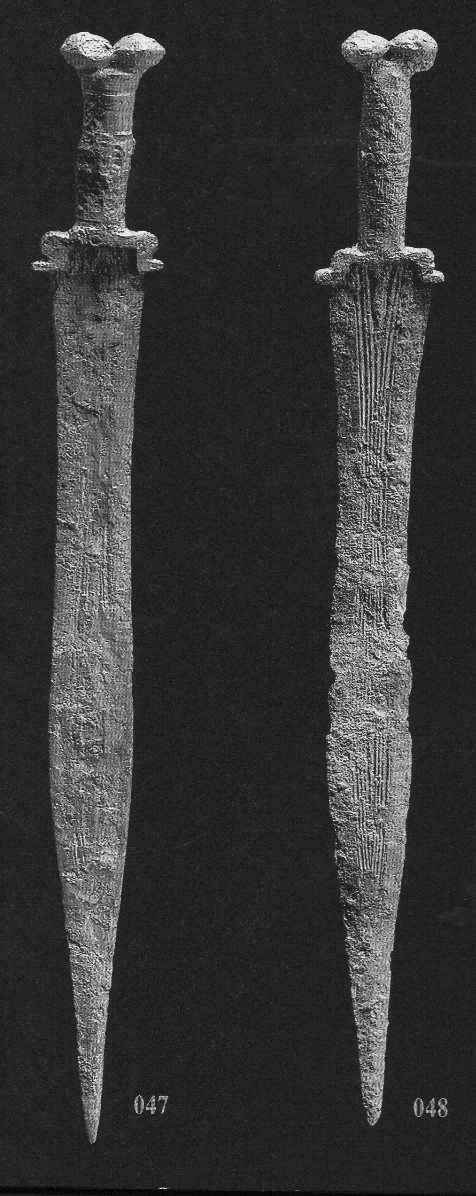

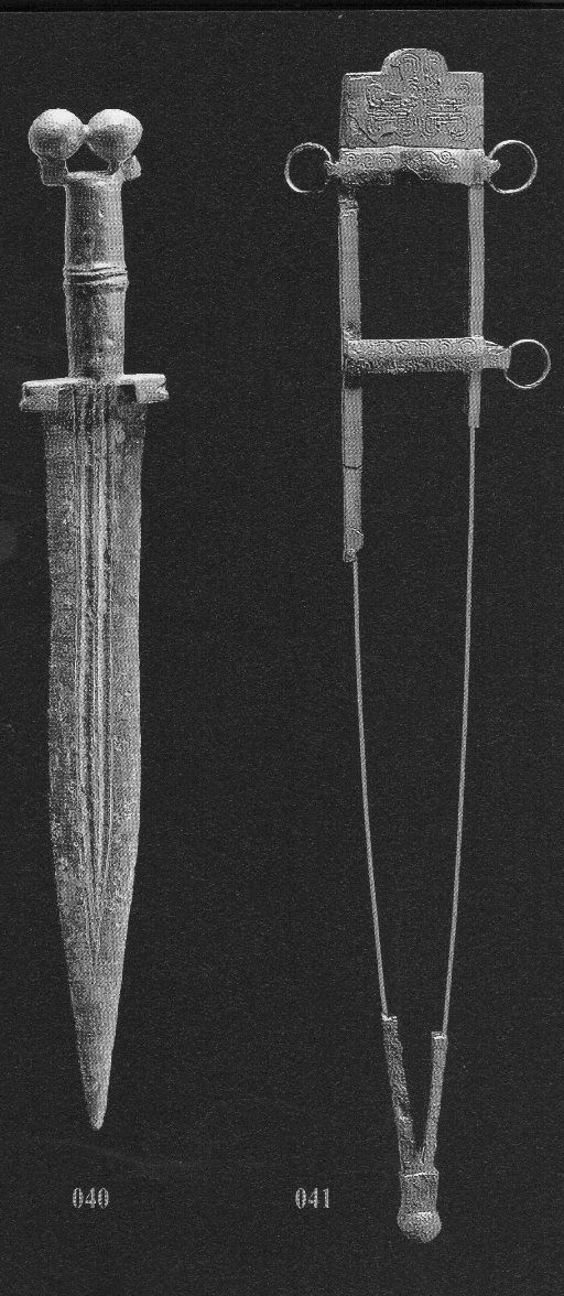

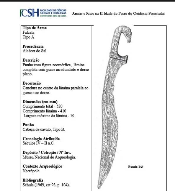

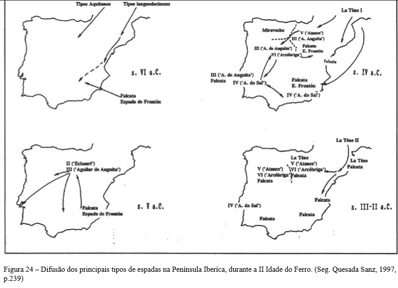

For those who care for these things and didn't have a chance to appreciate them as they were dispersed in 'less topic' threads and posts, i thought i would upload here a series of images on these Iberian swords, scanned from a catalogue held in 2003 by Hermann Historica for the special auction of the impressive Axel Guttman collection; with an introduction included. The collection in auction was a vast one from this period; i am just concentrating on swords... so far.
Note that Falcata #064 has its blade intentionally bent, a ritual used to bury the deceased weapons in his tomb..

Quesada Sans pretends that the first version of Falcata ( the Fronton type) arose in the South of the Peninsula (actual Spain) by the 6th-5th century BC, while by the 4th century BC large parts of the Peninsula were 'flooded' with Falcatas. This is consistent with countless findings, which extended to mid South Portuguese Alcacer do Sal, one of the largest amount of La Tene and Falcatas found, not in the open, but in a necropolis context.

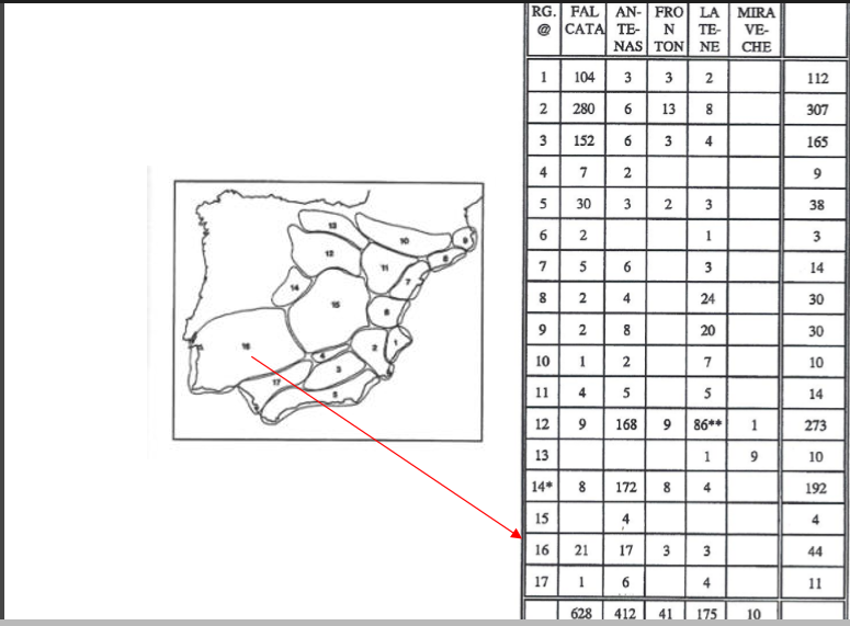

Where are located the older findings?
Follow the charts ... which you are aware of several .
Then again, I know the charts, I only wanted to set the problem in a way I considered an organized manner to develop the following exposition, which I planned to make in later posts for further discussion. My words were a sort of preamble. I also wanted to share some discoveries I made about the machaira and its presence in Central Asia, not as a Greek weapon. Maybe I choose the wrong way.

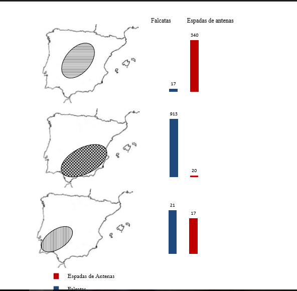

Iberians and Celts were a different people yes, to a certain extent and timeline. Isn't it said that the Celts not only coexisted but also mixed with the Iberos in the Central Meseta, reason for the appearing of Celtiberos, a thing different from Iberian Celts. But ...didn't all these peoples miscigenate ? No surprise if the Iberians (also) handled swords of Celtic Hallstatt tradition while the Celtiberos (also) had falcatized swords ?
While not a surprise that the ratio of falcatas found in the Southern part of the Peninsula versus other swords is overwhelming (98%) it is nevertheless symptomatic that in the (now Portuguese) West Coast, necropolis findings denoted a slightly majority of falcatas versus La Tene antena swords.
