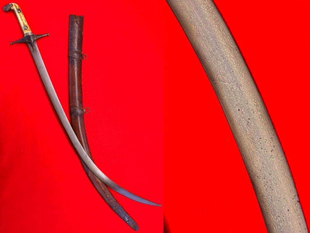

OH NO !!!! Estcrh, I am so sorry this happened. That is a beautiful sword!!!
It seems like this always happens to the valuable items. I would be flaming angry. @#$%^&* As mentioned above, it looks like someone either lowered the forks from a forklift unto it, or backed over it.

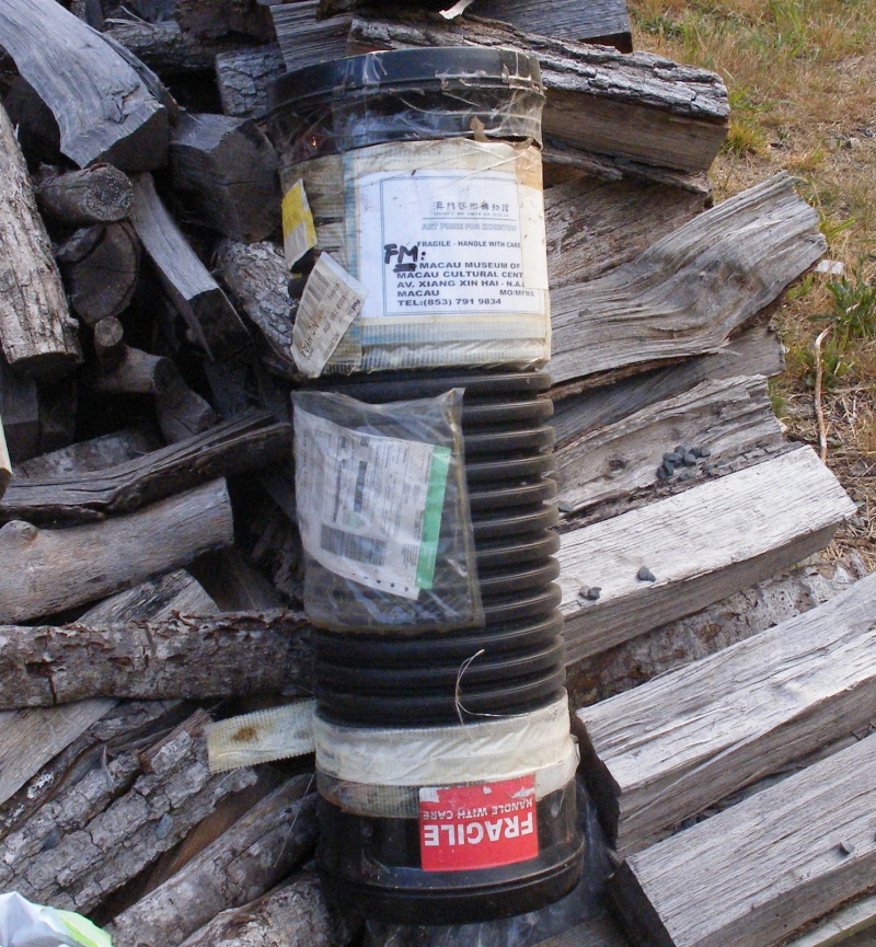

Historically, I've had good success with USPS. I had only one incident with a Balkan made pistol with a silver stock. It arrived with the grip area severly bent and a small crack in the bend area. But the damage was primarily due to the worst boxing and packing I've ever seen. Especially for an item like this. And this from a gun dealer, who should know better. I decided to keep the pistol - but - with 70% of what I paid for it refunded to me. Fortunately, between my old gunsmith and his Fater in Law, who was a genuine old time Silversmith, it was repaired masterfully. Cannot detect the repair.
Generally, double-wall boxes with lots of bubble wrap will work. But I use everything from PVC pipe to pine wood crates, depending on what I'm shipping.

That tip with the plastic pipe is very good. With smaller diameterpipes i trsnsport my fishing rods in the plane.

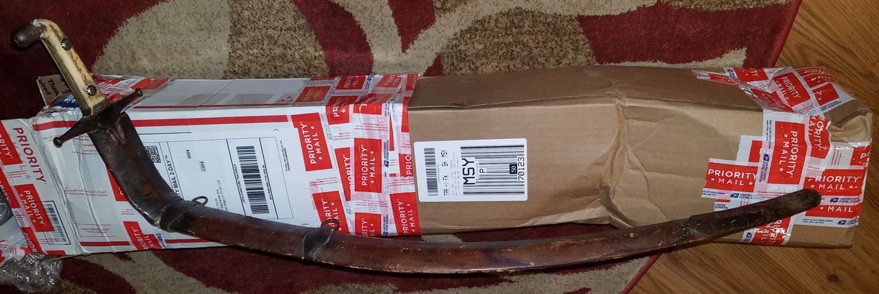

Sorry to see the shipping tragedy. It reminds me of a similar USPS incident I had a couple years ago when I bought a pole arm from a respected forum member.
Note before:
Old 17th July 2017, 04:38 PM   #12
Nathaniel
Nathaniel's Avatar
Posts: 865
And imagine my shock and horror when the postal worker brought this out to the counter for me to sign for!!! I told the postal worker are you serious you want me to sign for this!?!? And they just shrugged and said my best bet was to fill out a damage claim form Luckily this was fully insured! But still would have rather had a straight pole arm! Because the post paid the claim USPS keeps the pole arm!

Originally Posted by Nathaniel
And image that sinking feeling when the postal worker brought this out to the counter for me to sign for!!!
Nathaniel, thanks for posting your pictures, I know exactly how you feel, even though I will get the money I paid returned it hurts to see this happen to any antique. The damage to your naginata looks just like what happened to my shamshir.
