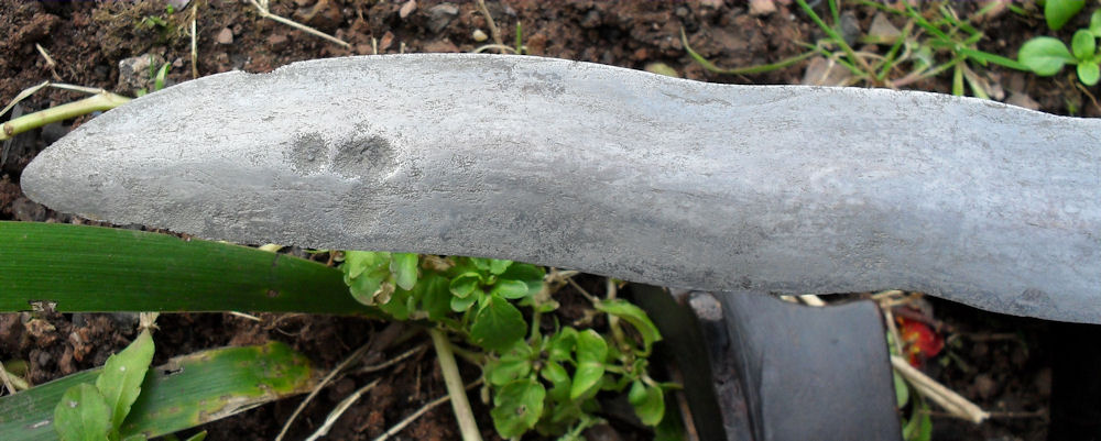

I've tried it by wetting my hand and very quickly punching my finger tip into a paper thin strip of red hot iron. You can get an indentation like this. I did it a few times and I burnt myself once. I reckon a smith with hardened hands could probably squeeze a similar paper thin piece of iron between his finger tips.
I have seen a dukun (shaman) kissing the cutting edge of a small red hot pedang , which left half moon marks on the blade edge. I felt at the time I was watching stage magic.

Richard, I recognise you as an experienced smith, however, I have indented red hot, not orange, iron with the tip of my middle finger.
The material was paper thin, which is the thickness of a sombro blade, paper thin, not one sixteenth, nor anything like it.
I had a tray of sand on the anvil, I kept my right hand in water until the iron was directly over the sand and as close as it could be without touching, then I punched my finger tip into the hot iron as fast as I could. I tried this a few times, and I burnt myself once, the burn was not severe, but that was the last time I tried it.
What I've described can be done, but you need to move very fast.
I understand exactly what you are saying, and I was not forming metal, the metal I hit with my finger tip was paper thin.
As to forming metal with bare hands, my feeling is the same as yours, but I've seen some very strange and totally inexplicable things in Jawa and Bali. Maybe it is a possibility, but not for me, and not for you.

Richard, you're 100% correct about never being able to see it.Keris pijit that are accepted as genuine all come from the very distant past.
I've seen genuine things in Jawa that are totally inexplicable, not parlour tricks, but manifestations of powers that cannot be explained with reason, nor logic.
Bear this in mind:- by profession, I'm an auditor. Not a bean counting auditor, but an auditor who deals in areas involving subterfuge, confidence tricks, and other rather interesting things. By nature I'm a sceptic, and better than 50 years in my profession has made me even more sceptical.
Knowing Javanese culture as I do, I am prepared to accept that keris picit could have in some cases been made in a similar way to the way I experimented with. The ones that we accept as genuine are in all cases paper thin sombros, or similar.
I do not believe that it would be possible to actually forge a blade by finger pressure, or by hitting with the hand. I see this as the mixture of myth and reality that is perfectly normal in Jawa. It may be culturally real, but that does not make it fact.
The empus of the distant past were akin to shamans.
They were in some cases, nothing like the current crop of people who can make keris.
Rick:- yes, of course, and the vast bulk of "keris pijit" are the result of coming into contact with something like a ball pein hammer. But there are a very few that we do accept as most probably real.
However, nobody needs to believe that they're real. Its all a matter of how you measure something based upon experience.

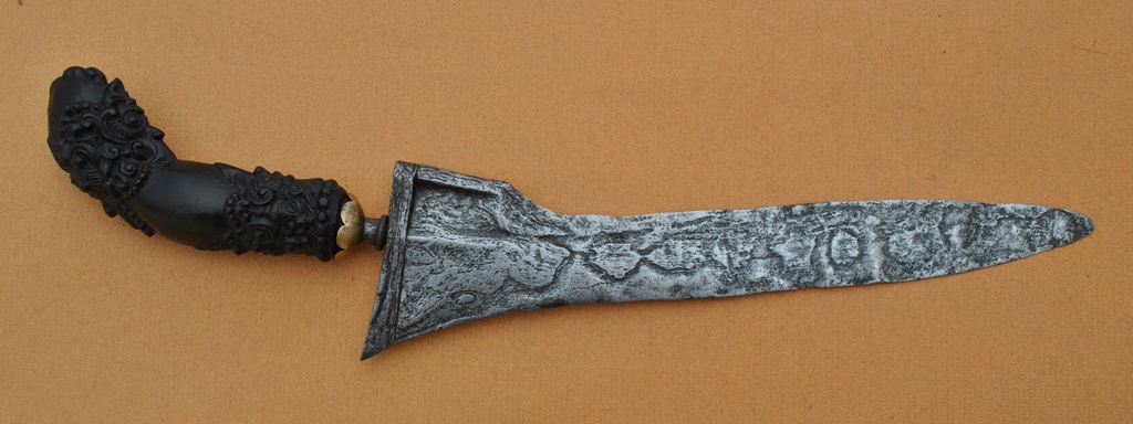

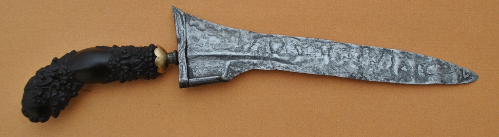

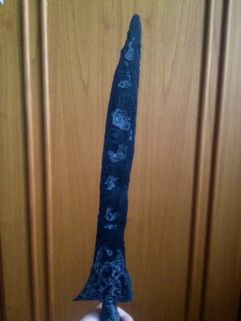

IN THE KRIS MYSTIC WEAPON OF THE MALAY WORLD BY EDWARD FREY PAGE 10 ARE SOME PICTURES OF FIGURE D AND FIGURE E. THEY MAY BE EXAMPLES OF THIS TECKNIQUE BOTH ARE ARCHAIC KERIS.
I INCLUDE TWO PICTURES OF THE MORO KRIS BLADE THAT GAVE ME THE IDEA OF ASKING IF THERE WAS ANY KNOWLEGE OF THIS TECKNIQUE / STORY APPLYING TO ANY OTHER WEAPONS BESIDES THE KERIS. THESE MAY BE PITS BUT THEY APPEAR TOO UNIFORM AND THE REMAINDER OF THE BLADE LOOKS CLEAN . I WAITED TO USE THE PICTURES UNTIL THE TRANSACTION WAS FINISHED IN THE SWAP FORUM.
FROM WHAT HAS BEEN SAID BY THOSE OF YOU WHO HAVE FORGED AND EVEN ATTEMPTED THIS TECKNIQUE IT WOULD APPEAR LIKELY A TOOL IS USED PERHAPS SHAPED LIKE A FINGER. IT DOES MAKE ONE WONDER WHEN THE STORY CAME INTO BEING.

Posts: 7,218
Barry, i saw this kris up for sale, but never for a second thought these indentations were formed at the forging. Their placement does not give that impression. I would be more likely to buy into a story of possible damage from bullets before i would think the former.
As for the possibility of this technique being possible with the fingers i have little doubt, though obviously many examples that we see are not done that way.

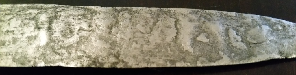

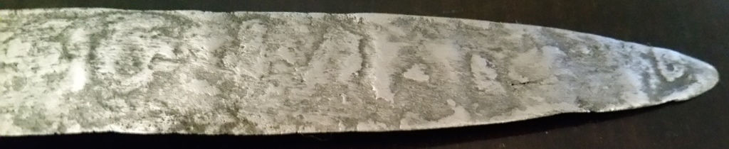

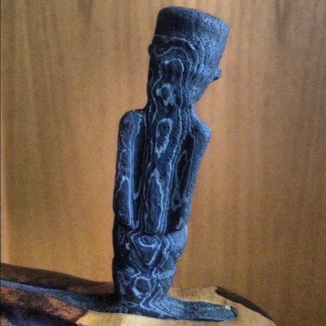

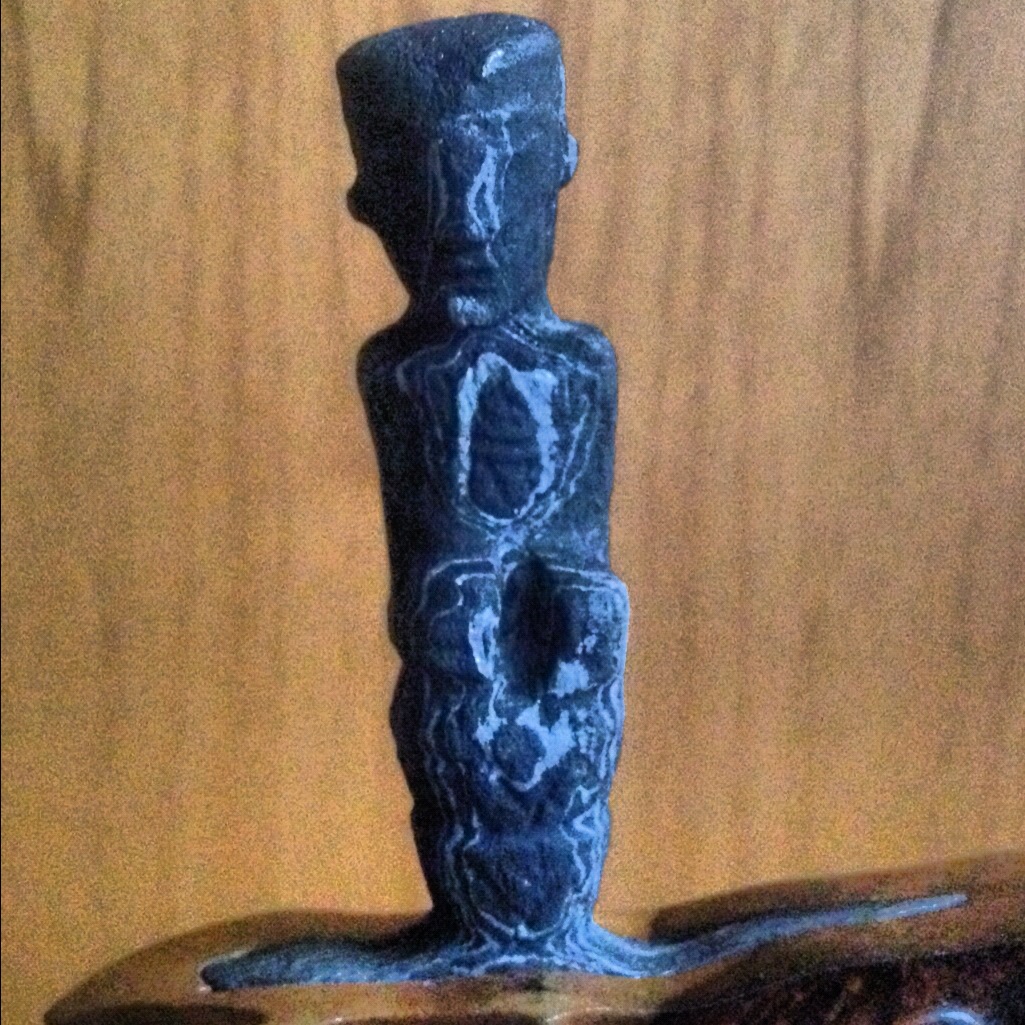

Genuine paper thin blades with finger pressure markings or what we call Sombro nowadays should have 9 finger pressure marking, no more no less. Most of blades are supposed as tangguh Segaluh and Pajajaran have 9 luk, I myself do not know why should be 9, Anybody know about it? I share some photos of keris Puthut with 9 finger pressure markings. Indentation from pressure markings occured on every pamor wulan-wulan and also Puthut figure seems very artistic, it was as though the pamor gives the detail appearance of Puthut itself.
Karttikeya is offline   Reply With Quote
Interesting keris Karttikeya. I am somewhat confused by you use of terminology. I have never heard this type of keris called "puthut". AFAIK that term is reserved for keris where the figure is at the gandik, not the hilt. I would probably call this a keris sajen or perhaps simply a talismanic keris. Also, AFAIK, not all keris Sombro display pijit, finger indentations. They also do not have an integral figural iron hilt like your example. I am also confused about your claim that "genuine" keris pijit all have 9 indentation marks. I have at least two examples which i would consider to be genuine. One is a what i know as a keris puthut, the other is what i know as a keris Sombro. The Puthut has 5 indentations, the Sombro has 3. I cannot see the indentations on the photo of your example due to the angle of your shot. I have a hard time, though, picturing 9 indentations on what are generally very short blades.

Well Karttikeya, that's something new I've learnt!
I rather think a lot of people don't know this information.

David,
I understand your confusion. In the old days this kind of keris would be called "keris sajen" or "keris majapahit", but I reckon recently a new terminology arise and call it as "puthut sajen" or "puthut" in sort, due to it's figural, one piece handle. Another term is "puthut cundrik" to call this kind of keris with dhapur cundrik (a kind of pedhang suduk shape). Sometimes it's confused with sombro.
An 'old school boy' like you may get "lost in terminology" nowdays in Java keris world

You're right about current keris terminology. One highly respected Solo empu, now retired, remarked to me a couple of years ago:- "where do they get all these names from? I've never heard of them!"
It is absolutely certain that the new generation of Javanese keris fanciers have been busy producing their own lexicon for some time now. If the people I learnt from in the 1970's and 1980's were still alive, they would be just as confused as many of us older people are.

So if the above type of keris is nowadays referred to as Puthut Sajen, so be it. I am curious what the actual meaning of the word "puthut" is. Can anyone assist there. I have always understood it as a praying figure while i have looked upon the sajen hilts as ancestral figures, which may or may not be the same thing.
Still, i am doubtful that even the current keris world in Jawa would call Karttikeya's keris a Sombro, would they? And i still question that a keris pijit need have 9 indentations to be considered genuine.

As to bullets..remarkable that this blade would have been hit six times and on both sides of the blade...and with no telegraphing of the dent to the opposite side (concave being met with convex..as happens with hail damage to automobiles and all the sheet metal I have in the shop)
As to fingers making those impressions....the spirit is strong, but the flesh is oh so weak.
Vandoo,
Is the patterned pamor nestled into these "finger print" depressions on that blade and not on the opposing side? I would assume this to be the case.
Ric
Ric, perhaps my sarcasm didn't come through well enough here. When i wrote "I would be more likely to believe..." i meant to imply that i didn't really believe that explanation either, but that it simply seemed more plausible than the former. But both explanations seem implausible to me and these marks appear to be damaged sustained at some point after forging and completely unintentional.

A puthut--- or putut--- is a disciple, or servant, or pupil of a holy man. The word exists in Old Javanese. Since the function of a puthut was to protect his teacher, the meaning on a keris blade can be interpreted as protective. However, it does appear to be a later motif, attached to the keris after Islam.
But "puthut" is just the name, and the name may not really indicate the source of inspiration for inclusion. Most keris terminology is comprised of euphemisms, like a lot of belief systems, there is public knowledge and then levels of hidden knowledge.
The number of indentations on a keris pejet that most people will accept as genuine can vary, some people will hold the belief that it can only be a specific number of indentations, placed in a specific way, and this seems to vary depending upon what group of keris fanciers one is aligned with.
The prime identifier for a keris sombro is the eye at the tip of the tang. The legend that goes with this is that she --- Sombro was a woman --- would make a number of blades, string them around her waist, and walk from village to village selling them. She was the daughter of Manca, the grand-daughter Marcukunda, and the great grand-daughter of Kajadsari --- according to Pangeran Wijil.

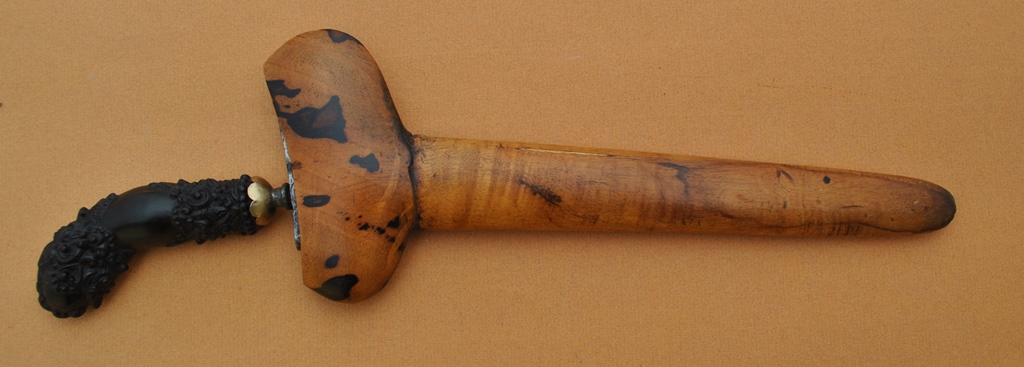

[QUOTE=A. G. Maisey]
In Jawa there are consistent legends about forging a blade by use of hands alone. I think these are legends, but the legend comes close to reality with the talismanic keris pijit, usually these are keris sombro with paper thin blades and they show indentations where supposedly they have been squeezed and indented by finger pressure.
Alan, I am curious to know if you would consider this keris as pijit. The blade is very thin and flexible towards the point. You can see indentations on both sides.
Dominique is offline   Reply With Quote
Old 19th May 2017, 07:25 PM   #26
Posts: 7,218
[QUOTE=Dominique]
Interesting subject.
Dominique, that is an interesting keris. And i very much like the hilt.
A keris picit (pijit, pecit, whatever spelling ) is so-called based upon what appear to be impressions of finger tip in the blade. You say there are indentations on both sides of this blade, but honestly i cannot see them in these photographs. maybe Alan's eyes are better than mine.
Maybe you could try a different angle for your shot. The high-relief pamor pattern on this blade does not make it easy to assess indentations if they are there.

I know, it doesn't look like finger tips, but there are slight indentations, the blade is not flat. I would need to make a pic of the blade profile.
I like the hilt too

Sorry Dominique, from the pics I cannot tell whether I'm looking at a possible KP or not.

Difficult to make good picture, but you might see with these pictures that the blade is slightly ondulated.

Posts: 6,339
Can we see the blade photographed edge on to see how it looks with that view?
