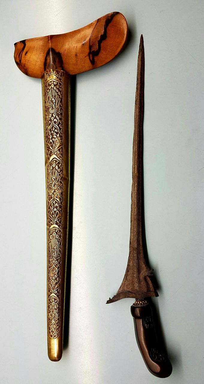

Good day everybody!
May I please ask you for your opinion for this Jogja keris?
Thx
Arjuna

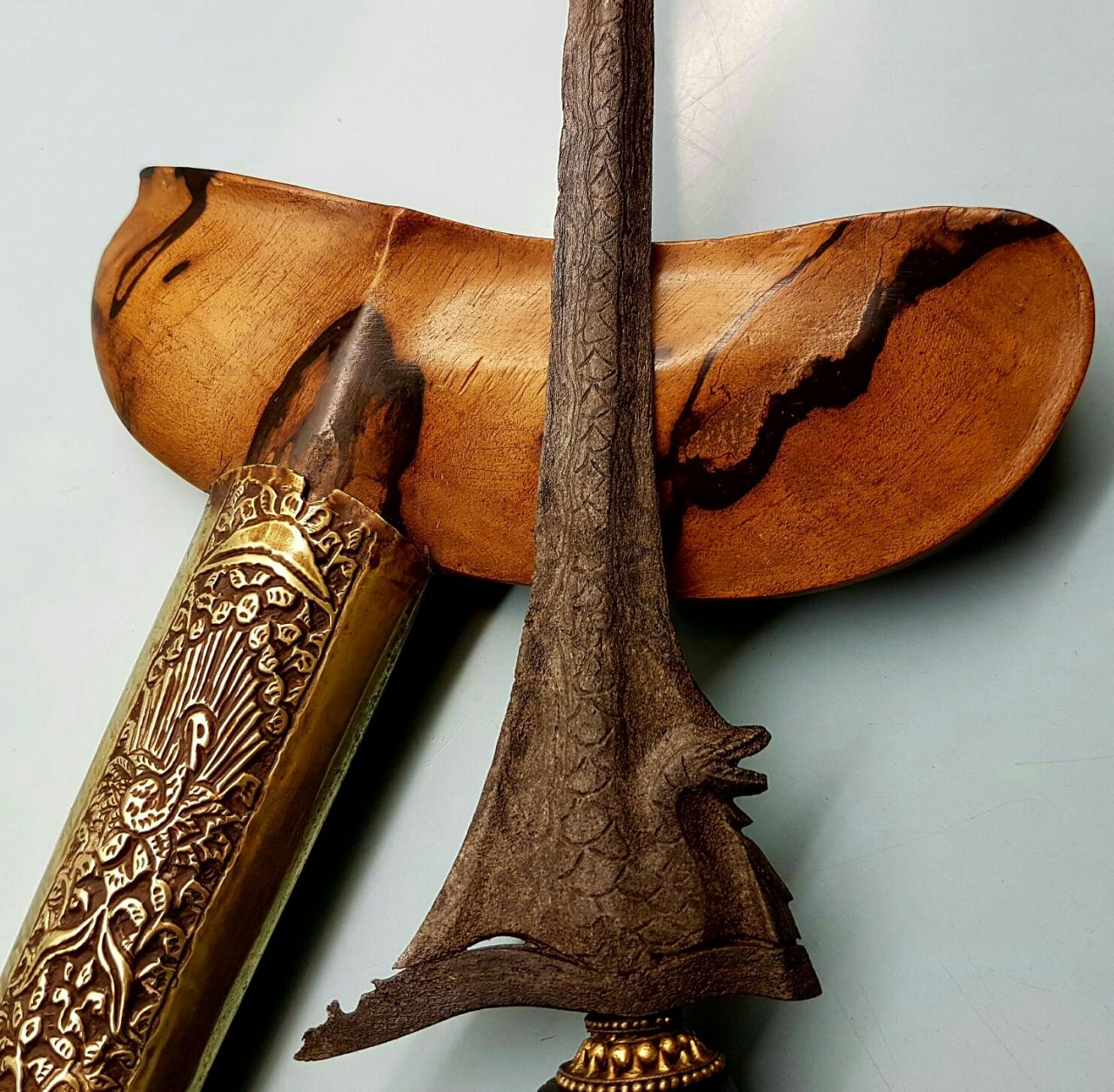

well the blade is straight and there's a rudimentary dragon, so the closest dhapur should be naga tapa
CMIIW
regards
Donny

I was asking because the blade looks rather thin to me and the Naga like a snake not the common dragon. I thought it could be a interesting keris, as someone has invested some effort, the sarong looks not "cheap" and fits well and also the handle is very deeply carved.
Arjuna

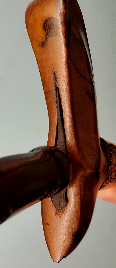

You say that it fits well in the sheath. By that do you mean to imply that it seems the sheath was actually made for the blade or that it is just well adapted? Can we see a photo from above showing the fit.
This does indeed seem to be an older blade, but my suspicion is that the naga may have been added later in its life. It's hard to tell these things for certain and a hands on inspection is always preferable so i couldn't say for sure. It is certainly not your standard design for a Javanese naga though.

Maybe just adapted?

To address the keris under discussion in this thread.
The blade is an older one of rather pedestrian quality, the naga is original to the blade, the gonjo has been replaced.
The wrongko is a relatively nice piece of timoho and is perfectly suited in both quality and condition for the blade; regrettably no effort has been put into the refit, but I can understand this, because the cost of a refit by a skilled m'ranggi would not be justified for the quality of this blade.

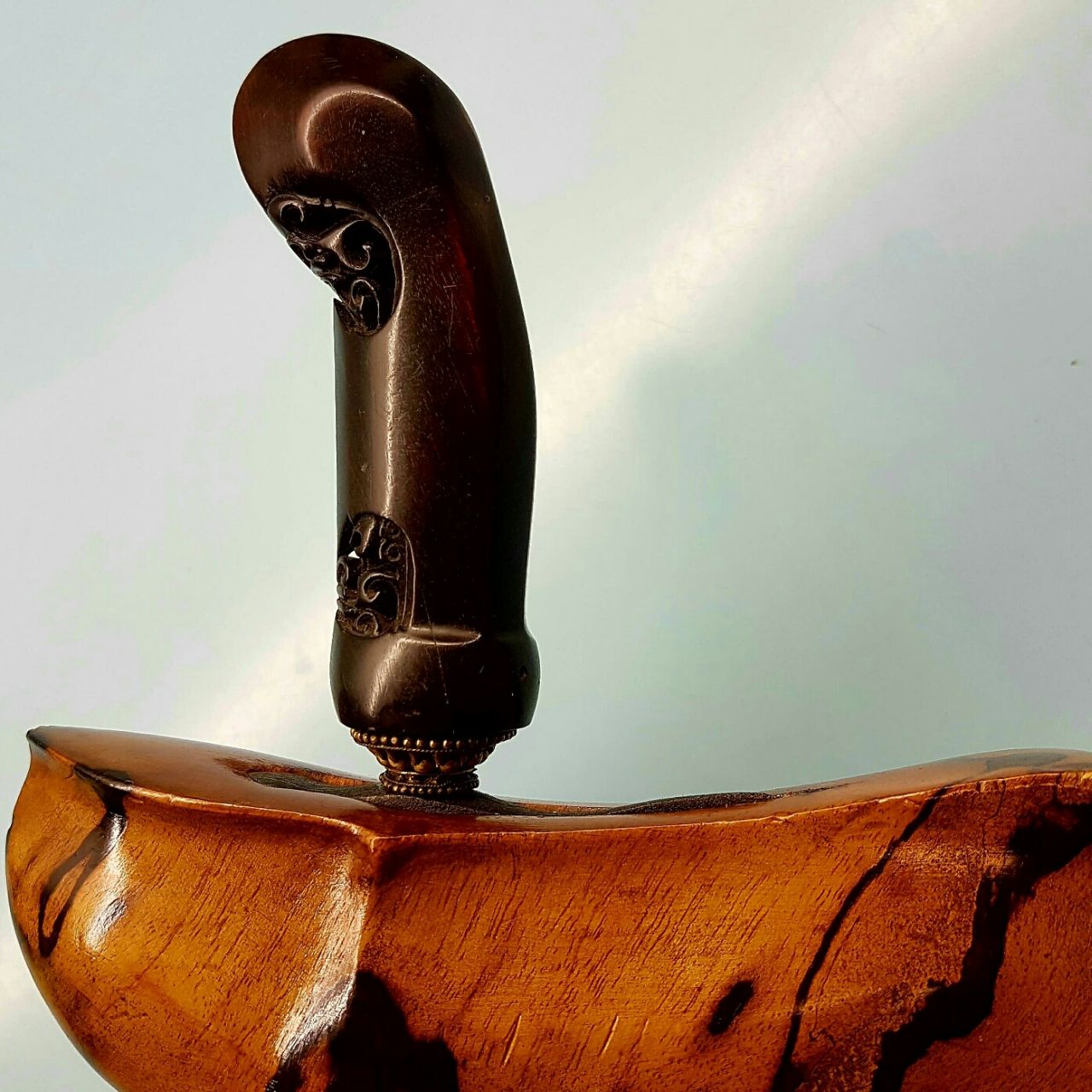

The pendok is old, ordinary pasar quality and has some damage; the jejeran is old, passable quality, but will be subject to a risk of cracking so should be treated gently --- do not exert undue pressure if removing, do not bind the tang all the way down when refitting, keep it out of direct sunlight; the mendak is old, pasar quality and appears to be undamaged.
I consider this to be a good representative keris for a beginning collector. Everything goes together nicely and it is a very nice example of the type of keris that many ordinary people living in Jogjakarta and surrounding districts would have as a personal keris.
