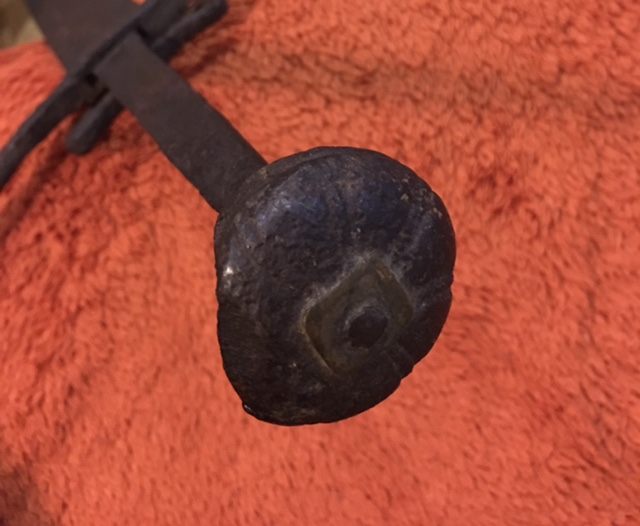

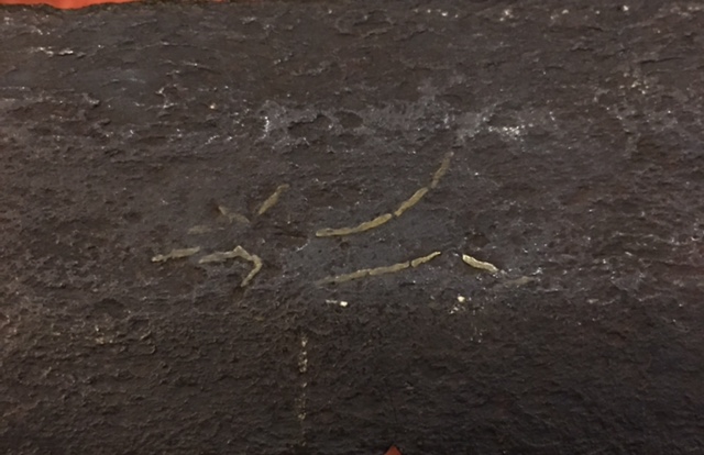

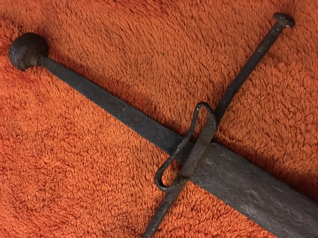

Hi I have not been here for ages ... recently got new sword or something what it was... any ideas on markings, Passau? This is not my area, but I know this item for many years and maybe I will get it for my collection... any comments

any photos of the whole thing? dimensions would be nice too. looks german side sword-ish.
bit of elbow grease and a new grip and she'll be almost good as new

It looks like a great specimen! I agree that it is German, and might date to around 1530ish. The wolf-mark originates from Passau, but was already being copied elsewhere I think - in Solingen for example. There are two similar swords in Zurich that have a fairly similar "forked-cross" mark (but no wolf-mark).

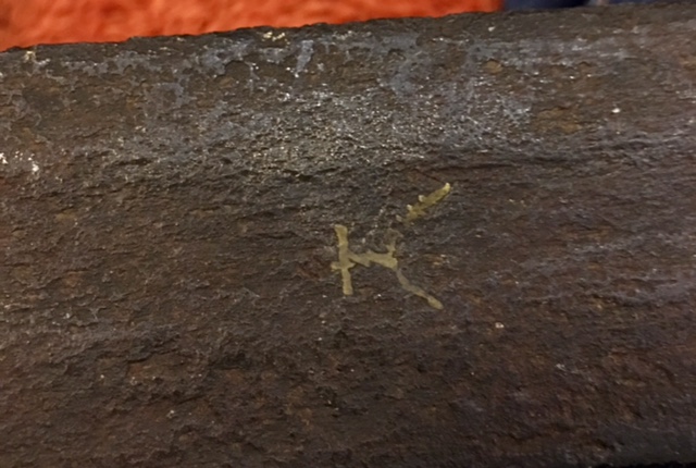

Mark Thank You Very Very Much for reply and information, wolf is on one side while "forked-cross" on both. I will try to place some more pics tomorrow. The sword is in rusty condition and was at least 24 years on my friends wall (this is when I first time saw it) and inlays seems to be in gold while still a bit shiny.

You're very welcome! It would be great to see the full length of the sword, and the mark on the other side. Also, is it as large as the swords in Zurich?

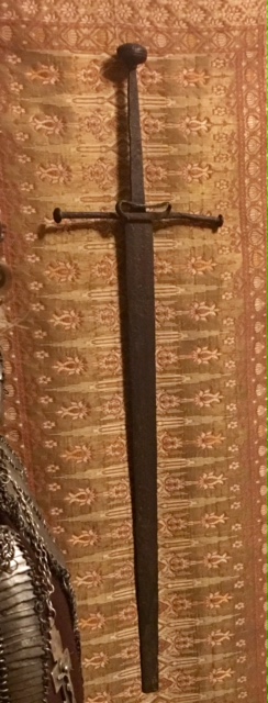

Finally I have found few minutes to take pic of whole sword, sorry not the best one I will try to make some in daylight tomorrow

Thanks for the photo!

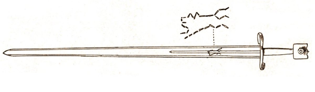

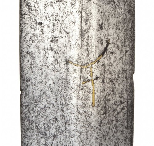

I've found another example of a "forked-cross" type mark for comparison, with a more curved shape that may be a little closer to your mark. The wolf appears again and is quite similar, along with an additional cross potent. This sword is in the Slavicin museum in the Czech Republic.

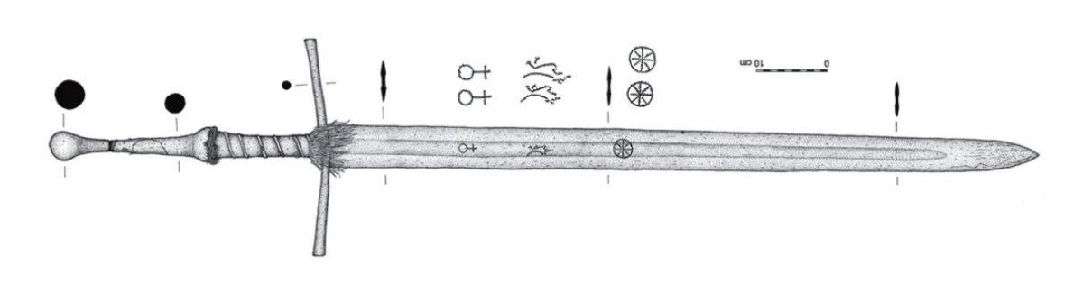

Hi mark,

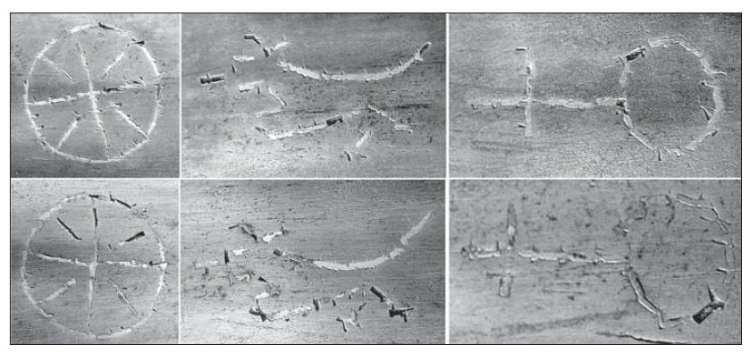

can you tell where you get this Picture from, very nice T-pommel sword.
Iam not sure if the "forked cross" with the round base displays a splitted cross or a monstrance.
sword of post 1, it looks as though the blade is 50-100 years older as the hilt.

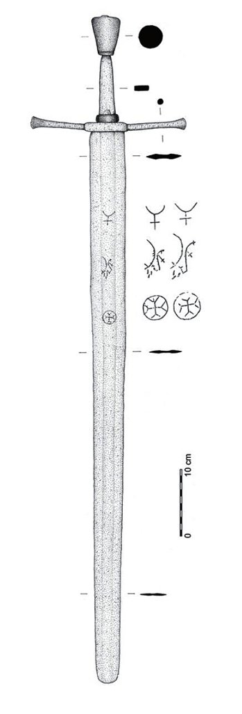

Hi Jasper, you are right - it is not really the same mark as the split cross. Have you seen a monstrance represented this way elsewhere?

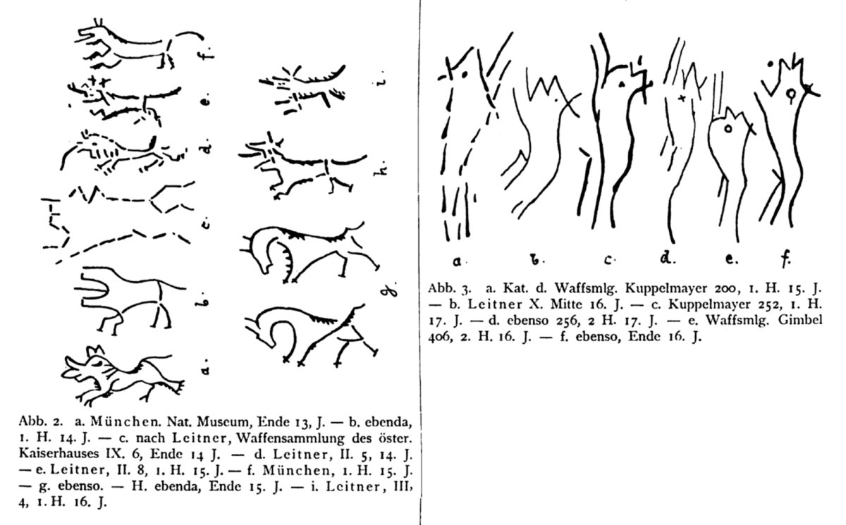

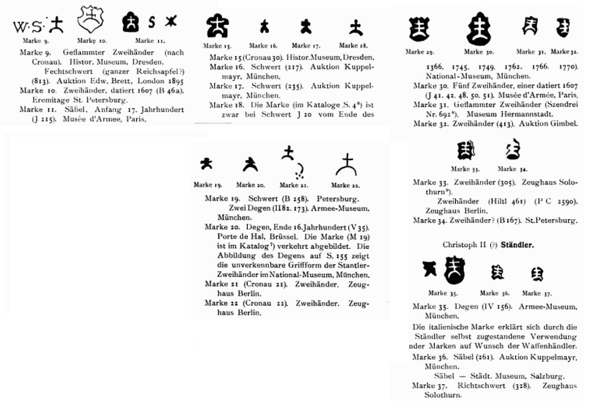

That illustration comes from an article by Petr Zakovsky, "Marked High- and Late-Medieval Longswords from the Collections of the Municipal Museum, Broumov", it should be available online. The text is in Czech, but there are other photos of swords with interesting markings.
I've found an article in volume V of Zeitschrift für Historische Waffenkunde with many examples and variants of the mark, ascribed to members of the Stantler family. In the same series of articles I also came across what looks to be the original source for Wagner's table of wolf marks - but with more details as to location.
Finally, another example was sold by Hermann Historica, who erroneously describe the mark as an "imperial orb" while repeating the attribution to the Stantlers.
http://www.hermann-historica.de/en/s...6&currentpos=2
