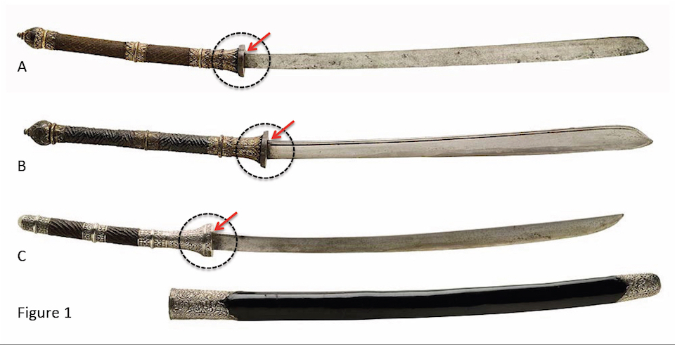

Although the dating of the painting that is the subject of this thread, and its attribution, may be uncertain, let’s take for now that the mid-17th century C.E. is approximately accurate for its completion. This means that the sword would likely have been made, at the latest, sometime in the first half of the 17th C.

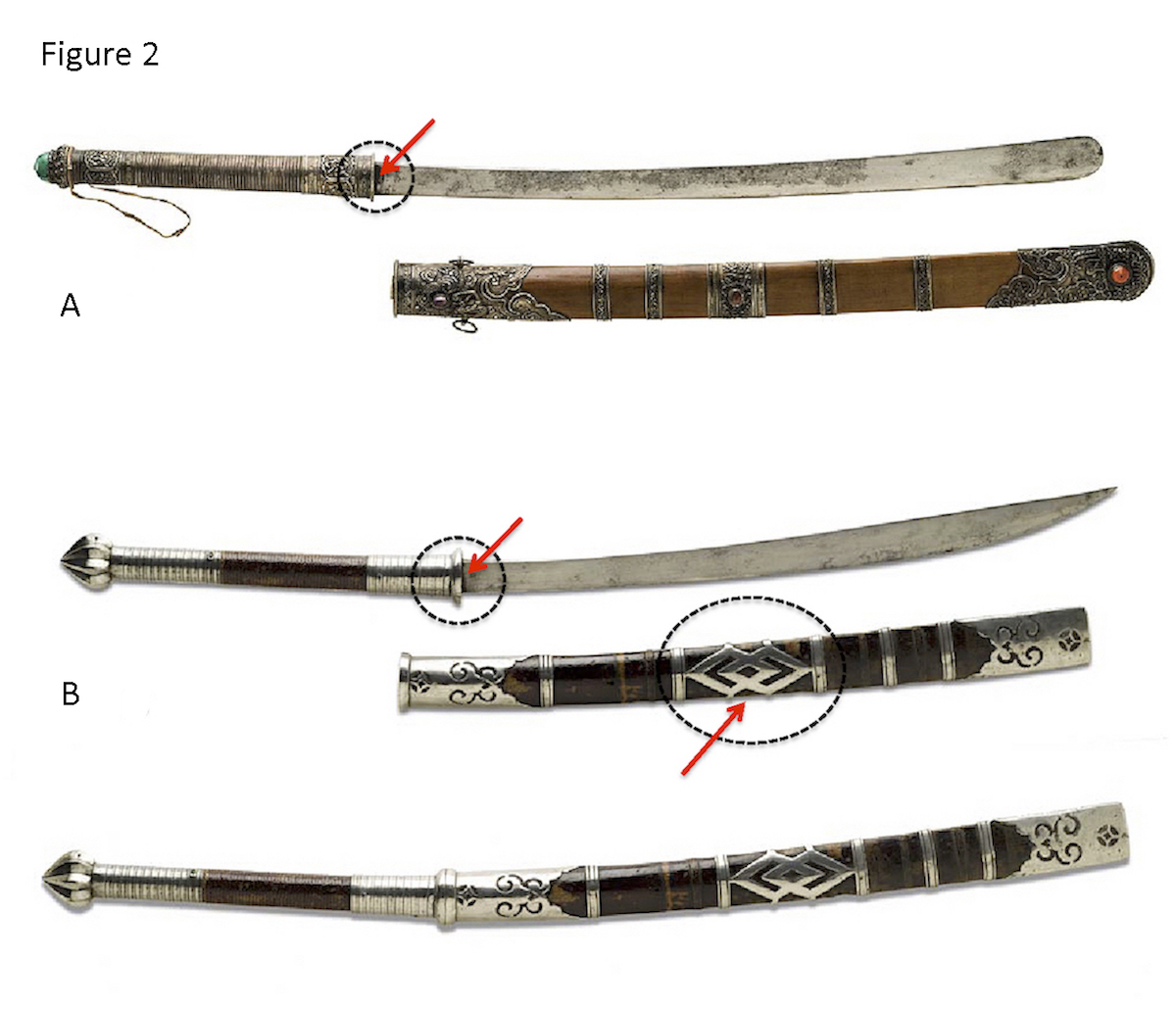

Several people have already commented that the sword and scabbard look Asian, possibly a dha/daab from mainland SE Asia. The sword bears no resemblance to Burmese dha of that period, so I will focus on Siam (now Thailand) and areas north and east.

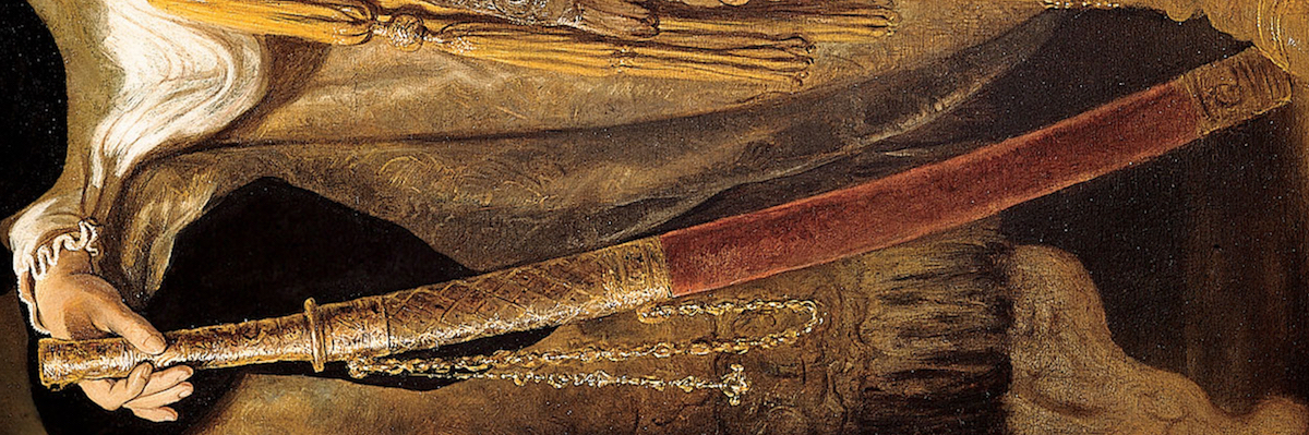

I have blown up part of the original picture to show just the sword, and further enlarged its hilt and the throat area of the scabbard to get some clues about its origin (see attached images). The first thing to notice about the fittings is that they appear to be gold, or perhaps a gold wash over silver; they might also be a copper alloy, notably samrit, (gold-copper alloy), brass or bronze. If gold or silver were used on the fittings then this would signify a high quality piece for someone of distinction.
It is unfortunate that we do not see the blade itself in this painting, which would have been informative, but the shape of the scabbard indicates that it was curved and probably of a general saber form. The ratio of the length of the handle to the presumed length of the blade (assuming the blade extended to within an inch or so of the end of the scabbard) is roughly 0.26. This ratio is unusually low for many dha/daab, especially those from Thailand at that time (the Ayutthaya period) when the ratio of the hilt:blade length was usually greater than 0.3. I have included some examples of Ayutthaya period daab (Figure 1A,B) as well as an early Rattanakosin daab (Figure 1C) made in the older Ayutthaya style. In addition to being longer, the Ayutthaya hilts are quite different from the one seen in the painting.

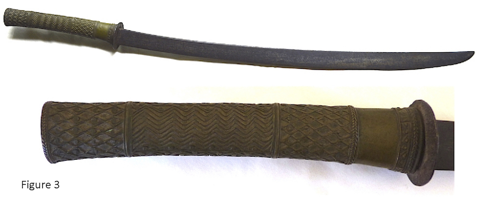

Nevertheless, it’s worth looking at a sword that I have that dates from the early 18th C. (Figure 3; hilt:blade ratio = 0.33). It is from the Lan Chang period, and I am indebted to an English dealer for the following information about this sword.
The sword is … from Laos and it is very old. It is from Lan Chang (Lan Xang) or The Lao Kingdom of Lan Xang Hom Khao. Its date would be 18th C, and the early part to middle 18th C as Lan Chang did not exist after c 1717, although the sword style did carry on after that date and the samrit bronze fittings were replaced as the style evolved into the more flamboyant hilts and scabbard fittings in repousse silver that often had velvet-wrapped scabbards … [as] seen on many swords from Laos onward into the 19th C and early 20th C. They are still being made today in this style in Laos and … in northern Thailand I have been offered modern ones but the blades are of no quality. The style is not Thai, and although are often thought to be, they are all from Laos in Lan Chang style, including the silver repousse ones in the BKK museum which are actually marked Lan Chang in Thai in the museum. Many of those types that come around for sale have the guards missing and … this guard type is a Chinese influence as many were made by migrant smiths from China and were often removed for comfort. …
The hilt of your sword has been reattached at some time and set upside down, this may have been done long ago in the native country or later after collection; when made it would have curved with the shape of the blade in one gentle curve.
Imitation of the Lan Chang style had somewhat of a revival in the 19th C. A number of these swords can be seen in the National Museum in Bangkok (see here for prior discussion: http://www.vikingsword.com/ubb/Forum1/HTML/002442.html ). These swords were designated Lan Chang by the museum, and appear to have been meant for nobility and as a sign of prestige. There are also examples of similar swords from the 19th C. Rattanakosin period that reflect a Japanese influence, with imitations of the tsuba and habaki, but these are found 200 years after the sword of this topic.
What can the hilt of the sword in the portrait tell us?

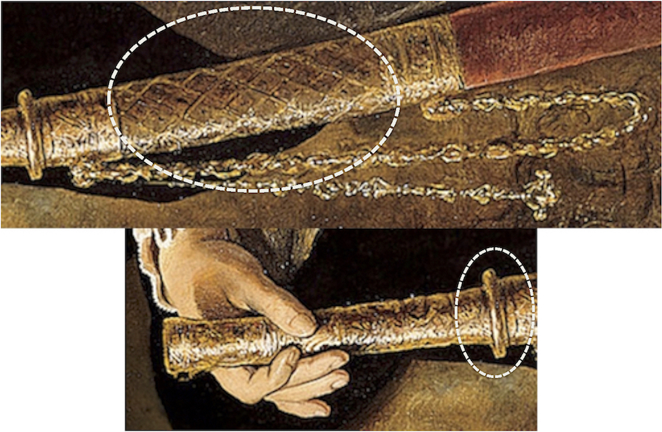

A distinguishing feature of this hilt is the small disc guard. A comment from my English contact may be helpful, “this guard type is a Chinese influence as many [of these swords] were made by migrant smiths from China and were often removed for comfort.” Dha/daab typically have no guard, and the presence of such a disc guard on dha/daab appears to reflect Chinese influence.
The cross-section of the hilt may also be relevant. Most dha/daab have circular cross-sections. The hilt on my Lan Chang daab is not circular, but elliptical, with the sides quit flat. This is unusual for mainland SE Asian swords. However, the sword in the painting appears to have a cylindrical hilt, although it is hard to say for sure.
Lastly is the handle itself. It may be metal over wood or it could be solid cast metal—there is really no way to tell from the pictures. What is apparent, however, is that the section of the hilt adjacent to the guard does not flare out into a bell shape as seen in the Ayutthaya swords (Figure 1), and to a lesser degree on my Lan Chang sword (Figure 3).
What can the scabbard tell us?
This scabbard presents some mysteries. Part of it appears to be wrapped in velvet, which is unusual for mainland SE Asian swords of the 17th C., while the throat has an extensive metal embellishment that shows a criss-crossed, lattice pattern. That same pattern can be generated by a series of overlapping diamond designs, and such a pattern seems to reflect Chinese influence again. This overlapping diamond design can be seen on the scabbard of a 19th C. sword thought to be from Yunnan/Northern Thailand (Figure 2B). Interestingly, it can also be seen on the hilt of my 18th C. Lan Chang sword (Figure 3).
To further add to the Chinese influence in this sword, the suspension system for the scabbard is not typical of mainland SE Asia, where the sword is usually worn suspended from a cord baldric wrapped around the upper scabbard. The painting shows a metal chain passing through two eyelets on the upper scabbard. The arrangement suggests that the sword was worn with the edge of the blade upward—an odd configuration in SE Asia—although this might reflect an alteration of the original scabbard configuration on the part of the artist, in order to balance the picture better.
Summing up
The appearance of this sword is most consistent with a 17th C. Lan Chang daab from what is now Laos. Against this identification are two main anomalies: (1) the hilt is short for the apparent length of the blade, and (2) the suspension system on the scabbard is highly atypical. In addition, we see Chinese influence in the presence of a small disc guard and in the metal decorations on the scabbard.
So where would a Dutch merchant have found such a sword? Ayutthaya is a possibility. However, the Dutch also had trade relations with Tonkin/Cochin China, which share a considerable length of border with the Kingdom of Lan Chang. Tonkin/Cochin had major trading centers, with trading partners as far as the western coast of India (Kerala and the Malabar coast).
I think it is more likely that this sword was obtained in a major trading center such as found in Tonkin/Cochin, rather than a much smaller trading center such as Ayutthaya.

Detailed views of sword in the painting by Ferdinand Bol. The hilt guard and scabbard decorations are highlighted.

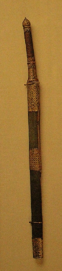

Figure 1. A,B swords of Ayutthaya period. C. A sword from the early Rattanokosin period, in the earlier Ayutthaya atyle.
Figure 2. Two swords attributed to Yunnan. A. Northern Burma/Yunnan. B. Northern Thailand/Yunnan (note scabbard decoration). Both swords have small guards and cylindrical hilts.
Figure 3. An early 18th C. sword, with detail of hilt, from the Lan Chang period (Laos).
