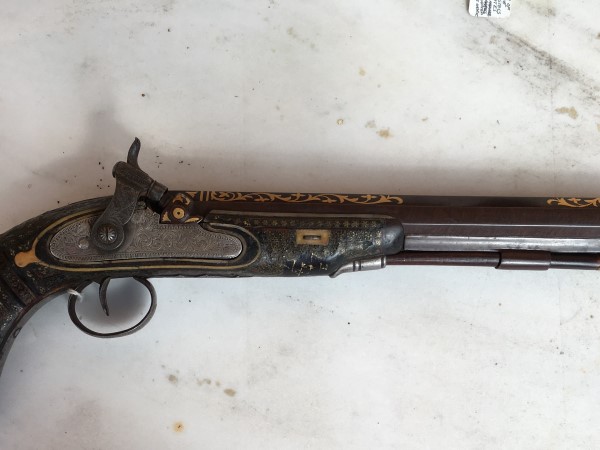

I have the pair of percussion pistols illustrated..They are 37cm overall,barrells 24cm, the lock is silver & engraved.The pistols are half stocked, no but cap,& a rib under the barrell also holds a wooden, brass tipped ramrod.
The percussion hammer seems to be based on the patent pillbox hammer made by Joseph Manton.On p241 of The Mantons Gunmakers, is a colour photo of a pair of Joseph Manton pelletlock pistols which are similar to these pistols.
The hammers on my pistols fire a percussion cap only,there is no provision for a pellet or pilllock action.

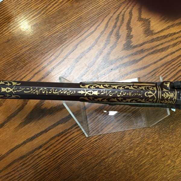

The barrell is decorated with ornate gold work & a long inscription, I assume in Urdu.

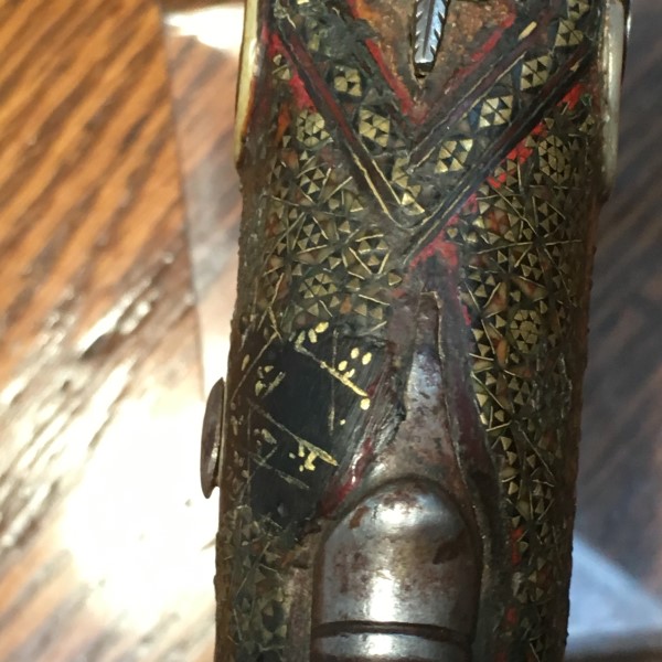

The stock is lavishly decorated in Indian or Ottoman style.At first I thought the decoration was hundreds of tiny brass pins & painting.However under the forestock the decoration seems to have rubbed off in a section, & there are no pin holes. I wonder whether the decoration was made in a sheet & then glued to the stock.

For me it is a pair of European pistols, in which the wood was used to decorate it and the same with the barrel, in which inscription and decoration with gold foil was made, in a known method.
Gabria to have a photograph nearer the decoration of the lock, to hold some opinion.

PLEASE COULD YOU POST PICTURES OF THE COMPLETE PISTOL
REGARDS RAJESH

These pistols are Persian work, they exhibit strong overall European formal influence in contrast to the more characteristic khatam or mosaic work on the stocks. The barrels bear what appear to be couplets and a date, 1260 a.h. (1843/44 c.e.)

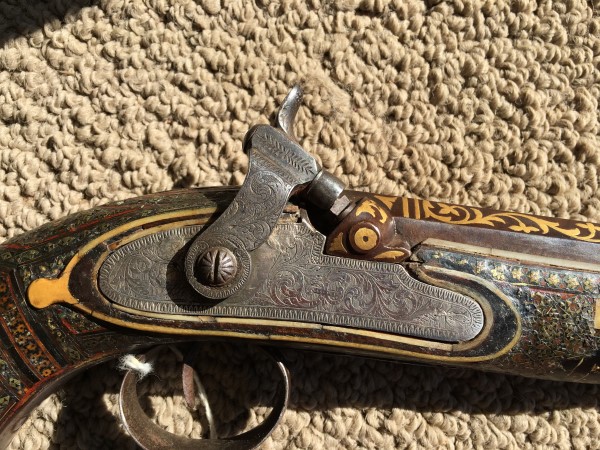

Fernando, I'll also post some photos showing the lock area.

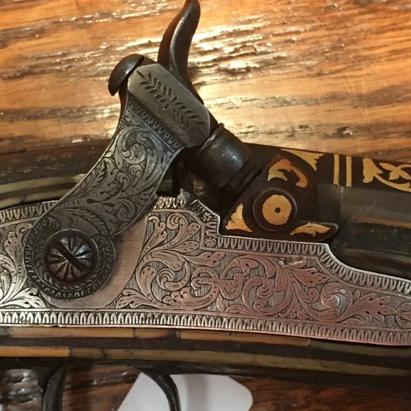

That is a very nice, and unusual pair of pistols. And obviously made in percussion (not converted). And the apparent date offer by Oliver would also confirm that. While the hammer styling may seem it bit unusual, I think it was intentionally done that way as part of the overall styling exercise. The mixture of European and Persian influences sure make for an interesting pair. And they appear in great condition. First class craftmanship. Yes, more pics as mentioned above would be great. Thanks for posting.

Very nice indeed!
The locks and percussioning do seem to follow British style, as does the engraving, but such work was also seen on Persian work as Oliver states.
It would be interesting to see the interior of the lock, Plus the lock mortise if possible. That could tell us a lot!
Can't see well enough in the photos, but are the strikers detachable on these hammers?
Are there any signs of proofs on the barrel?

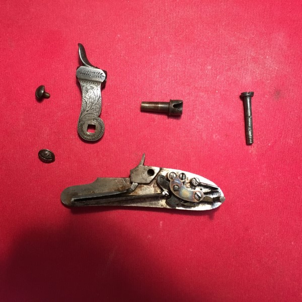

As promised I have attached more photos of the pistol, the inside of the lock, the hammer & mortise area, & the trigger guard.
I should have mentioned that there are no proof or view marks on or under the barrels, or any marks or stamps on the inside of the lock.Although the springs & tumblers seem to be well made.
On one pistol I have been able to remove the striker by removing the screw at the back of the hammer. One of the photos shows all the components. The screw in the other hammer is stuck.The striker can only ignite a percussion cap fixed to the nipple, however the set up is odd, & seems to be based on a pellet lock.

In my first post I mentioned that the decoration seemed to have been "stuck on".This is incorrect, on closer inspection I can see hundreds of brass pins & brass pieces hammered into the stock. The thin brass pieces separate the lines of pins which make up the triangles & circles formed by the pins which are outlined in red.[I also have new lenses in my glasses!!]
I was confused by some repairs to the forend which have involve replacing damaged sections of stock with new wood & painting in a poor manner, some gold lines & decoration.

I see 1290/1873 for the date, for the rest I agree with Oliver (for the decoration and the text).

By what I can see, the lock-work is very competently done and the sort of lock that would not surprise us or appear any way inferior on arms of European/British origin. Nice to see the stirrup on the tumbler.
Can't tell on the lock mortise, but may be a shade down on European inletting.

Thanks for the additional photos. From the photo the internals of the lock do indeed appear to be European made. Or at least to that standard. Although the engraving does look more Persian in style. That hammer assembly is really unique. Believe it's the first I've ever seen. A very interesting design. But I can't figure out the purpose of the two hammer pieces with the set screw (?)
Must be something I'm not thinking of. Hmmmm.Do any of you think the lock was European or Persian made - before any decoration was applied ?

Now, come to think of it.......It seems that I have seen this percussion hammer style many years ago on a pair of cased, European dueling pistols. But my memory is not what it used to be. LOL
