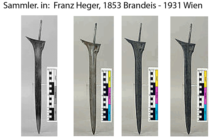

So I tried to follow a lead to the Austrian Ethnologist Dr. Franz Heger who, as described in the article, had ordered the five keris and had paid for them.
I found out that the collection of Dr. Heger became part of a royal museum in Austria. The museum was eliminated and the collection was divided between two Austrian museums in a later time. The part of the collection with the five keris could possibly have been transferred to the collection of the Welt Museum in Vienna.
After some communication the museum was so friendly to search for me between the about 200 keris they have in their collection and at last and to my big surprise they came up with some very small and low quality photographs of keris that looked very much alike the original five keris.

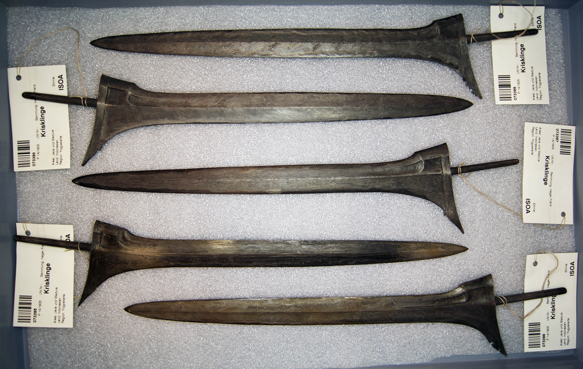

I was very pleased when they invited me to have a look at the keris in real, especially since the museum is closed for a long period due to restoration work. I was allowed to measure and weigh the five keris. So I went to Vienna and found the famous five keris as they were taken from Yogjakarta.

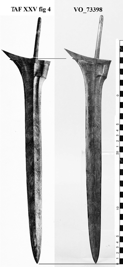

No maintenance was done at all. They were like new, but looked very bad. One of the blades was damaged by taking a small piece for examination purposes.
Below I show a comparison of a photograph in the article of Dr. Groneman and a photograph of the same keris in the museum.
The left side of the picture shows the photograph of the keris in the article of Dr. Groneman in 1904.
At the right a photograph of the keris in the collection of the Weltmuseum.
The quality of both photographs is bad but it is still possible to compare the pamor and confirm that it is the same keris.
I hope the museum will have them well maintained and show them to the public when they reopen.
For us it will be very interesting to pay these historical famous keris a visit.
We may be very happy that 100 years after the dead of Dr. Groneman these five famous keris come alive again.
