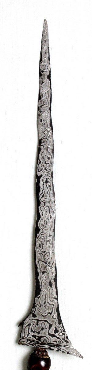

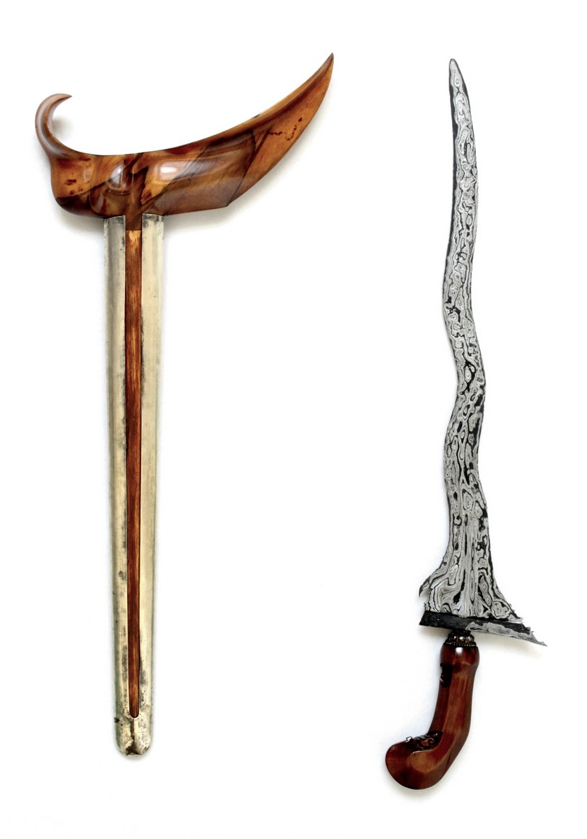

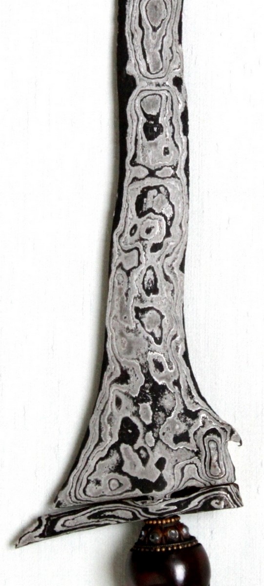

These 2 blades are examples of what they identify as made from meteoric pamor, what do you think?
Old 28th September 2016, 09:59 AM   #12
Posts: 7,260
Yes, it is a widely held belief that pamor made from meteorite does have a very slightly prickly feel to it. The two blades that I have been involved in making that definitely contain meteorite do have a very faint prickly feel. Another blade that I have which is attributable to Jayasukadgo also has a very faint prickly feel. Jayasukadgo was a Surakarta empu during the era when Surakarta empus did sometimes use meteoritic material.

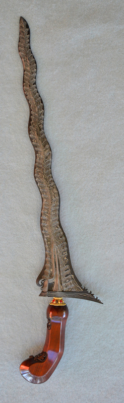

The picture above of the keris that pande keris Yantono made, using meteoritic material that I welded uses pamor that was made with meteoritic material that had been combined into a small billet thus the billet of meteoritic material could be incorporated into the iron in exactly the same way as if it had been commercial nickel.
I welded meteoritic material used in the keris above, in a gas forge, not in charcoal, not in coke. I welded a number of billets of meteoritic material, all of which were made with a number of small pieces of Arizona meteor. Small pieces, because at that time--- about 1990--- it was incredibly difficult to buy large pieces of meteor, and even the small pieces were very expensive.
I did initially attempt to weld meteoritic material in a coke forge, and I did have limited success, but it was a very wasteful process, and very, very difficult. I never used the Javanese envelope method with meteoritic material.
Using a gas forge for welding is about as difficult as making a chocolate cake --- in fact I'd say that making a decent chocolate cake is quite a bit more difficult than taking a weld in a gas forge.
