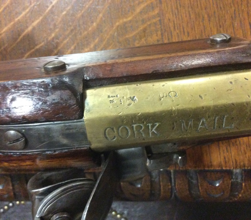

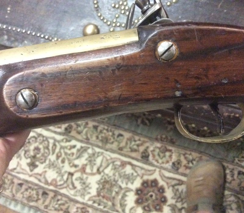

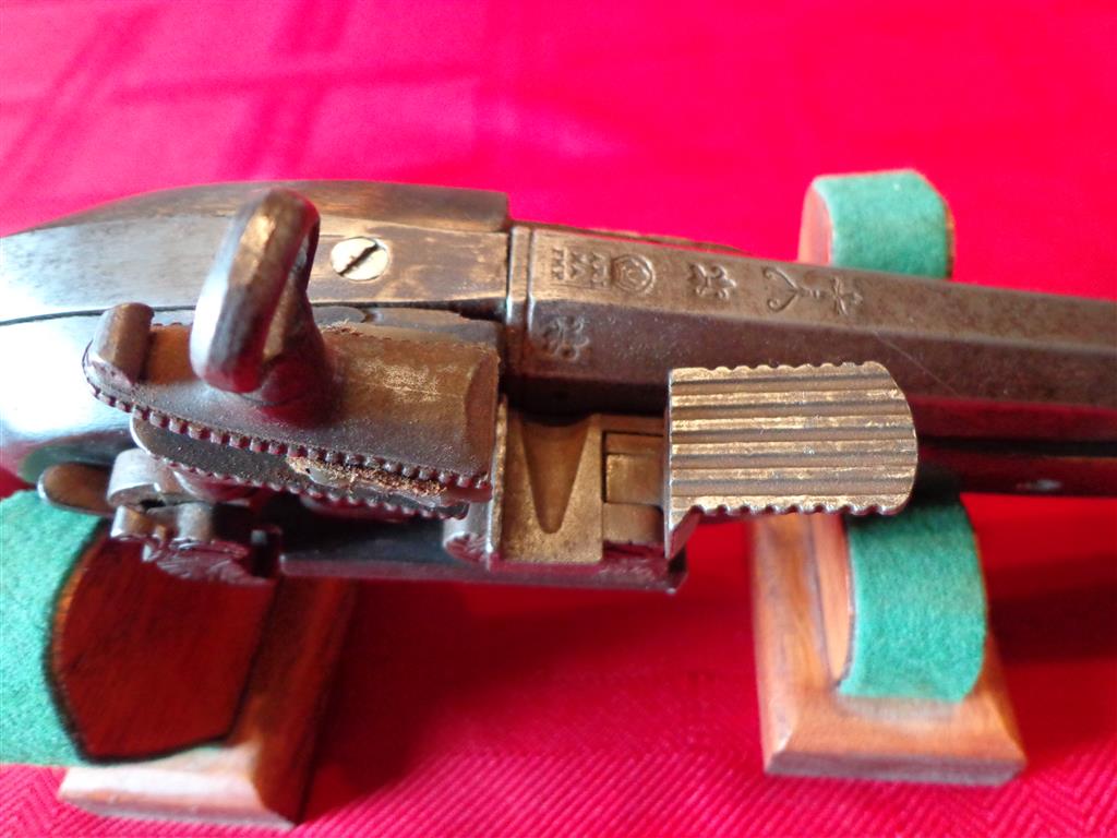

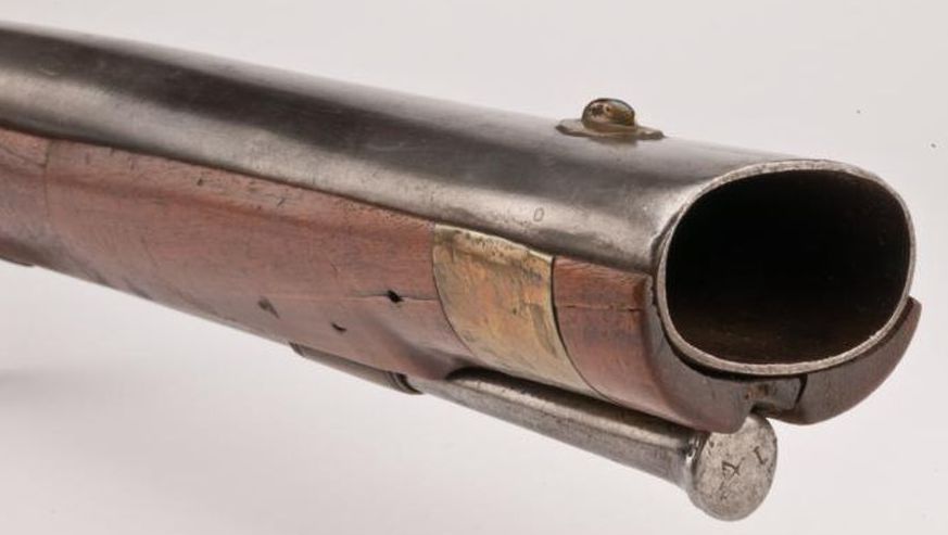

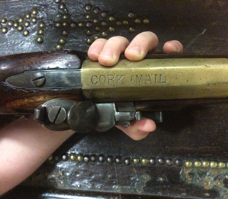

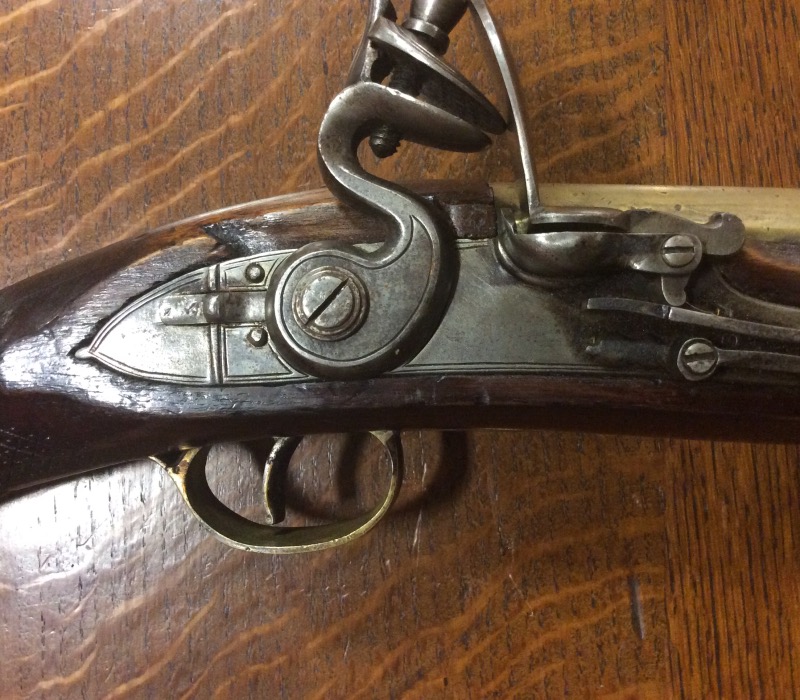

Hi all
Thanks to a pervious post on A York Mail blunderbuss I have saved a good bit of money
http://www.vikingsword.com/vb/showth...ht=blunderbuss
The attached blunderbuss has just sold at an auction in Ireland
I went to view over the weekend and on comparing the two I was confident this is a recent reproduction as per post above
Things to look out for
Not one screw was rounded anywhere
Font on Cork Mail not square
No wear on the stock chequering
No makers mark on the lock
proof marks did not make sence
and a few other small things
Incidentally the safety did not work and the sear was not engaging with the nice click noise
With a bit of improving on the workmanship it would be hard to distinguish

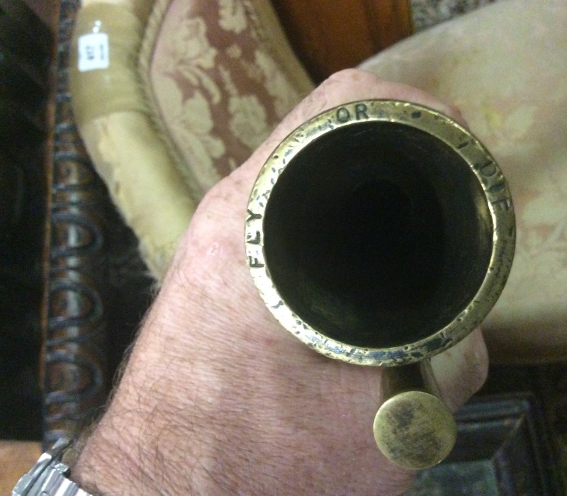

Note also the Fly or Die on the end of the barrel, which shows recent tooling marks on the inside
I hope this thread is appropriate as I just want to alert others to these items
Best regards
Ken

That blunderbuss is well synthesised, unlike the ugly tourist gun. One further weakness is the inletting at lock and tang, which look somewhat worse than any original I have looked at (I am not an expert though). It makes me want to understand who made it and from what. The creation of charming copies for Victorian decorators is well known, and there are known past collectors who have had top-quality copies of rare guns built, ofttimes with no intent to deceive.
This one has to me the feel of a 1950s-60s faker, when top quality craftsmen were less likely to do this stuff and the 'distressed' look was a big part of making new craft furniture 'antique'.
The 'no makers mark on lock' and 'barrel stamp not square' is not at all definitive. We tend to see better-quality retailed pieces or known-quality military standards, but a body like the Cork Mail probably armed their guards from lower-quality trade suppliers, perhaps by tender. The makers would not necessarily pay a quality engraver to mark trade-sourced second tier locks. The Cork Mail stamp is done with old-looking individual letter stamps and reasonably well aligned though not perfect. Letter stamps are more what you would expect in smaller more remote or colonial organisations and consistent with the lower trade quality of the components.
The fly or die is also letter stamps but perhaps newer font, and is the worst feature on this gun I think. The inletting feels like the gun has been made up from two genuinely old but partial guns, and the cock clamp screw and other un-butchered screws are probably new-made.
Overall, I would give it house room if it were not priced too high or for a Cork historic exhibit. Its almost OK, but a fastidious collector or museum might decline to lower the tone of the collection with it.
Just my less-experienced opinion.

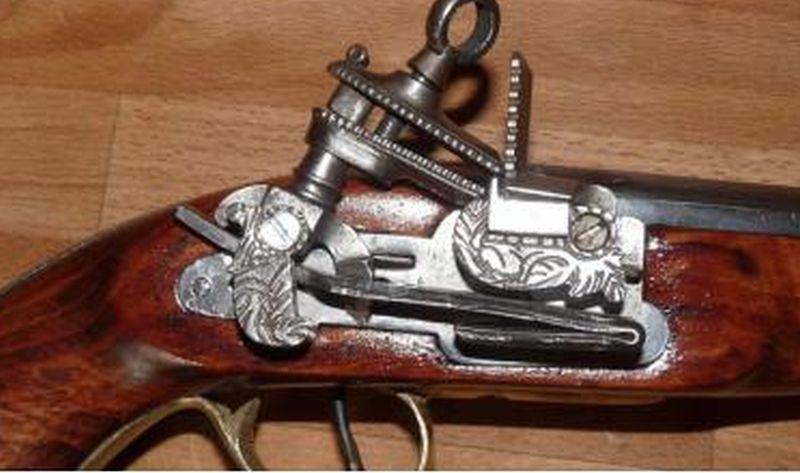

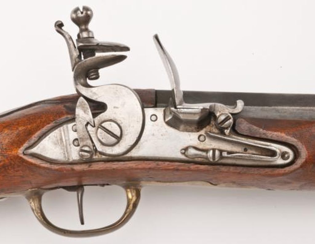

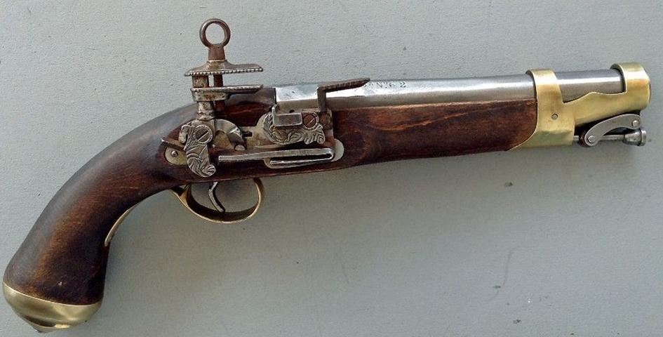

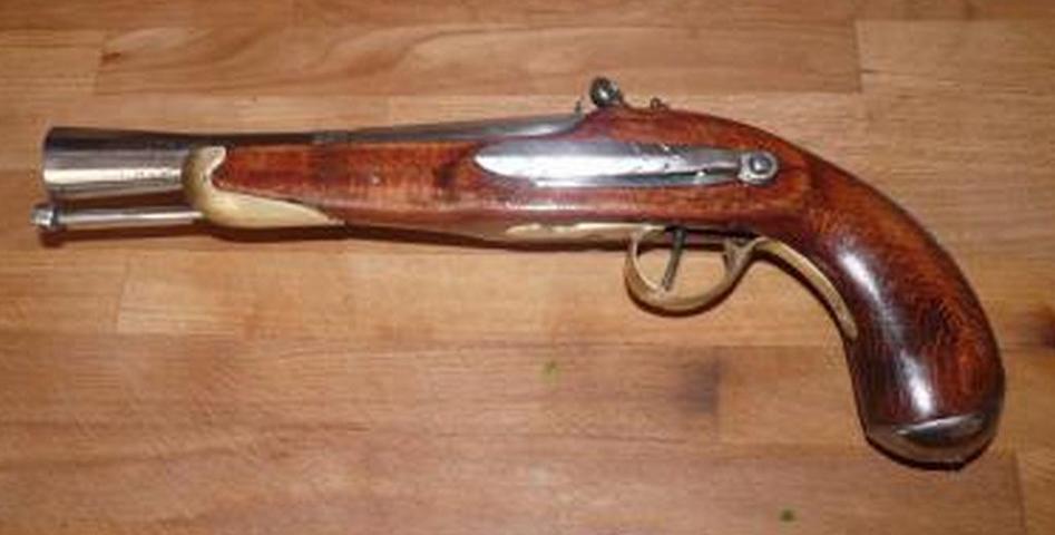

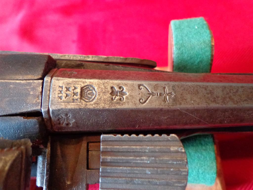

This pistol is a typical Indian made replika of the 1980s. I've added fotos of the same pistol and a foto of another type. Both pistols have exactly the same lock, a fact that is rarely found at original items.
corrado26

I agree in principle
I do think though the blunderbuss is not a tourist item and discussing does enhance the forum by showing what good copies are being made
Without this forum I would have bid north of 700 euro for this gun
A rogues gallery of fakes is a good idea
Ken

Hi Chris
The blunderbuss is not real, it not a tourist item though, it is something made to deceive ( my opinion)
But I reckon without the mail stamps and a few other things I am not going to get into on an open forum, this blunderbuss could be made to completely fly under the radar and be purchased for not inconsiderable money as the genuine article.
I have purchased fake items and if is a learning experience
My lesson was not that expensive but we'll learned all the same.
Maybe a thread entitled " my mistake purchases" would be handy as a reference of what is out there.
I am not a regular enough contributer to this forum to start such a thread though as it is not really what the forum is for.
Ken

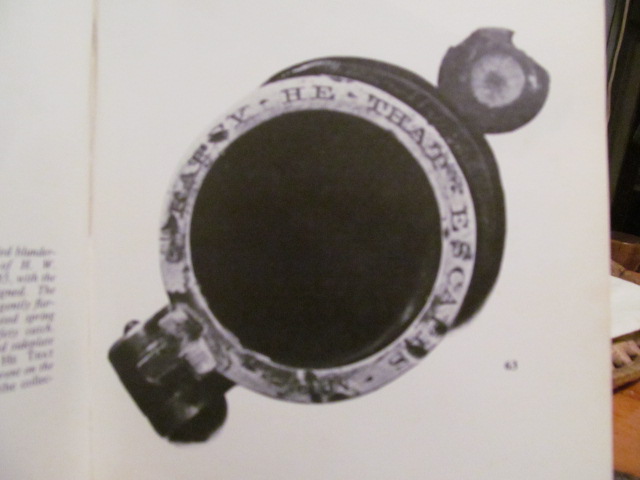

On some other makers, particularly Ketland & Co. the words:
HAPPY IS HE THAT ESCAPETH ME
The same on one by Joseph Sanders c. 1778-1788
Top of barrel: SANDERSBOROUGH LONDON

I could not find evidence of any FLY OR DIE phrase nor any reference to it.

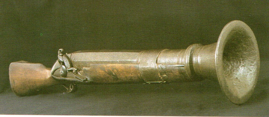

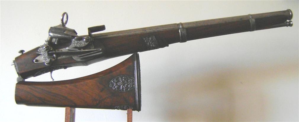

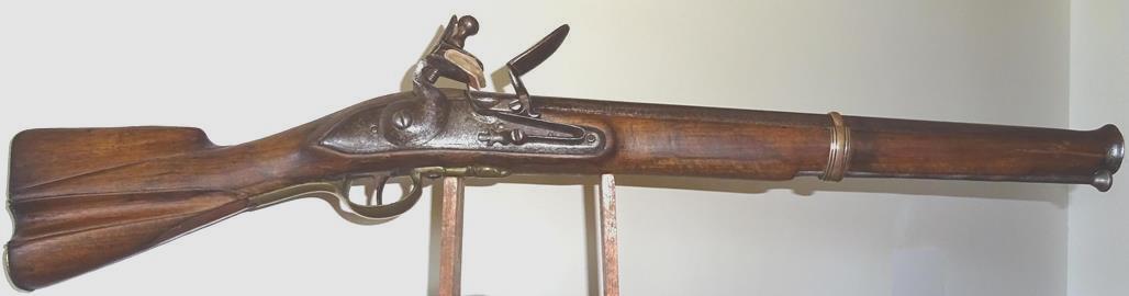

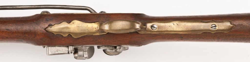

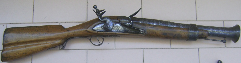

Interesting question, Jim, starting by sorting it by either typology or coloquial terms ... or even by period.
What is precisely a coach gun ?
Does a coach gun have to be the blunderbuss type ?
Do navy blunderbusses have something to distinguish them from those used in coaches ... or those used afoot ... let alone the bronze barrel version ?

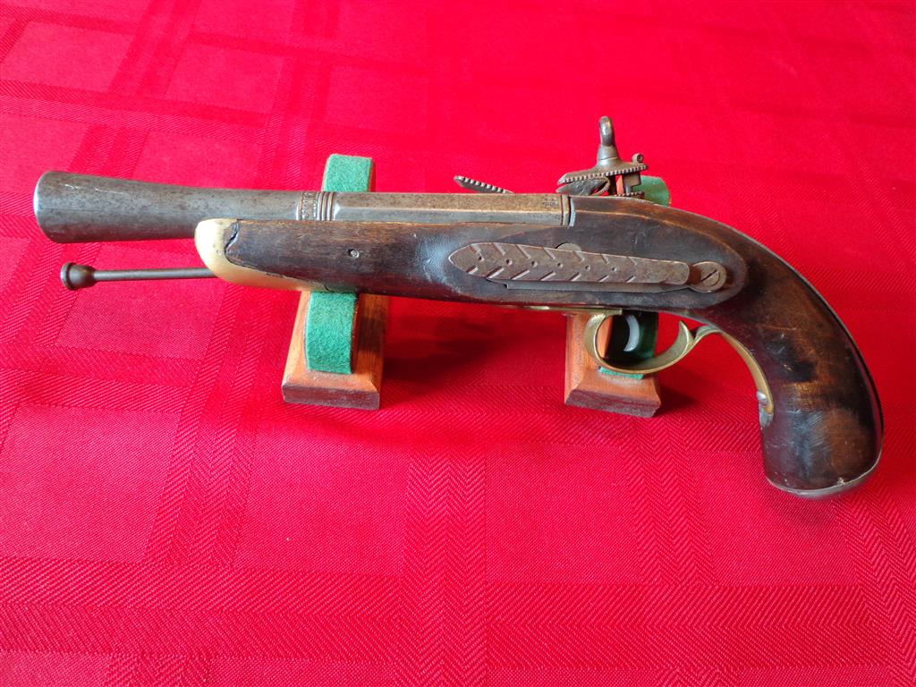

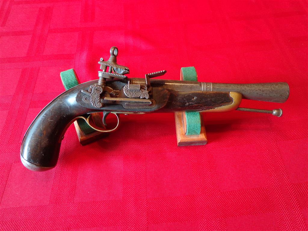

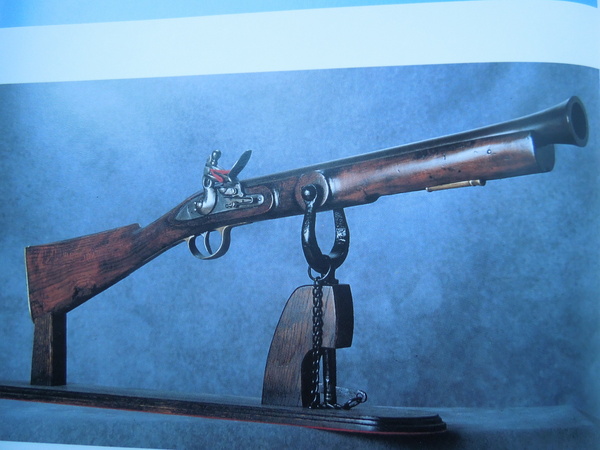

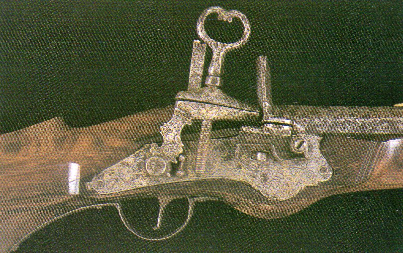

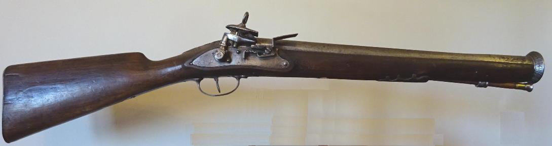

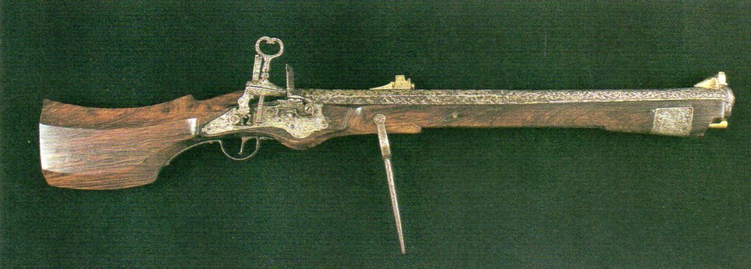

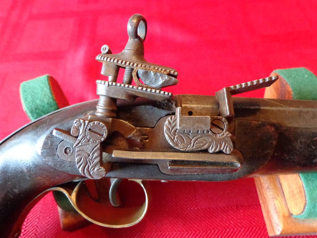

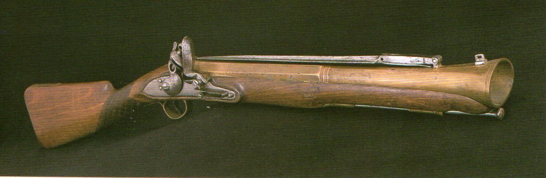

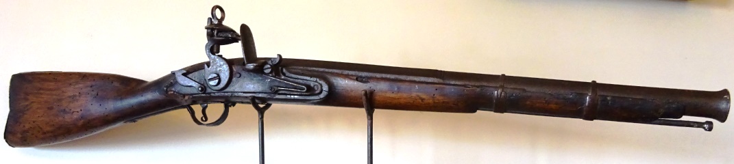

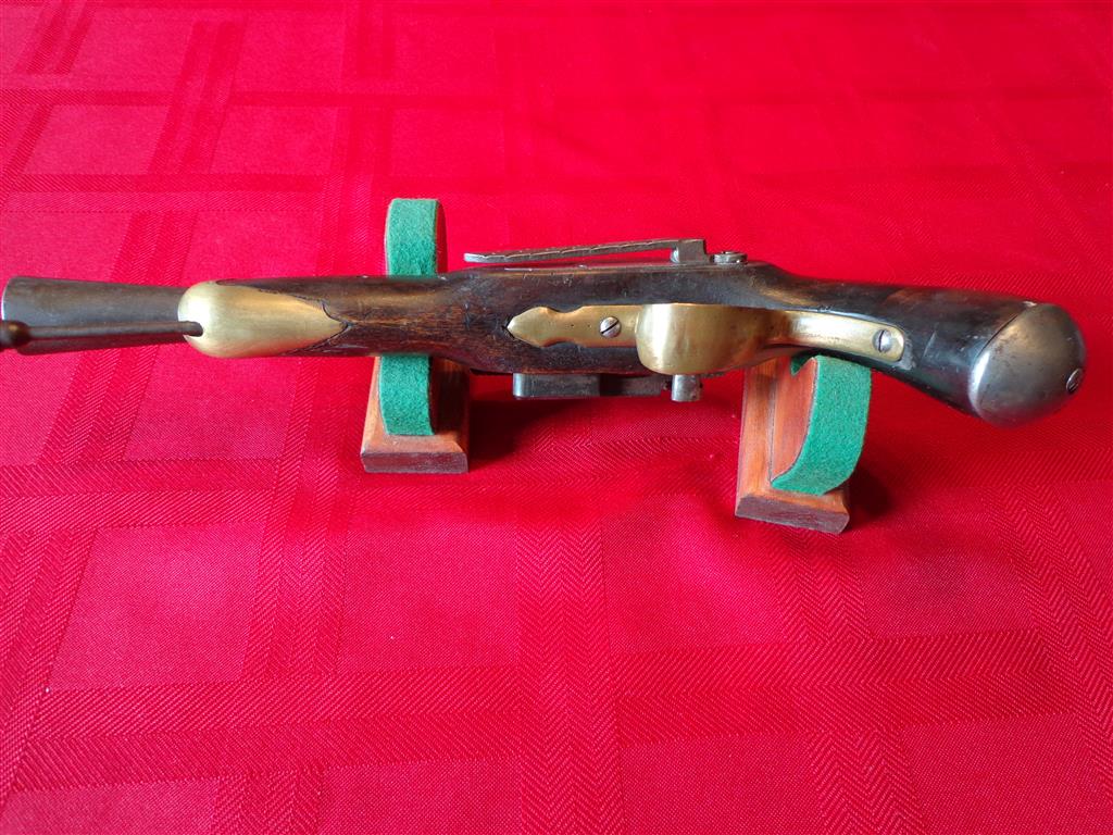

How would you classsify the following examples ?
Old 14th September 2016, 06:42 PM   #12
Posts: 10,833
Excellent questions Fernando! Thank you.
My use of the term 'coach gun' was inadvertent in this case, as that particular term was not coined until 1858 with the well known Wells Fargo & Co. stagecoaches. While popularly associated with 'riding shotgun' as to the guard with shotgun in the seat next to the driver, these guards were actually referred to as 'shotgun messengers' . An odd term, the message must have been, '...don't even think about it!"
The blunderbuss enigma is complicated by the fact that these odd early 'shotguns' were actually in varying forms closely related, with different terms and characters in degree. The most significant of course was the shorter barrel and flared bell muzzle . The 'musketoon' was a closely related type but I cannot specify exactly what the differences are.
While the blunderbuss originated around second half of 16thc.it did not become widely known until mid century 17th. Its use militarily seems sketchy until military pattern of 1715 was established. Even then, its use seems limited.
The use of these aboard vessels appears more substantiated, and examples often used the 'pintle' swivel strapping them to the deck rails to absorb some of the notable recoil. These so equipped were termed 'boat guns' .
While the use of brass/brnze barrel would presume naval use, that feature seems characteristic of many of these guns, most notably of course, the Royal Coach blunderbusses (and accompanying pistols). There are many examples of naval blunderbusses with iron barrel.
Naval use of blunderbusses appears to have faltered c. 1810, with general military use slightly after.
However, the Royal Coach mail were still ordering and using these through mid 19th c.
I think that classification of most of these guns would be better done by those here with firearms expertise and they would be likely denoted by ignition system (i.e. flintlock, miguelet etc.) and as mentioned, they may fall into musketoon type vs. blunderbuss.
Thank you Fernando for the questions and I hope this might bring more dialogue to this topic. There is clearly a lot to learn and most of what I have added is purely from on call research I did before writing .
Old 14th September 2016, 08:32 PM   #13
machinist
Join Date: Oct 2010
Posts: 93
Such a beautiful set of guns Fernando, thank you for posting them, they really brighten my day!
They look very stylistically from the peninsula, are there any you think are Portuguese ?
machinist is offline   Reply With Quote
Old 15th September 2016, 01:42 AM   #14
ChrisPer
Posts: 35
I have to agree, thank you Fernando. Can you tell us more about them?
ChrisPer is offline   Reply With Quote
Old 15th September 2016, 11:38 AM   #15
Thsnk you machinist and thank you Cris.
Let me try and 'localize' them ...
#1. An early dog lock system, potentially made in Portugal around 1700.
#2. A luxury engraved example with a typical Portuguese lock, XVIII century.
#3. A miltary style example with a Miquelete lock, made in Spain, circa 1800.
#4. A rather rustic wound steel barrel specimen, with a salvaged Edge lock (1762), made in Portugal in the XVIII century.
#5. A short blunderbuss, with salvaged lock and barrel (Peninsular War), set up in regional Portugal.
#6. A Spanish trabuco with a percussion Miquelete lock, a Catalan stock and a salvaged John Clive barrel, first half XIX century.
#7. An Îtalian luxury 'Scavezzo', to be carried in coach door pockets, made in Brescia in the XVIII century.
#8. Another luxury blunderbuss, with a strong octogonal barrel, made in Portugal, end XVIII century.
Note; all provenances indicated are not categoric, only based on common sense; always susceptible to be corrected.
In a note to Jim i was trying, maybe without success, to evade the steryotypes without evading the fact that some guns are more suitable or even typical to use in coaches, this not necessarily being an exclusive attribution. Coach guns are, as i see, usually connected with Anglo American terminology, like those of Royal Mail and Wells Fargo, while i was wandering in a wider range, as these mail/passenger transport facilities (diligencias, malapostas, etc) were used all over. Thus my approach to be more on guns for coaches than coach guns, if youn catch my drift .

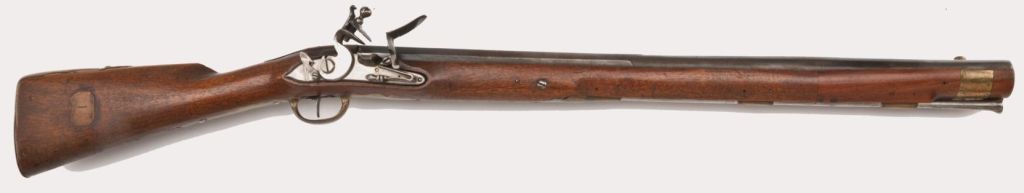

Just for Information: There has been a blunderbuss-gun introduced in the Austrian cuirassier-regiments. 12 men of these regiments used so called "trombones M 1759" with a horizontally very wide muzzle. These guns had brass mountings, whereas the following model of the same characteristics but with iron mountings was introduced in 1781. These guns were loaded with 12 small bullets or hacked lead.
corrado26

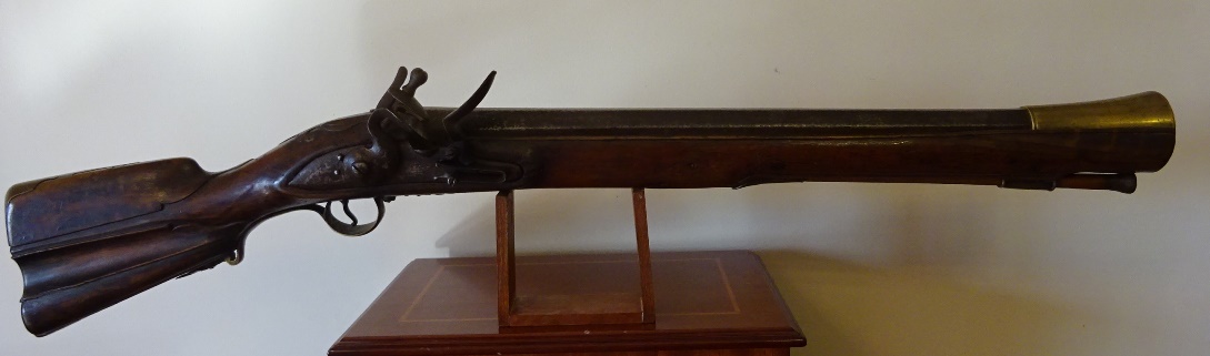

... There has been a blunderbuss-gun introduced in the Austrian cuirassier-regiments. 12 men of these regiments used so called "trombones M 1759" with a horizontally very wide muzzle ...
Suggestive example, corrado; thanks for sharing it. If i may say, this one falls into atypical connotation, both because blunderbusses generally have flared muzzles and its nickname trombone doesn't reflect its actual barrel shape ?.
But speaking of muzzles, one may consider the 'duck beak' version (as we call it here), in a French example of the XVIII century, here scanned from the catalogue of the Ducal Palace of Vila Viçosa (Portugal).
From the same armoury, we may also appreciate an English fortress/navy blunderbuss, from the same period, with a rather 'scary' muzzle.
... and another example for a similar purpose, this time Portuguese, from the XVII-XVIII century, with a steel octogonal/tronco-conic barrel with silver decoration, equipped with prominent brass sights, an iron swivel device and a typical Portuguese lock.

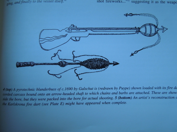

As Jim has already mentioned blunderbusses were widely used at sea in many sizes. From swivel mounted for the ships rails and small boats to hand held for boarding parties.
A 1797 list of equipment requisitioned for the first three US frigates - United States, Constellation and Constitution with around 40 guns each - included 44 blunderbusses. Approx 1 for every 3 guns but by 1822 the navy allowance was recorded as 1 to every 10 guns.
Similar to coaches the ease and speed of loading on a moving platform or small boat must have been a major advantage. Although it is said that a trained shooter could discharge 3 musket rounds a minute from a standing position, the rate of fire was lessened for kneeling or sitting.
This drawing of a Pyrotechnic Blunderbuss is from 'Boarders Away' and was apparently widely used by the Dutch. The dart was set alight before firing and the chains and barbs were designed to catch in the sails to set them on fire.
