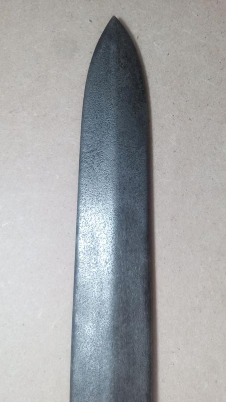

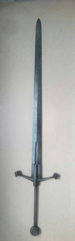

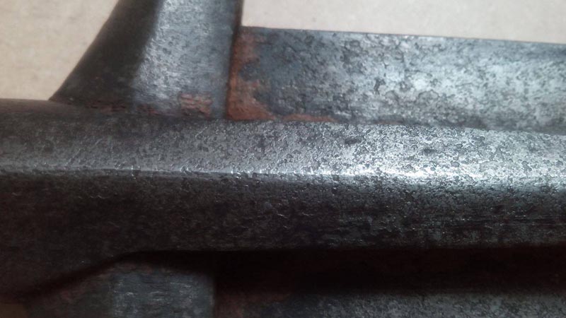

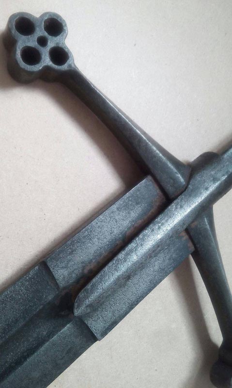

Smile determination of the authenticity of the sword

My opinion, modern build.

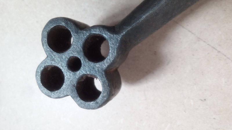

What confuses you in the sword? What are the disadvantages?

3. Very uniform, shallow pitting across all components.
2. Style of blade.
1. The realization that period claymores are extremely rare such that the odds are very much stacked against antiquity for any recently appearing example.

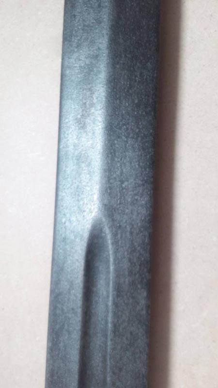

The edges of the fullers are much too straight and regular, what is not possible without a modern machinery. So I think this sword is far away from beeing original,

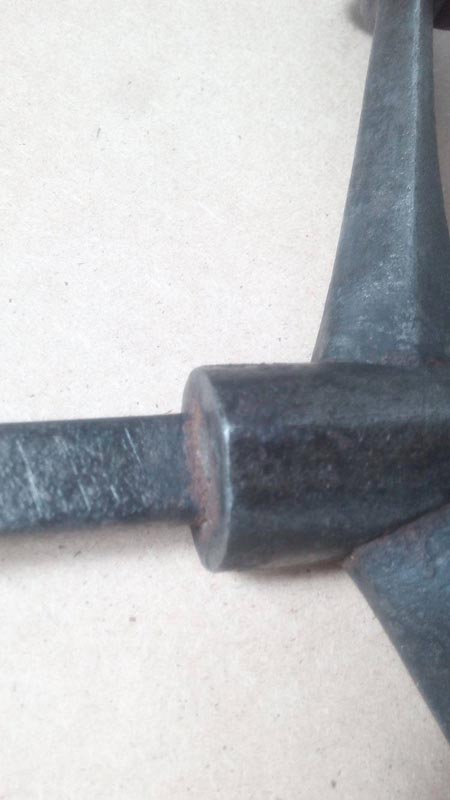

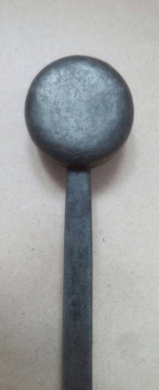

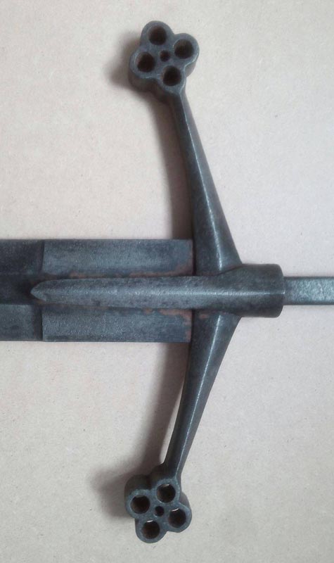

Almost everything is wrong; the pommel should be strongly bossed, not a bevelled disc; the collar and langets should be forged in one with the quillons; the langets should be slimmer and tapered; the quatrefoils are too thick; the blade should be flat or lentoid in section, not diamond; the ricasso is stepped down much too abruptly; in short it doesn't look right! Quite apart from the fact that virtually all Scots Highland two-handers are known and most are in public collections. Sorry.

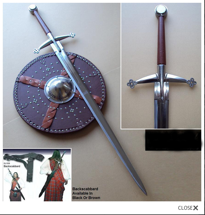

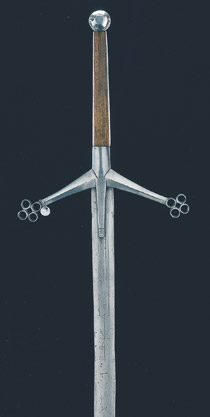

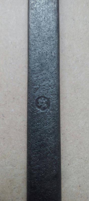

the multi-part guard-bolster-languet and the very crisp square ricasso and the fuller going thru it are interesting*. attached is a current sword available very cheaply - who is copying who? it (the new one) does seem yo lack the stamped mark tho.

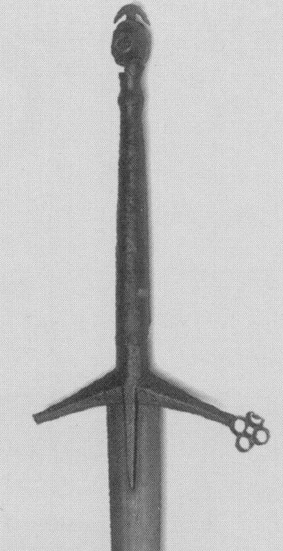

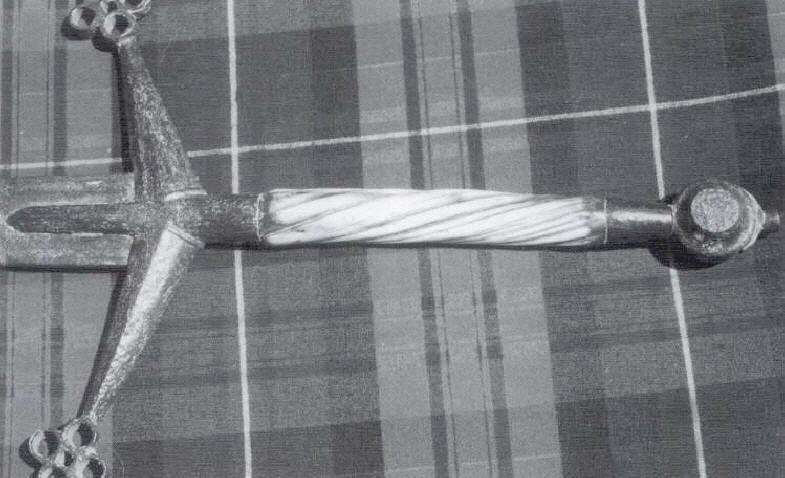

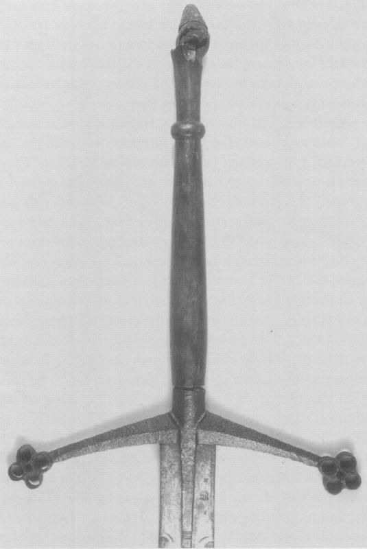

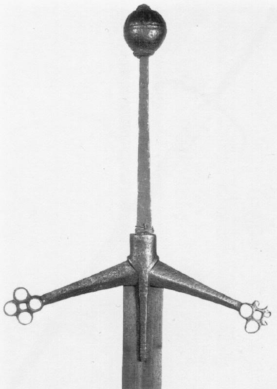

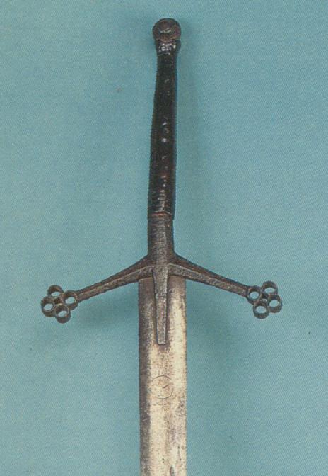

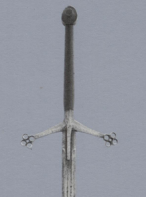

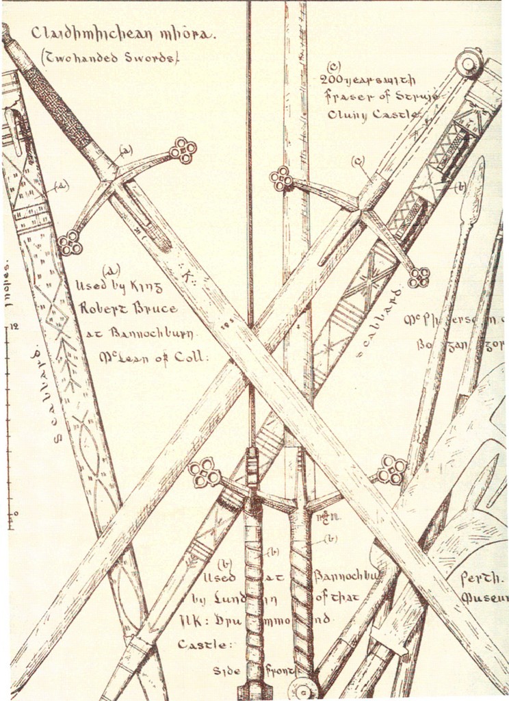

I believe that the sword from post 1 is a recent copy. see some comparisons
PS:also note the scabbards of these swords on the drawing!
best,
Jasper

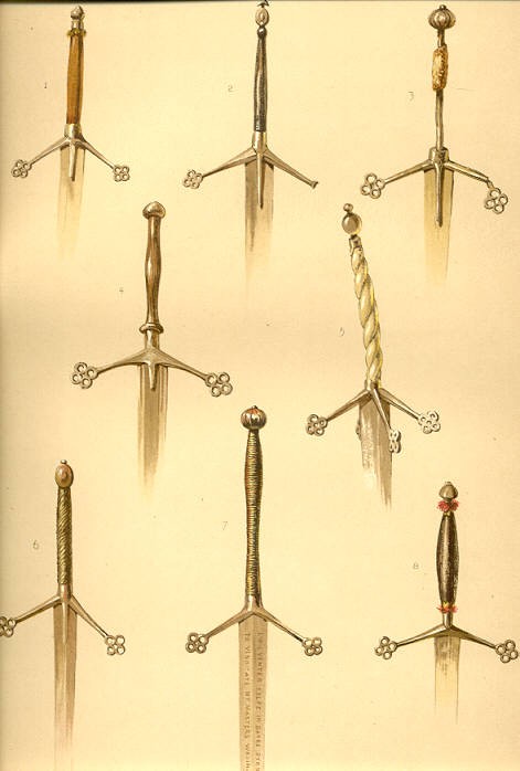

Old 5th September 2016, 06:49 AM   #10
cornelistromp
cornelistromp's Avatar
Join Date: Mar 2009
Posts: 1,071

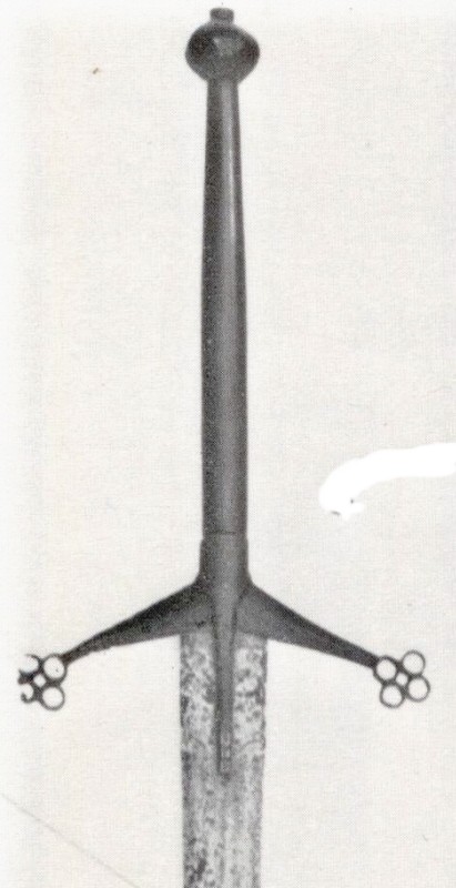

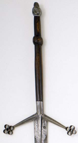

1 more

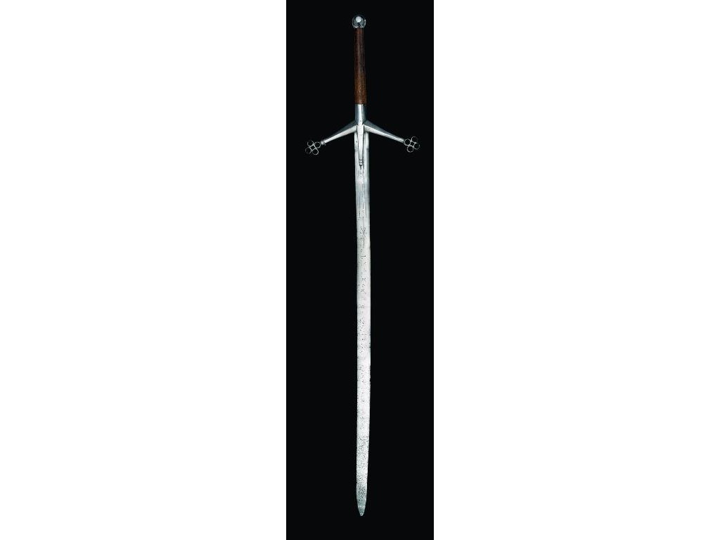

It can be the sword of the 19th century? (The Castle copy)

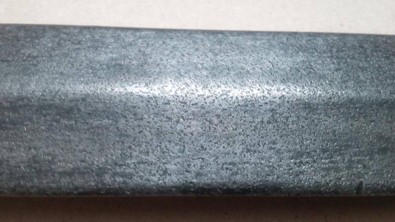

I fully agree with Neil, "Almost everything is wrong with this sword"
This is so obvious and I'm sorry to say the sword is not 19th C either.
Its a modern partly machine made sword reproduction, aged with acid treatment and its easy to see.
The metal is etched all over from applying the acid on the surface, on this modern mono steel this gives an even etching which can mistakenly look like old pitting.
kind regards
