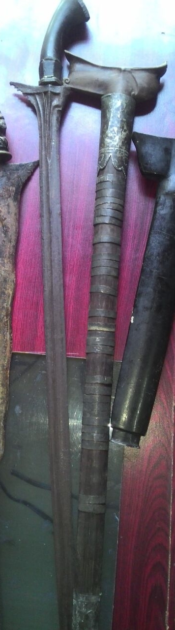

Hi everyone,
I am new to keris. I hope that you help me identify this one old keris which I have no idea the type of its warangka which I believe is Sumatran. It has little round carvings to it maybe significant to certain area or just addition to major warangka styles. Thanks

Hello Loyah, welcome to the forum!
Congrats, nice find - that's an interesting keris panjang!
The blade seems to have good age with expected wear to the greneng. Nice fullers! The blade exhibits some details that deviate from the typical Bangkinang style. A close-up of the base of the blade would be good - please make sure to take the pic exactly from above (vertical to the blade surface) to avoid distortions.
Looks like a really old scabbard, too. I can't remember having seen this variant before - details may help to place it though: I'd like to see close-ups from the other side, especially of the cross-piece as well as of the foot/tip. Close-ups of the hilt would be great, too.

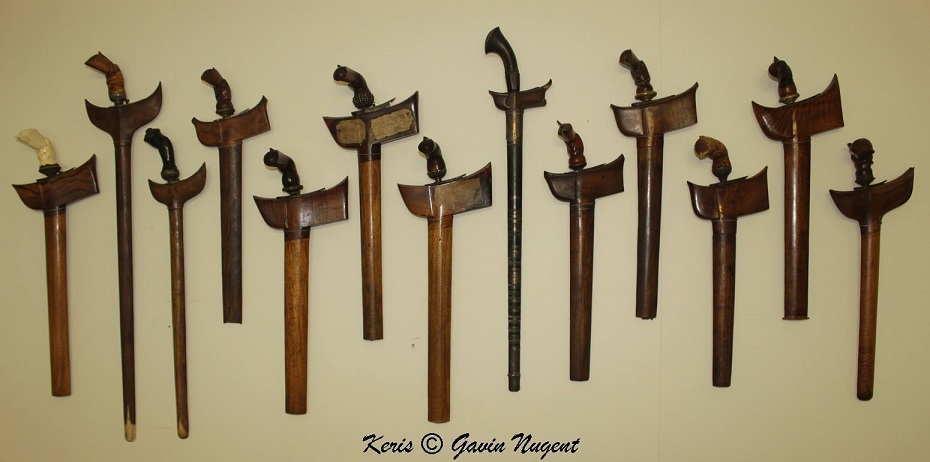

Originally Posted by Gavin Nugent
Welcome Loyah,
That is a nice Keris. The hilt type I have seen in various panjang dress, I recently sold one like it, have seen others but have also kept one like yours in my collections too.
I look forward to hearing what those with more experience in Sumatran Keris Panjang have to say.
Gavin
nice collection **
Old 21st July 2016, 01:41 AM   #7
Gavin Nugent
Gavin Nugent's Avatar
Lose one or gain one Gavin.
With that number you're really tempting fate.
It is but a small part of them Alan, my money is always on odds :-) It is one of my lucky numbers :-)

Originally Posted by loyah
Thanks for the greetings guys,
I am aware that the forum members have very beautiful keris photos postings.
Sorry . I only have that one picture for reference for the time being,
I must say it almost 90% if not identical resembles the one that Gavin has in his collection. Rings / cincin on the sarong. Should have been that beauty under good hands.
This keris belonged to my ancestor. tracing the family lineage.. the warangka style maybe from Siak , riau , bangkinang to Minang.
almost similar style is keris kusriwa. which is said from kelantan malaysia
regards
Loyah
Loyah,
My initial searches in to this keris type origins lead me to Minang regions... but the more I looked, I also found similarities in Palembang carving too...so the more I looked, the less I knew.
Zonneveld, figure 205 is also from this group of keris, from the collection of WILLEN VAN DER POST.
Further discussions here, I am sure, in time, will reveal more about the specific origins.
To quote Robert Palmer, "Ooh, I'm looking for clues"
Gavin

i've never seen a keris panjang having tikel alis and sogokan like this before.
i'm fascinated and curious. this is a new experience for me
Yeah, this keris panjang is different from the standard pieces from Bangkinang/ Riau from the blade (sogokan and tikel alis), the shape of the sampir (not dua hari bulan), the gandar with wide silver rings and a flat tip?, and the shape of the tapak kuda hilt. I visited Bukittinggi (Minang country) 20 years ago and remember to have seen some keris panjang with similar features (gandar with silver rings especially) so it may be correct to attribute the origin of this keris to this region.

It is a Minang Keris Panjang, and most probably a quite old one, pre-19th cent. or even earlier. This could be a blade for which Minang were famous - "At Menancabo excellent poniards made, called creeses; best weapons of all Orient" (Argensola, 1609). Marsden is a good lecture on this subject.
Another variant of this type of Sampir posted recently here:
http://www.vikingsword.com/vb/showthread.php?t=21714
Regarding this Sampir style Dave Henkel a while ago wrote:
"Properly speaking this sampir style in Kelantan is known as a sampir "pucuk kacang". My understanding at this point is that the term Ku Sriwa is an attribution to a group of kerises with this style of sheath to an aristocractic Kelantanese of that name. Ku (Tengku) Sriwa is supposed to have lived around the turn of the 20th century and is reported to be an historic figure."
