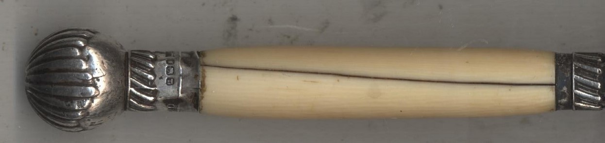

Any opinions on this knife handle as to the material. The silver mounts are Sheffield hallmarked for 1886 .

Posts: 1,435
Ivory
Old 20th June 2016, 02:52 PM   #3
thinreadline
thinreadline's Avatar
Join Date: Nov 2010
Location: Wirral
Posts: 1,204
Ivory
Thank you Colin .... may I ask how one tells ?
Old 20th June 2016, 04:36 PM   #4
Colin refer to the Schreger lines. But I've seen a similar dagger with an early sort of plastic which imitates this Schreger lines. Can you use the hot needle test at an unvisible place?
Old 20th June 2016, 05:10 PM   #5
thinreadline
Join Date: Nov 2010
Location: Wirral
Posts: 1,204
Thanks Detlef , tried that and no its not plastic ... I didnt think they would use silver hallmarked mounts on a plastic grip , but you never know of course .
Old 21st June 2016, 09:55 PM   #6
asomotif
asomotif's Avatar
Join Date: Nov 2006
Posts: 2,238
Ivorine, as used on kitchenknifes, can look very much like this.
Sometimes including the lines.
However, I think that ivorine would not crack like this handle
Willem

I don't think this is ivory. Some translucence along the edges of cracks, dings, and scratches causes ivory to typically show hotter coloration there (red and orange, not black as is shown here). I think the grain is also too strait (with no intersection) and uninterrupted. Have you done the rub test?
What is the rub test ?

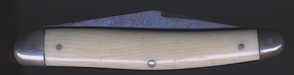

Berkley
Berkley's Avatar
Location: Austin, Texas USA
Posts: 257
The regularly alternating dark and light lines are characteristic of the type of celluloid known as “French ivory”, first made in the 1860s and often found in knife handles.
(Shown is a knife with French ivory scales made by George Wostenholm of Sheffield).
Impossible to say what environmental or traumatic effects caused the longitudinal fracture. With as much certainty as possible from merely photographic evidence, I vote “not ivory”.
Old 24th June 2016, 03:04 PM   #15
thinreadline
Join Date: Nov 2010
Location: Wirral
Posts: 1,204
All very interesting but wouldnt celluloid melt when a hot needle is applied ?

I don't think ivorine would crack like that, but ivory will. At least I've never seen cracks on table knives with such ivorine handles...
Old 25th June 2016, 12:27 AM   #17
Posts: 7,415
I have to agree with Colin on this. These has been my observations as well.

A cursory Google search for “cracked celluloid” seems to indicate that it is a problem, at least among fountain pen collectors. However, thinreadline is certainly correct that a hot pin should have shown a positive reaction - in the case of celluloid, that could well be in the form of bursting into flames.
All of which reinforces the difficulty of identifying ivory from a photo on a computer monitor. Sadly, my own collection has several pieces where my optimism proved to be mere wishful thinking when the item was in hand.
Old 25th June 2016, 05:40 AM   #19
Shakethetrees
Shakethetrees's Avatar
Join Date: Apr 2014
Location: Louisiana
Posts: 363
Ivory.
I have seen a lot of both, and ivory is the only material that would crack like this.

Hi. Ivory vs bone is easy. Bone has tiny holes that you can see under magnification.
The "Hot wire" test is good for distinguishing between plastics and ivory though not all plastics will react clearly.
Barring fakery, I would bet on ivory. Also, Ivory cracks as an almost natural occurrence, plastic does not except under stress.
