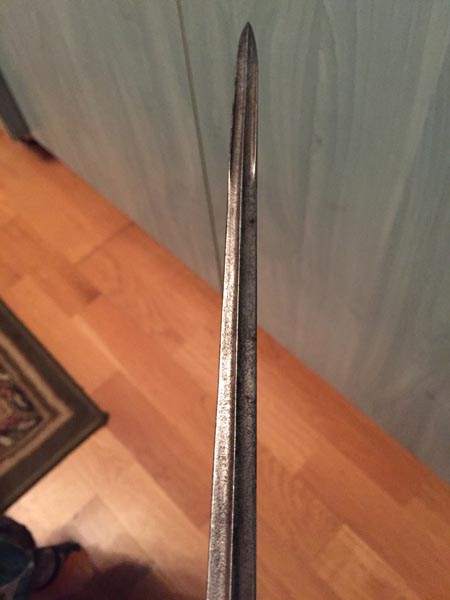

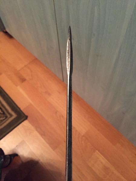

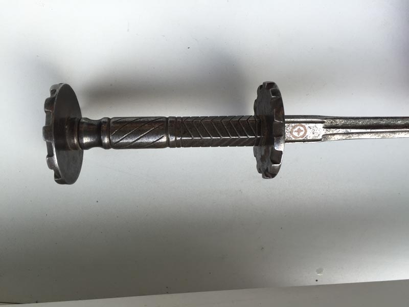

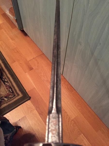

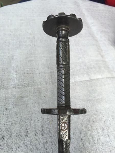

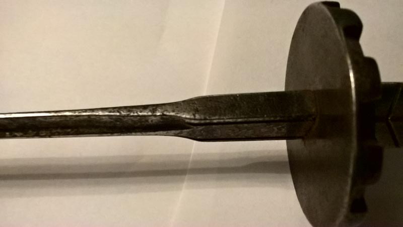

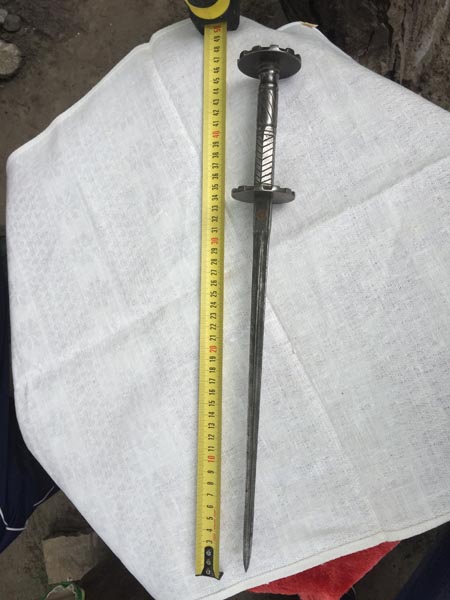

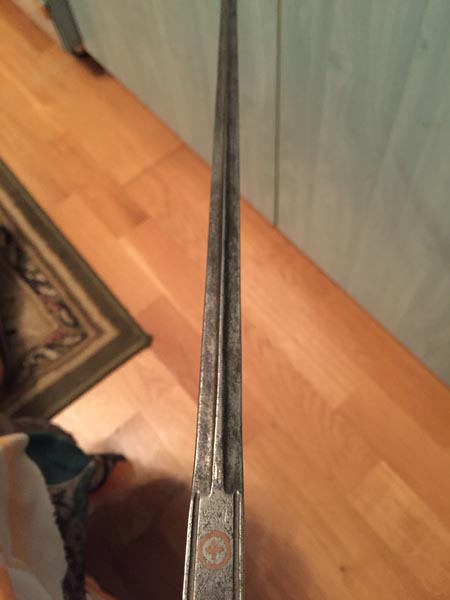

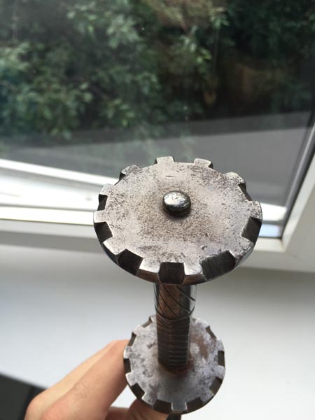

Hello colleagues by collectors, I recently bought a dagger in one of the old collector and want to know your opinion.

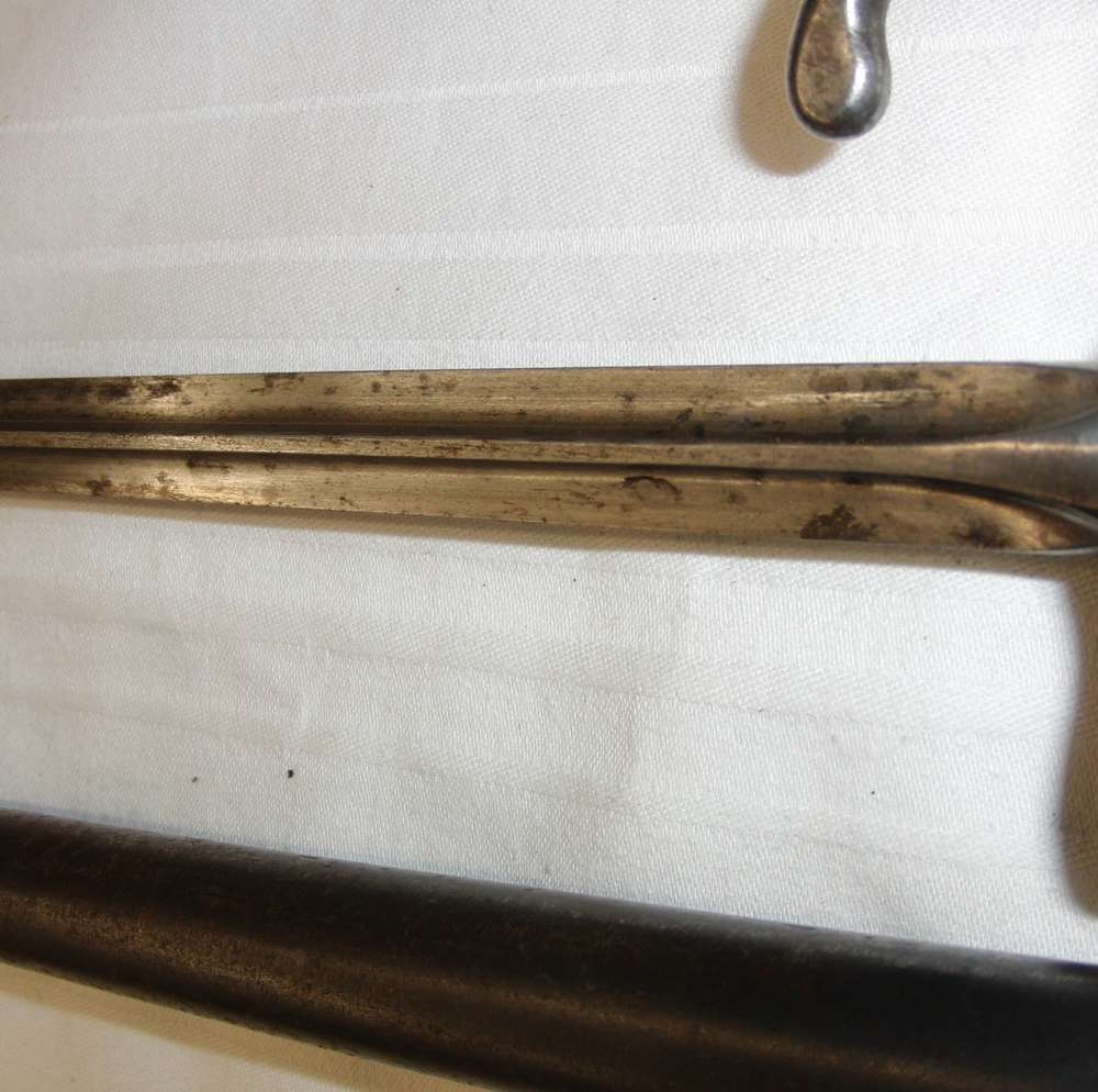

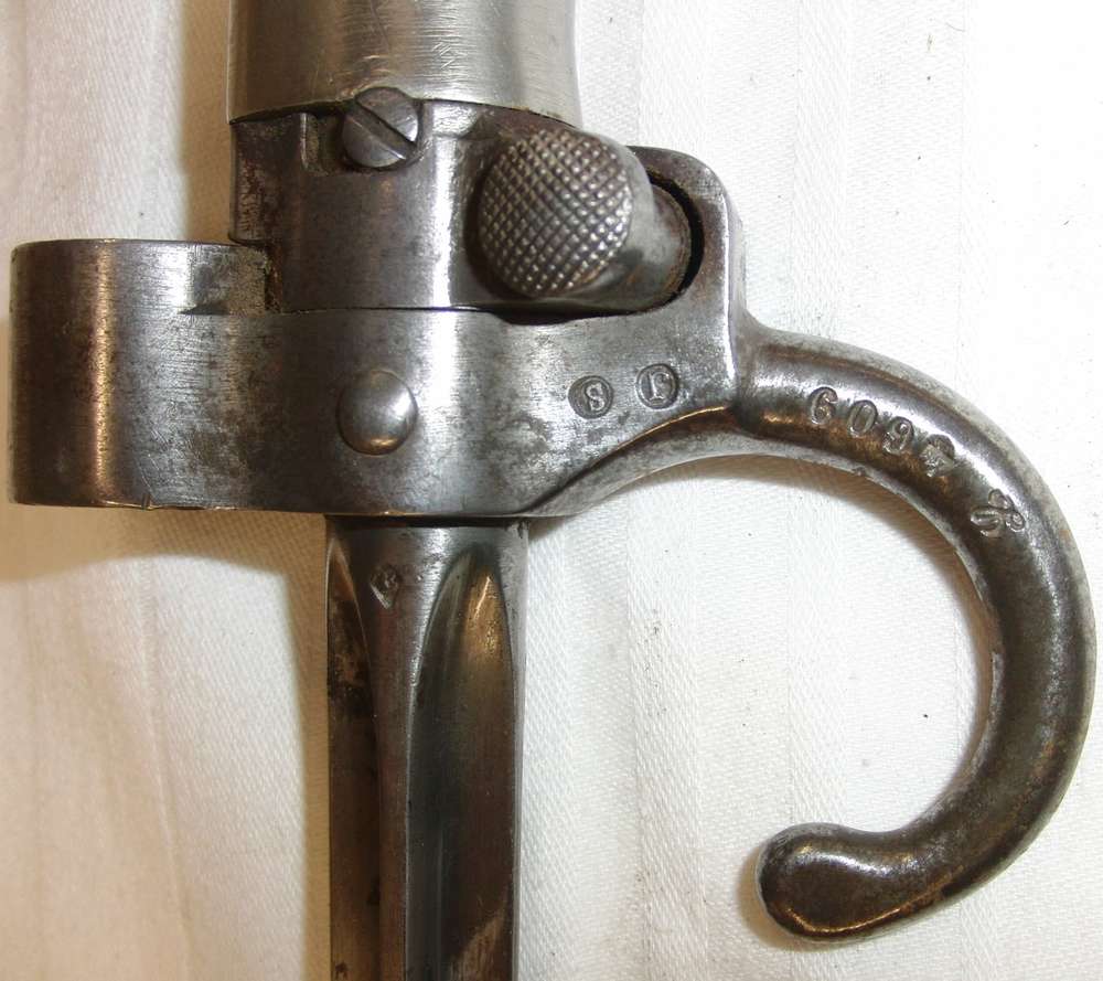

I think this item is a not very old piece. At least the blade is probably made from the blade of a French Lebel bajonet M 1916. Compare the added fotos please.
corrado26
The Lebel has a round base, but the rondel dagger has a rectangular tang.
The dagger is either from 19th century historicism but more probably a genuine piece from 14th to 16th century in very well condition.
If the dagger is real, it is an very extraordinary well preserved piece and pretty rare.
Roland

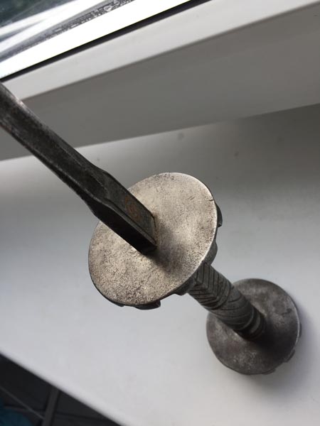

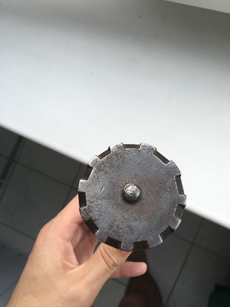

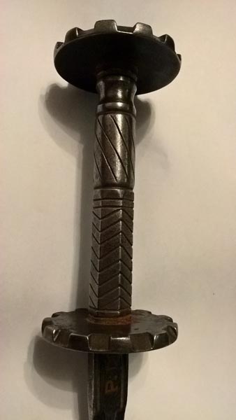

The blade looks to me to show signs of being older but a shortened blade coming from another source. Maybe a 19th C bayonet from something else? The guard and pommel look to be newer. Maybe some better pictures of ends of them?
Today it should not make great problems to get a rectangular base out of a round base by help of heat and high pressure. Sorry, but for me this dagger is a fake.

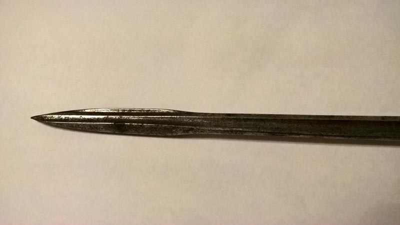

Posts: 32

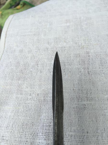

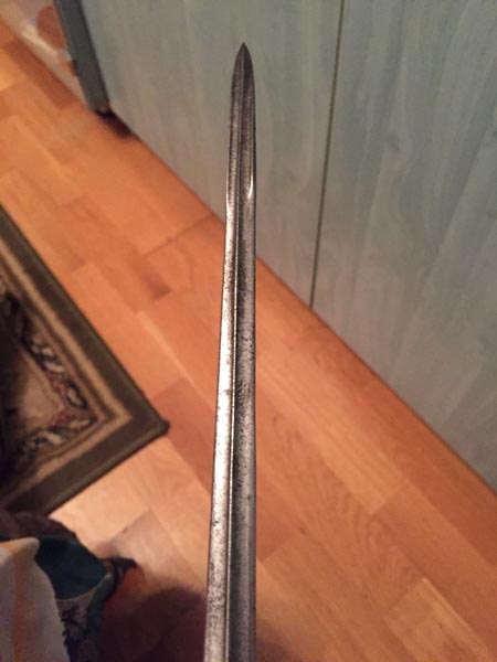

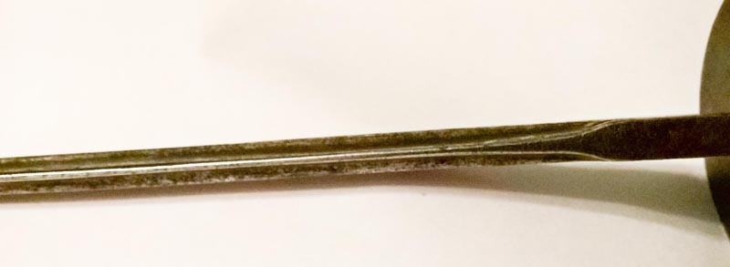

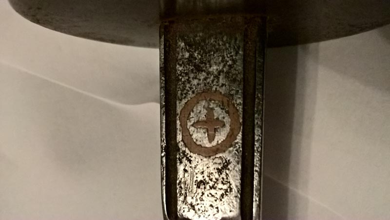

more photo

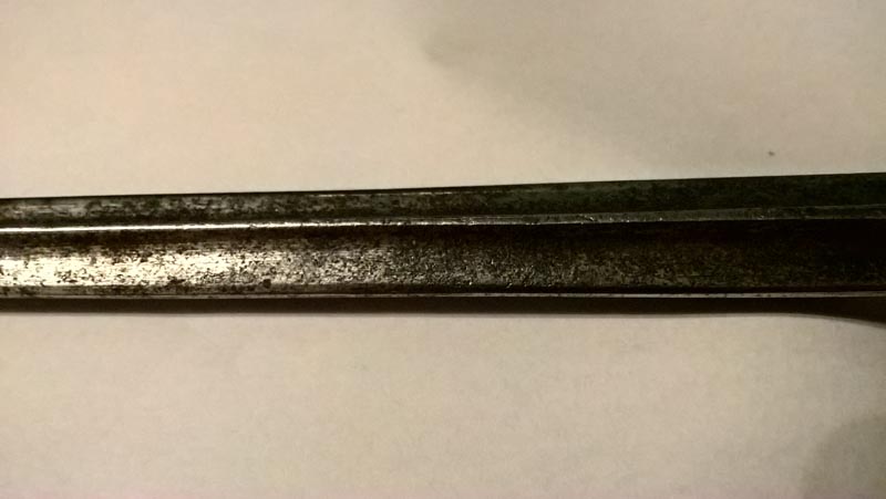

Posts: 32

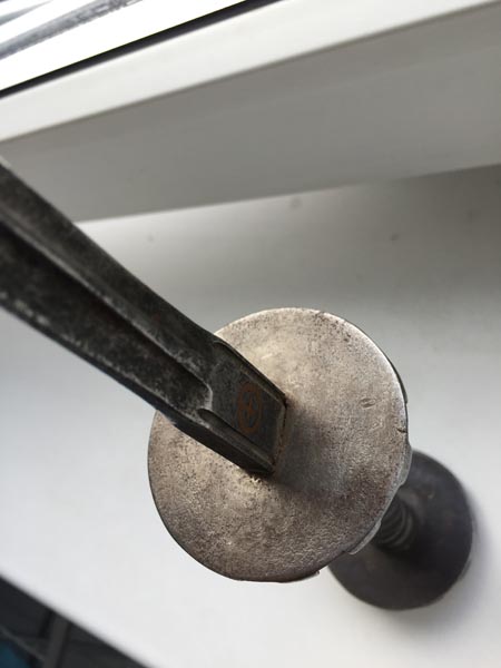

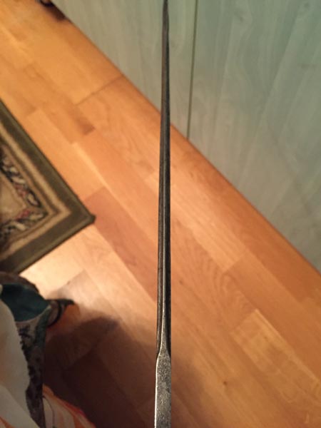

more foto

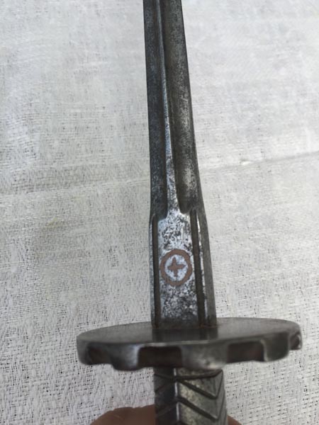

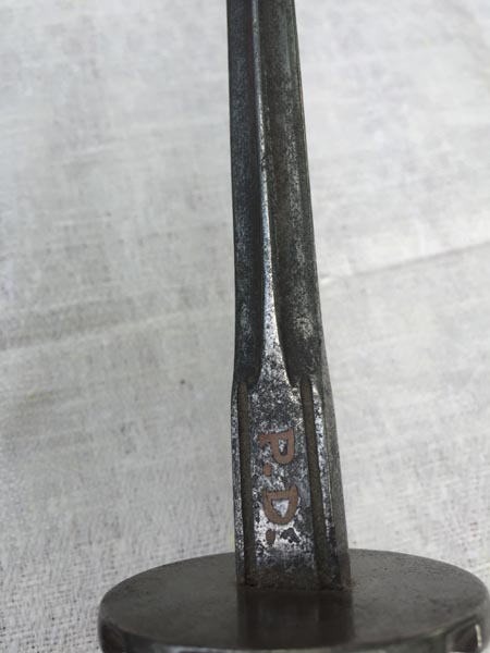

It looks to me to be an interesting assembly of previously unrelated parts.
The blank surfaces of the pommel and guard do not seem to belong on the same object as the hilt, which itself can't seem to decide how it intends to be decorated. The cruciform marking is not in keeping with the other decoration.

Looks modern to me.

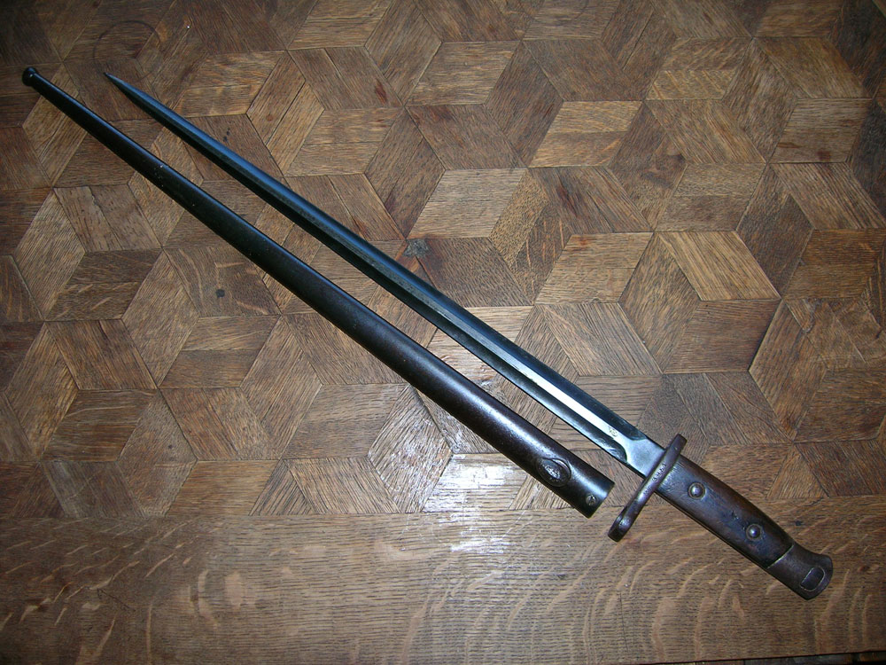

Oh I understand, the collector was old, the friend was old, so the dagger must be old too. May be, but the bajonet M 1916 is old too
corrado26

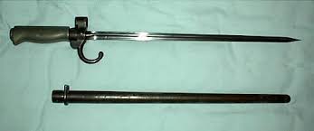

No reason to be cynical. How about a picture as a clear evidence of your bayonet-theory?
Here is your M1916. Are you really sure, that this is the same blade?
Roland

This is not a M/16-LEBEL bajonet! Look at the foto of a Lebel-M/16 and compare
The Lebel has a round base but the base of the dagger is rectangular!
The middle ridge of the Lebel is thicker than the dagger and finally the tip is completely different.
I am sure, this blade doesn't come from a Lebel or another well known mass produced bayonet.
Roland

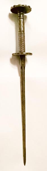

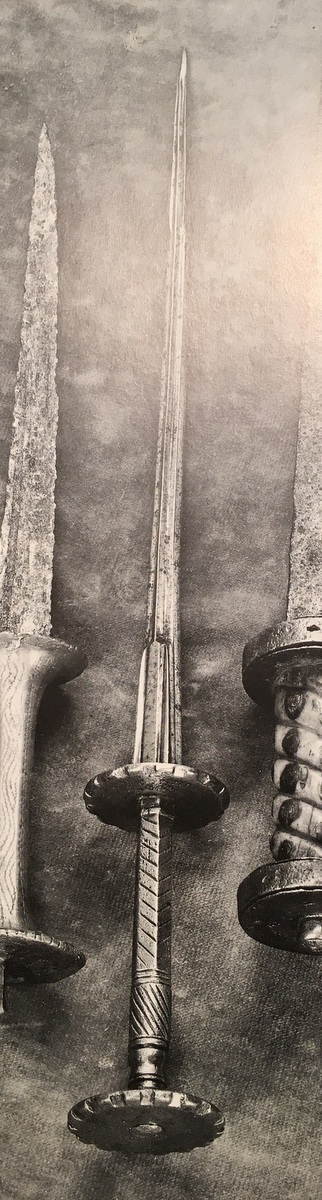

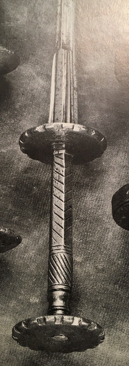

the dagger under discusion is a well kknown type of all steel roundel dagger , Germany around 1400.
this type of stabbing dagger is Long, around 40-42 cm.
see pictures of the same type
based on the Pictures, marks, excecution and extreme length, I tend with dating of this dagger more to a later reproduction, I think i have seen the dagger before but cannot remember where it was.
Old 18th June 2016, 04:30 AM   #20
M ELEY
Location: NC, U.S.A.
Posts: 2,236
Good catch, Jasper!! I agree that it looks much newer. Historismus?
Mark

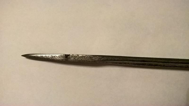

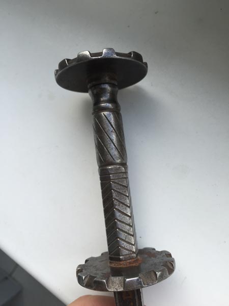

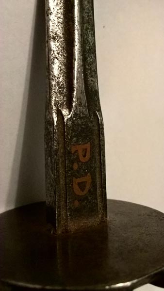

add photos from another phone
