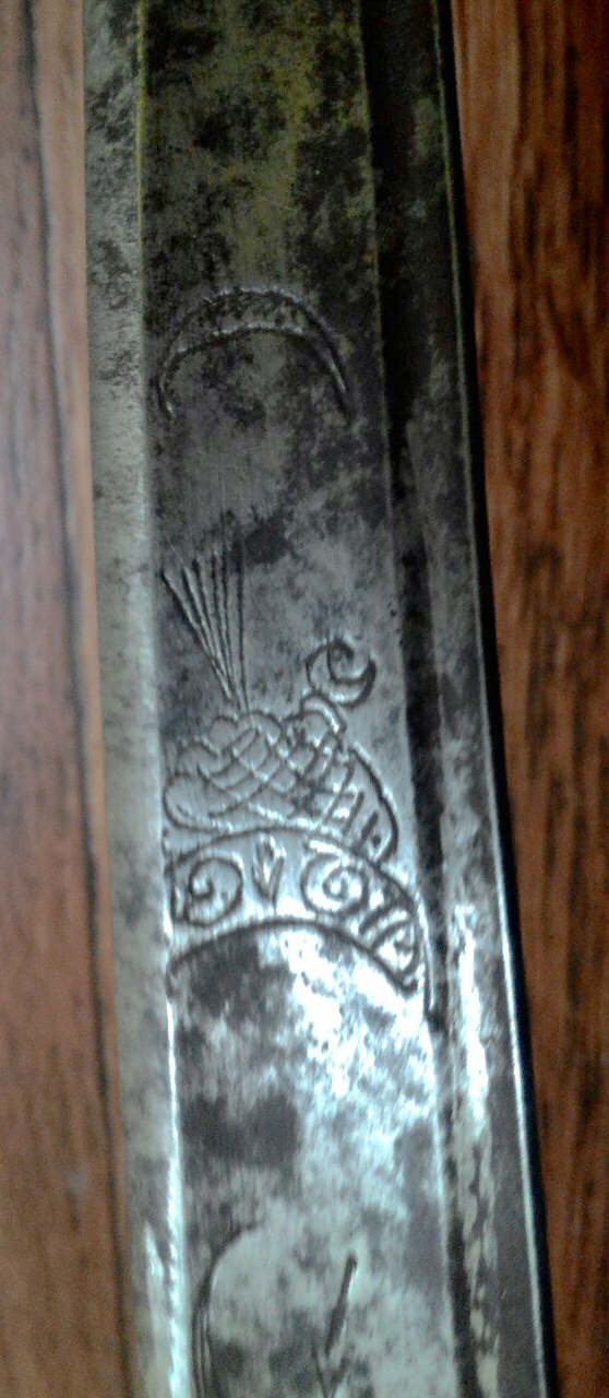

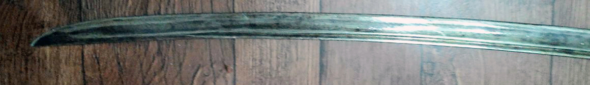

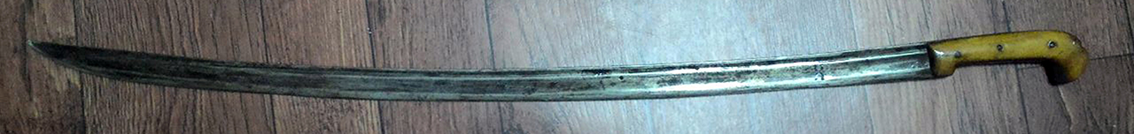

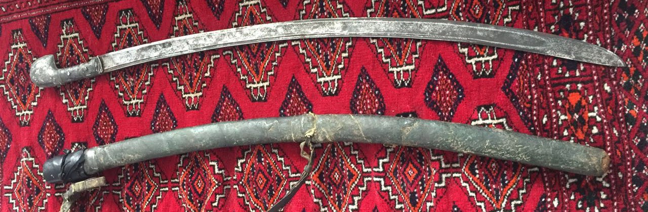

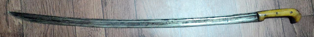

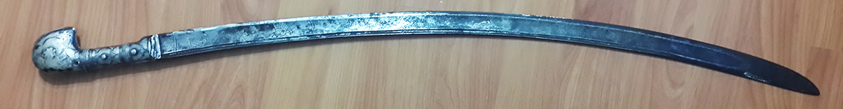

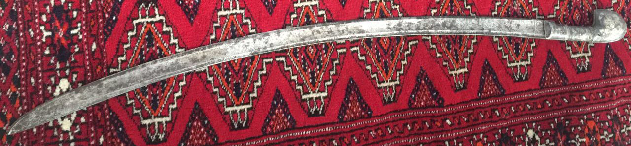

Hi all. I am a fan of this forum for years, as a member recently, and this is my first thread. I have two shahkas, here I would like to share. By the way, I am no collector or seller, but just a Circassian with two shashkas and two kindjals only
For the first one, what I can say, is a European blade mounted in Circassian(?) style. The blade is probably Solingen, a Hussar(?) blade, somehow appeared in the Caucasus. However, I cannot say more, as you will see, there are series of motives I could not figure out, including the thread http://www.vikingsword.com/vb/showth...t=early+makers
The hilt is being repaired now, and the scabbard was repaired a few times, but not recently. What I am curious about is the origin and the date of the blade. Is there anyone who can help me with this? I would really appreciate any comments, for I could not find any details by myself.

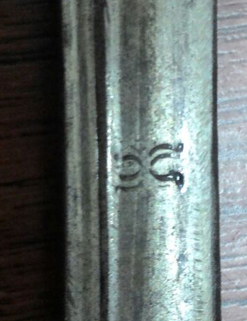

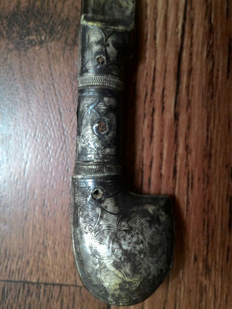

The second is a modest one, with a double horse-shoe like mark.
Thanks for any of your contributions.
Best.

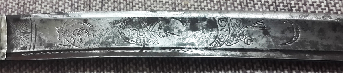

This is an other figure I forgot to attach in the previous post. May be helpful for dating. Thank you very much.

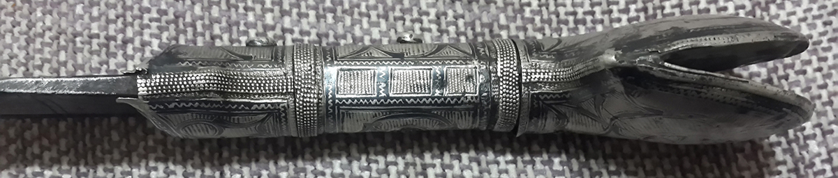

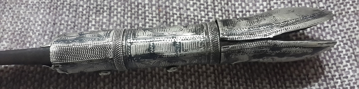

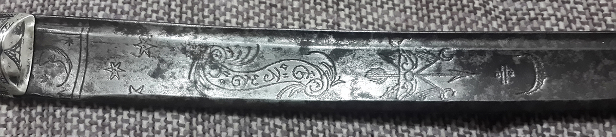

Yes, it is a Circassian style. The blade is indeed European, likely Solingen, 17-18 century. These blades were used and reused, and it may have its second or third furnishings. The blade has either been narrowed to start with to fit the handle, or was sharpened many times. Large parts of the engravings are lost.

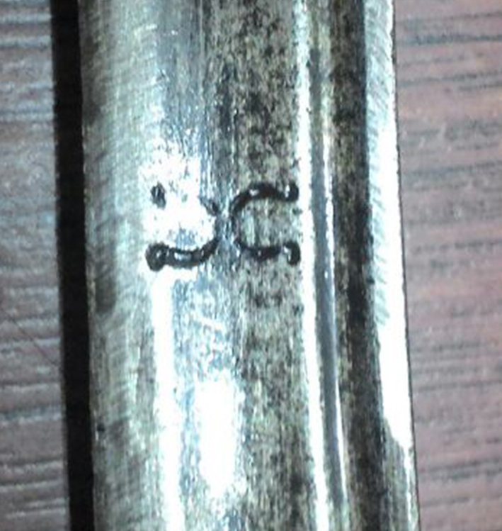

I cannot see your second one very well, but it seems from your description that the blade may be marked with gurda: originally Genoese mark that became a world- wide mark of trade blades for the "Orient". Would love to see the details of the handle and the blade. Hopefully, I might even get smarter:-)
I like these old and worn-out ones.

Thank you very much, Ariel. I am going to take better photos, not by a phone and post again. About the second one, I do not think it is Gurda, at least it does not seem to be any of the versions I have seen on the forums do far. I will post better photos, soon. The date in my mind for the European blade is the ends of the 17th century - not knowledge, just feeling

We are in agreement about the age of the European blade.
Waiting for pics of the second one:-)

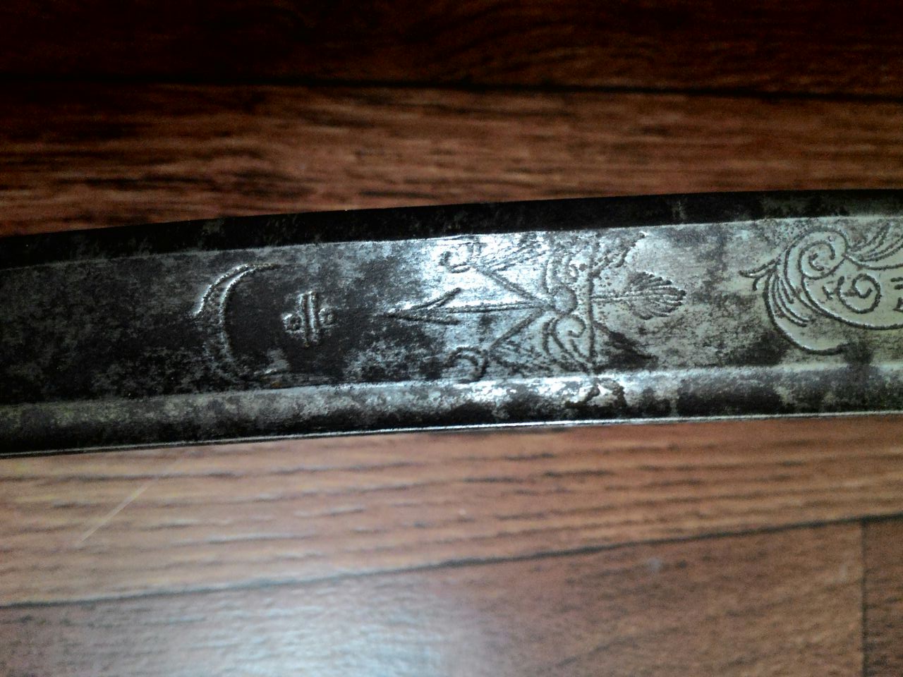

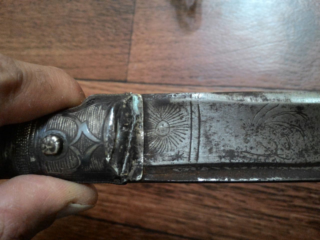

I agree with the Circassian probability on these, and that these are European cavalry blades. While they of course may be Solingen, I feel due to the curious motif that they may well be Hungarian blades. This is to the similarity of the talismanic and magic associated devices and motif which may relate to the so called 'Transylvanian knot' which collectively refers to some of these. According to Ostrowski (1979) discussing Polish sabres, many Hungarian blades came from Styrian sources rather than Solingen.
Finding these kinds of blades mounted in these wonderfully interesting shashkas makes them all the more intriguing in my view.
Ariel, would I be correct in assuming that Circassian examples would be more likely found with European blades, while the 'gurda' ; 'ters maymal; kaldam etc. would be most commonly on Chechen and Daghestani swords?
Old 6th June 2016, 07:19 AM   #8
Circassians got most of their blades from Crimea and European exports.
But there are Daghestani blades with obvious European provenance. I have a Daghestani one with old German blade.
It's late ( 2 am) and I am too tired to look, but Astvatsaturyan cites a Russian traveler who was dumbfounded finding piles of old blades in a Daghestani workshop: Genoese, Andrea Ferara, Solingen, you name it... But in general you are absolutely right.
The same Astvatsaturyan writes that most of the so-called "Hungarian " blades " Vivat Hussar" were in fact German. Just as most blades with Genoese "jaws" these days are found on Indian tulwars. Follow the money:-)
Arabs prized Hungarian blades very much, called them Majjar ( Magyar). Little did they know :-)

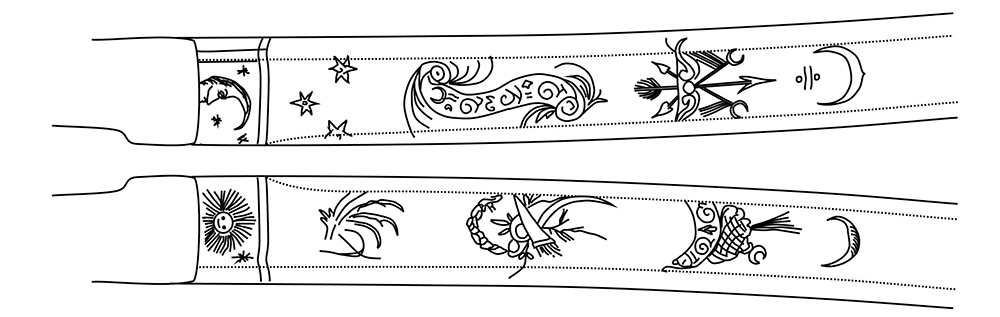

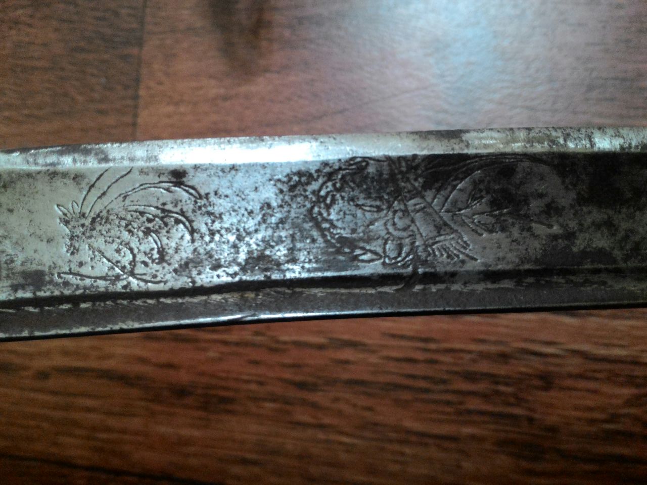

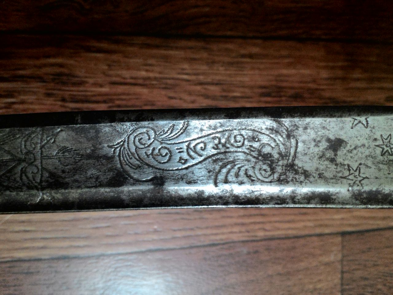

Thank you Ariel and Jim. Now I am going to add the better photos accordingly, beginning with the European blade. The "Transylvanian knot" Jim mentions is important I think, for there are some carvings that look like inscription, but hardly I can interpret these, and they do not like any script I know. Maybe my ignorance.

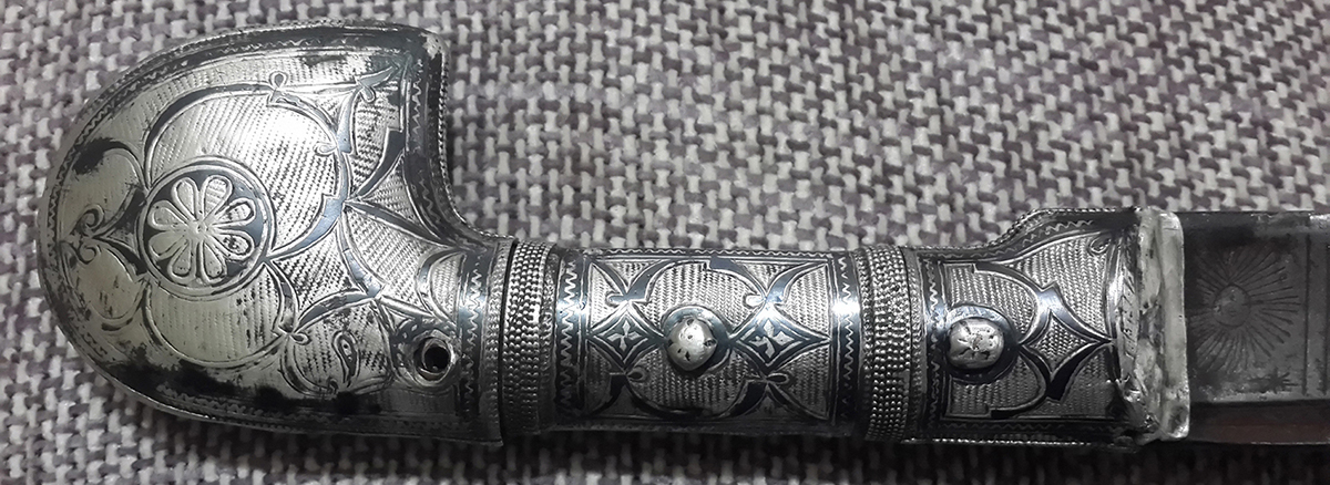

Here goes the European blade first. I thought it would be better if I added a drawing of the figures, to have a better idea, for the origin or a more precise dating. I also add a photo of one of the silver fittings on the belt, possibly old Circassian style.

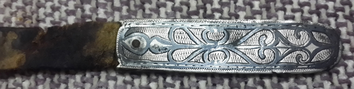

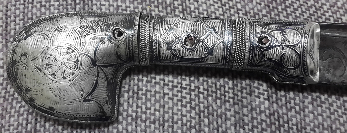

Here is one of the silver fittings on the belt.. Unfortunately, most fittings were silver plated copper, and they are in a terrible condition. Only the silver ones survived.

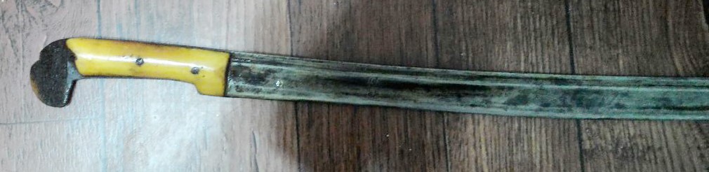

Join Date: Jan 2015
Posts: 26

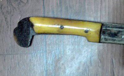

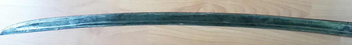

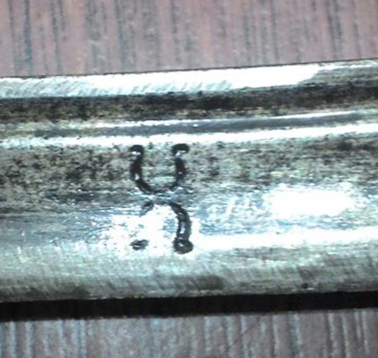

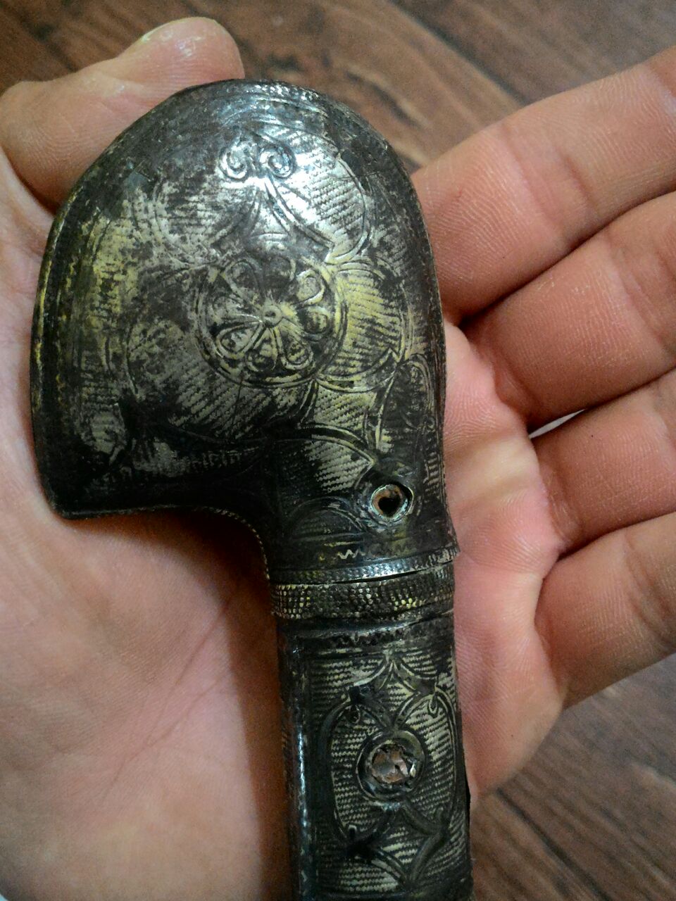

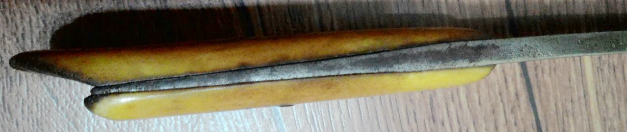

Here is the photos of the second one. I tried to do my best. As I mentioned, I did not find any parallels for this mark on any blade (but surely I am no expert )
The bone handle is poorly preserved, some part loosing. Please note the extension of the iron (like a hook) at the very end of the hilt.
