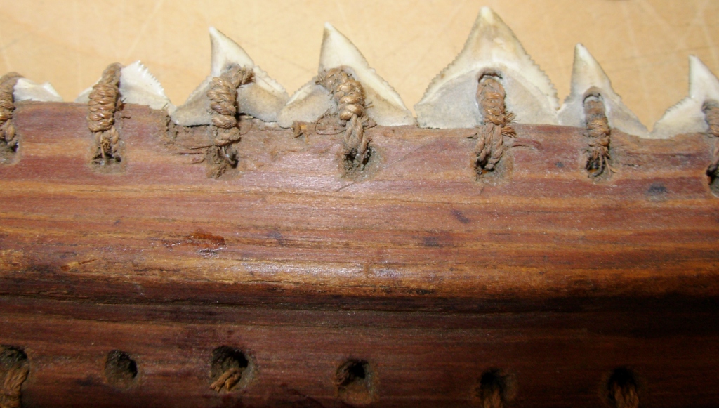

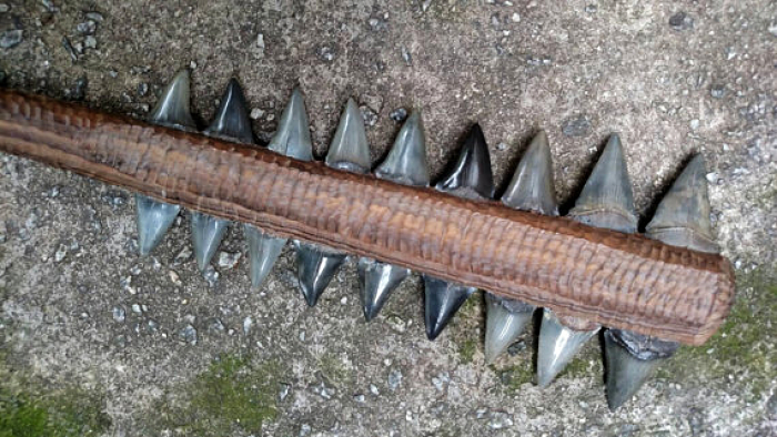

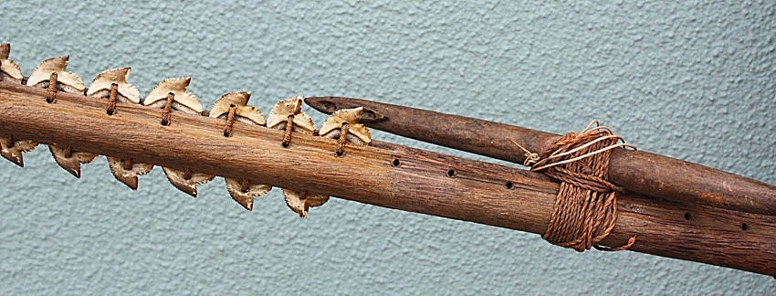

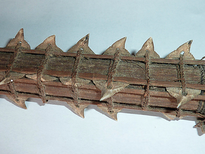

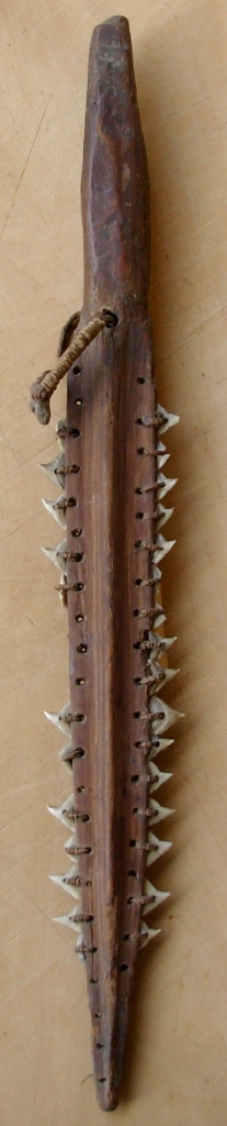

good evening

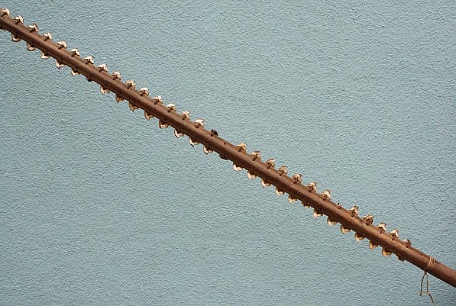

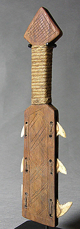

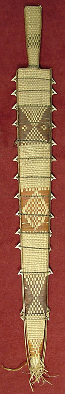

Would like to like to show you one of my favorites. Length 39.5 cm Width 4.5 cm
Have a few questions about this shark tooth weapon.
where those weapons come from everywhere? (according to Stone, Kingsmills Island)
what kind of wood that could be and what kind of shark teeth that might be?
how old the weapon be?
is the condition good?
how rare something?
Many thanks for any help
gruss chregu
Old 21st February 2010, 10:06 PM   #2
DUE TO ITS SIZE IT FALLS INTO THE CATEGORY OF DAGGER, I WOULD ESTIMATE IT TO BE NO NEWER THAN THE 1930'S AND IS LIKELY OLDER. IT IS IN GOOD CONDITION FOR ITS TYPE AND AGE, THE CORD BINDINGS AND SHARK TEETH BECOME BRITTLE WITH AGE AND WHERE THE TEETH ARE DRILLED ALSO WEAKENS THEM.
THE ISLANDS WERE CALLED BY SEVERAL DIFFERENT NAMES OVER THE YEARS MARSHALL ISLANDS, GILBERT ISLANDS, KINGSMILL ISLANDS AND NOW ARE CALLED KIRABATI. ONE WAY TO GET AN IDEA OF AGE IS BY ANY WRITINGS ON TAGS OR PROVENANCE. THE BRITISH HELD THE ISLANDS FIRST THEN THE GERMANS THEN THE JAPANESE AND AFTER WW2 THE USA WATCHED OVER THEM UNTIL THEIR INDEPENDENCE.
I SUSPECT THE SHARK TEETH USED ARE MOST LIKELY OCEANIC WHITETIP OR PERHAPS BULL SHARK. MOST EXAMPLES I HAVE SEEN HAVE ONLY ONE TYPE OF SHARK TEETH BUT IT IS POSSIBLE THERE MIGHT BE MORE THAN ONE TYPE SHARK REPRESENTED ON A WEAPON DUE TO LATER REPLACEMENT. A SET OF SHARK JAWS HAS MORE THAN ENOUGH TEETH TO MAKE SEVERAL SUCH DAGGERS AND THE TEETH ON THE LOWER JAW DO DIFFER FROM THOSE ON THE UPPER SO YOU WILL SEE SOME DIFFERENCES. ON YOUR EXAMPLE THE LARGER WIDER TEETH ARE UPPER TEETH AND THE DIFFERENT SHAPED ONES FROM THE LOWER JAW. THE HOLES DRILLED IN YOUR TEETH ARE CRUDE AND THE FIBER CORD IS PROPER OLD HAND MADE KIND AND THE HANDLE LEFT CRUDE (I WONDER IF THEY WERE ORIGINALLY COVERED WITH SOME SORT OF FIBER WHICH IS NOW MISSING, BUT I HAVE NEVER SEEN AN OLD EXAMPLE WITH A FIBER COVER) ALL OF THE ABOVE INDICATE AGE, THE BLADE IS ALSO PROPPER FOR OLD EXAMPLES WITH THE RAISED CENTER. THE BRITTLE FIBER CORD AND PATINA ARE CONSISTANT FOR A OLD TRADITIONALLY MADE DAGGER. I HOPE THIS ANSWERS SOME QUESTIONS YOU CAN ALSO GOOGLE THE VARIOUS ISLAND NAMES AND READ THE HISTORY OF THE AREA AND PERHAPS FIND MORE ON THE ANCIENT SOCIETY. CONGRADULATIONS A NICE SPECIMIN
Old 21st February 2010, 10:35 PM   #3
fearn
Posts: 1,247
Hi Chregu,
These have shown up previously (here and here among other places). I think they're still making these for tourists in Kiribati.
Name: Tetoanea. Te is the definite particle, like "the" in English (calling it "the tetoanea" is a duplication). Tebutje (Stone's name) isn't a word in I-Kiribati. I-Kiribati is similar to Polynesian languages, in that a consonants always followed by a vowel, and they don't have "j". No one's figured out where tebutje came from, to my knowledge.
As Vandoo noted, it's probably from Kiribati (which is an indigenous version of "Gilbert" from the old name, Gilbert Islands. They didn't have a collective name for the archipelago before, and adopted the English name). On the longer weapons (e.g. te unun), they usually brace the teeth with splints along the base, under the wrapping (look here to see what I'm talking about). The wood appears to be coconut, outside possibility of it being pandanus.
I agree with Vandoo on the teeth as well--they look like they're from a requiem shark which includes both bull and reef white tip.
F
Tetoanea

Chregu,
These shark tooth weapons are truly wicked...I would hate to see the nasty gashes made by a slash with one of these. The Bishop Museum in Honolulu, Hawai'i in the USA has a fantastic weapons collection that are shark teeth lined...that is the extent of what I've seen Thanks for sharing..and comments Fern and Vandoo

hello together
Many thanks to you all for your help.
a piece of information I have forgotten, this weapon I have, together with other objects from a legacy of a captain of the 1915-1925 was purchased at sea. He has brought many beautiful souvenirs to take home from all over the world.
gruss chregu

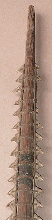

Old 22nd February 2010, 11:15 PM   #7

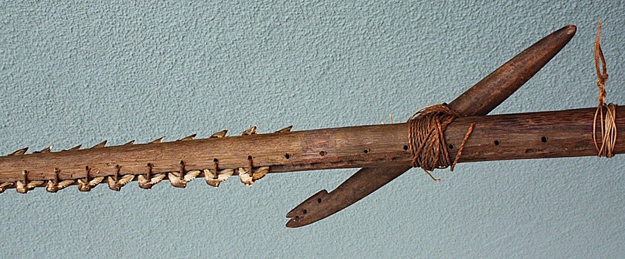

THE DAGGER THAT STARTED THIS POST IS STRAIGHT AND HAS A LANYARD SO I SUSPECT IT WAS ONLY USED FOR A DAGGER. THERE ARE MANY SIMULAR CURVED DAGGERS THAT WERE OFTEN USED AS GAURDS ON THE LONGER WEAPONS AND ARE OFTEN FOUND DETACHED.
A PICTURE OF THIS GAURD IT HAS A SINGLE BUT I HAVE SEEN THEM WITH A DOUBBLE GAURD.

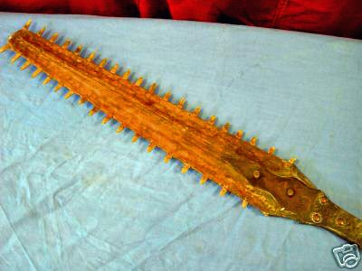

A PICTURE OF A SAWFISH WEAPON WHICH I THINK IS PROBABLY THE INSPIRATION FOR SHARK TOOTH WEAPONS OF THE SORT FOUND ON THE GILBERT IS. IT IS NOT A SLASHING WEAPON BUT ONE THAT INFLICTS DEEP MULTIPLE PUNCTURES AND POSSIBLY BROKEN BONES.
A PICTURE OF A WARRIOR IN ARMOR WITH A LONG POLE ARM I HAVE SEEN A 6 FOOT ONE BUT THIS APPEARS TO BE LONGER.

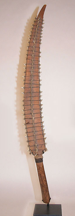

A EXAMPLE OF A OLD CURVED SWORD 25 INCHES LONG
A EXAMPLE OF THE CURRENT SOUVINEER OR CEREMONIAL TYPE WITH DECORATIVE FIBER COVER.

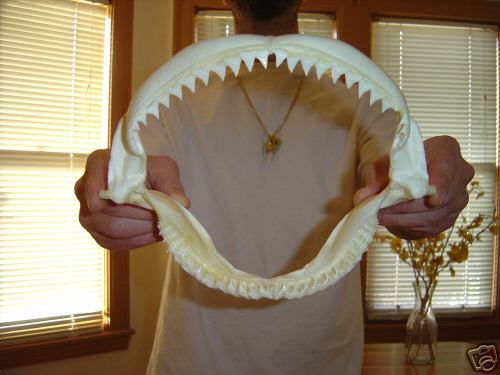

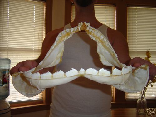

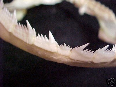

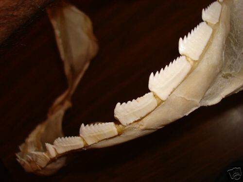

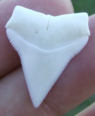

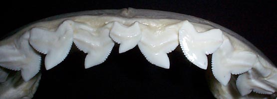

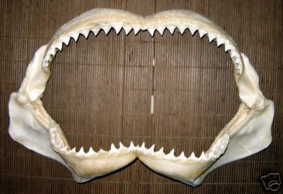

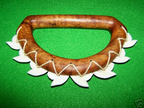

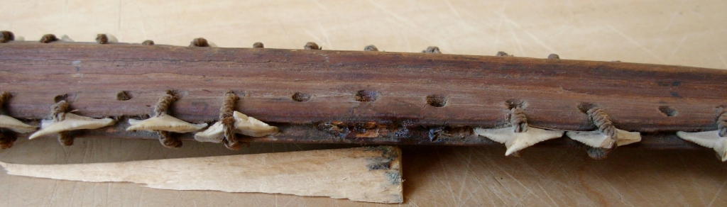

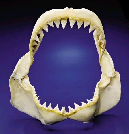

PERHAPS HERE WOULD BE A GOOD POST TO PUT IN A LITTLE SHARK INFO AND PICTURES.
PICTURE #2 TIGER SHARK. #1. SIX GILL SHARK
#6. TIGERSHARK #3. GREAT WHITE, #4.BULL SHARK
#5. OCEANIC WHITE TIP #11. SIX GILL, BOTTOM TEETH
#10. DENTICIAN SHOWING TOP AND BOTTOM, BULL SHARK
#9. OCEANIC WHITE TIP TOOTH. #8. SEVEN GILL SHARK
#7. SAND TIGER SHARK
THE PICTURES WERE IN ORDER I DO HATE IT WHEN THEY CHANGE.
Old 29th July 2010, 04:54 AM   #19
THE SIX AND SEVEN GILL SHARKS ARE DEEP WATER AND SEEM TO BE A PREFERRED TYPE FOR USE ON THE MAORI MARIPI A KNIFE USED TO CUT HUMAN FLESH.
#1.A OCEANIC WHITE TIP, AROUND 13 FEETLONG
#2 WHITE TIP REEF SHARK GETS UP TO A LITTLE OVER 5 FEET LONG, MOSTLY A BOTTOM FEEDER.
#3. TIGERSHARK KNUCKLEDUSTER, #4 GREAT WHITE SHARK TOOTH HAWAIIAN CLUB. VARIOUS TIGER SHARK TOOTH CLUBS #5. THREE MAORI MARIPI , #6 PLATE WITH ONE MARAIPI AND CLUB, ECT.

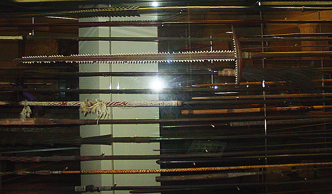

A FEW MORE PICTURES OF SHARK TOOTH WEAPONS, TOOLS AND ARMOR. THE FIRST 4 PICTURES ARE FROM THE MUSEUM IN AUCKLAND NEW ZEALAND WHICH HAS MORE MAORI AND OTHER OCEANIC WEAPONS AND ART ON DISPLAY THAN ANY OTHER I HAVE VISITED AND SHOULD NOT BE MISSED IF YOU ARE EVER THERE. PICTURE #5 IS FROM THE CHRISTCHURCH NEW ZEALAND MUSEUM AND SHOWS 2 LONG EXAMPLES OF THE TOOTHED SPEARS. #6. I TRIED TO CLEAN UP A PICTURE POSTED PREVIOUSLY OF COMBAT. MY CAMERA AND MY PHOTO SKILLS ARE LACKING SO I APOLOGIZE FOR PICTURE QUALITY. JUDGING FROM THE MUSEUM DATA BASE SOURCES, THE MAJORITY OF THEIR ARTIFACTS ARE NOT ON DISPLAY, BUT IN STORAGE. THE ONE WITH THE MOST AND LARGEST VARIETY ON DISPLAY WAS THE MUSEUM IN AUCKLAND THE DISPLAYS IN CHRISTCHURCH WERE VERY GOOD FOR MAORI ITEMS. THE NATIONAL MUSEUM IN WELLINGTON HAS LESS ON DISPLAY BUT SOME ITEMS WITH IMPORTANT MAORI HISTORICAL PROVENANCE. ALL THREE ARE VERY GOOD AND SHOULD NOT BE MISSED. THE MUSEUM IN DUNEDIN IS MOSTLY TRANSPORTATION RELATED BUT DOES HAVE SOME MAORI ITEMS ON DISPLAY. THERE ARE INTERESTING SMALL LOCAL MUSEUMS LOCATED IN SMALLER TOWNS THRU-OUT NEW ZEALAND. A WONDERFUL COUNTRY TO VISIT AND I SUSPECT TO LIVE IN.

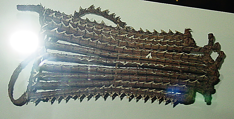

Shakethetrees
Shakethetrees's Avatar
Join Date: Apr 2014
Location: Louisiana
Posts: 363

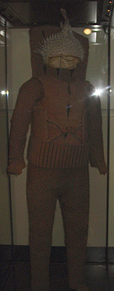

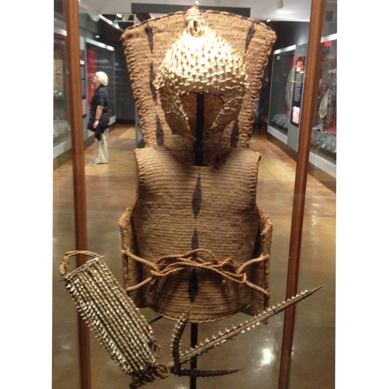

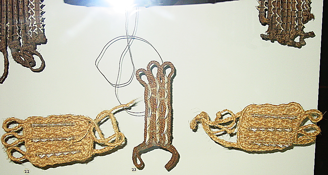

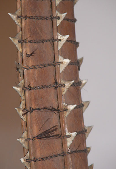

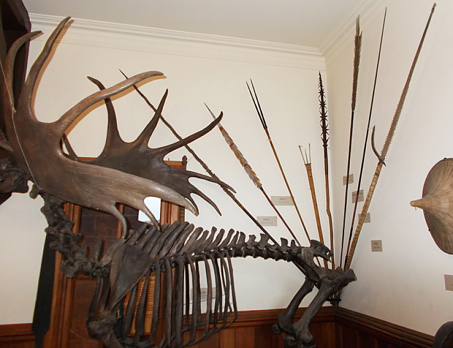

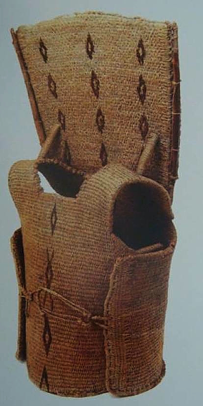

Last year I visited the Peabody Museum at Harvard. It had been about forty years since I last visited and remember viewing a group of Gilbert Islands weapons and fiber armor.
I didn't have great hope things would be the same, since these days museums have gotten away from dusty glass cases filled with relics to highlighting single objects with some sort of interpretive display nearby.
But, to my surprise, it's still on display, along with a fair amount of other weapons and ethnographic material.
If you ever find yourself in The Boston area, it might be worth your time to go for a visit. But, beware! Parking anywhere nearby is an absolute nightmare!
Sorry the image is a little out of focus. Shooting through glass with lights everywhere is tricky!

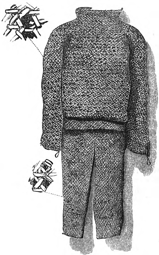

Old 26th May 2016, 03:48 AM   #23
THANKS FOR POSTING THIS EXAMPLE OF THE ARMOR IT SHOWS HOW THE SECTION WITH THE LARGE SECTION TO PROTECT THE BACK OF THE HEAD IS ATTACHED AND THE EXTRA PROTECTION IT GIVES TO THE SIDES AND KIDNEYS.
SEVERAL OF THESE SETS OF ARMOR HAVE VERY FEW BLACK DESIGNS LIKE THE ONE YOU POST WHILE OTHERS HAVE QUITE A LOT. I WONDER IF THEY DENOTE THE RANK OF THE INDIVIDUAL OR THE NUMBER OF TIMES HE HAS FOUGHT OR HIS TEAM (TRIBE, VILLAGE OR ISLAND) ? NOTE THE DESIGNS ON THE TWO WARRIORS IN ARMOR IN THE PICTURE OF THE FIGHT ABOVE. SOME PICTURES FOR COMPARISON USE THE PICTURES IN POSTS ABOVE ALSO. NOTE THAT THE DESIGN APPEARS TO BE DIAMOND SHAPED IN MANY BUT ARE SHAPED LIKE FISH IN ONE EXAMPLE.
#1. SUIT IN AUCKLAND MUSEUM MUCH LIKE YOUR EXAMPLE
#2. LISTED AS FROM THE GILBERT ISLANDS
#3. LISTED AS GILBERT IS.
#4. LISTED AS KIRIBATI WARRIORS, LOOKS LIKE THE SAME GROUP POSED FOR THE FIGHT PICTURE IN THE POSTS ABOVE.
#5. LISTED AS KIRIBATI
#6. LISTED AS GILBERT IS.
#7. 1841 SKETCH DRUMMOND IS;AND WARRIOR KINGSMILL ISLANDS
#8. GILBERT ISLANDS
#9. GILBERT ISLANDS
#10. KINGSMILL ISLANDS ARMOR , GERMAN BOOK
#11. KINGSMILL ISLANDS tHIS IS A DIFFERENT FORM THAT COVERS FRONT AND BACK.
#12. GILBERT ISLANDS ARMOR , FRONT AND BACK FORM.
SORRY ABOUT THE QUALITY OF THE PICTURES MANY WERE TOO SMALL AND DARK TO DO MUCH WITH.

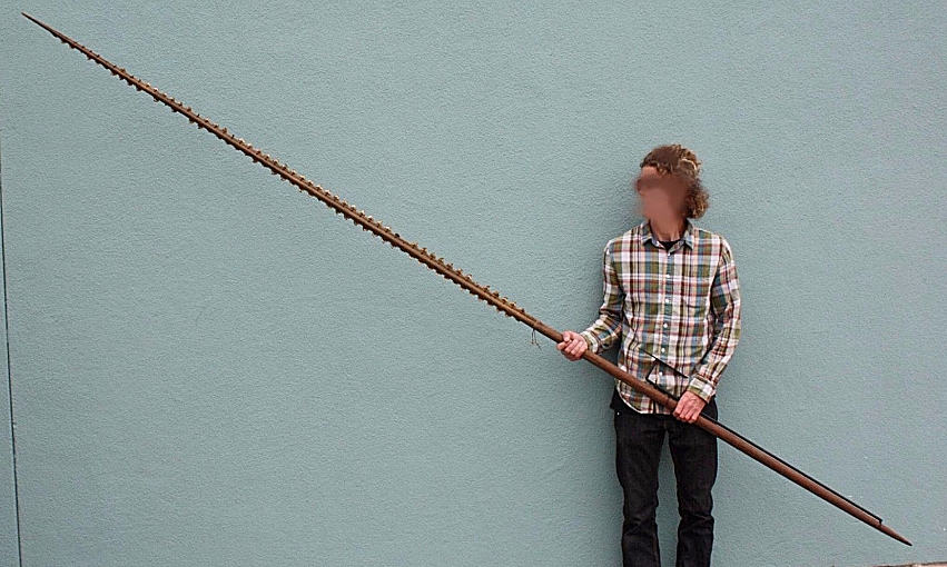

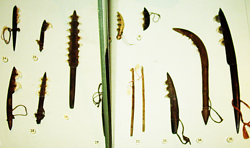

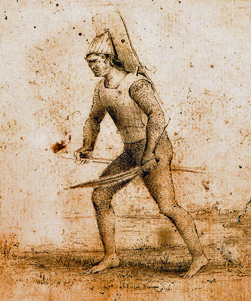

MORE ARMOR AND WEAPONS FROM KINGSMILL, GILBERT, MARSHALL, KIRIBATI ISLANDS REGION. DIFFERENT NAMES FOR THE SAME PLACES OVER TIME WITH NO SPECIFICS DO MUDDY THE WATERS.

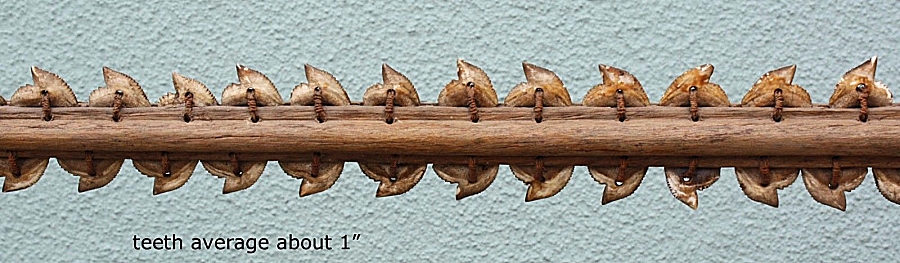

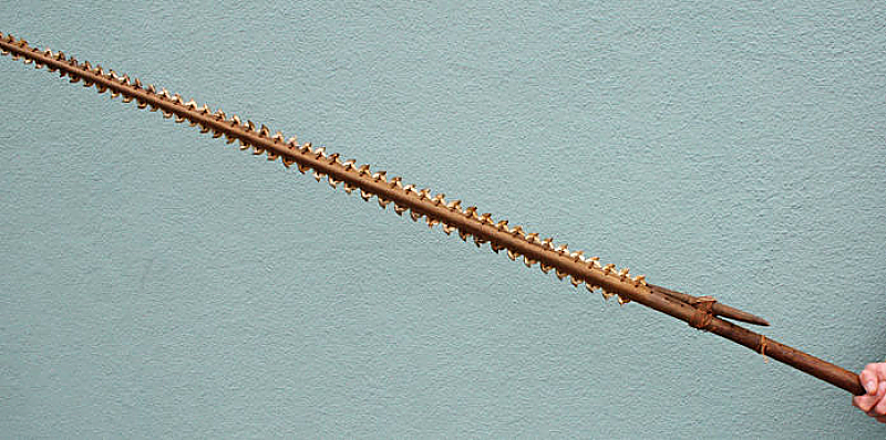

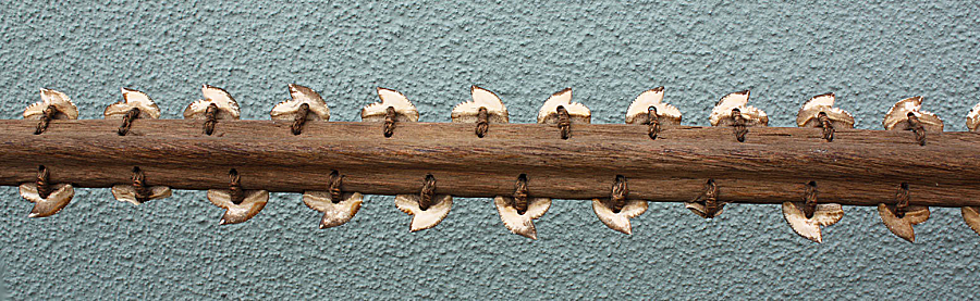

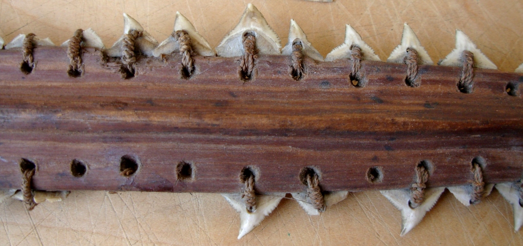

Old 1st June 2016, 05:02 PM   #25

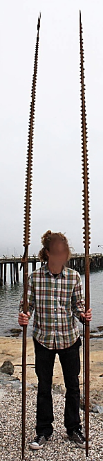

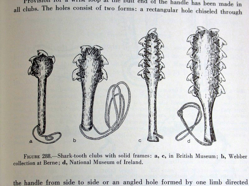

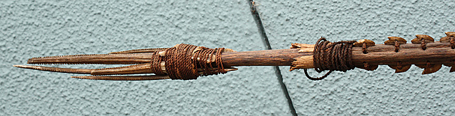

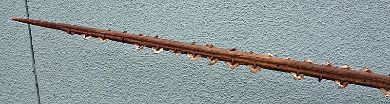

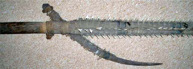

A OLD EXAMPLE OF A INTERESTING SHARK TOOTH POLE SPEAR. THERE ARE 4 ROWS OF TEETH 2 ROWS WITH THE TEETH POINTING FORWARD AND TWO ROWS WITH THE TEETH POINTING BACKWARD. TWO ROWS GO ALL THE WAY TO THE TIP AND TWO GO TWO THIRDS OF THE WAY. IT IS 81.5 CM. LONG BUT APPEARS THAT SOME OF THE POLE MAY HAVE BEEN CUT OFF IN THE PAST.
THE TWO OLD PICTURES OF THE WARRIORS FACING OFF AND OF THEM STANDING WITH WEAPONS IN THE ABOVE POSTS, WAS FROM A 3 BOOK SET IN GERMAN CALLED " DIE SITTEN DER VOLKER" PUBLISHED IN 1920.

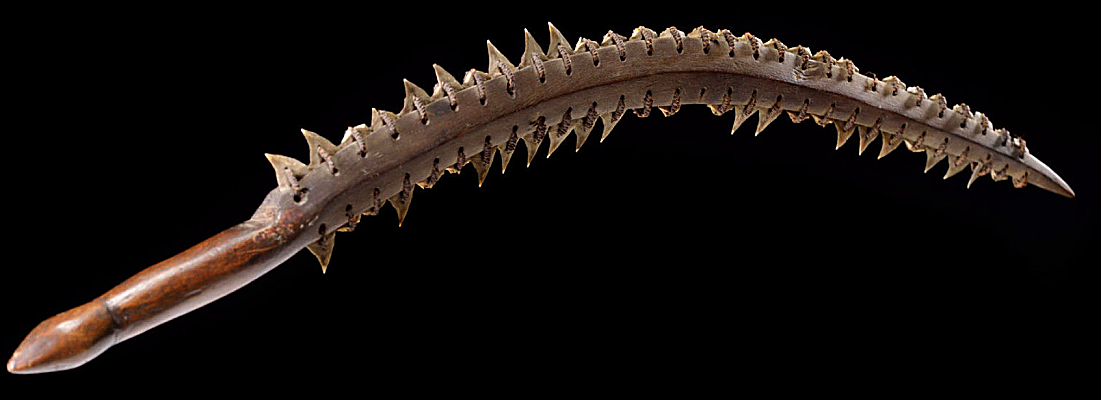

Old 9th June 2016, 07:13 PM   #26
PICTURE OF A VARIATION OF THE SHARKTOOTH SPEAR/CLUB FOUND IN THE MUSEUM IN AUCKLAND NEW ZEALAND
Old 24th August 2016, 06:45 PM   #27

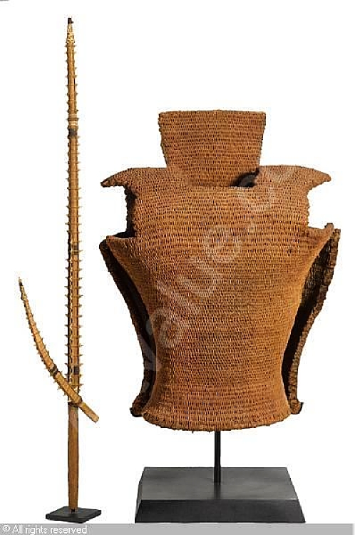

TWO EXCEPTIONALLY FINE LONG SHARK TOOTH SPEARS RECENTLY ENDED AT AUCTION. ONE HAS A TIP MADE OF LARGE STINGRAY SPINES, BOTH APPEAR TO BE GOOD OLD EXAMPLES. THESE TWO EXAMPLES ARE 11 FEET BY 2.5 IN. OR 335 X 6.3 CM. LONG. DESCRIBED AS 19TH. CENTURY MAKE OF WOOD AND TIGER SHARK TEETH WITH A TIP ON ONE WITH STINGRAY SPINES AND A LITTLE REMAINING OF A FIBER WRAP. NOTE THE TEETH POINT ONE WAY TOWARD THE TIP BUT CHANGE ABOUT HALFWAY DOWN TO THE OTHER DIRECTION. THERE IS A WOODEN CROSS GUARD WITHOUT TEETH ON ONE EXAMPLE. IT LOOKS LIKE THEY WERE MOUNTED AND DISPLAYED AS A PAIR IN THE PAST.

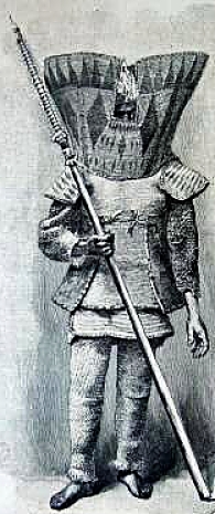

Old 27th December 2016, 09:31 PM   #30

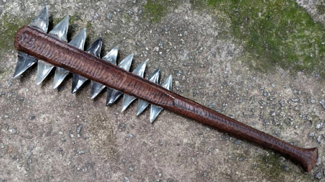

#1. & #2. REPLICA OF SHARK TOOTH CLUB MADE WITH LARGE FOSSIL SHARK TEETH. THESE FOSSIL SHARK TEETH ARE FOUND IN NORTH AND SOUTH AMERICA AND WERE USED FOR VARIOUS THINGS INCLUDING WEAPONS.
#3. TWENTITH CENTURY REPLICA OF A SEMINOLE SHARK TOOTH WEAPON 15.25 IN. LONG
#4. KIRIBATI ARMOR CUIRASS AND SWORD
#5. WARRIOR WEARING FIBER ARMOR KIRIBATI
