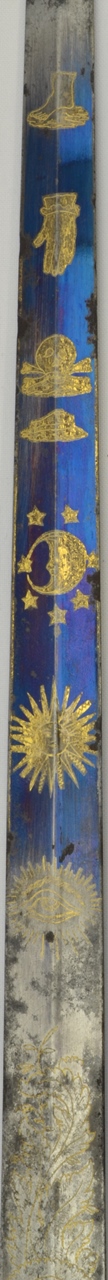

Hi Guys
Here’s an odd one. This Naval dirk has the most usual etched design I have come across, appears almost free mason. It’s larger than most of my dirks and I haven’t come across another example quite like it. I would be interested in anyone’s thoughts as to what this peculiar collection of symbols might mean.
Date: c1800
Overall Length: In Scabbard 20 ¾” 52.5 cm, Dirk Only 20” 50.8 cm
Blade length: 15 7/8” 40.3 cm
Blade widest point: 1” 2.5 cm
Hilt widest point: 2 ½” 6.4 cm
Inside grip length: 3 ½” 8.9 cm
Marks, etc: St Side Floral design, seeing eye, Sun, Moon & Stars, Scull & Cross bones over a coffin, Hand, Foot. Other side Floral design, Star, Maltese Cross, Sheep with Flag, Rooster, Sword.
Description
BRITISH OFFICER'S BLUE & GILT DOUBLE EDGE DIRK:16" blade retaining 70% blue & gilt finish; gilt brass hilt Lion's head pommel & with chips to carved ivory grip; fitted with original gilt brass chain; complete with gilt brass mounted leather scabbard. c.1800.
Any thoughts
Cheers Cathey & Rex

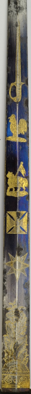

Hi Cathey,
The cockerel would suggest this is French rather than British.
Norman.

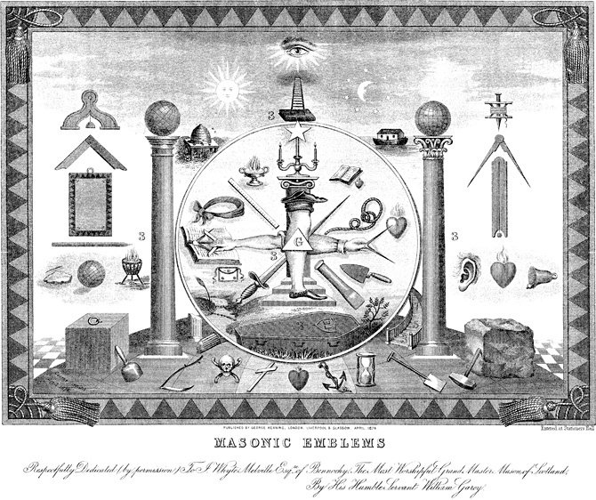

Here is an article on the Paschal Lamb as it relates to freemasonry.
http://www.myfreemasonry.com/threads...al-lamb.22916/
Old 11th May 2016, 03:03 AM   #8
Posts: 7,281
If you scroll down a bit in this article you can see how the seven-pointed star, also shown on this blade, is used in freemasonry.
http://dcsymbols.com/officers/officers.htm
In freemasonry the rooster symbolizes the mercurial principle as explained in this article on the Chamber of Reflections.
https://en.wikipedia.org/wiki/Chamber_of_Reflection
I suspect that what looks like an iron cross on this blade is really meant to be the Cross Pattée, symbol of the Order of the Temple.
So i can connect every single symbol on this blade to a significant symbol in freemasonry, but maybe that is just a coincidence...

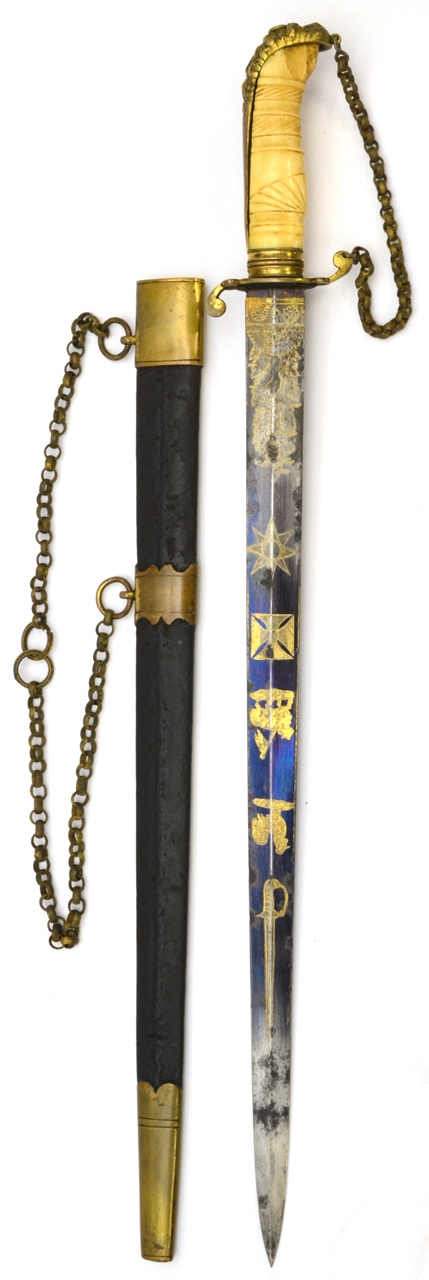

Richard I believe this dagger/dirk would have been used by a navy officer. The blade etching would not normally be seen except if drawn for use. Masons took pride in who they were and didn't hide the fact of who they were.

Will, looking at this again, I'm still not sure. I can't see any naval connection other than the style of the dirk itself. I wonder if it is a masonic dirk, plain and simple'
Helleri, the pommel is supposed to be a lions head. This sort of 'upper half only head' is normal for this type of dirk.

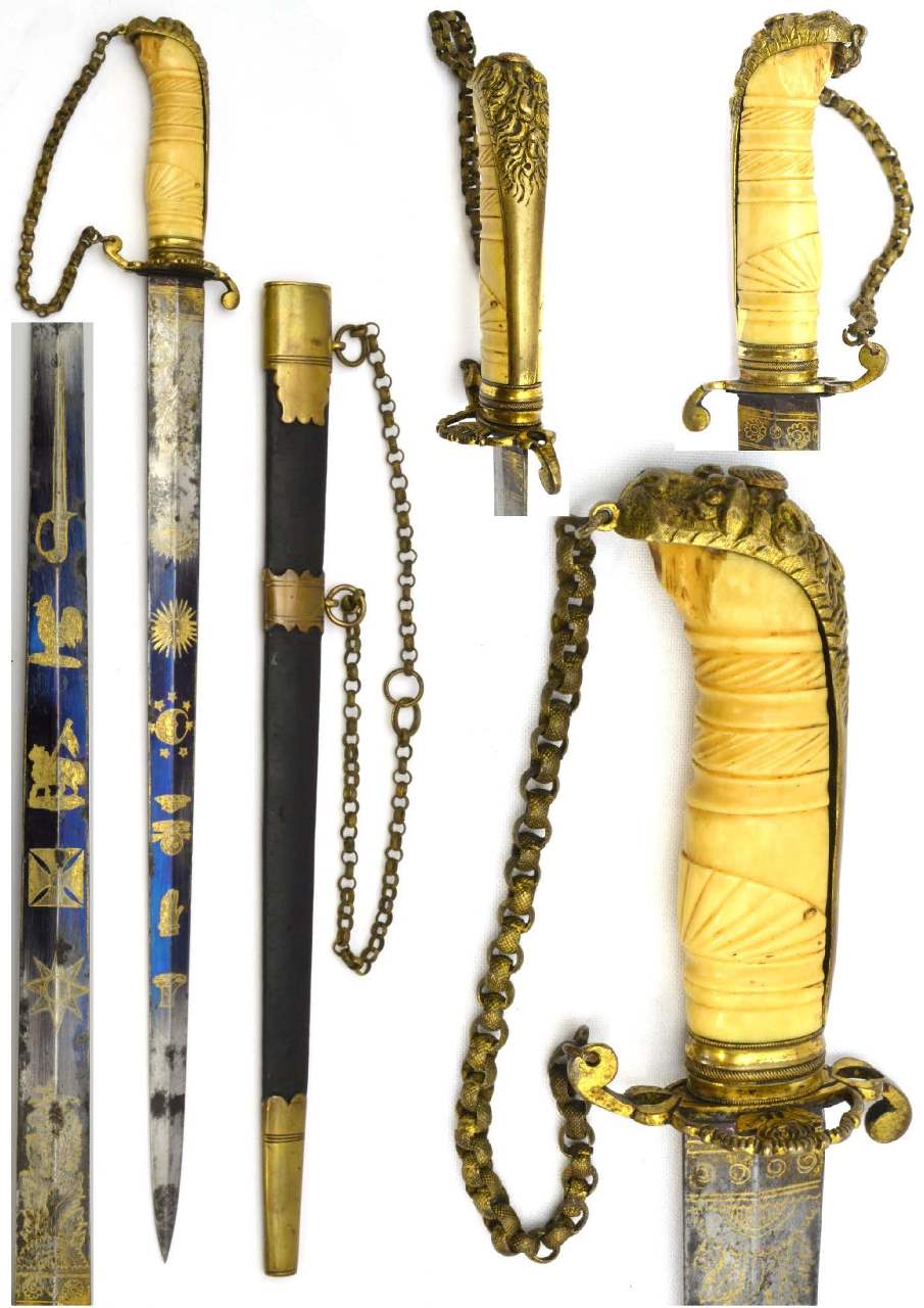

Guys, thank you for bringing this thread back!
Actually the notion that this is a naval officers dirk was probably simply because of the well established use of them in that context.
The animal head is indeed intended to be a lion head, in this configuration it corresponds to British infantry officers sabre hilts (M1803) and other military and naval hilts of the Georgian period.
Looking further into this, it would seem that this is most likely a dirk made specifically for a Freemason, and probably of the Order of Knights Templar.
While checking references on Freemasonry, in this case which are on the American aspects, in many if not most cases, the allegory and symbolism used in Freemasonry transcends nationality and other denominators.
From "Material Culture of the American Freemasons" (John D. Hamilton, 1994, p159): 'Knights Templar Dirk"
"...both real and false dirks were worn attached to a regalia baldric or sash as an insignia of the Templar Order. Real dirks were prescribed for regalia worn by Knights Templar only in certain commanderies".
With the numerous symbols on this blade, it would seem perhaps that either it was intended for an individual with achievements in a number of degrees or associations in various rites or steps. In most cases, there is a wide spectrum of perceptions held toward these symbols. For non Freemasons such as myself, it is often dangerous to try to offer meanings and definitive assessments of these. The very secretive nature of Masonry has lead to prolific writings and material which can mostly be regarded as speculative.
The grips on the hilt in ivory for example, have the familiar Palladian arch, which while an architectural feature of the Renaissance, and from a famed architect and Mason, also appeared in Georgian and Federal designs in other than Masonic cases.
The rest of the symbols on the blade are all profoundly Masonic, the cockerel represents the 'Cock of Resurrection' often placed with the 'Paschal Lamb' (as discussed earlier). While this was suggested to indicate French origin, I would note that in other cases the Paschal lamb was joined with French inspired regalia c.1797, on Scottish Rite aprons (op. cit. p112 , 4.22).
There were unbound connections between British, French and for that matter, American Masonic lodges in these times.
It is interesting to see the 'dirk' itself among the pastiche of symbols on the blade of this piece. It seems that symbol often occurs as well in certain degrees of the Scottish Rite. Other symbols such as skull and crossbones have more broad meaning in Masonic symbolism, as do the 'All Seeing Eye' which recalls the origins back to Solomon and Hiram Abiff etc.
In all, a most intriguing item of distinctively British Masonic regalia and as noted, Georgian period in early years of 19th c.

It seems by its style that this dirk would certainly be Georgian, and inherently aligned with a naval weapon, but as noted earlier, the dirk was also a weapon used in Masonic regalia. As such it would be presumed that the according symbolism would be impressively displayed as with this example.
I wonder if naval officers of this period were perhaps simply absorbed within the membership of the broader scope of Masonic lodges, rather than there being a specific 'naval lodge'. It does by no means dismiss the notable rarity and keen naval gestalt of this example, and that it is indeed of the Georgian period.
As I could find no examples of naval dirk with Masonic motif until the one I noted from 1880, and as the only specific naval lodge recognized was not founded until 1838, the question remains if there was actually a recognized naval lodge in the end of the 18th into early 19th c .
The 1739 lodge apparantly became disassociated with the Grand Lodge as noted, and its members presumably filtered into other lodges .
This dirk is an outstanding example, and its Masonic character presents opportunities to look deeper into its history.

Jim, I agree that this dirk is late Georgian or William IV. There are also other types, the most common being with a turned grip and somewhat resembling a stilletto. I agree that as a type these dirks are associated with Naval officers; but in every case?
What I am speculating is that these dirks are first and foremost Georgian, and although we can say probably Naval, we should not make that assumption if the clues lead elsewhere.
To put it rather simply, would a Naval officer, a Mason, or even a man off the street, who approached a sword cutler for a dirk be shown essentially the same dirk and be told we can 'customise' this to your requirements. Probably the majority of customers would be Naval officers and this would mean the majority of these dirks are Naval, but not necessarily every one. Cathey's could be one of those exceptions
Annis explains his 'strong presumption', but it is only that, due to the absence of any other likely attribution. Unfortunately a quick Google of Georgian dirks will reveal virtually every one is described as 'Naval'. Many obviously are, but some are more akin to hunting knives. Unless dirks were the sole preserve of Naval officers only this seems a too easy and rather sloppy attribution.

I indicated that in Masonry, the use of the dirk was in fact worn as a status and ranking symbol, thus certainly something available from outfitters for such purpose. So clearly, not only naval officers would be ordering such weapons. In the case of dirks used by naval officers, as shown in Annis, many of these were clearly personal items, reflecting few or virtually no military or naval features. This has long seemed to be inherently the case with naval officers with their choice of swords as well.
Therefore, as I see in rereading my text which was mostly the progression of research I was doing, I would revise my last comments in accord with what you note.
A British Georgian period (possibly later) dirk with Masonic motif and possible naval association.
