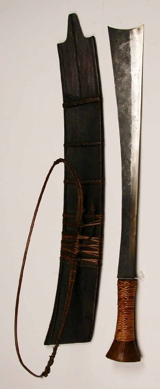

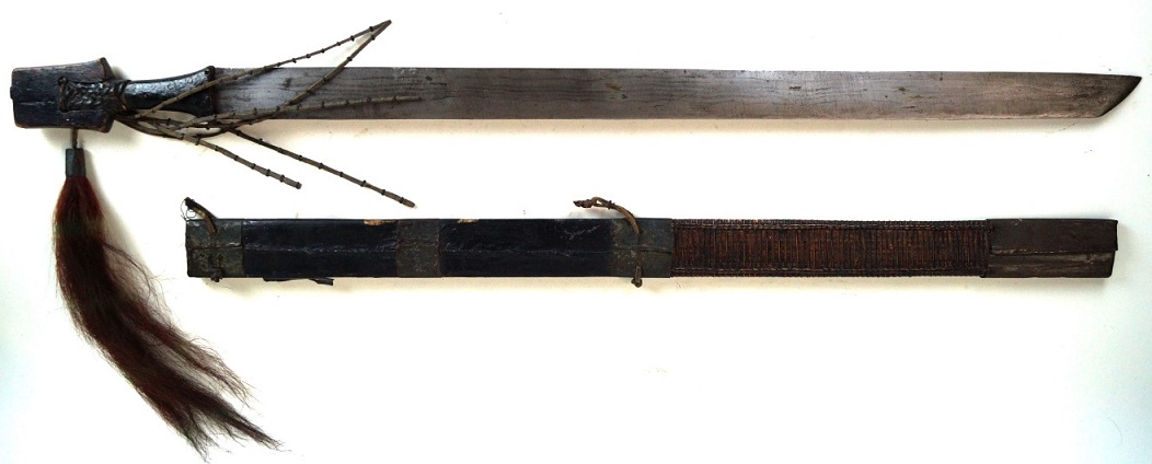

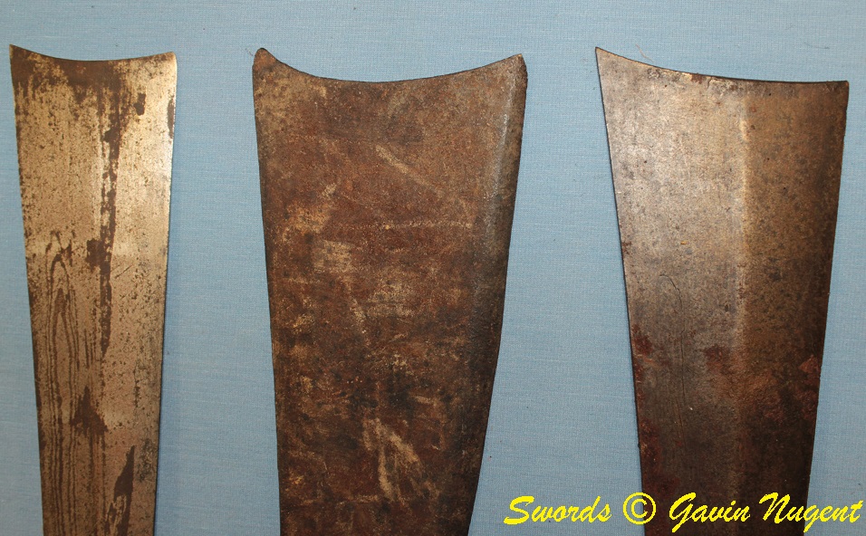

Just to throw it out there, and thinking a little differently about the whole Tibetan Kora thing, what say perhaps the Kora was specifically a very early weapon from Tibet that founds its way to Nepal and then in to India? I only say this when consideration is given to the Assam/Naga/Kachin regions which saw a lot of trade and migration from Tibet through the centuries...their typical weapons carry this curved tip with horn like protrusions.
Note the hair pin laminated Kachin blade, a typical feature on these weapons...note also further below a recent sword from Assam regions that was at auction...Tibetan blade repurposed for local Assam regions traditions.

Posts: 1,492
Gavin
So which came first, the Assam sword or the kora?

The Kachin dha comes out of Burma, admittedly Assam-adjacent, although folks tend to insist on calling it Naga, presumably because some were acquired by the eastern Nagas. But if you look at traditional Naga blades, they are smaller and differently shaped---axes, really, usually on a wood haft. Some Naga axes have concave ends, but they don't look like koras. The Khasis probably had the most access to iron in the hills and the most advanced metal technology. But their 'national' sword, and those of the Garos, are not closely related to koras. The little Kuki sword would probably have the closest resemblance, but not very close.

Indeed the swords and axes from these regions do not resemble a Kora overall, but nothing else really does either, not even the Kukri, except they may now and then share the hilt types...but then these OLD Kora types noted as Tibet do not follow the common hilt form either.
With regards to the image I placed above, from left to right it was Kachin, Naga, Kachin.
With regards to (and although undocumented), the tip note I have throw out there to ponder, what other weapons have these concave tips like this...none come to mind except the dao and axes from the regions of Assam and Northern Burma.
Specifically looking at the known Indian Kora and the known Nepal Kora, the large ends look rather like an Indian Elephant ear,right down to the central point, important animals to the regions and the religions...not so important in Tibet...so IF these narrow old Kora with the protrusions are Tibetan, what form was the tip styled on?
Gavin
