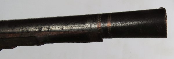

The barrel is decorated with fine bands of silver and copper/gold inlay very similar to a Indian Flintlock shown in Firearms of the Islamic World by Robert Elgwood as fig.94, attributed to the maker Seetaram and Sons, from Rajasthan?.

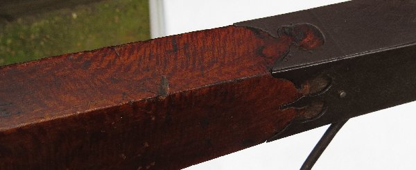

The top side plate in the photo below is original, the other three plates I made to match the cutouts in the stock. Trying to tone the new steel down takes some time.

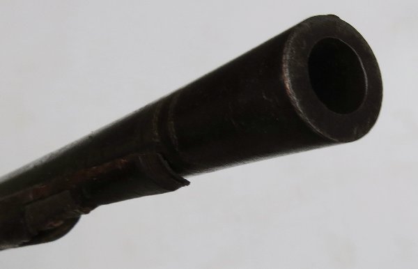

Whats also very interesting is the pattern on the barrel is etched, while very worn/pitted along the top of the barrel, the half of the barrel in the stock came out looking like its new, showing the barrel was always in the bright. They clearly etched the barrel in the round and then put the best half facing up.

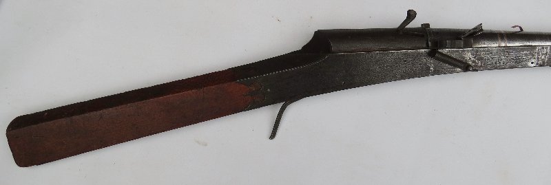

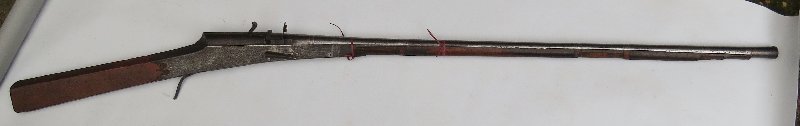

As requested heres an overall and a few other photos.
55" overall with 37" barrel.
