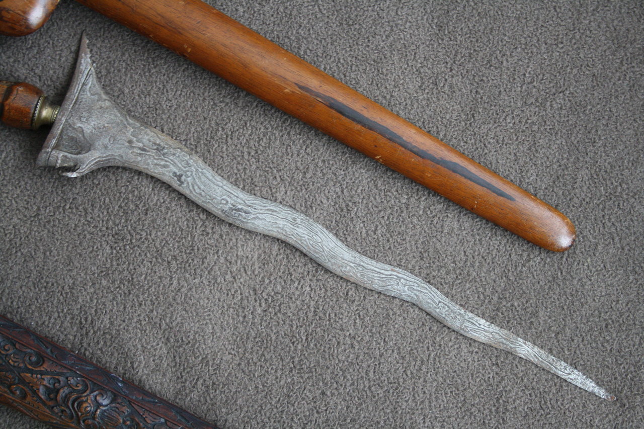

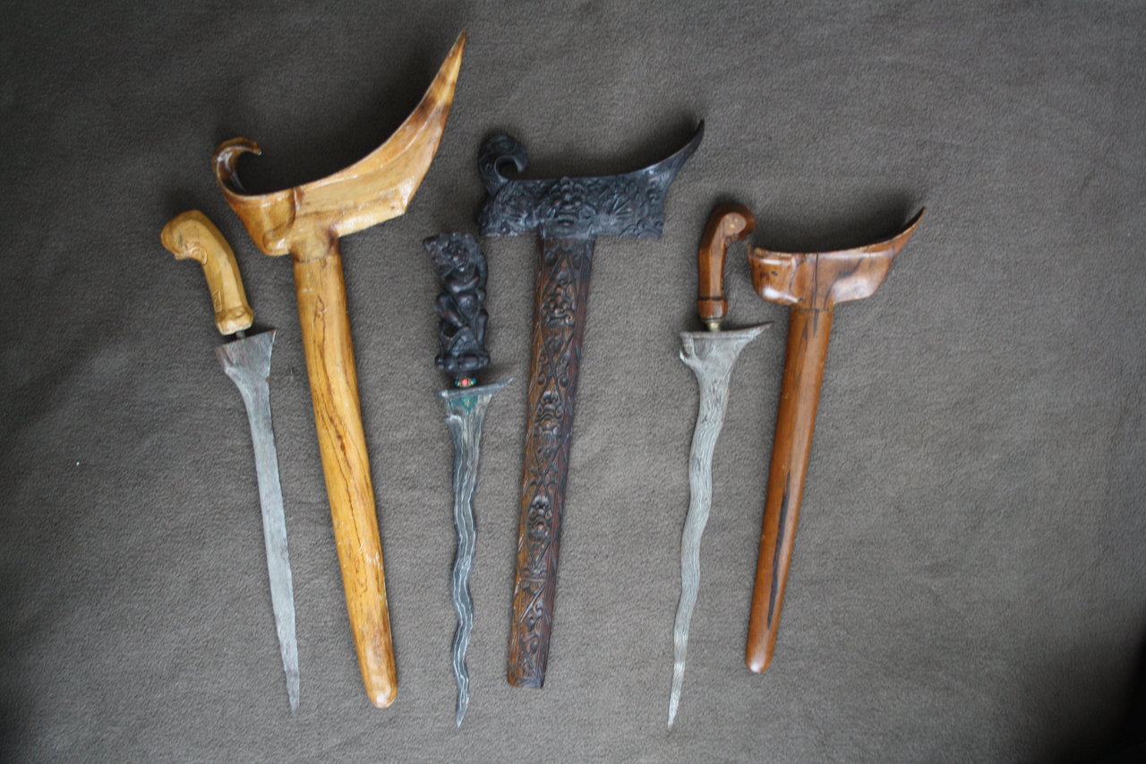

Hi Guys.

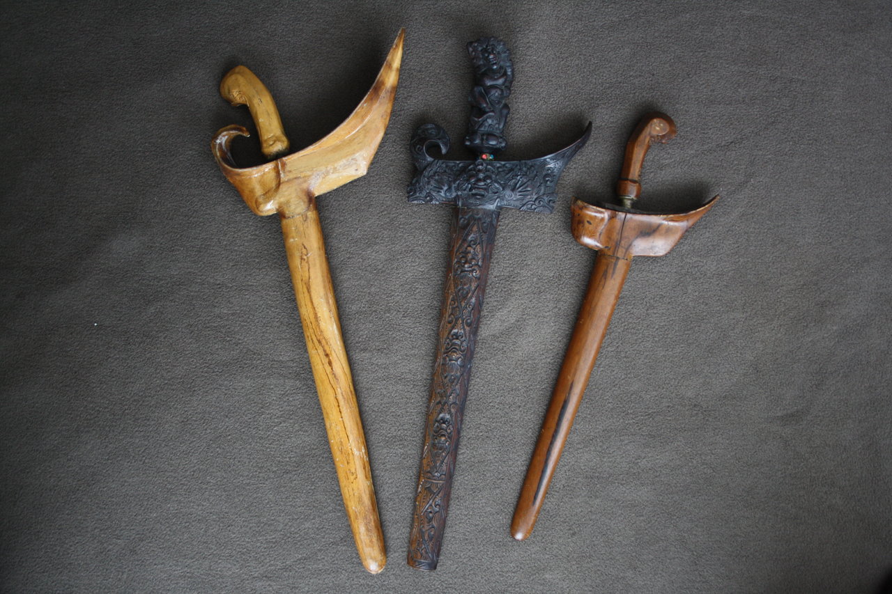

I am way out of my collecting area here. What have I got ?
Thank you very much !

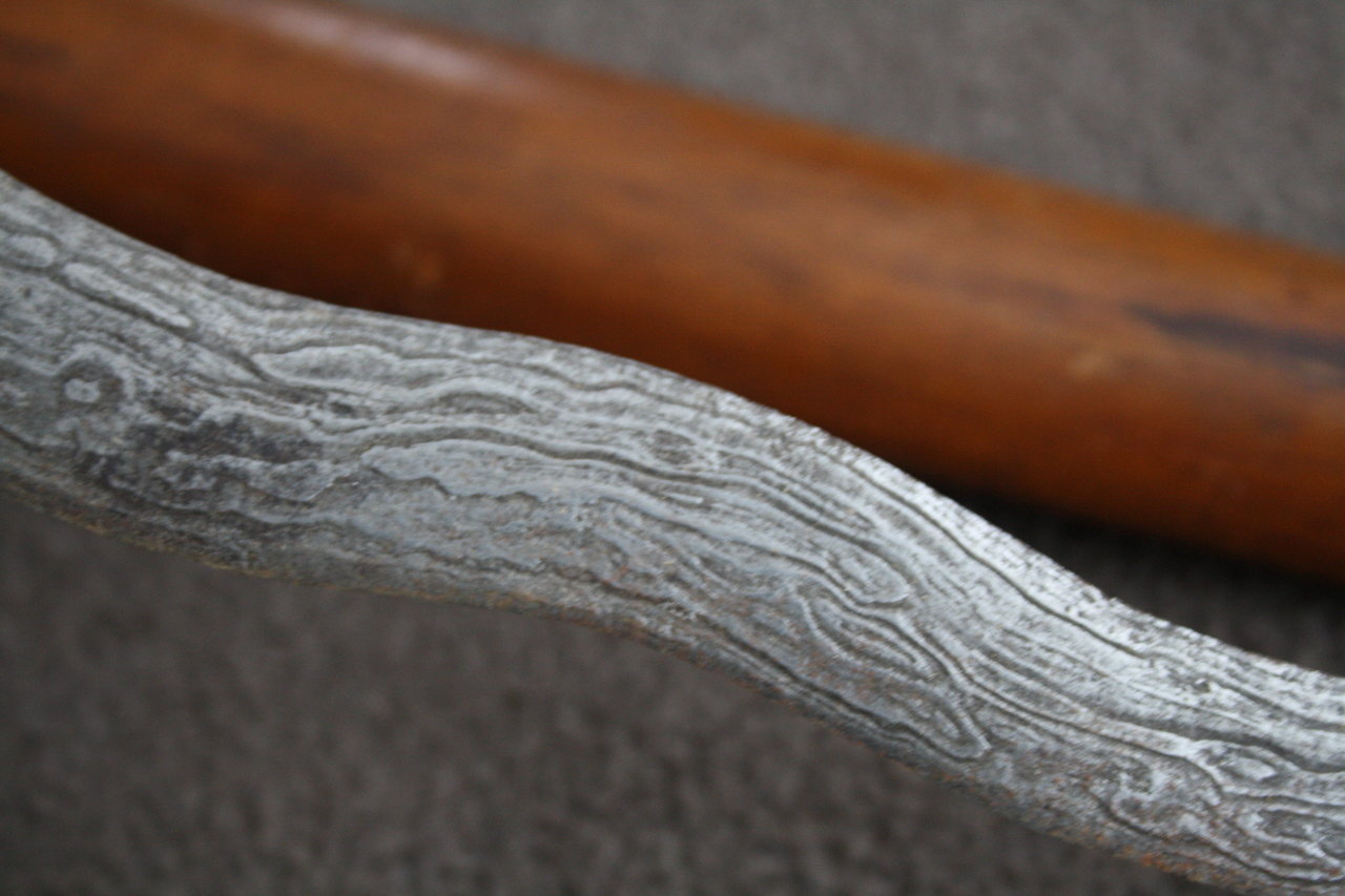

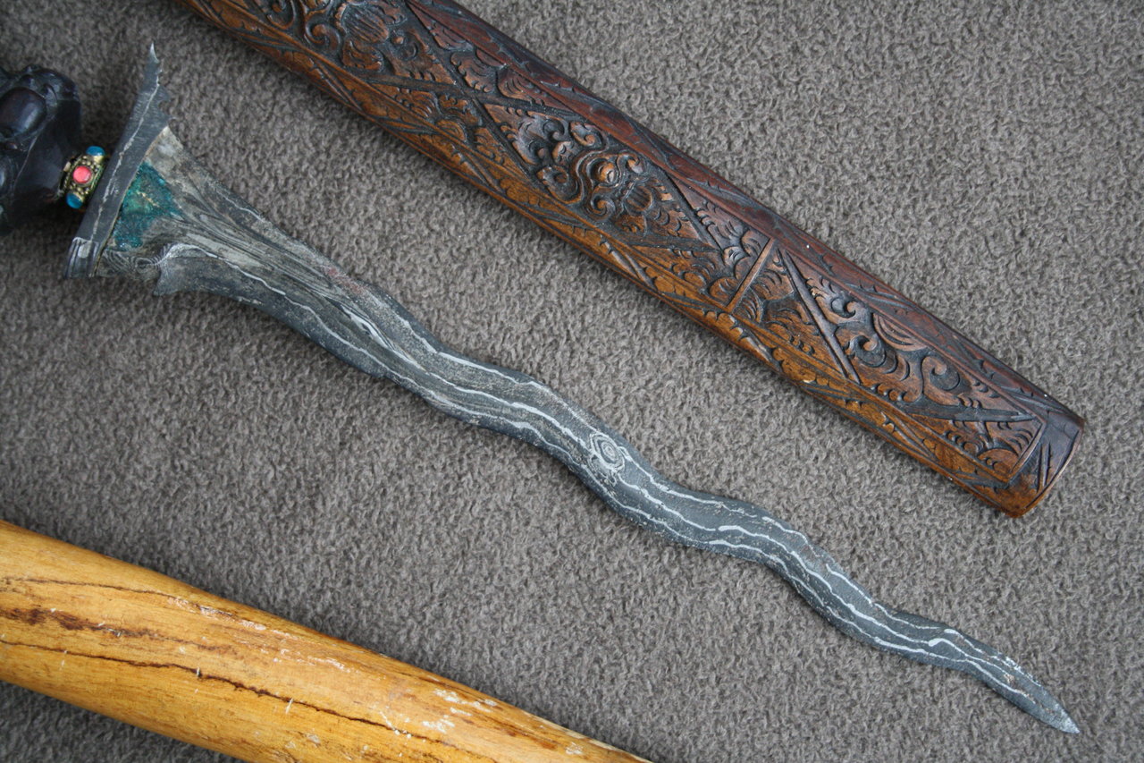

Hum, only the kris on the right of the picture (from East Java) is a good collectible piece IMO (the front side of the ladrang scabbard is damaged though).

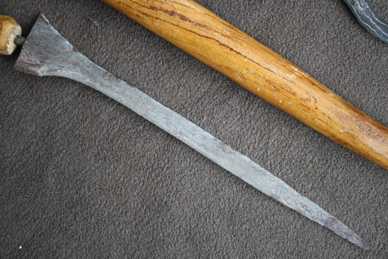

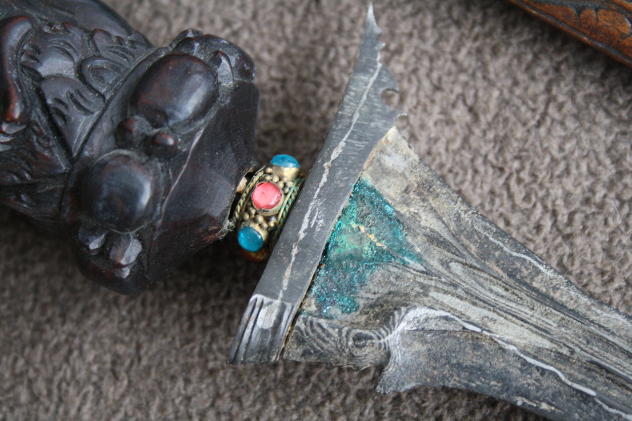

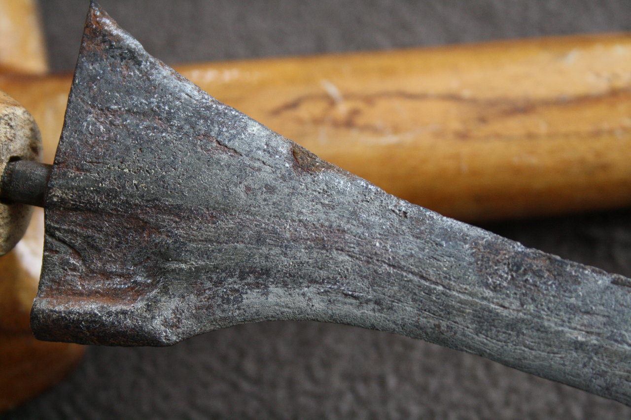

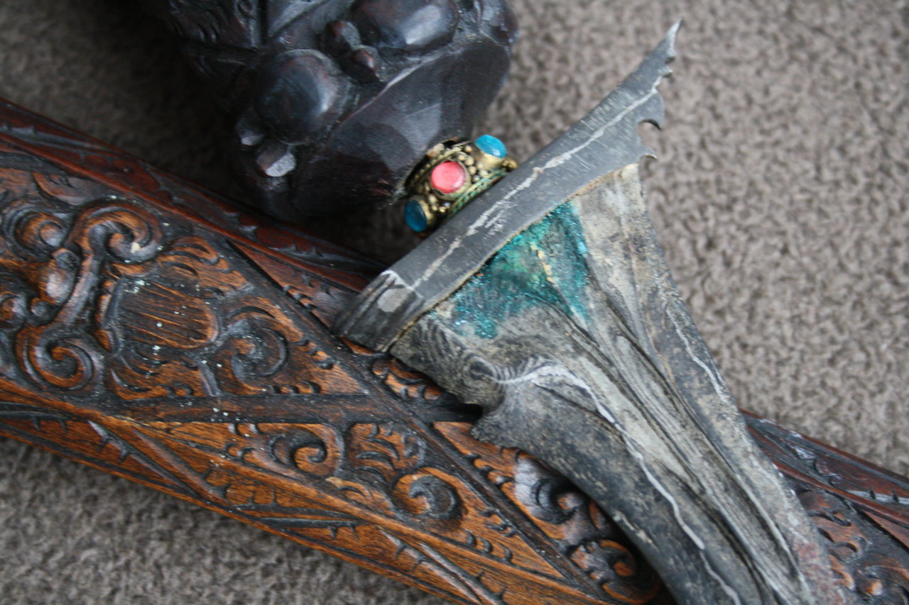

The kris on the left of the pics has a blade which misses its ganja so it is worthless, and the kris in the middle is a very mediocre quality balinese piece.
You should be more selective next time!

The third keris is indeed the best one in my opinion too. The crack in the scabbard should be restored and the ukiran should be turned to the other side, just like keris number one.
The first keris isn't so bad and certainly not worthless as you put it. The mendak is missing and can be replaced. The gonjo is missing but could be replaced also. But is it really missing? I can recall a comment of Alan that there are kerisses without out a gonjo. Same like a gonjo iras where the gonjo had been chisseled into the blade.
The keris in the middle is tourist stuff and could be placed in the section: mistakes we never should forget, in the attic, like we all have
And why should HB more selective? What we collect is a matter of personal taste and the thickness of our wallet. Maybe this was a bargain the effort worth.

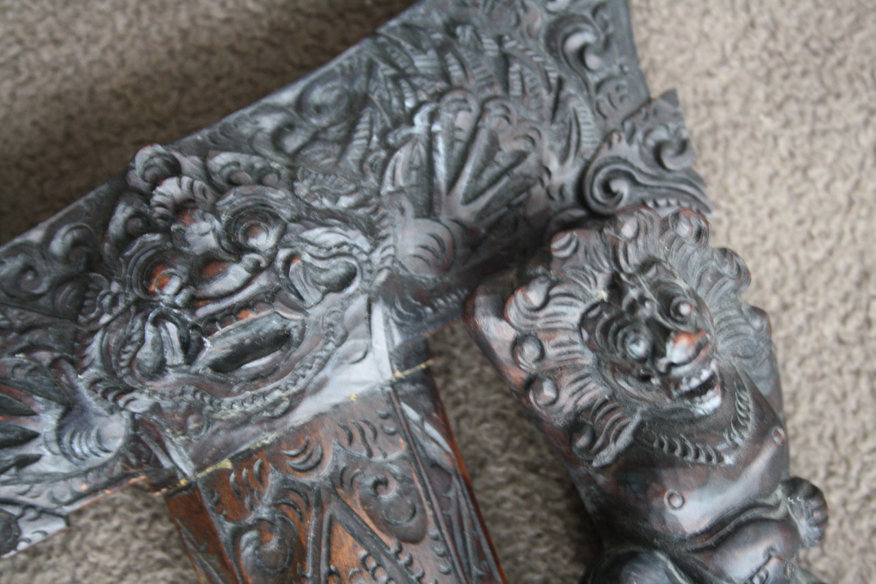

Default Middle Keris
I respectfully disagree. Not that I know what I am talking about. I don't think I had ever seen a Keris until ~2 years ago. That being said, I like the center (darker) one - a lot. I would have bought that one in a heartbeat. Congrats on your find. They look like keepers to me, especially the darker one.

Yes, the middle one is a real artwork.
Looks like it combines a real (residual) pamor with some "wax reserve dyeing" or something like it.
Very very low level kerisses. And with enthusiastic comments about such blades also the level of this Forum is becoming increasingly low, sorry guys.

Harry,
I understand that you like the center one. I suppose you should handle this one together with a real Balinese keris. Then you will understand the differences. Such a keris was one of the first keris I bought as a boy from my saved pocketmoney because i couldn't afford a real antique one. Also my knowledge was very low to nothing.

I agree generally with Henk's opinions here, though for me personally i would not bother with a keris missing its gonjo unless the rest of the blade was interesting enough to warrant the work to replace the part. Replacing a gonjo may not be that difficult for some, but it isn't like picking up a replacement mendak. It needs to be forged specifically for the blade.
The keris on the right is probably the keeper here, though it is not an extraordinary blade and seems to be some serious losses to the "bow of the boat" on the wrongko (sheath). It otherwise seems like a fairly original and complete antique piece. And yes, the hilt should be turn 180º around for a proper orientation.
Now for the center Bali keris. The dress is post 1960 tourist style. This may make it collectable if one feels the need to include such dress in their collections and their is an argument for it having such a place i suppose. The blade seems a bit older, but as has been pointed out, it is not a good Bali blade and it does indeed appear that its pamor has been augmented at some latter date with a surface treatment to give the impression that this keris has more going for it than it does in actuality. Harry, while no one should knock anyone else for their opinions here it would be to your benefit to shake off any offense and take note that this is, in fact, not a very good keris for the above stated reasons. It was augmented to deceive and not a particularly good example of Balinese keris arts to begin with.

Sorry if my frank opinion looks crude but it was not my intent to be unduly critical but to try to help Mr HBHansen for his future kris purchases and I apologize to him if he feels offended.
And I maintain that the ganja of the first kris is missing since the pejetan cavity extends to the bottom of the blade (not the case for a ganja iras).
