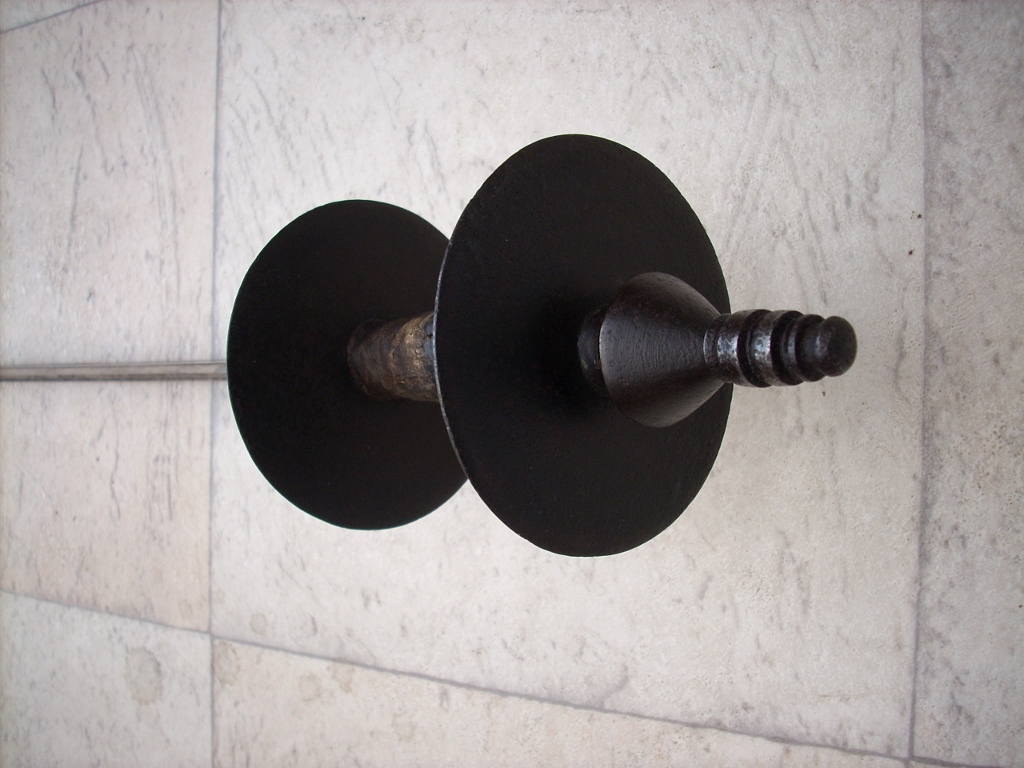

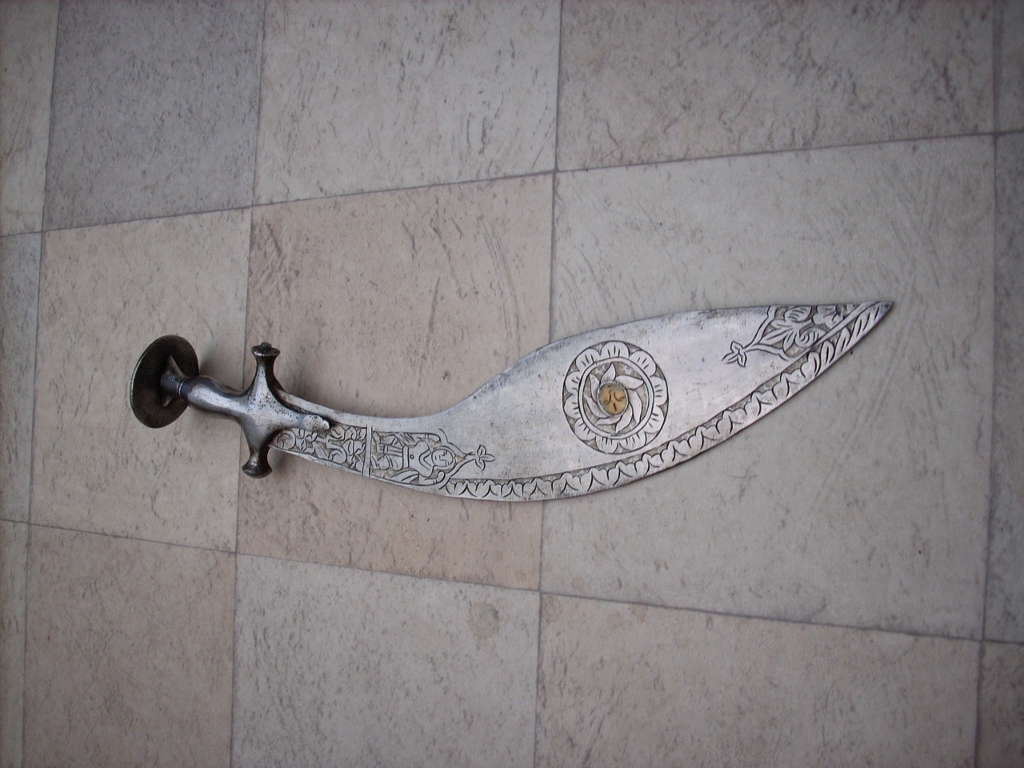

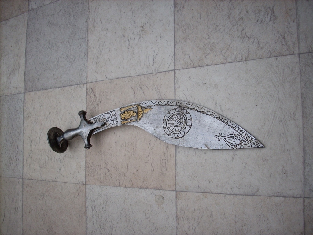

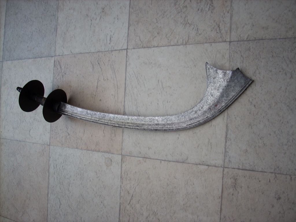

Hi Everyone,
I would welcome your comments and if possible the correct Indian names for these weapons. It is possible that they may be Nepalese but I think that they are Indian swords with a blade style adopted from the Gurkhas, I find it strange that the Indians who have given names to all their weapons have not given these weapons a particular name which leads me to think that they also used the name Kukri. I think that the decorated item was made for Religious or Ceremonial occasions or for the Tourist trade. The plain item is a fighting weapon and has a blade stamp which I am also hoping someone may be able to translate. The overall length of the plain one is 22 ins with a blade length of 16.5 ins and width of 1.5 ins, the dimensions of the decorated one are overall length 20.25 ins, blade length 16 ins and width 3.5 ins. Thanking you in advance.
Miguel

Here is some information on this type of khukri:
http://vikingsword.com/vb/showthread.php?t=9718
Your top one is indeed for the tourist trade, albeit the early-20th century variety, so it's still old.
The bottom one looks more like the fighting kind.
Emanuel

Semantics, but no.
It has a cho/kaudi, so it's a khukri

Well put Emanuel, and as noted, the choil (a distinct kukri feature) as well as the wider (kopis type) profile place this more in the kukri range.
The sosun pattah is characterized by the recurve and inside cutting edge, but not with this type blade. As always, these classifications become quite vague as these variations occur in diffusion of forms.
It seems to me that in the Bengal regions nearer to Nepal, such variations occur with kora hilted with the Indo-Persian hilt (as here) and much stouter, heavier blade more like a ram dao. These often have the eye or decoration near blade tip, and I have understood these to have been used as a sacrificial weapon with doves. The one I had still had vestiges of the red paint apparently applied to augment symbolic details of the blade.
I would consider that this kukri like version may have perhaps also been used in that manner but not necessarily for doves as in Bengal.

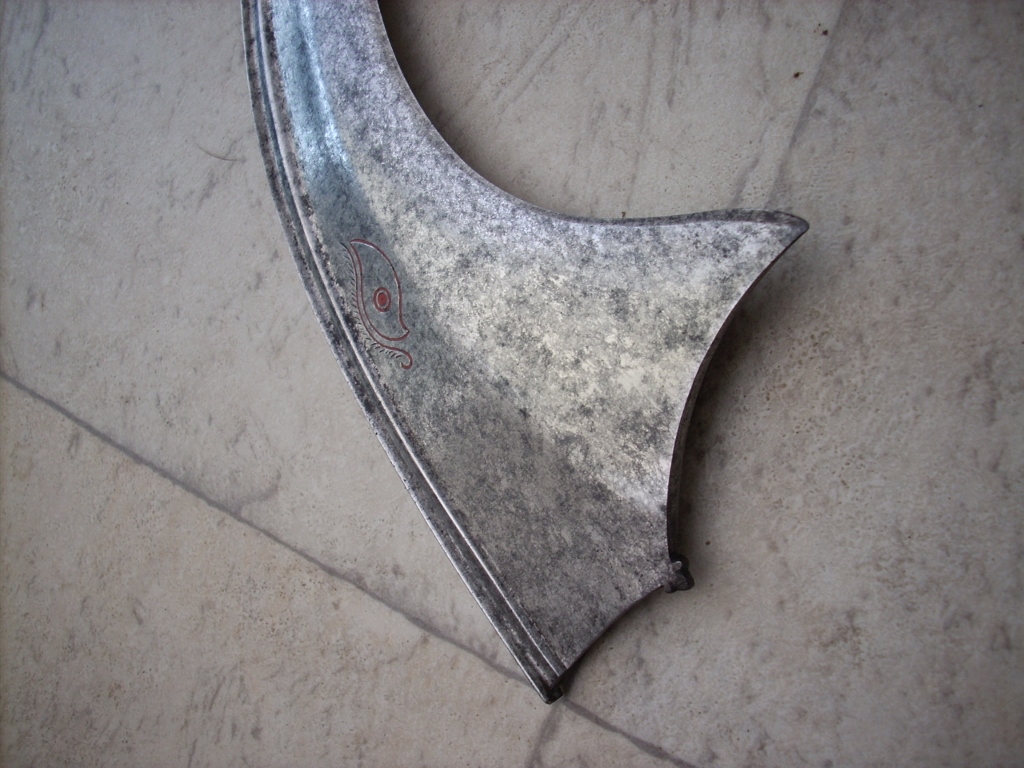

I am curious on the deep stamp at blade center, and what script or language might be in it. It resembles the deep stamps often seen on early tulwar blades in the Northwest regions of India, such as with trisula or stamps in Urdu.
The first example with the brass pavilion theme decoration does seem like it was in a discussion years ago (besides the thread you linked) and the production of souvenier items for British forces was noted. It seems to me that this cottage industry pretty much evolved after Omdurman in the Anglo Egyptian Sudan occupation, at least in notable subsidized production of these 'souveniers'.

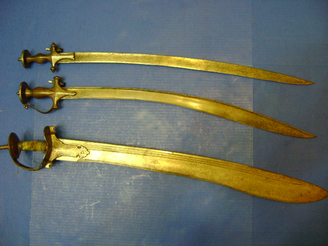

Just an example: 3 Sosun Patas.
The upper one has an 18th century real Ottoman blade ( the mastique is old and crumbling, so it is not a recent remounting)
The middle one is also yataghan-like, but not quite.
The lower one is a totally different animal:-)

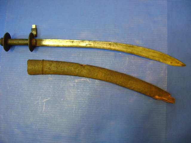

Old 1st November 2015, 02:37 PM   #9
And another one: size of a Kukri, but no Cho. There was an opinion that it might be a reshaped Kora. Perhaps. But it has a perfectly fitting very old scabbard, so the owner of even the reworked weapon saw nothing unusual in its new incarnation.

That's why I said semantics Ariel
If this sword came from a Nepalese armoury, a Nepalese would probably call it a khukri.
If it came from a Mughal armoury a Mughal might call it a sossoun pata.
A Rajput might call it...and so on.
The cho is generally characteristic of khukri. The rest is semantics

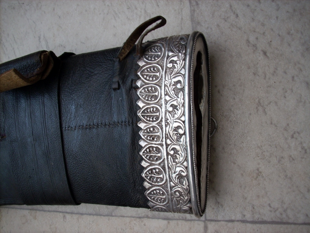

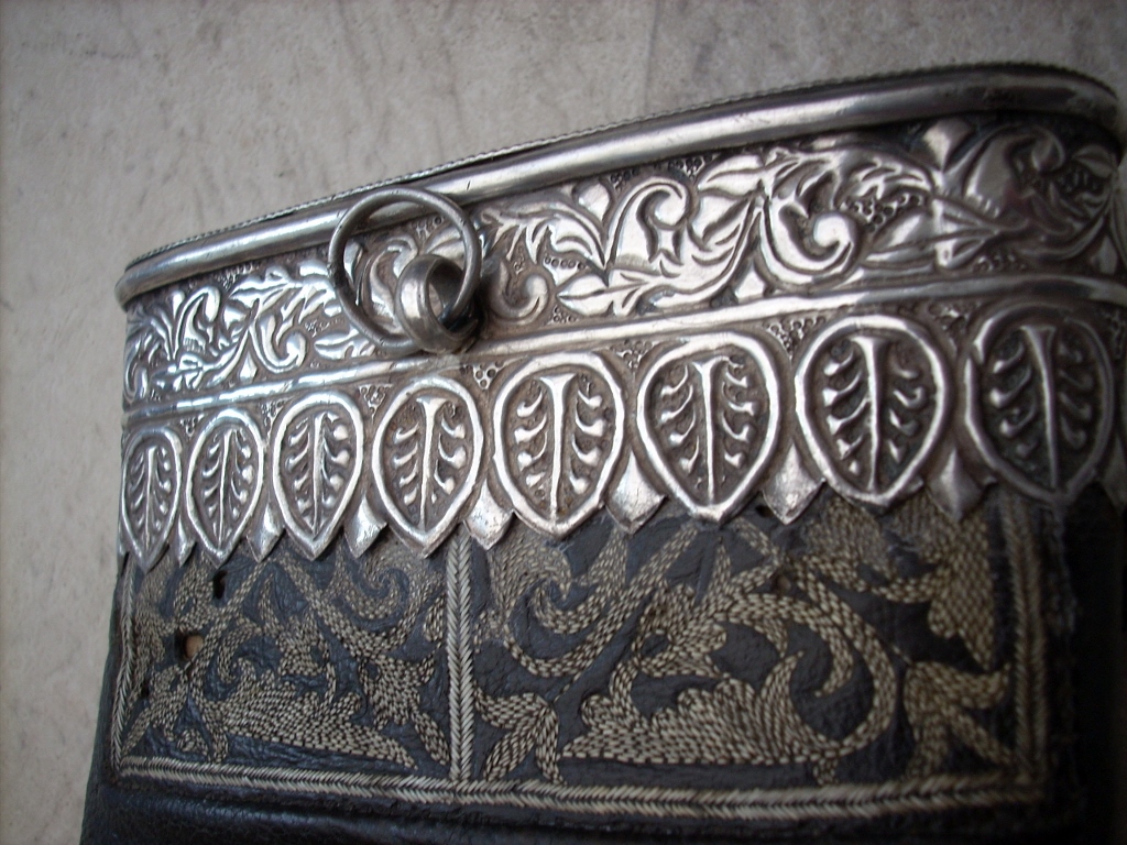

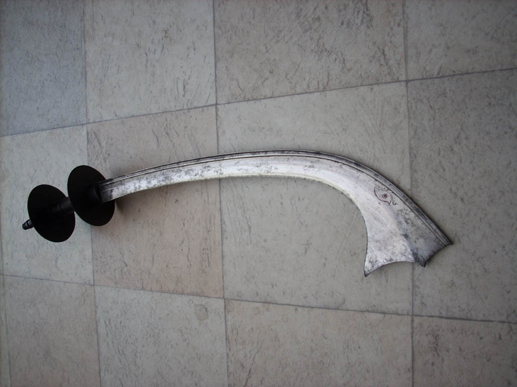

Hi Jim, Thanks for your reply. I must admit that since posting this thread I have learned a lot more information about Nepalese weapons making me realize how little I new before. It has made me look at them in a different light and do more research. From old threads and websites the information gleaned can be most confusing. You would think that as Nepal has only two principle weapons the origins would be clear, particularly the Kukri being such an iconic weapon but no one knows r sure although there are plenty of theories most of which seem plausible but none which can be conclusively proved. I must admit to subscribing to the Kopis theory and adopted from the the downward curving weapons of the Rajputs, but since seeing images of the earliest known Kukri against an old Kora (Kouda) my thinking has changed to it being derived from these weapons, but I guess we may never know.

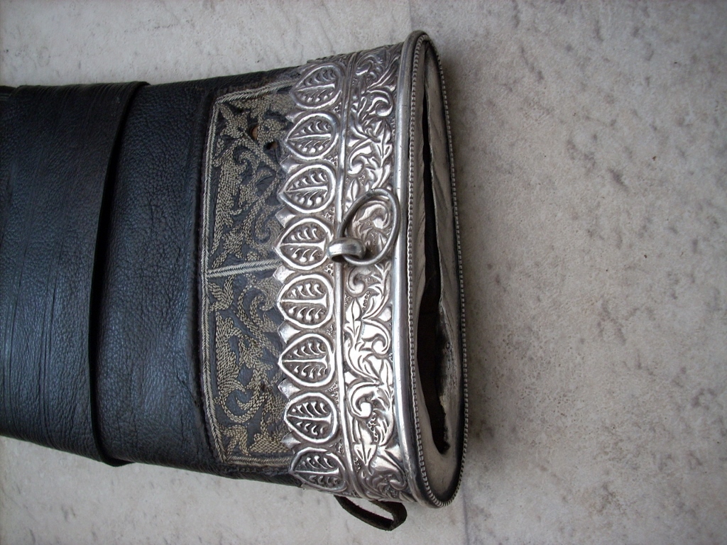

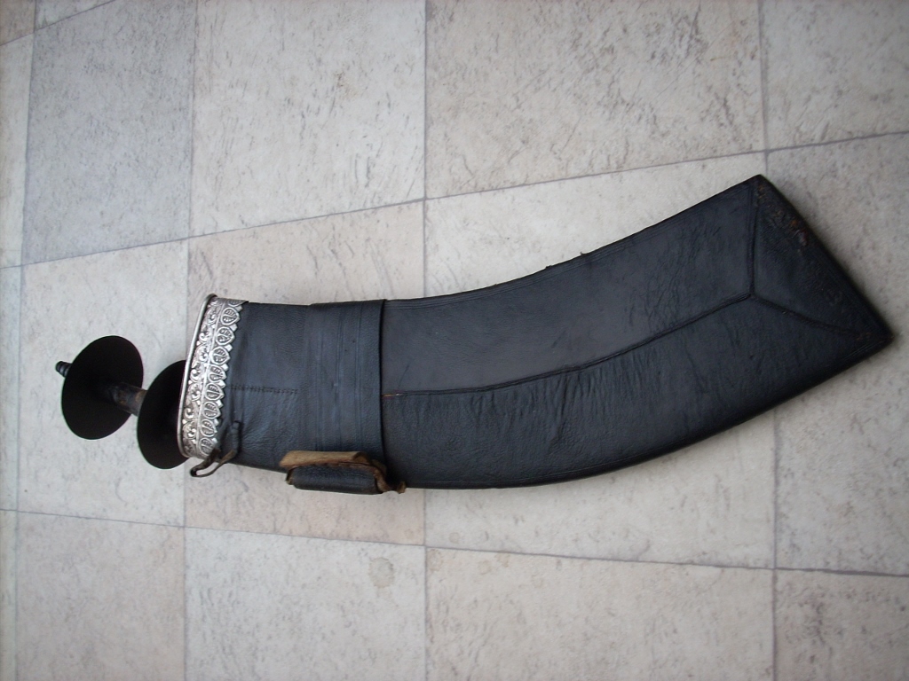

Thought you might like to see some pics of a Kora I have.
Regards. Miguel

Regards. Miguel
Lovely Kora, stunning quillwork on the scabbard.

Regards. Miguel
Miguel, thank you for posting this outstanding kora! You are right, every time we think we have things pretty much cornered on the arms of certain cultures, regions and classifications .....more is revealed and we find that all we have done is added more questions

The second example certainly means business, almost certainly for fighting rather than sacrifice, although it could accomplish that if required. I am most intrigued by the armoury stamp.
I have seen a few with similar markings, but they are not often found. Would it be possible to see a clearer image? I'll see if I can find any comparable examples.
Many thanks for showing us the Kora, probably one of the finest I have seen, and stunning when accompanied by that beautiful silver and quill work sheath.
I am yet to acquire a kora, despite having quite a few kukris, and you have certainly given me something to aspire to-thank you!

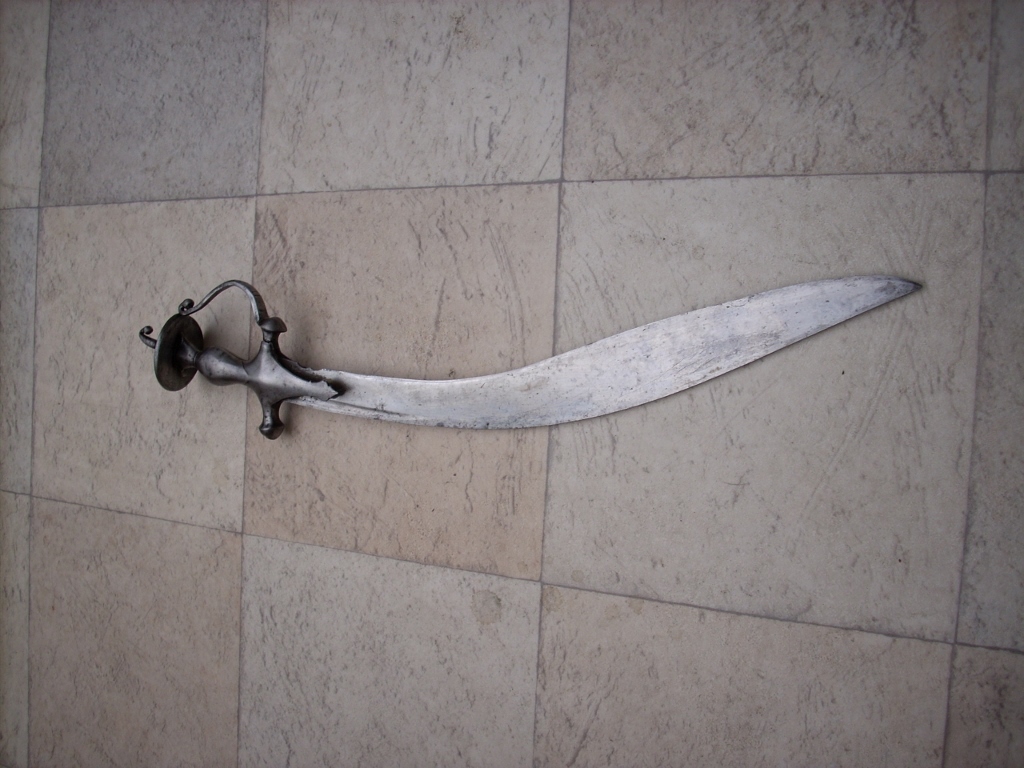

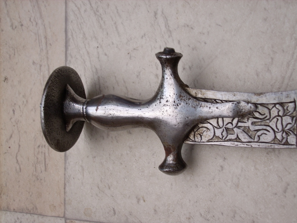

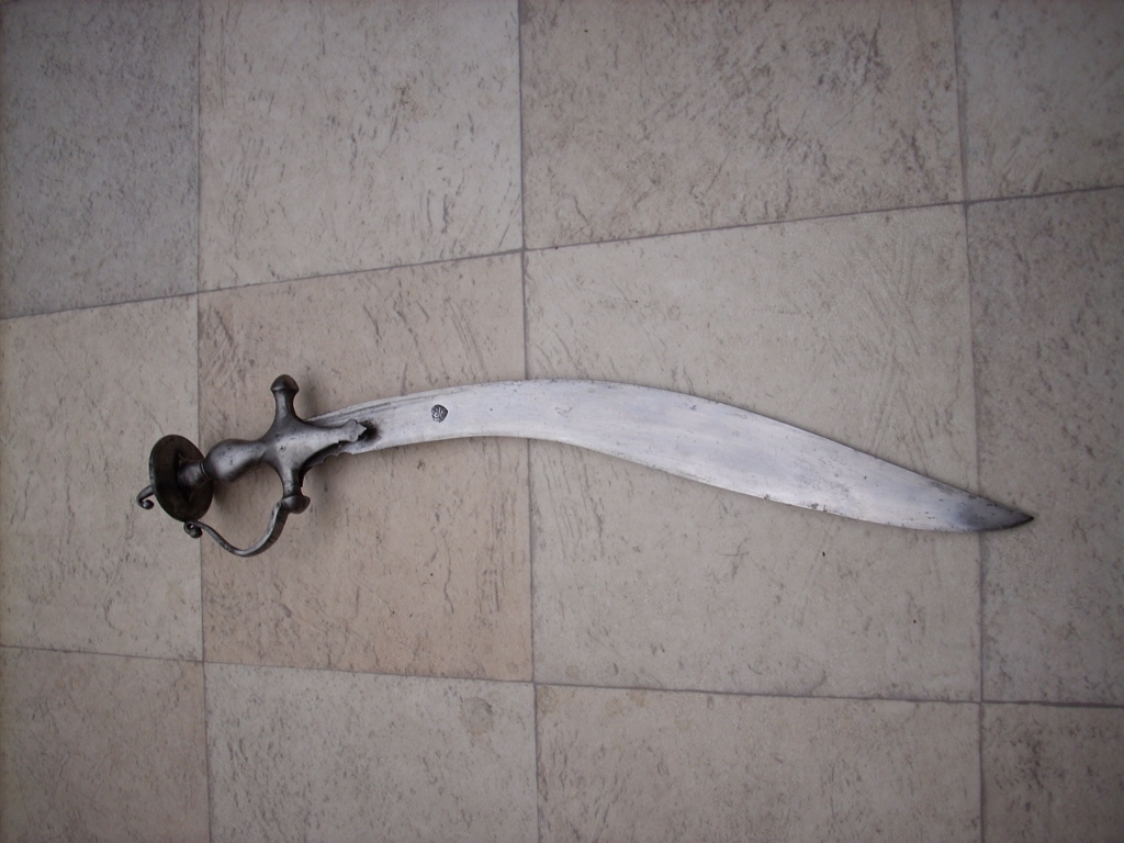

Originally Posted by mrcjgscott
Dear Miguel,
Firstly my apologies for coming to this thread so late, it obviously slipped under my radar!
Thank you for sharing your kukri's with us. The top one has been correctly identified, infact I saw one last month in quite a famous art collection, with the rest of the suite of arms which accompanied it dispersed around the villa housing the collection. The labels stated acquired in 1904.
Such stands of arms were a very fashionable accessory in well to do households of the time, and as well as the catalogue in Berkley's post, I have seen a similar advertisements in the UK.

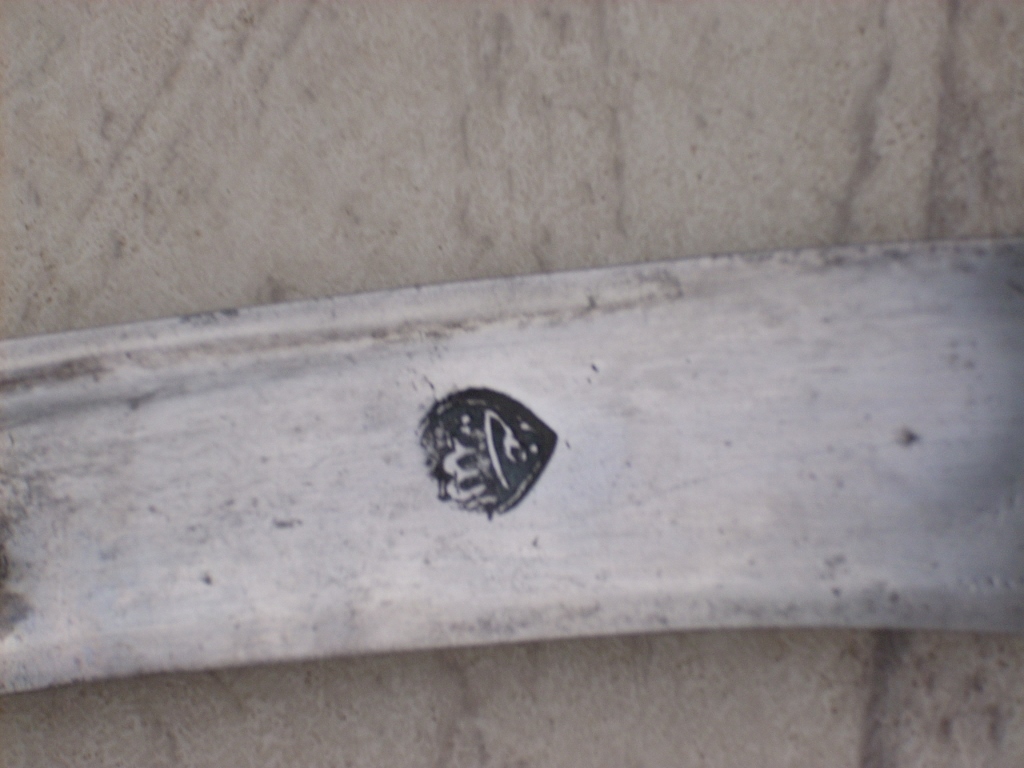

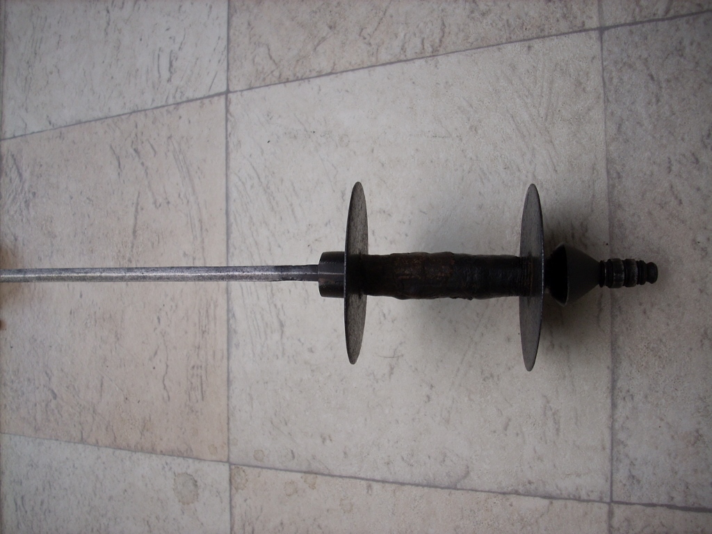

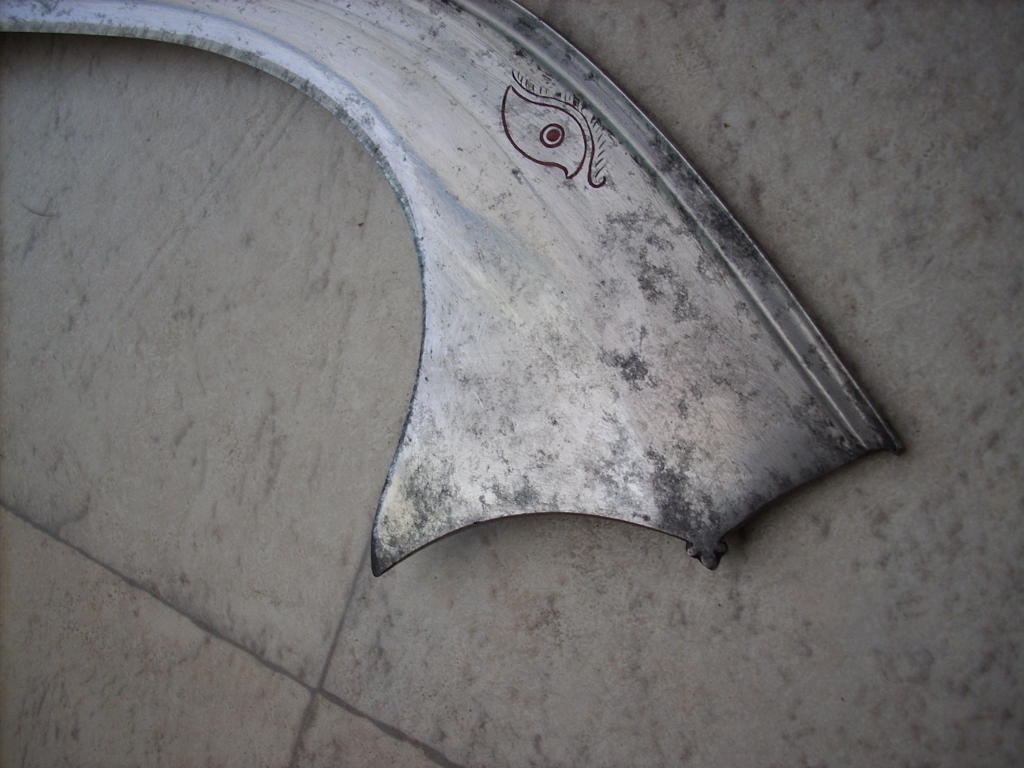

Kind regards,
Chris
Hello Chris,
Thank you for your interesting comments on the Kukris. Apology accepted, better late than never. I have now obtained more than three quotes which fix the time period and use for the wide decorated Kukri and am well satisfied. Not quite so with the plain one although I pretty certain that it's name is a Kukri with a Talwar hilt as obvious as that. A friend of my youngest son owns a business in Katmandu and researching Nepali weapons is one of the services he offers. This person has advised that the blade stamp is 99 per cent Afghanistan and that a number of these blades were produced in the late 18th early 19thC. He pointed out that the Gurkhas were in the North West Frontier for well over 100 years and also in Afghanistan. A contingent apparently as guards for the British installed Sultan. It will be very interesting if your enquiries could confirm this. There is a problem
, however, as my PC decided to stop working yesterday so it will be a while before I will be able to provide you with a clearer image of the blade stamp as I will have to have it repaired or worse purchase a new one. I am sending this reply from my iPad but I can't send photos as systems are not compatible. Your comments on my Kora were most appreciated.
Miguel
Hello Chris,
Miguel
Thanks for getting back to me Miguel,
I am sorry to hear of your misfortune with your PC, I hope you can rectify the problem quickly and with the minimum of hassle and financial outlay!
Afghanistan is certainly a possibility for the plainer of your two kukris, although I wouldn't rule it out as being Indian in origin also. I would also revise the age estimate given by your son's friend to mid to late 19th century.
I will start a hunt for the stamp as soon as I return home later this week, and shall let you know if I find any further information.
With kind regards,
Chris

Old 25th November 2015, 02:06 AM   #30
Yes, there are kukris clearly marked with what we conveniently call " Mazar-i-Sharif" stamp. Likely, just a stamp of government property. They are from the very end of the 19th century, perhaps even beginning of the 20th.
