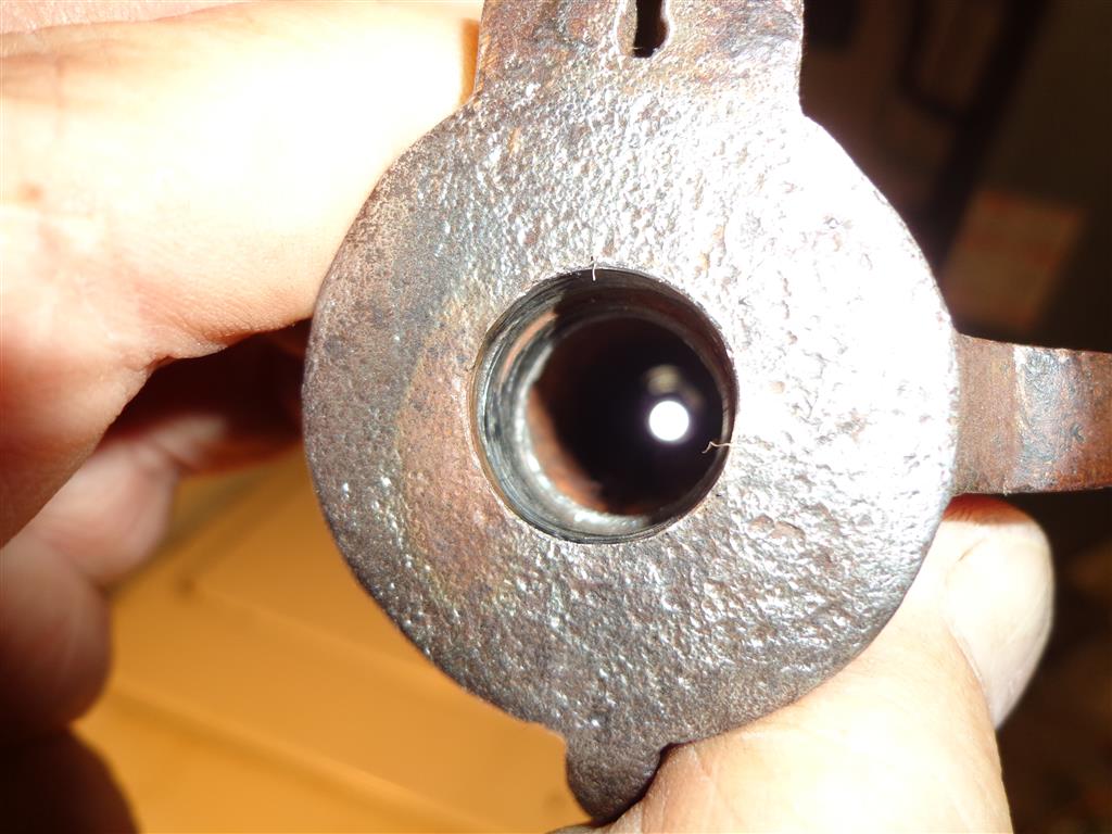

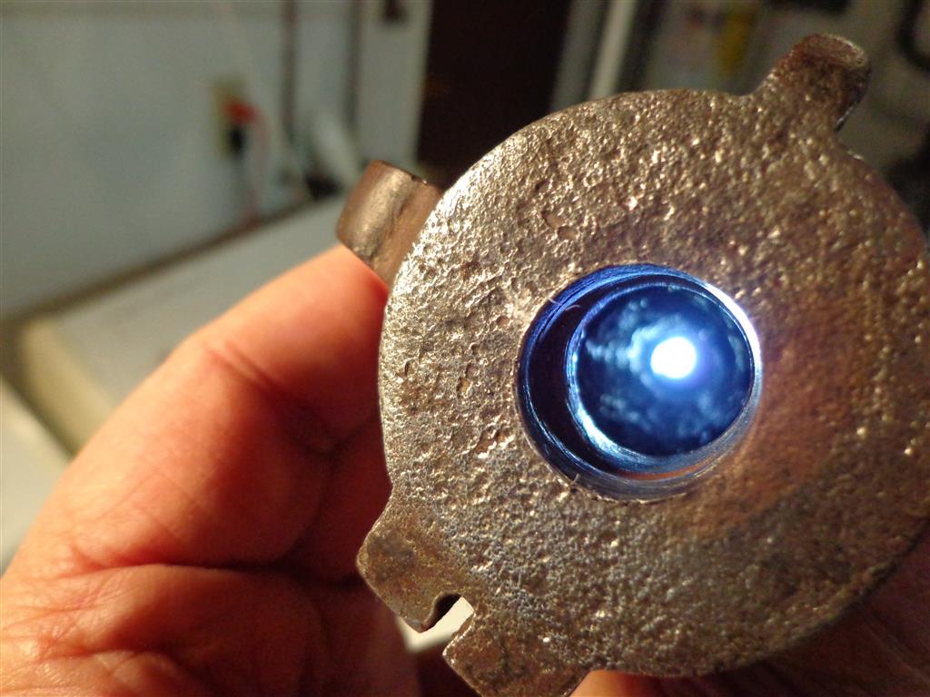

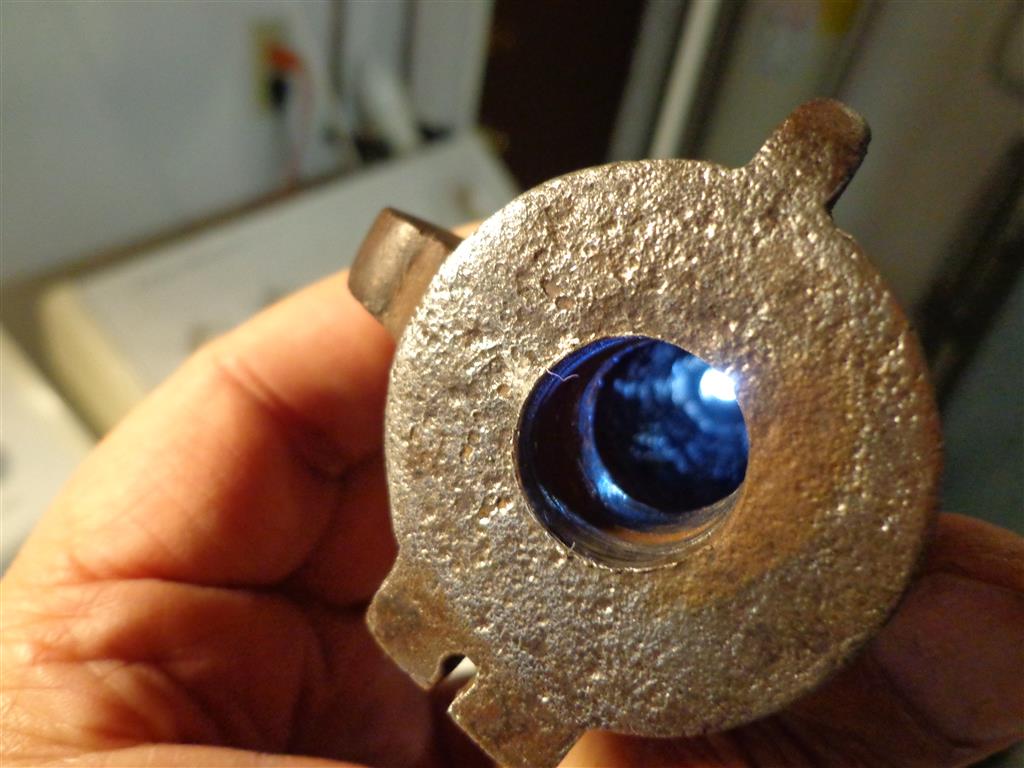

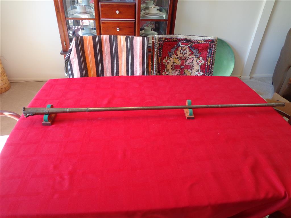

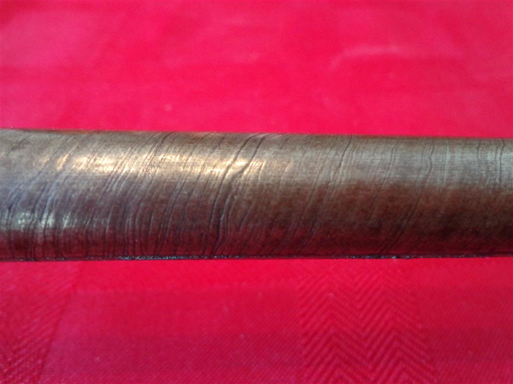

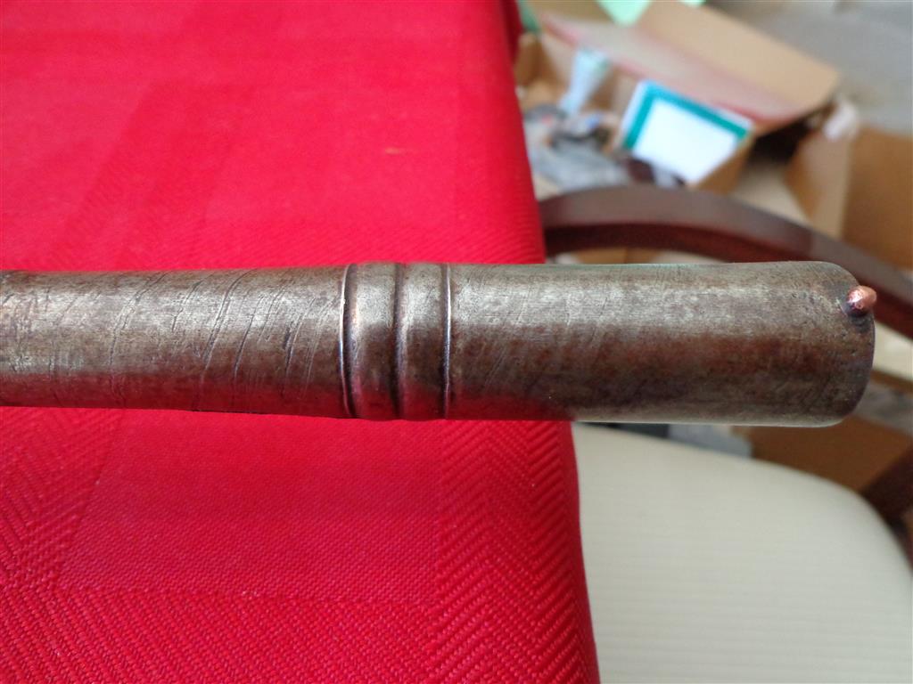

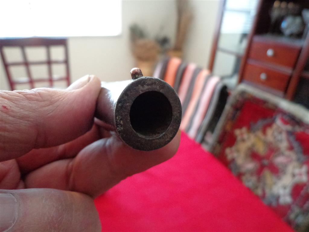

Hello all.

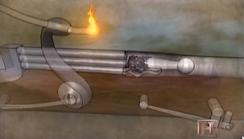

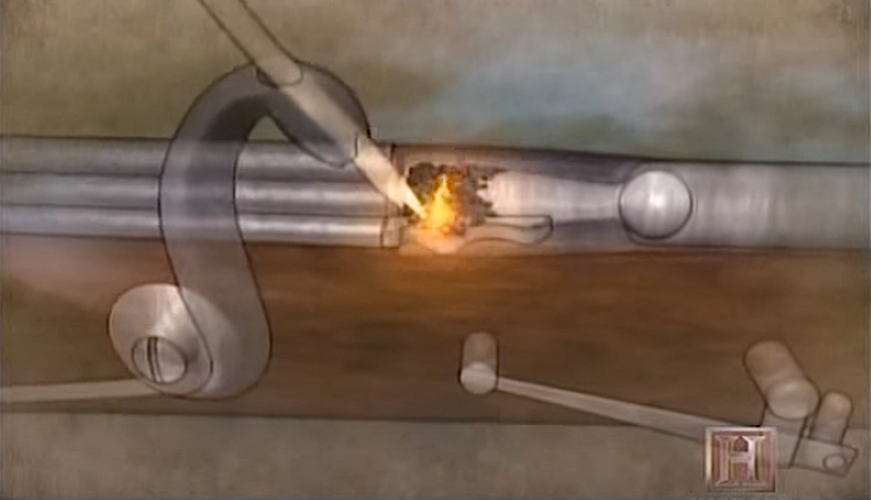

Well, I received the barrel back. On the YouTube video "Mughal Matchlock" there is a very brief skeletal type interior view of a loaded barrel showing the distance of the patched ball from the loose powder in the chamber. I tried putting the video on still, to copy this view, but can't seem to do it. Maybe another member with better computer skills than I can do it ? It does seem to be a accurate likeness of the interior of my barrel. Would sure like to have it.
Anyway, here is what I found: This barrel is 55.5 inches (141cm) long and .59 caliber (15mm). From the muzzle end, the bore travels towards the breech to about 51.5 inches (131cm) where it NARROWS to a smaller cone shape for about the next 1 inch (2.5cm) and into the large powder chamber that is about 2.5 inches (6.35cm) in length and very large diameter. The breech plug material was about 1/2 to 3/4 inches in length (about 1.25 to 2cm).
So it does seem to portry an accurate account of what is shown in the video. To get this shape inside of the barrel, it would have required the barrel being forged around a pre-shaped mandral of some sort. Another interesting note is the vent hole is drilled just ahead of the breech plug, which is typical, but drilled at a 60 degree angle similar to Japanese matchlocks. Hmmmm.

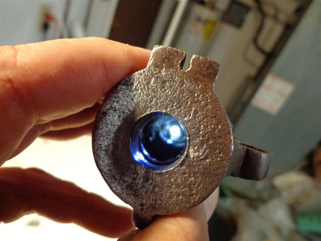

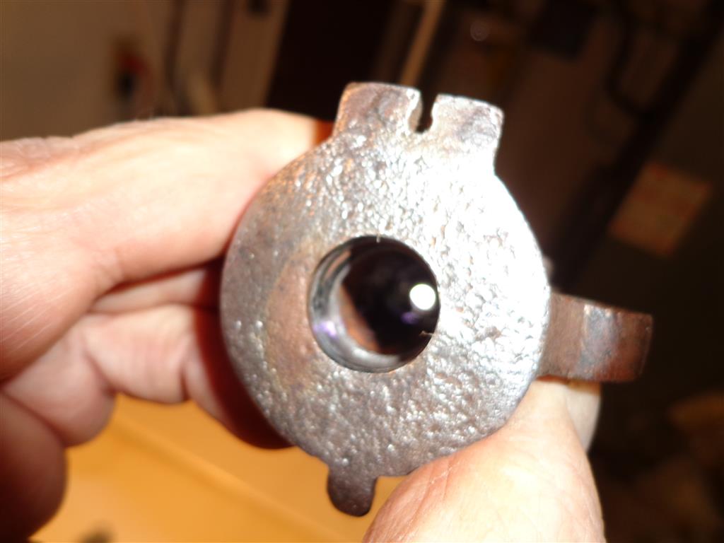

I tried to get the best pics I could with and without flash. But you really can't see the interior properly without specialized photographic instruments. Thus my description above.
Well, I've finally answered my question about the interior of these barrels. It's likely that the other Torador barrel interiors are similar.
Here are some pics............
Rick.

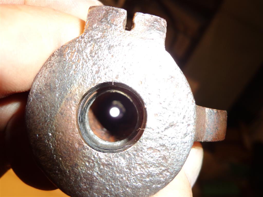

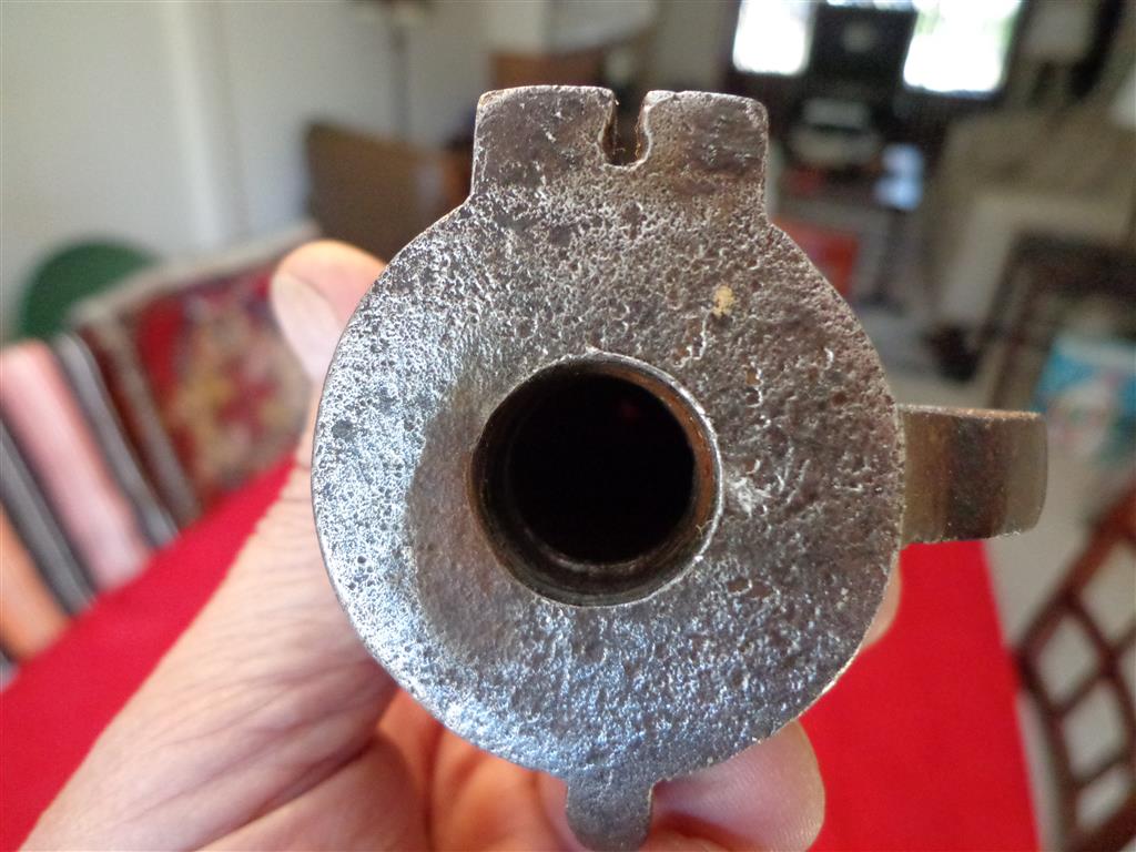

Old 18th October 2015, 06:21 PM   #2
rickystl
Join Date: Jul 2010
Location: St. Louis, MO area.
Posts: 1,633

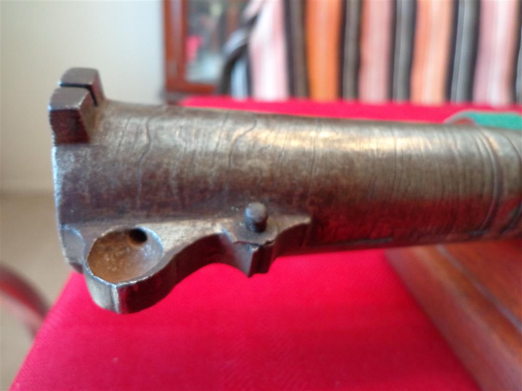

Now the breech end.........

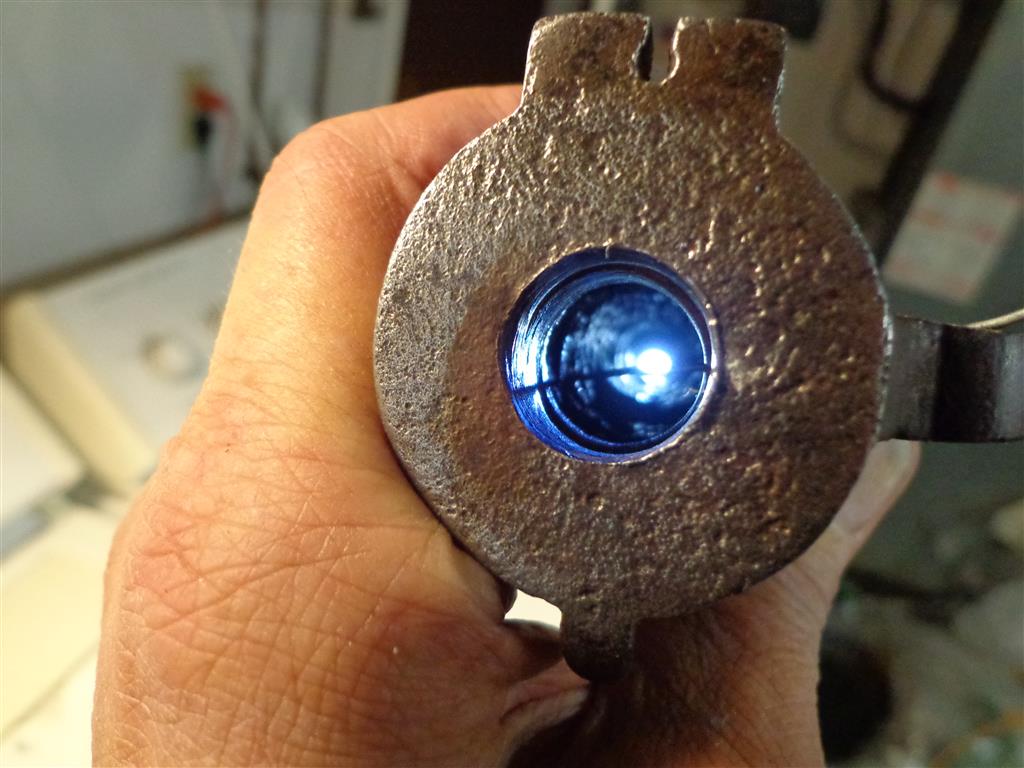

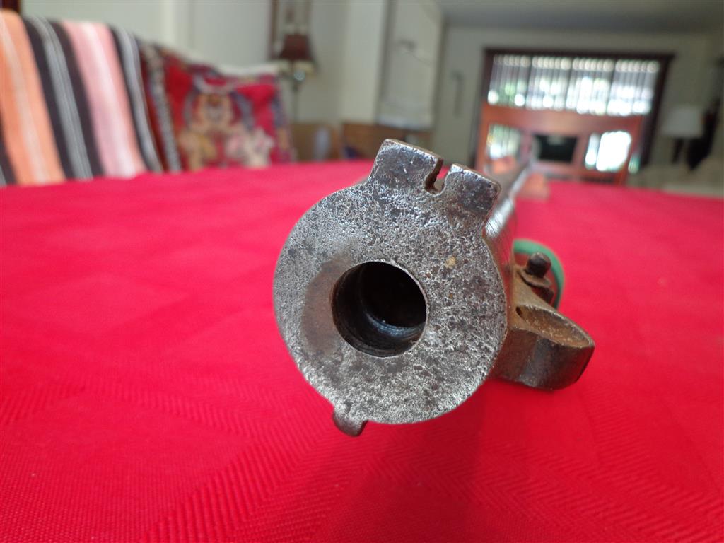

Old 18th October 2015, 06:22 PM   #3
rickystl
Join Date: Jul 2010
Posts: 1,633

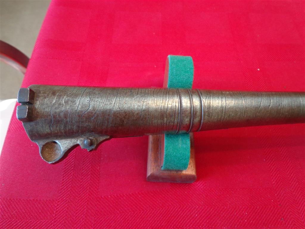

Last ones.............
Old 18th October 2015, 06:54 PM   #4
Posts: 2,833
Hi Rick,
Well I have to admit I am surprised! The thing which interests me is that if the patched?? lead ball when loaded has to be forced past a swamped area of the barrel, what happens when it reaches the more "open" part? I would have thought that the ball would then not be a snug fit anymore, and pressure would be lost past the ball at the time of ignition of the powder.
Also when fired the pressure inside the barrel would be markedly increased on the way out, again when the ball reaches the swamped area, which I would have thought would have increased the chance of the barrel bursting at that point.
Swamped barrels would be safe if lead shot was used rather than a solid ball.
I do not for one moment doubt your findings, but it goes against the safe laws of ballistics as I know them.
I also need to comment on the barrel itself. You would be correct in thinking the barrel was forge welded round a mandrel. That is how the beautiful pattern you have there is created. This method was also used in England and European countries, and we know there are some really exquisite barrels which have come from there.
Regards Stu
Rick,
I hope this is the image you want.
I certainly wouldn't consider trying this as an experiment.
Berkley
Old 19th October 2015, 06:25 PM   #7

Hi Rick, I see Berkley has provided a very clear illustration of what you have described. Thanks Berkley for clarifying that.

Looking at the illustration, it seems that wadding must have been used between the powder charge and the ball. Otherwise, the loose powder would have spread along the bottom of the rear chamber when the barrel was lowered to a horizontal position after loading. Such an arrangement would likely have produced less than optimal results.
This comports with the observation of the old charge removed from my torador by its previous owner:
I dug out some very dry bits of paper that was serving as an over shot wad. Then I dug out a bunch of corroded shot. It was so corroded that it was just a mass of granular white gunk but could be recognized as having been lead shot at one time a long time ago. Following the corroded shot, there was more dry crumbled paper and then I dug out the original powder charge.
