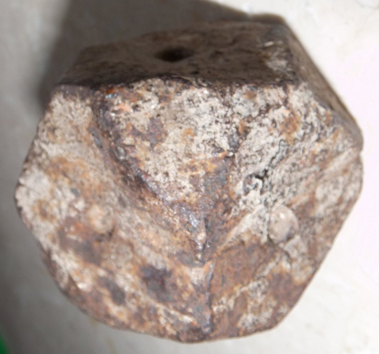

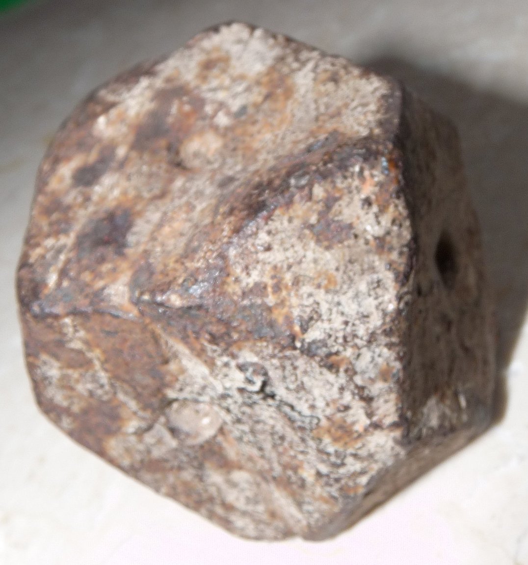

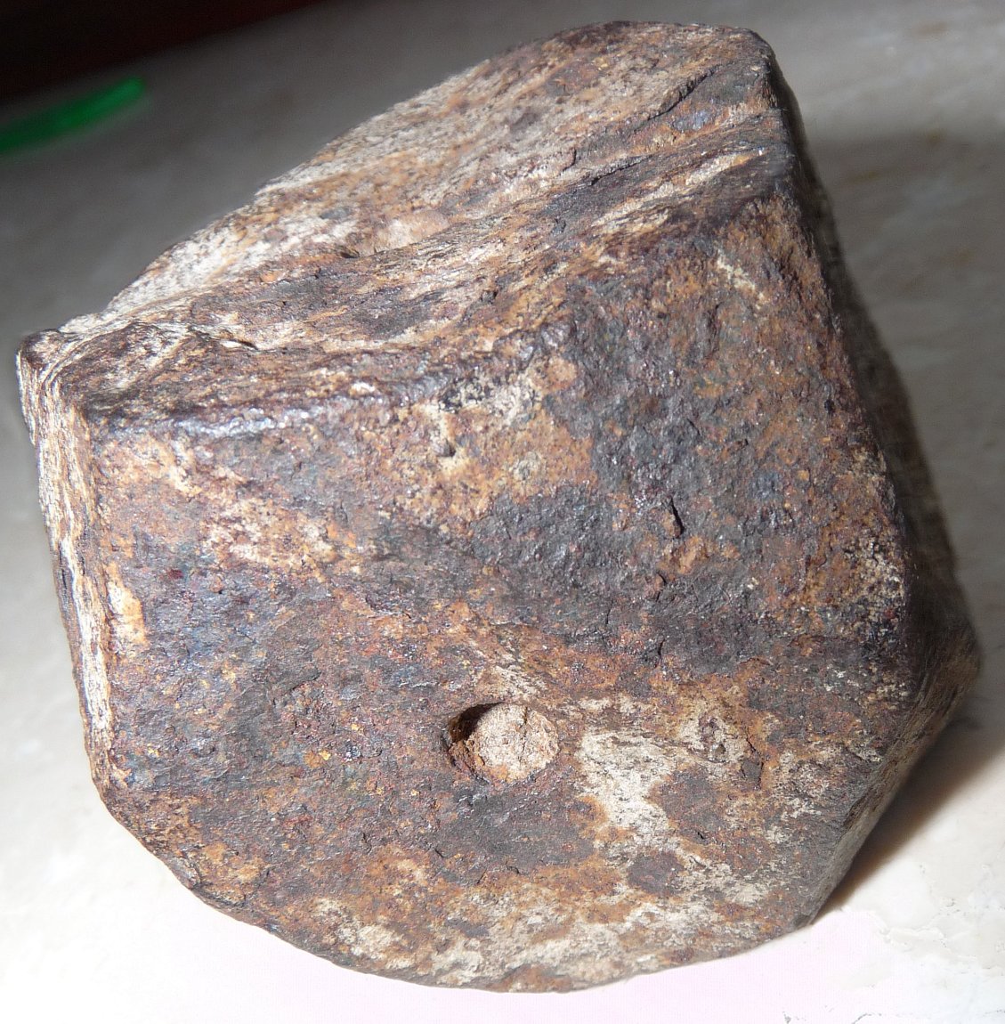

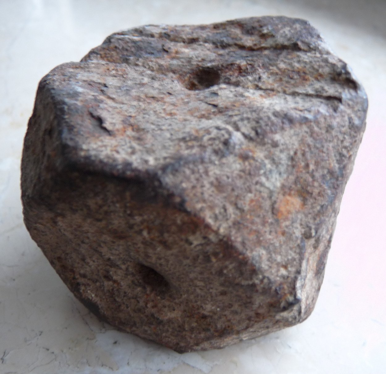

The sample from collection, weighing 1 kg and very similar to the bottom image in post #28.
The traces where the mold halves joined are clearly visible, so it was cast.
It weighs 1.2 kg!
Any guesses what the central holes on the six larger sides might have been for?

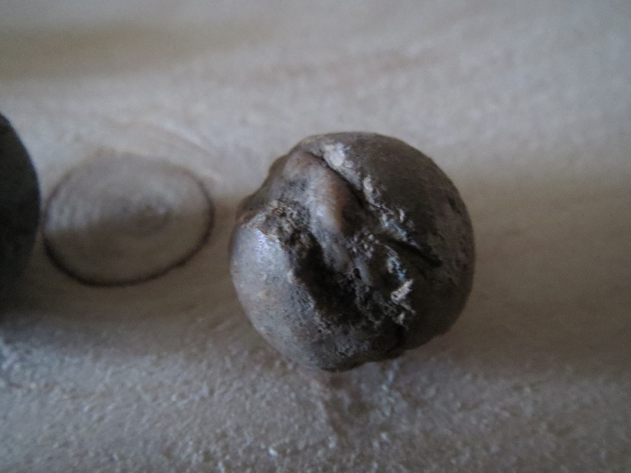

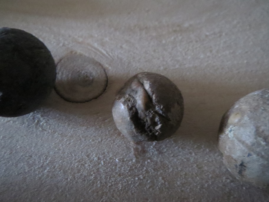

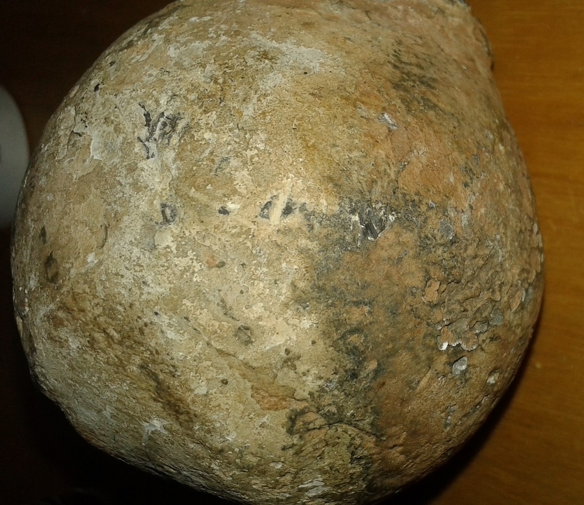

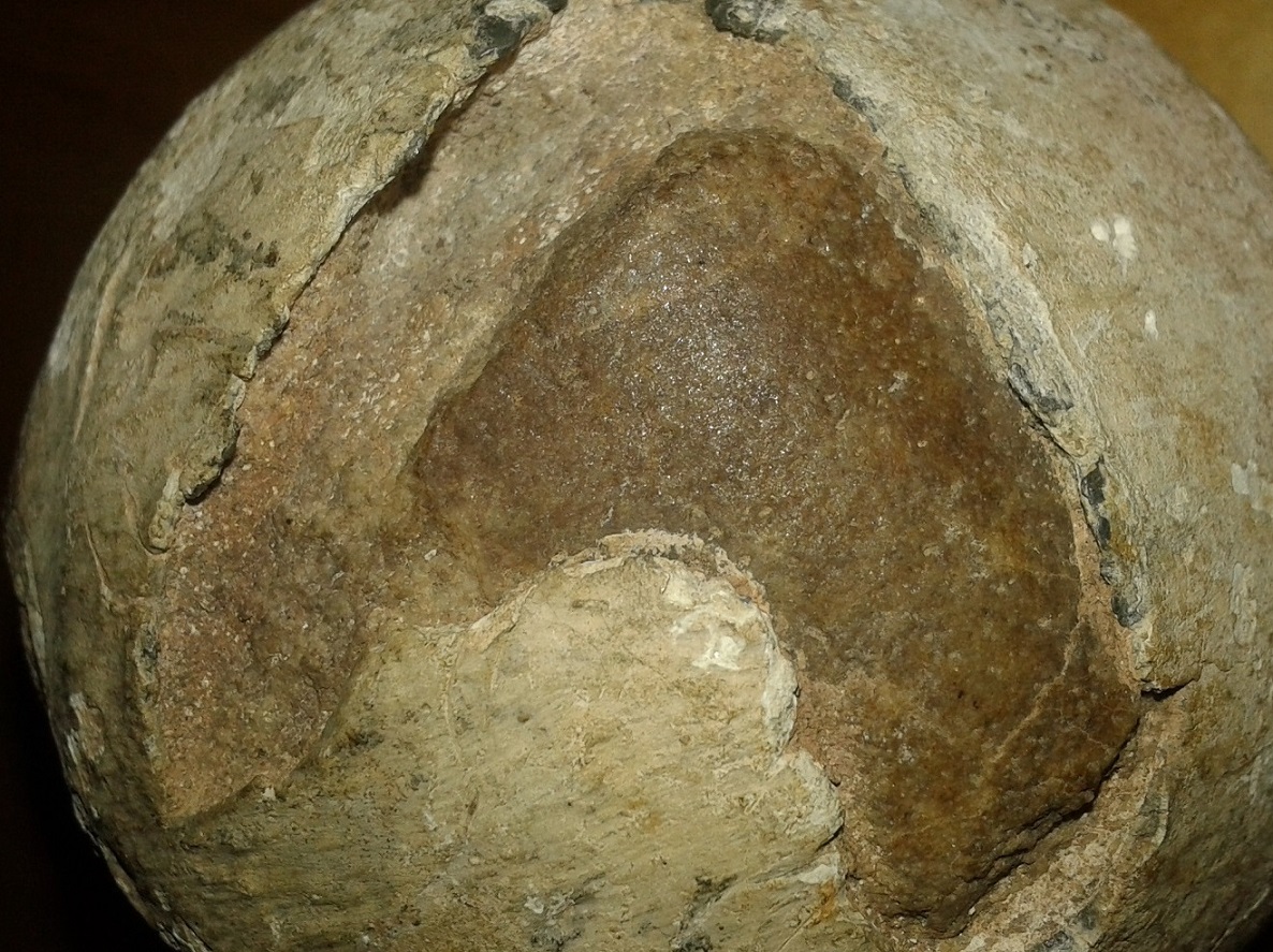

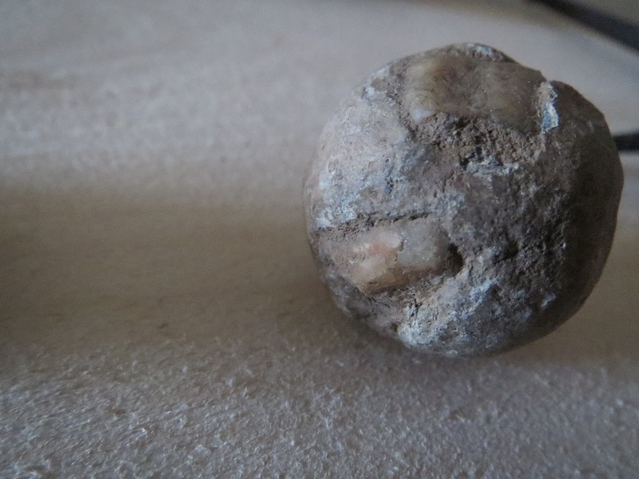

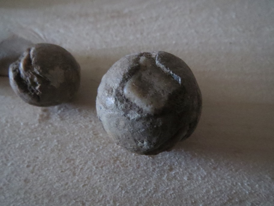

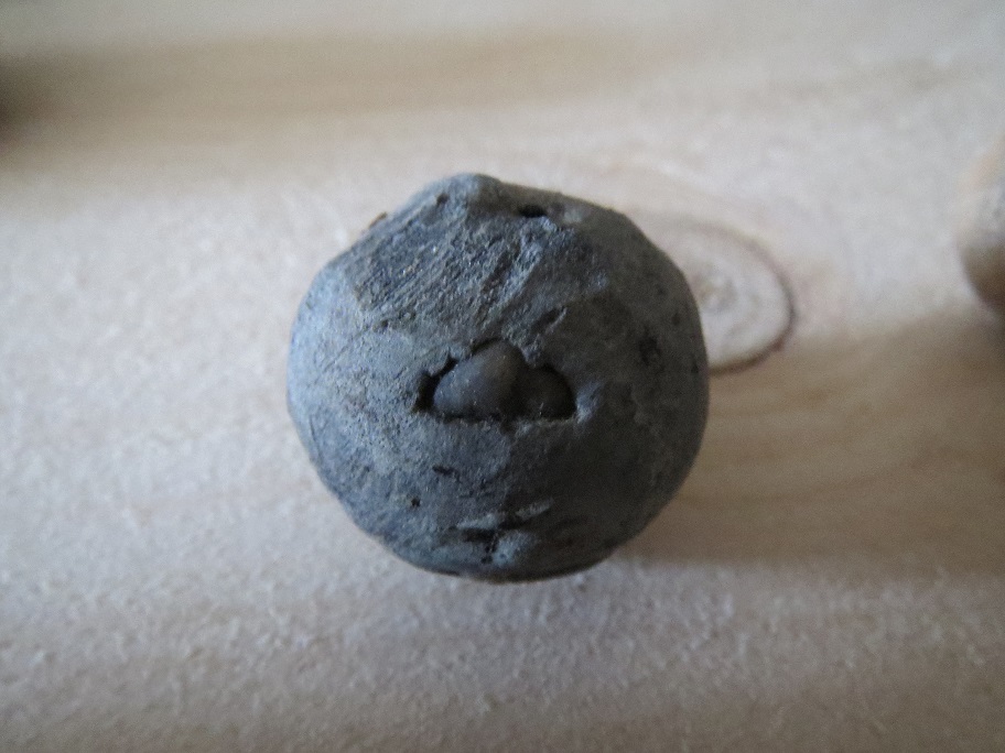

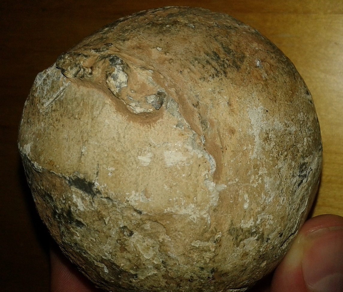

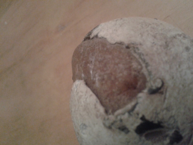

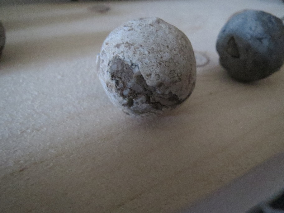

I bought these pieces a few weeks ago from two seperet metal detector enthausiast.
The first three where found near a castle in Boxmeer, The Netherlands (south east, near the river Maas).
The first one weighs 58grams and has a diameter of 25,5mm when measured at the flatened side around the middle. This is the most likely bore caliber.
The second weighs 31grams and is 20mm in diameter.
The third has lost most of its stone core, but some smaller stones remain. It also weighs 58grams and has a diameter of 25mm. This one differs from the first one because the first one most likely has just one single piece of stone while the third has multiple smaller stones and woould have acted like shot. A X-ray of some sort could show more evidence.
The fourth piece was found near Deventer, TheNetherlands near the river Ijsel.
It weighs 61 grams and has a 24mm diameter.

Congratulations Marcus!
I also planned to reconstruct such type of ammunition but I am still not sure how to do it.... Are the pebbles cast into the lead or is the lead folded over the stones?
Andi is offline   Reply With Quote
Old 17th September 2015, 06:21 PM   #35
Marcus den toom
Marcus den toom's Avatar
Location: Netherlands
Posts: 543
Hi Andi, thank you i am quit happy with them as well
The surface is mostly smooth with no overlapping lead, so i would say they where integrally cast. They probably selected stones or pieces of stone that would fit within a mould and put those pieces in the mould before pouring the lead in.
There are also a couple of lead balls with an iron core, made in what i supose is the same way. The pieces of metal are not al round, but seem to have corners apart from the heavy oxidation.

Thanks for your reply. That sounds logically to me, good to get it confirmed

Looking at the Matchlock's drawing on the top of page 1, the left man has a bore-diameter rod with a thin extension that he stuck through the hole in the projectile.
Matchlock's theory was that the holes in the shot were used to transmit the ignition to the superimposed loads in the barrel. But since you clearly see numerous touch holes in the barrel, it just doesn't make sense. There would be gases escaping from these holes, reducing the pressure and velocity. If Matchlock's theory concerning the center holes in the projectiles was to be believed, the barrel would have had to be solid without any touch holes.
I want to propose another theory - the holes in the shot were used to measure the distance between projectiles to ensure that the powder charges properly line up with the touch holes. That is why the man on the left has a "measuring probe" inserted through the center hole in the clot shot.

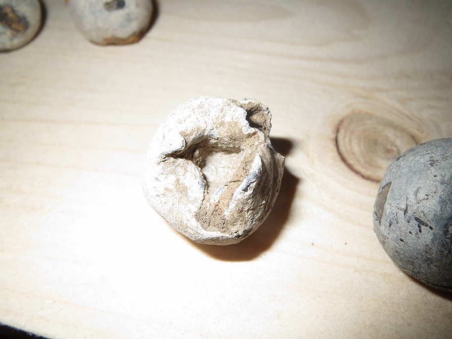

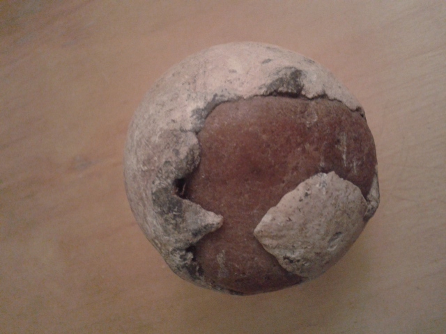

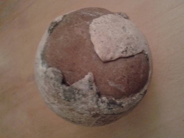

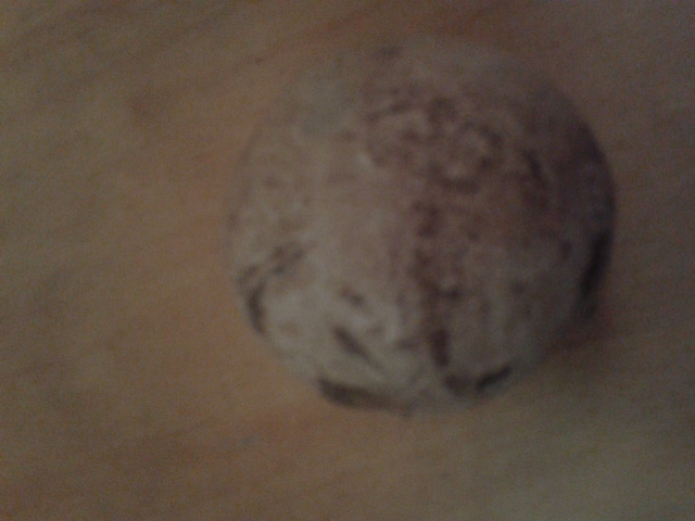

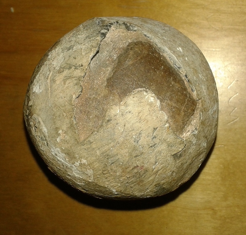

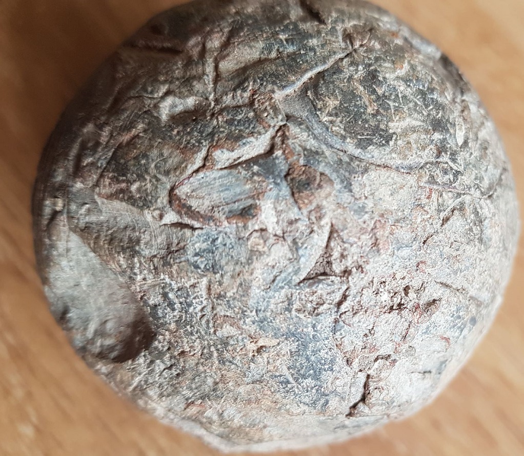

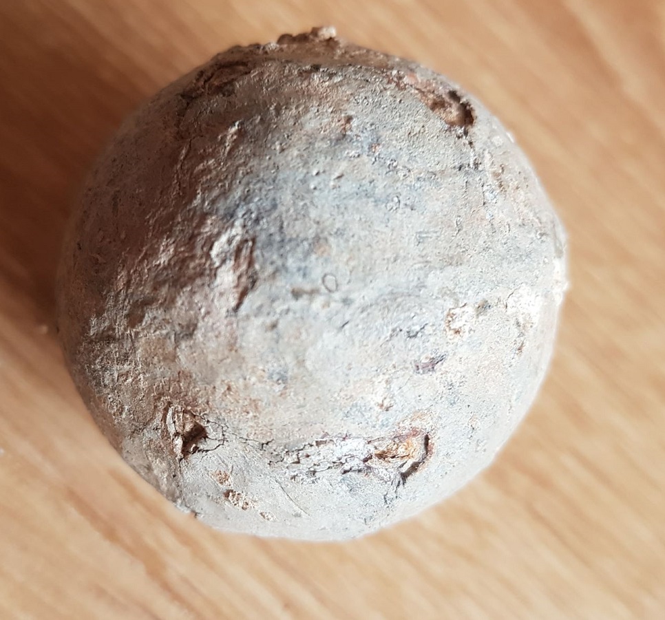

Reviving this thread with this 7cm piece of clodshot. Lead with a stone cast together.
Found at the North sea near Northumberland.

Yes it is, just like this 4cm one from the same source.

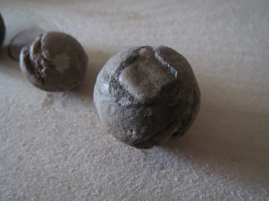

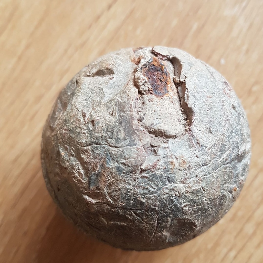

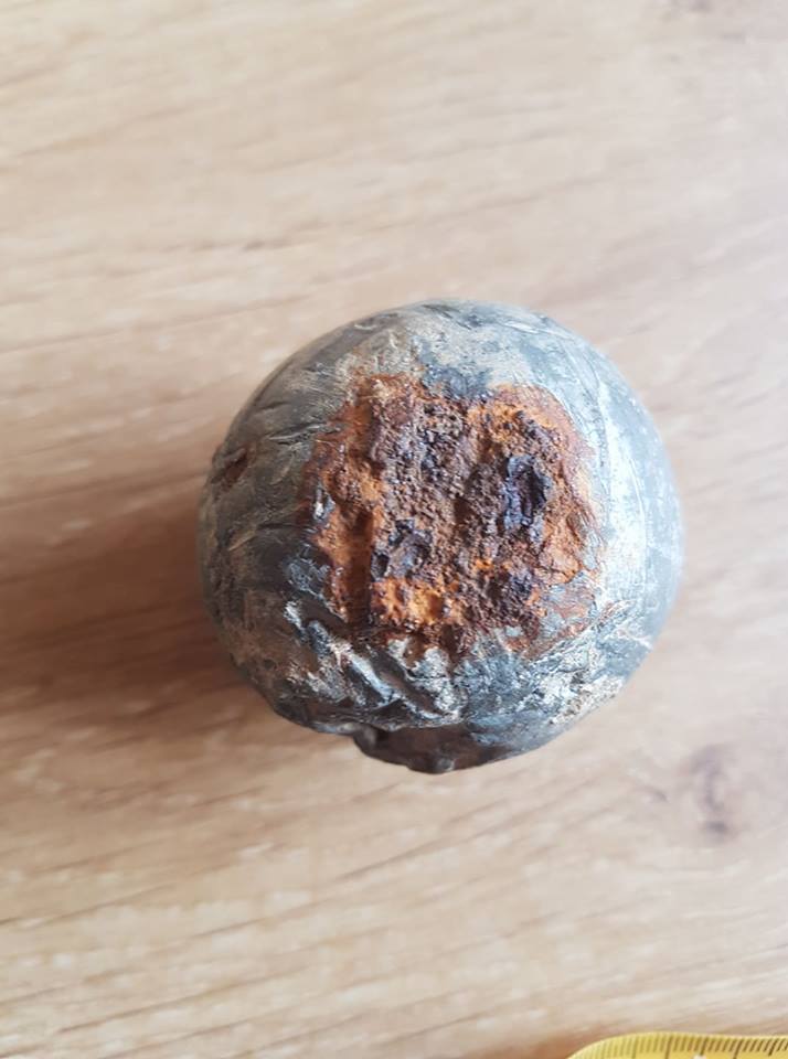

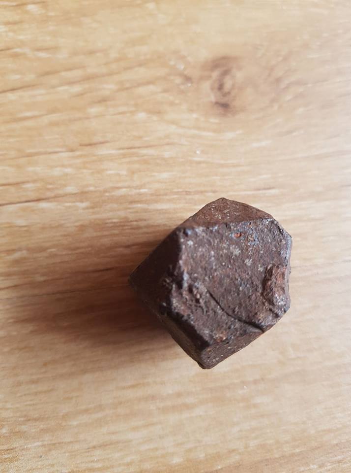

And even more now

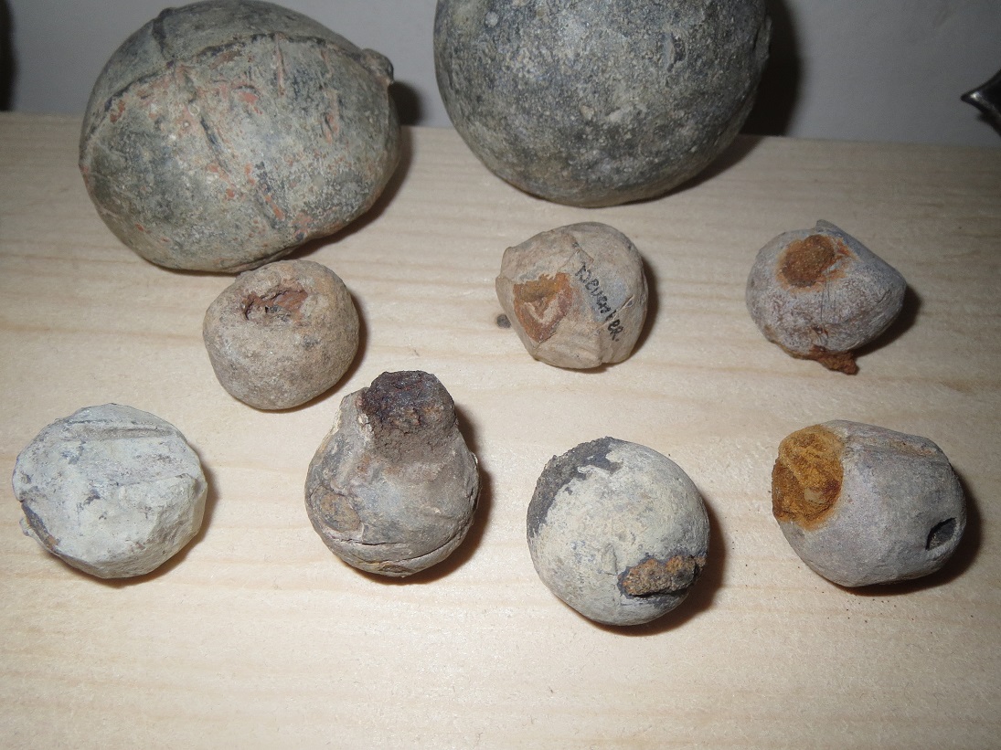

Bought these recently and they are the rare clodshot Michael spoke about. Also a iron core like the one Michael showed us before.
The lead seems to be wrapped around at least one of the balls, but these might just be "scars" in the lead.
The iron cores have been hammered, i think the edges where not broken of but completly hammered this way.
