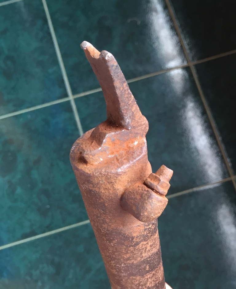

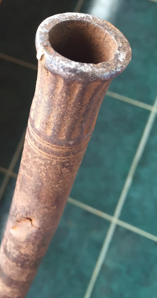

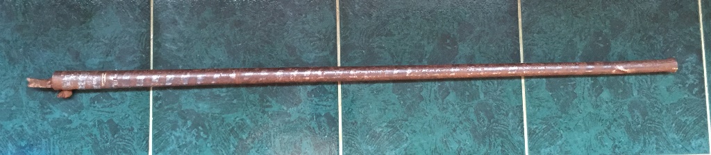

Dear all,
Is it possible to define origins of this musket barrel based of the shape of the muzzle ?
Evgeny

The barrel of an Indian Toradar ?
This barrel was excavated here in Russia so I'm not sure that it's Indian.

Or a Miquelet Turkish...either way ... wrong part of Forum.... Please can this be shown on Ethnographic.... and a fuller picture please? Sorry crossing posts... Could be a wound barrel Turkish Miquelet??

Now Evgeny shows us some more part of it; why not in the first place ?
If it has a percussion chimney, would not be (flintlock) Miquelete.
Let us see more pictures, in different angles; will you Evgeny ?

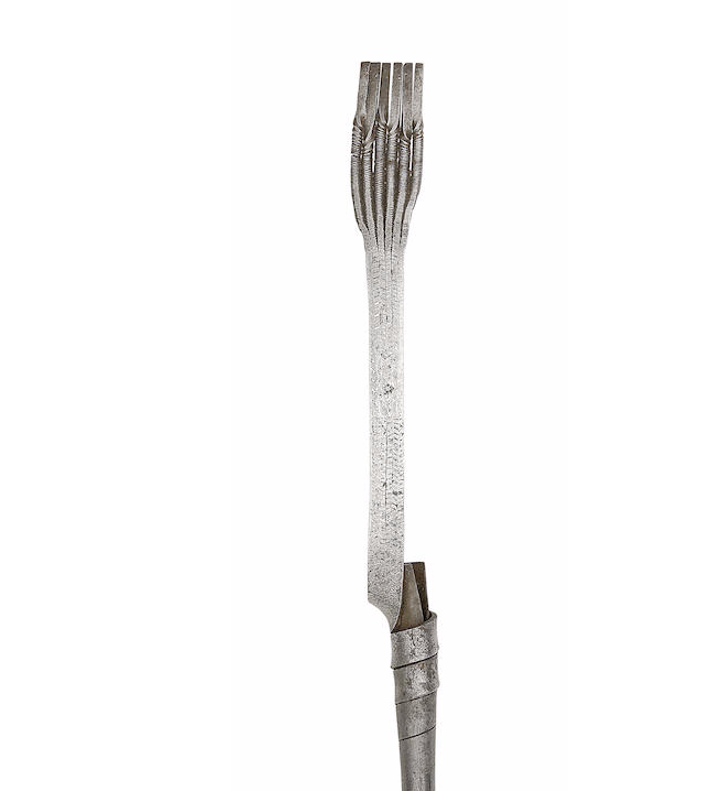

Just for comparison, this wound barrel specimen was sold yesterday att the Bonhams auction house.
Interesting to see how these damascus barrels where made.

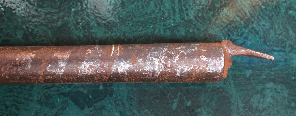

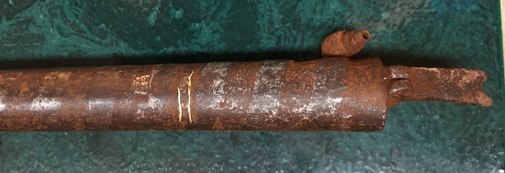

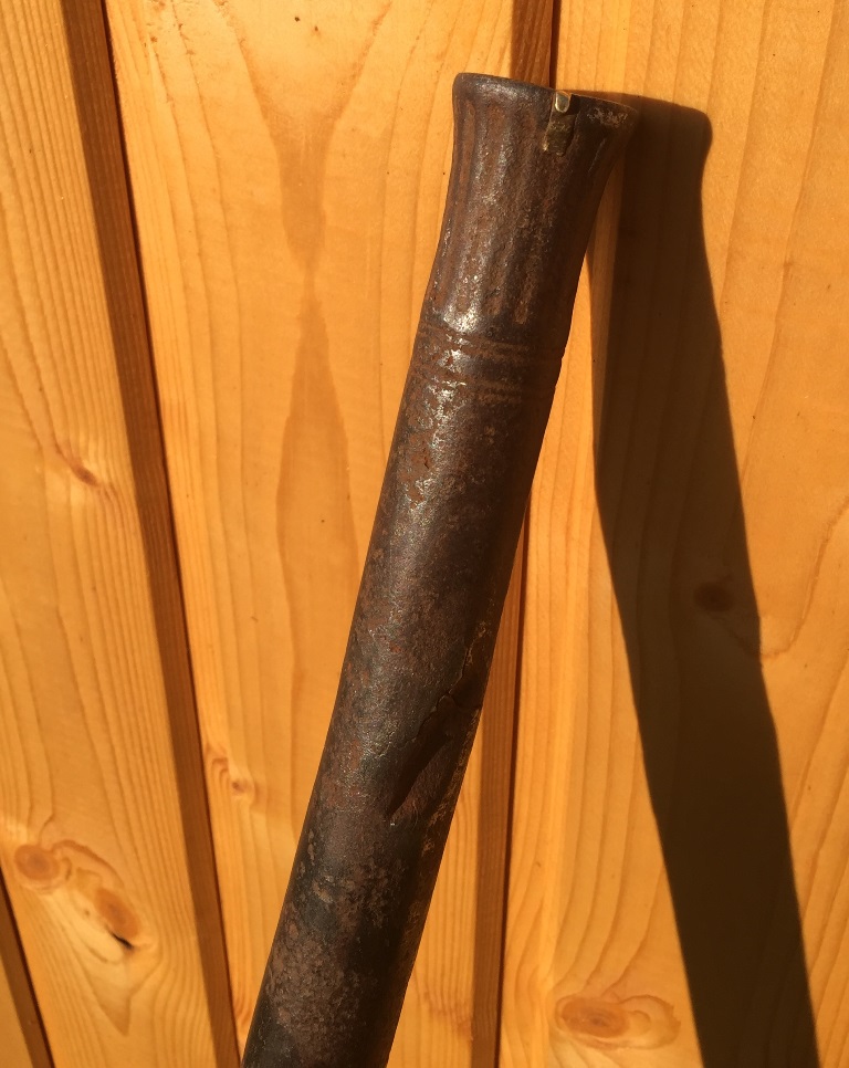

Here are some additional pics of the barrel.
Total length is 113 cm
Barrel caliber is 2 cm
Evgeny_K is offline   Reply With Quote
Hi Marcus.
Now that's interesting. I wonder if that was intentionally made as a display piece or styling excercise? Or simply an unfinished barrel?

Hi Evgeny.
Just when I think I've seen most everything in Ethno firearms, something new pops up.
This is a tough one to pinpoint it's original origin. At first glance at the muzzle end, it says Indian Torador. And I'm convinced it did start life as a Torador barrel. The front sight even mounted on the top edge as typical Torador.
But the breech end of the barrel looks nothing like Torador construction. There is no swell at the breech, and there is an actual breech "plug and tang" which is probably threaded into the barrel. Torador barrels were flat at the breech end. The breeches were plugged by forge wlding (or similar). And the breech plug on this barrel, with it's slight curve downward, looks Europen in origin.
So, I'm going to say this barrel started life as made for an Indian Torador long gun. Later, back in the period, it was cut off at the brech end a genuine breech plug added, and converted to percussion with the addition of a drum and nipple as shown. There may have been breech damage to the barrel, thus the cut off and conversion. Even the rear sight slot looks exactly like the ones on Torador barrels. Could have been cut off and re-welded to the barrel.
Of course, I'm just speculating. It could be an Ottoman made barrel, with a Torador style muzzle, and converted to percussion. But I don't think so. For now, I'll stick with my first guess.

Hi Rick,
I'm sure that it's not an Indian barrel.
The Ottoman origins are more probable I think.
Evgeny

Originally Posted by rickystl
Hi Marcus.
Rick.
I think you will find it was made as a display piece. I have seen something like this before.... Also you would need to forge each operation/piece to completion before starting the next. In its present form it would be impracticable to finish the barrel.

I must be missing something. I see nothing that indicates an unfinished barrel? The breach is plugged, and the tang shows signs of heavy use, even damage. The area around the nipple shows deep pitting, which is an indication of repeated firing, over a long period of time. And then, there is the matter of what looks like battle damage, near the muzzle. I agree, that it is a recycled barrel of some sort. Looks Indian to me. Please, tell me what is unfinished.
This one!

What does an incomplete barrel, in the process of being made, have to do with a complete, functioning barrel? The fact that you see alternating colored bands? I have a Japanese Murata, that is very complete, and has a barrel with two distinct color steel bands in the wrap. OK, I see now. The discussion went from the original post, to something totally different.

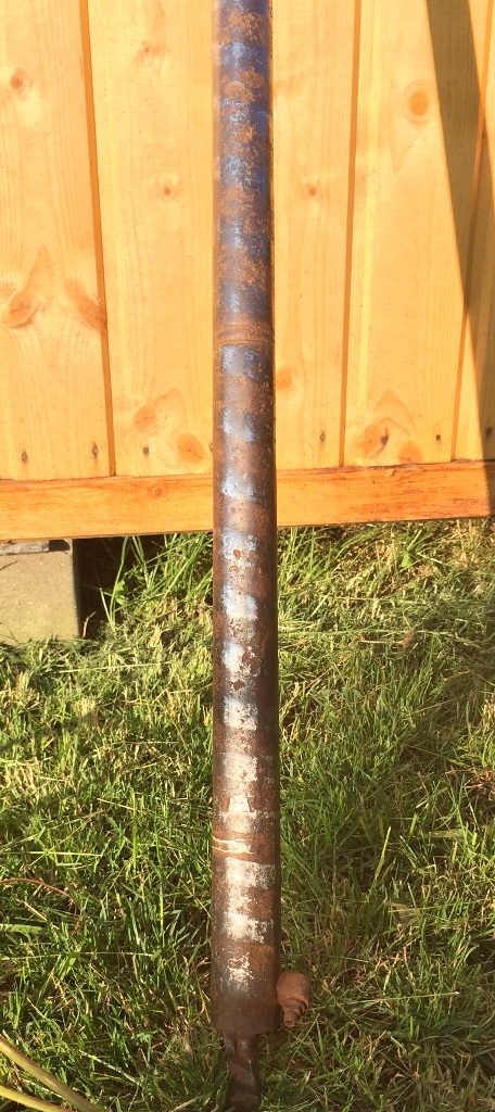

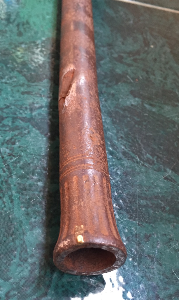

what about this barrel, gents ?

Very sorry!
I believe it is a torador barrel, but re-worked at some time.
In England, oriental/Indian /Persian, barrels were quite popular at one time, re-breeched and fine bored if needs be, for use on good quality sporting guns, (18th century.)
I see no reason why other parts of the world could not have had a similar fad, so even if it came from Russia, this does not mean it cannot be from India originally.
