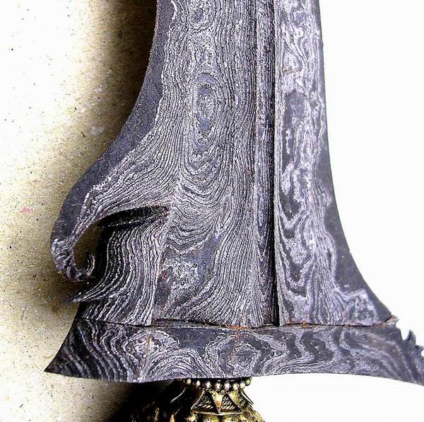

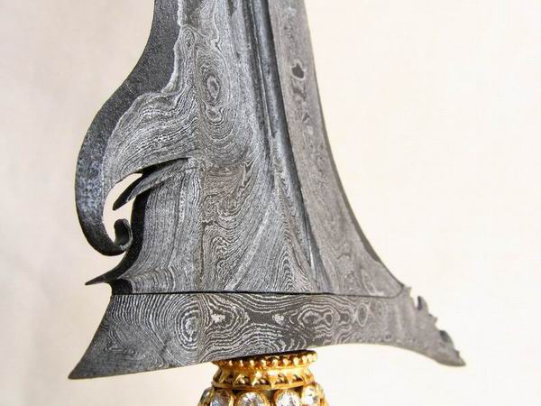

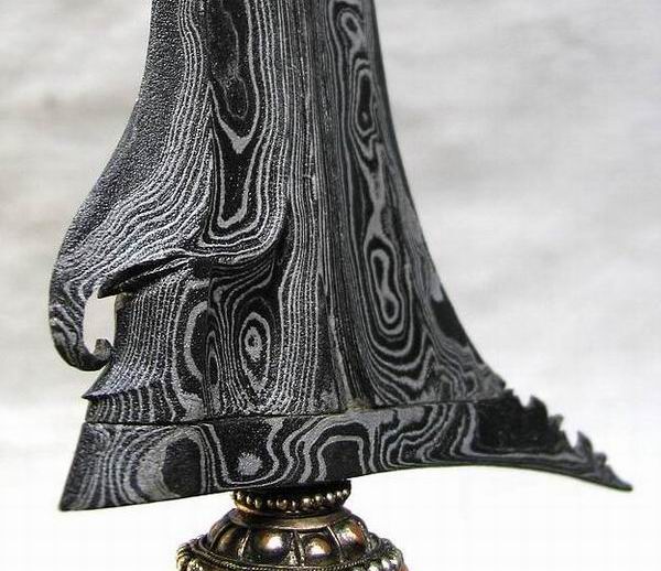

The pointed top end at the sides, are these Pudak Sategal?
Normally on a Dapur Pandawa Karno Tinanding blade, there is a pair of lis-lisan but this blade seems to have Pudak Sategal instead.
I wanted to confirm this feature. Please assist.

Yep, that's what i'd call 'em. But then, what do i know?
BTW, nice modern keris craft, that.

Manolo, good observation. It's like a 'champion' model of the swiss army knife, where there are many features...on this one.
Battara: Could this be a new evolution of the keris
Battara, possibly it may. I'm not surprised if in the future, perhaps you can order a piece with features that you like, a custom-made piece.
Nechesh, modern it is. But 'internally' does not necessarily be 'empty'.
What I'm wondering is, with Pudak Setegal, can this keris dapur still be called
Dapur Pandawa Karno Tinanding or instead
Dapur Pandawa Karno Tinanding Pudak Sategal or
something else altogether?

Hello Alam Shah and all Kerislovers,

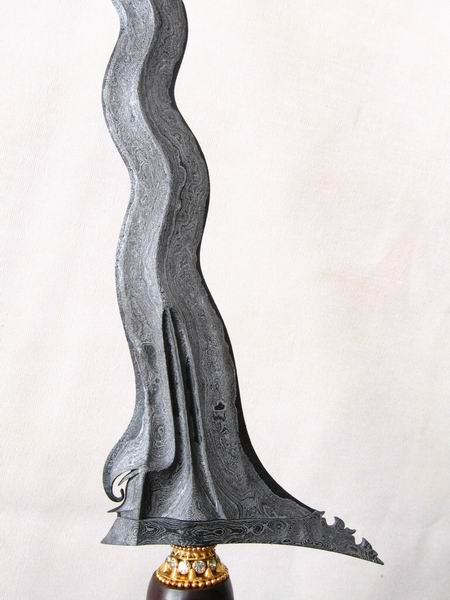

i don`t want to make you angry but there must be some critics! But first of all i want to say according to my textbook with drawings of 1920 of the Keraton Solo this keris is:
dhapur Pandhawa Karna Tinandhing but because of the ganja kelap lintah we could add Pandhawa Karna Tinandhing kelap lintah ?.
The description of the ricikan are:
luk 5, blades with 5 luk has in general the name pandhawa
pejetan ngajeng-wingking,
sogokan ngajeng-wingking,
tikel alis ngajeng-wingking,
sekar kacang ngajeng-wingking,
lambe gajah kalih ngajeng-wingking,
jalen ngajeng-wingking,
pudhak sategal bungkem,
ron dha kalih.
The design of this dhapur is probably not so old (late 19th-early 20th cent ?)
The execution and garapan of this blade ist still far from perfect because of the base line of the ganja and blade. Should be a small angle between the centerline of the blade and the base line therefor the blade is showing stiffness. Also the buntut of the ganja (to long) and also the flow of the wuwung ganja especialy the luk of the buntut-side is to slow.The lower ron dha is more closed then the upper one. The tampingan pejetan are almost parallel to the ada-ada, should be more narrow in the upper part and the tampingan should be straight. The lambe gajah goes to far out of the blade.
But anyway its a beginning and i have the feeling or better my observation are: the quality of of modern keris is improving and this makes me quite happy especially the keris becomes a world treasure of mankind.
The mass production of Madura might have followers but most of them are not the real high keris culture.
Salam to all of you and Happy New Year
Ki Jayamalelo

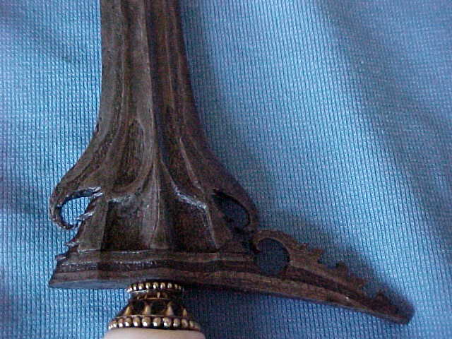

Hello Ki Jayamalelo,
I placed this keris before on the forum. I got just a little response.
Your Critism is a eye opener ( although to me )
Is it possible to give a comment on this one?
Of course everybody is invited too, dont hold back
thanks in advance

No need to worry about angering me at least, opinions are just that.
Perfection is a) Like beauty in the eyes of the beholder b) Perhaps best reserved for the likes of God. I think it might also be a bit difficult to really judge the garap of this blade given the limited area of the blade that is shown. I still think this is an exellent example of modern keris making. Let us keep in mind that most older blades fall even further from the tree of perfection than this one. Critique is all well and good and in fact necessary, but i would still be pleased to own such a blade.
You might also keep in mind that your ideal of the perfect blade is based on an older set of standards which may infact being changing in mode with fashion. Nothing stays the same, not even man's ideal of perfection. Just take a look at older art works to see how the ideal female form has changed over the years and through different cultures.
I think it might also be a mistake to place all these modern keris under the title of "mass produced" Madurese. Firstly mass produced gives me the idea of something machine made, where one product is identical to the next. While certain modern methods are no doubt employed this is hardly the case in the making of this keris. Also, keris of many different levels are being produce today, just as in the past. This is an example of the higher end of that spectrum. I also hope not to anger you when i say that i could really care less how the "real high culture" of keris view these modern works. That hardly invalidates their existence for me. I obviously don't collect keris for the same reasons they do, perhaps not for the same reasons ANYONE else does. All this being said, i must admit that the large part of my collection is older keris, 19thC and older, but i do own a couple of very nice 20thC pieces. To paraphrase an old saying, I may not know keris, but i know what i like.

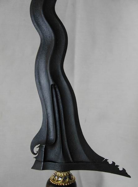

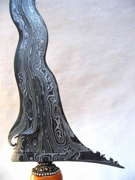

Here I posted the example of each levels are being produced today
All of these keris are NEW MADE.
Mans is offline   Reply With Quote

Sorry Martin, i didn't see your post til just now. Yes, your keris is of a similar dapor, but just as we were saying about different quality levels of modern blades i think you can probably see that yours is somewhat inferior to Alam's example. While Ki might find the form of Alam's keris stiff i think you will agree that yours is much less flowing. The garap just isn't right. But then, this is just one man's opinion.
Hi Ki Jayamalelo,
Alas... 99.9999% of us keris collectors can never hope to own, touch, or even see a high-culture keris...
But your comments are certainly necessary to see where the high end of the bar is. Empu Kumis used to share with us the features of a good keris, in accordance to his very strict standards.
Unfortunately, pictures of good high-culture kerises are far and few in between, so it is difficult to appreciate the aesthetic nuances that the words are trying to describe.
Mans' kerises have less fancy dapur, but I don't think all of them can be said to be inferior.
The 2nd picture from the top -- that is a very graceful and balanced keris that does not lose out to the karna tinanding, which I think is a nice one too.
Look at the way the kembang kacang progresses from thick to thin before curling in -- its just 'manis' (ok, the final curled tip is a bit disappointing, but still the overal kembang kacang is very well-executed). Notice that both sides of the kembang kacang are not 'flat' at the top; there is a slight concave contour to it. This feature is much better than the karna tinanding's
The jalen and the lambei gajah, and the gandik under the jalen curls very nicely, and are not too long, not too stubby. I feel that this set of features are thus nicer than the karna tinanding's rather exaggerated ones.
The sogokan depan and belakang, in my opinion, are about as nice as the karna tinanding's, though still a bit stiff. Nice fat bungkul too.
The ganja is better though, especially in terms of the definition of the greneng, the length in proportion to the base, and the curve at the end.
Luk-wise, the keris looks proportionate and sweet.
And hey, pamor is condense and very well executed too.
Personally, I'd prefer this keris to the karna tinanding, although if presented with the chance to acquire the karna tinanding, I would grab it too!
