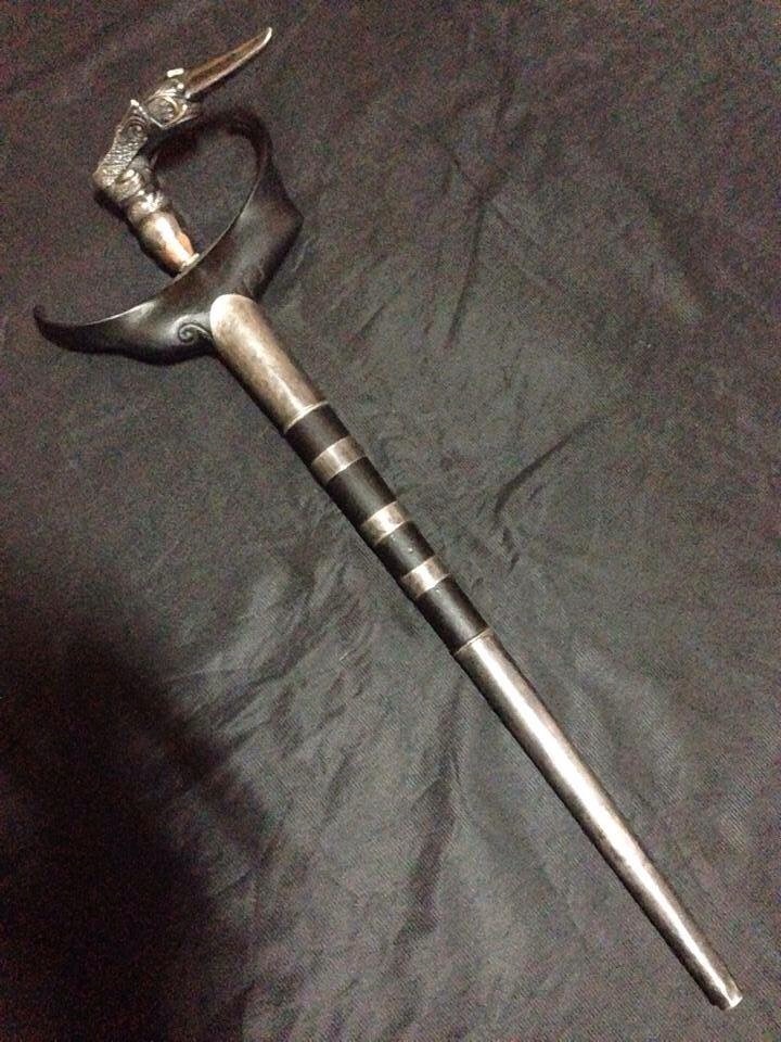

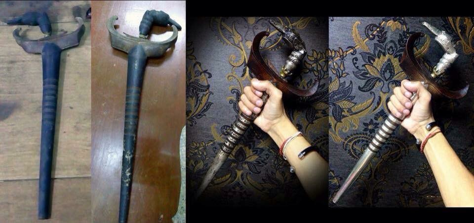

Another of ɱყ friend's Coteng

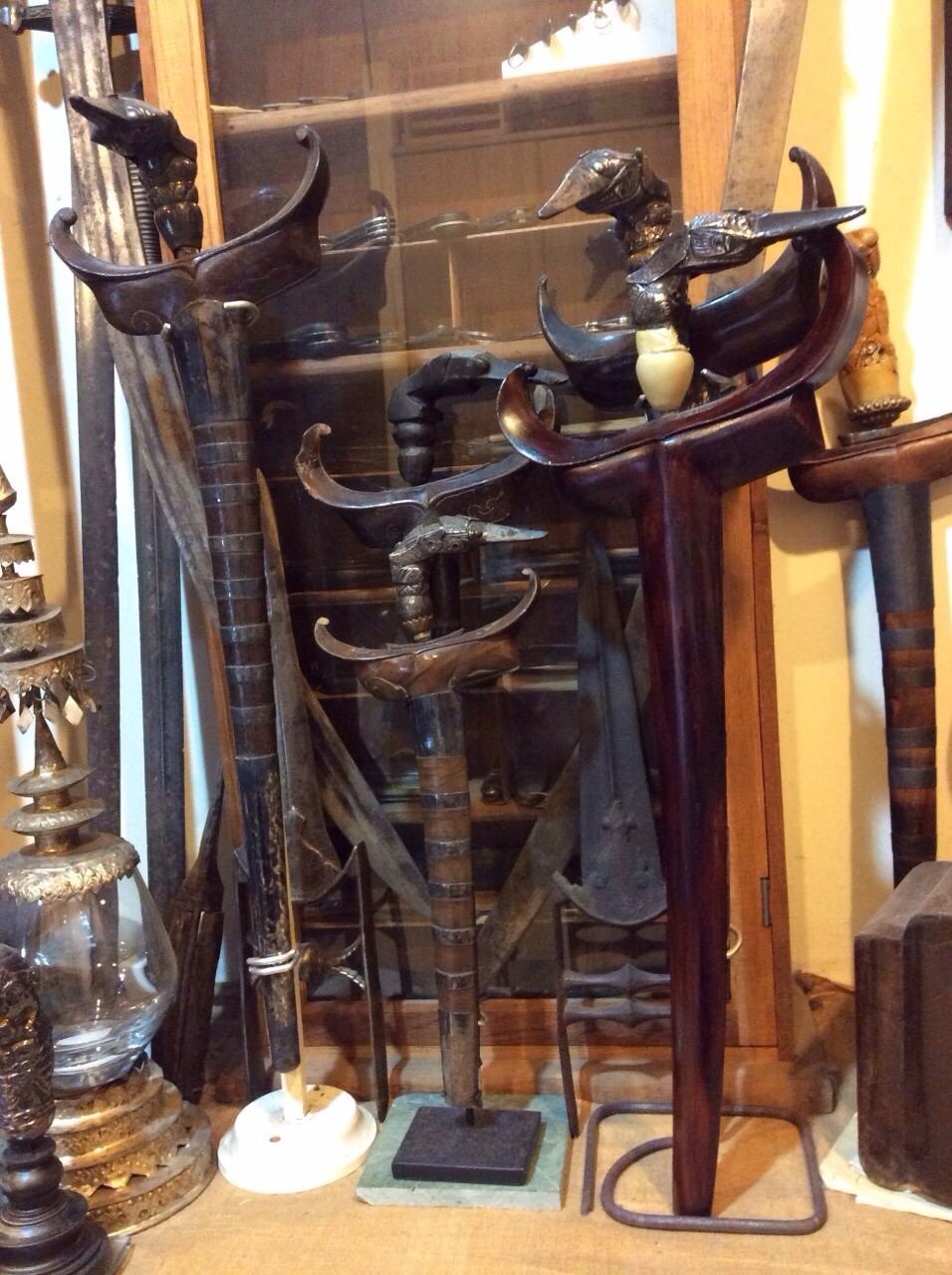

Staying in Thailand has allowed me to build a small network and I have managed to get to know more Keris collectors

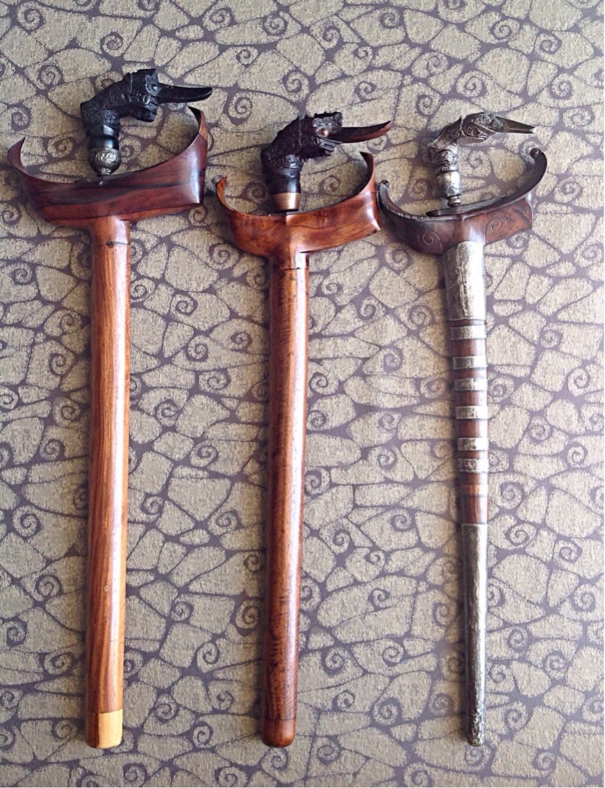

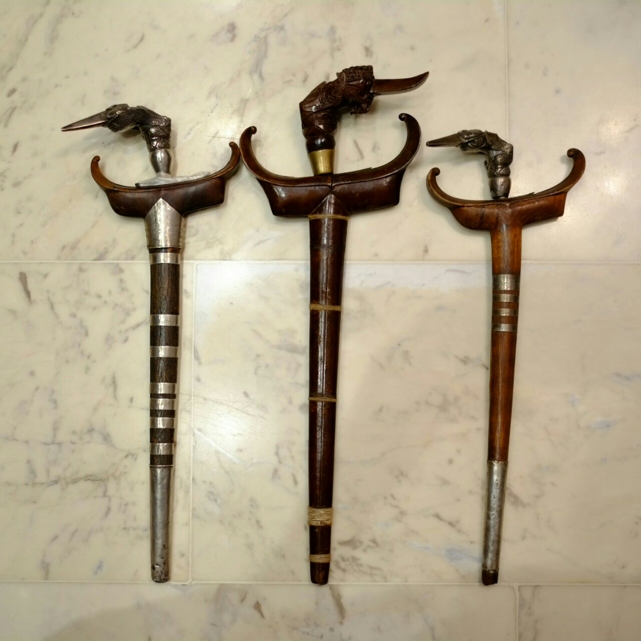

Excellent pieces these 3! Tks for sharing. It's difficult to see pieces of these calibre.

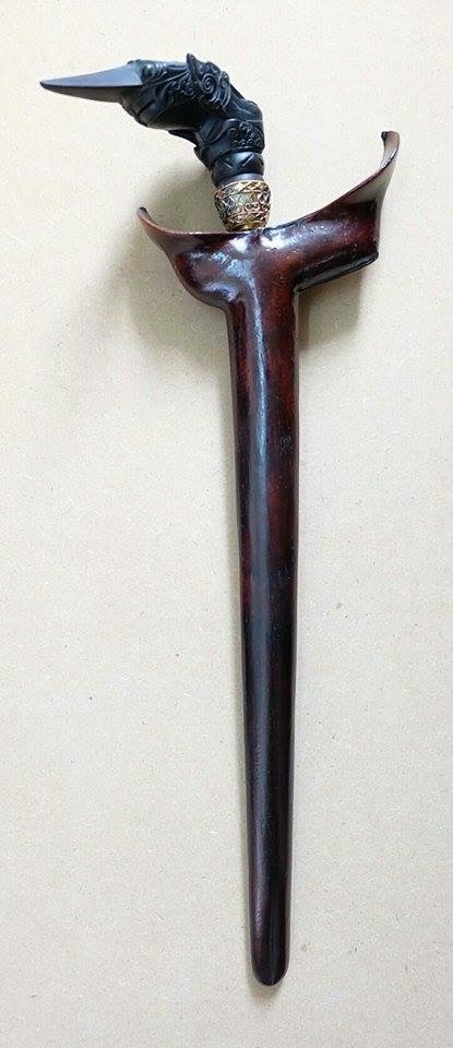

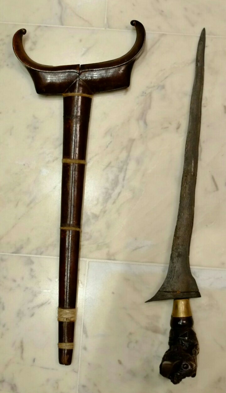

Another collector's Keris
These two are very good too. The sheath forms are top notch.

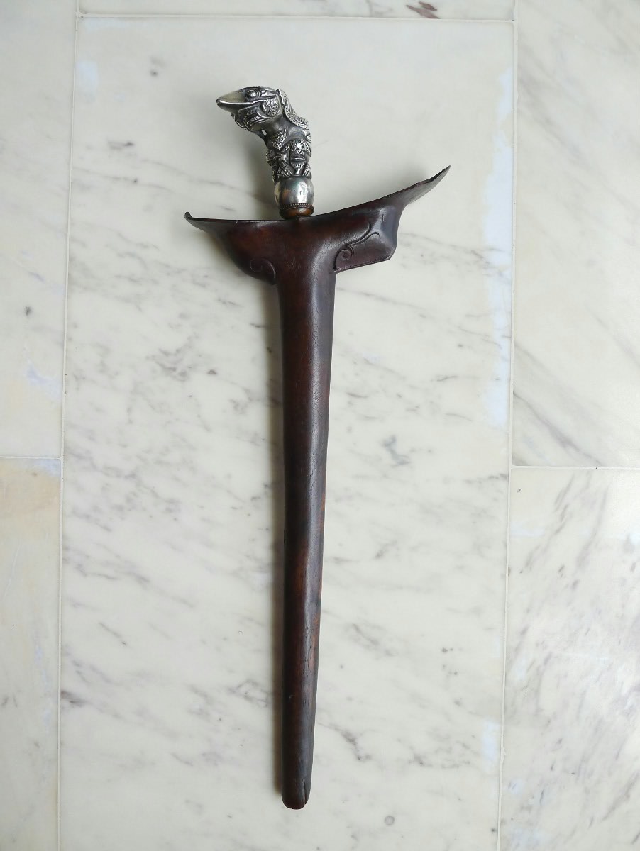

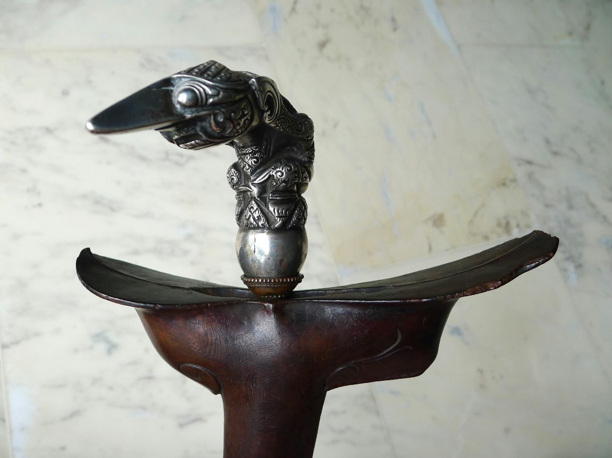

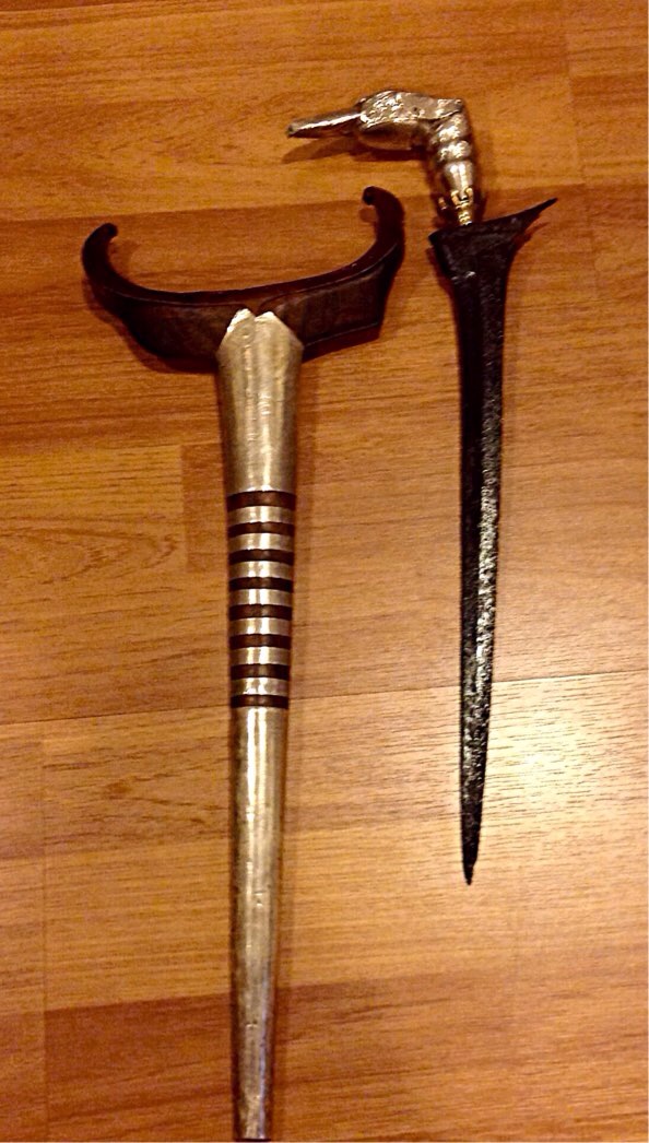

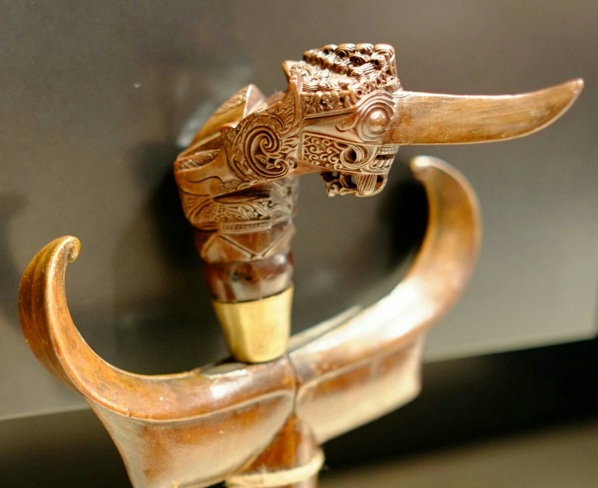

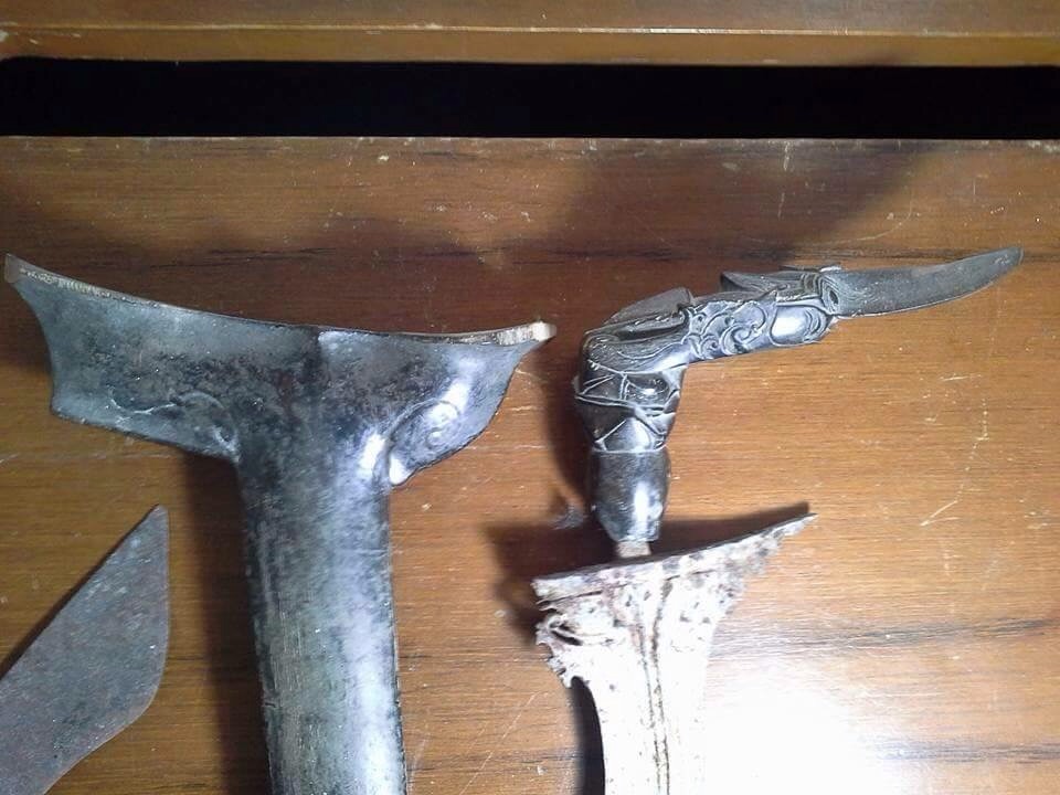

I have a piece in my collection which has baffled me for a while. It has features of a tajong, like elaborate crown, beard, and a more abstract anthropomorphic form. But instead of a regular tajong sheath, it was affixed to a coteng style sheath which was larger than usual. The blade is what my group of collectors here in Sg refer to as "Chenok" style, after the place the form is said to originate from.
Can your collector friends share their opinion on the origin of this keris pls? Tks

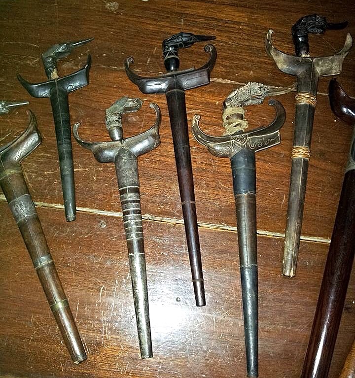

Old 29th June 2015, 02:59 PM   #69
BluErf
BluErf's Avatar
Location: Singapore
Posts: 1,180

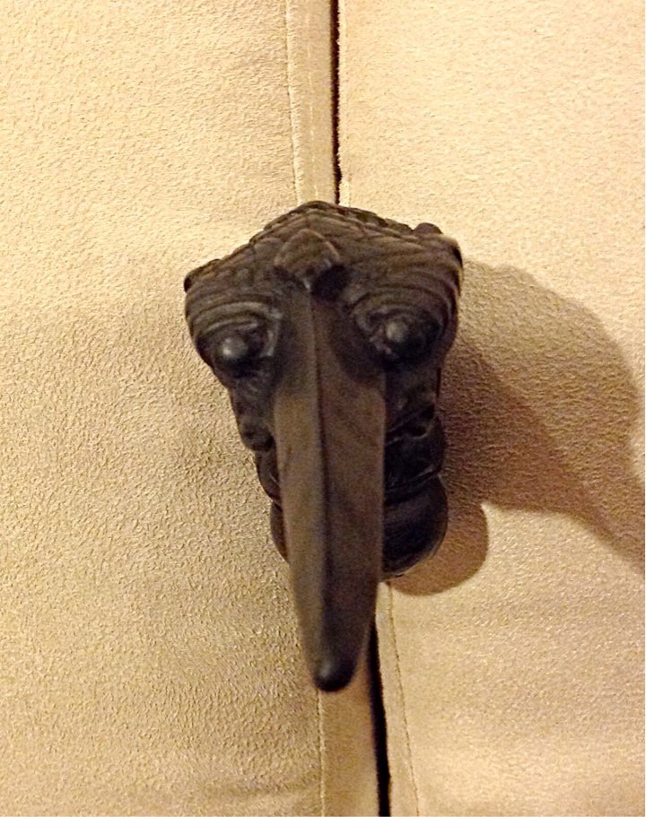

More pics, including one for comparison with other more regular coteng kerises.

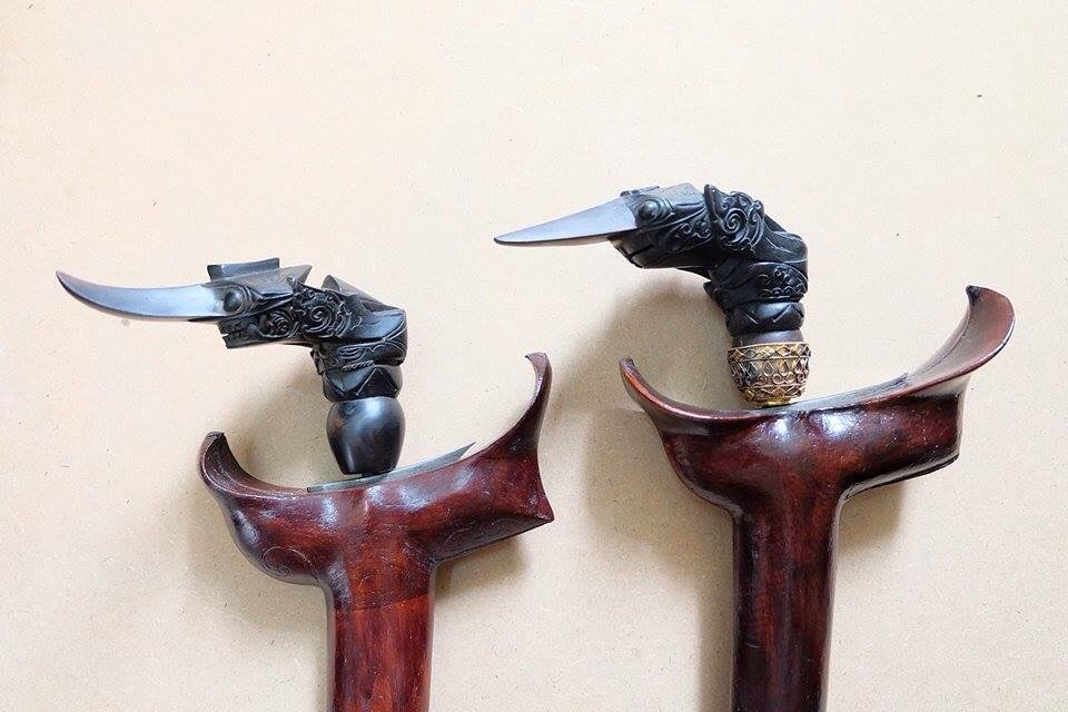

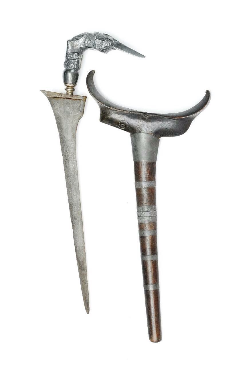

Hi! I have shown the photo to a senior Keris collector and in his opinion, he feels that the the Hulu (handle) should be a Coteng one for the sheath. There are bigger Sheath Coteng.
Please see example..
maxbliss888 is offline   Reply With Quote
Old 30th June 2015, 10:59 AM   #72
maxbliss888
Join Date: May 2015
Location: Bangkok
Posts: 150
Default Coteng
Here is another example of Coteng Shield
Old 30th June 2015, 11:04 AM   #73
maxbliss888
Join Date: May 2015
Location: Bangkok
Posts: 150
Default Coteng versus Tajong
The Coteng has various sizes and the rare one is as long as the Tajong..
Old 30th June 2015, 11:09 AM   #74
maxbliss888
Join Date: May 2015
Location: Bangkok
Posts: 150

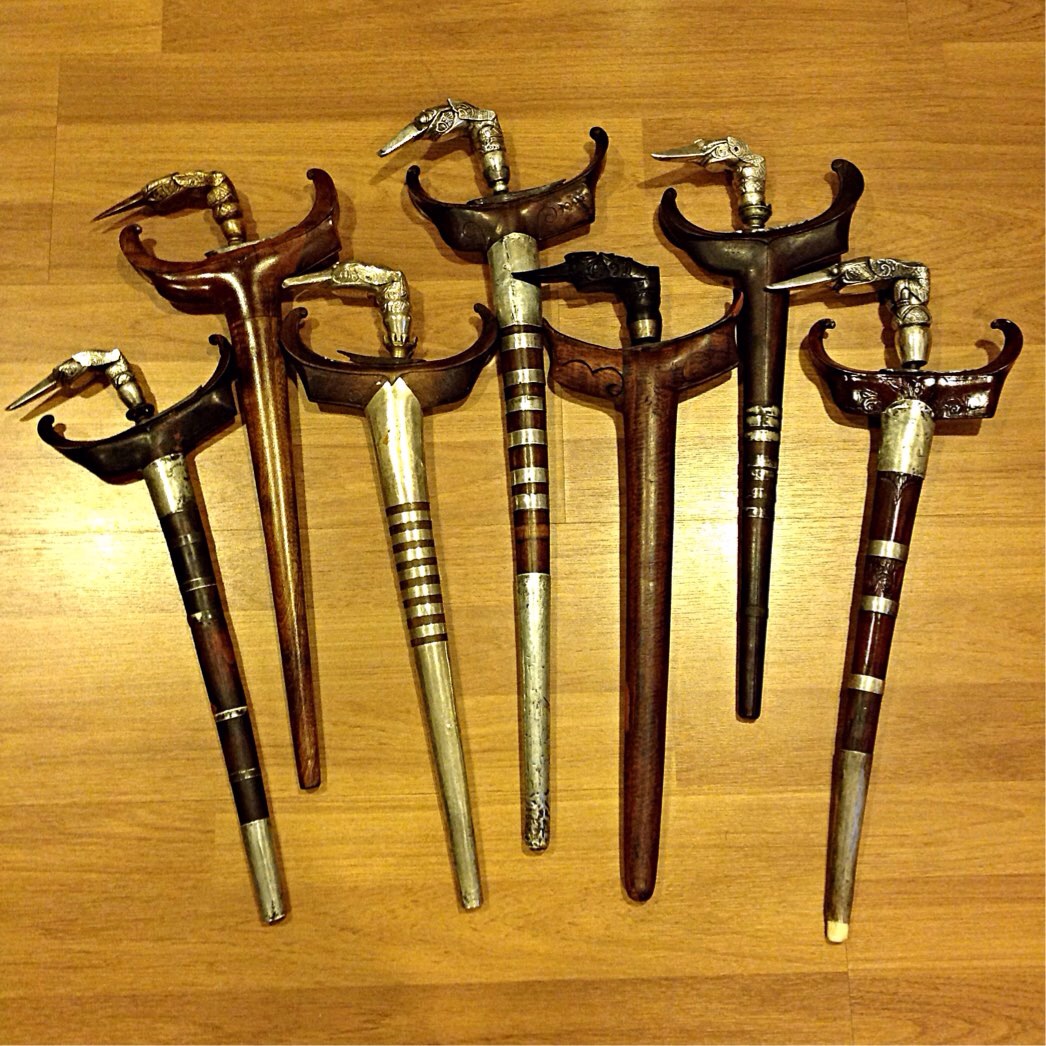

Default Coteng

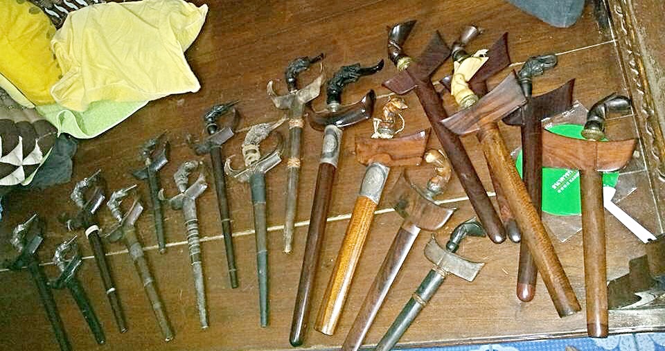

This is another collector collection. Good example to see the different Coteng with different length and sizes.

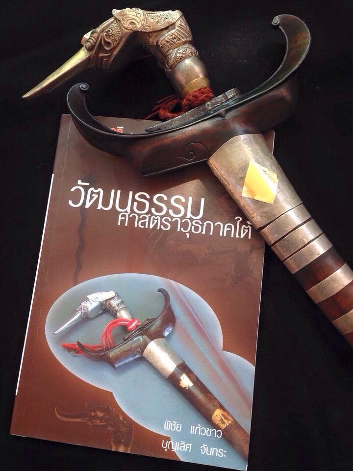

Posts: 150
Default Book on Keris
A gift from my Thai friend..

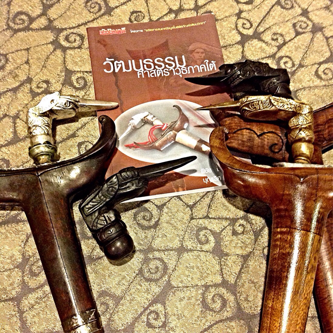

Default New Coteng
ɬɧıʂ ıʂ another Coteng from my Thai Friend..

Thanks! Can I clarify whether you meant the hilt was not correct for the sheath, or that the hilt is considered a coteng hilt?

With so many specimens shown in this thread, it should go down as the Coteng thread to come to for a visual feast. Thanks for sharing them.
Hi!
According to some serious collectors, as the hilt is made of wood, some tends to get damage over time and often got replaced. In this instance, it can be either be a situation where the Coteng hilt has been replaced with a Tajong. Alternatively, it may be a situation where a Tajong Keris has been matched with a Coteng shield. The suggestion from the collectors are either One quick way is to change the hilt or shield.

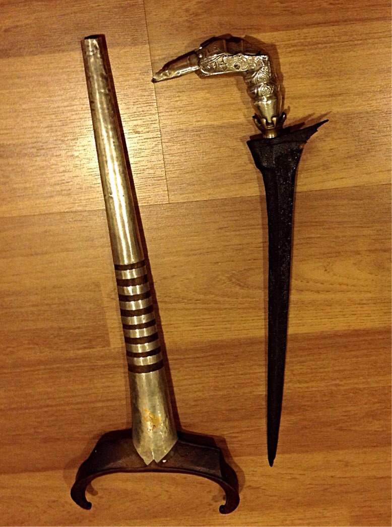

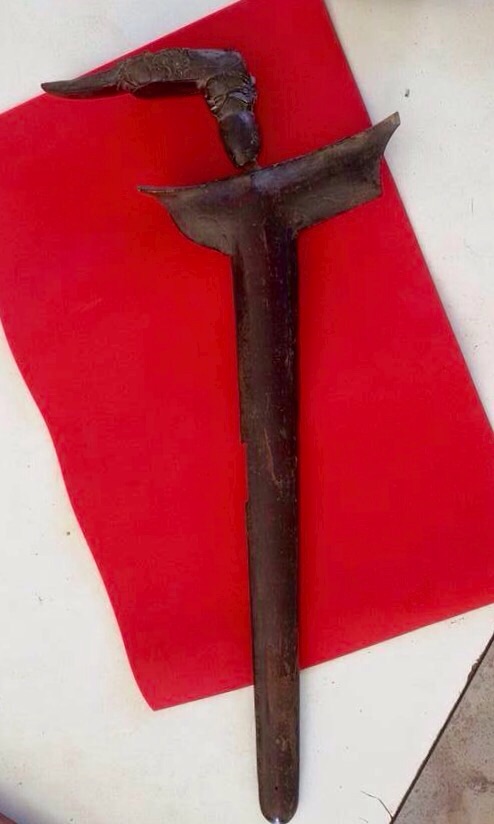

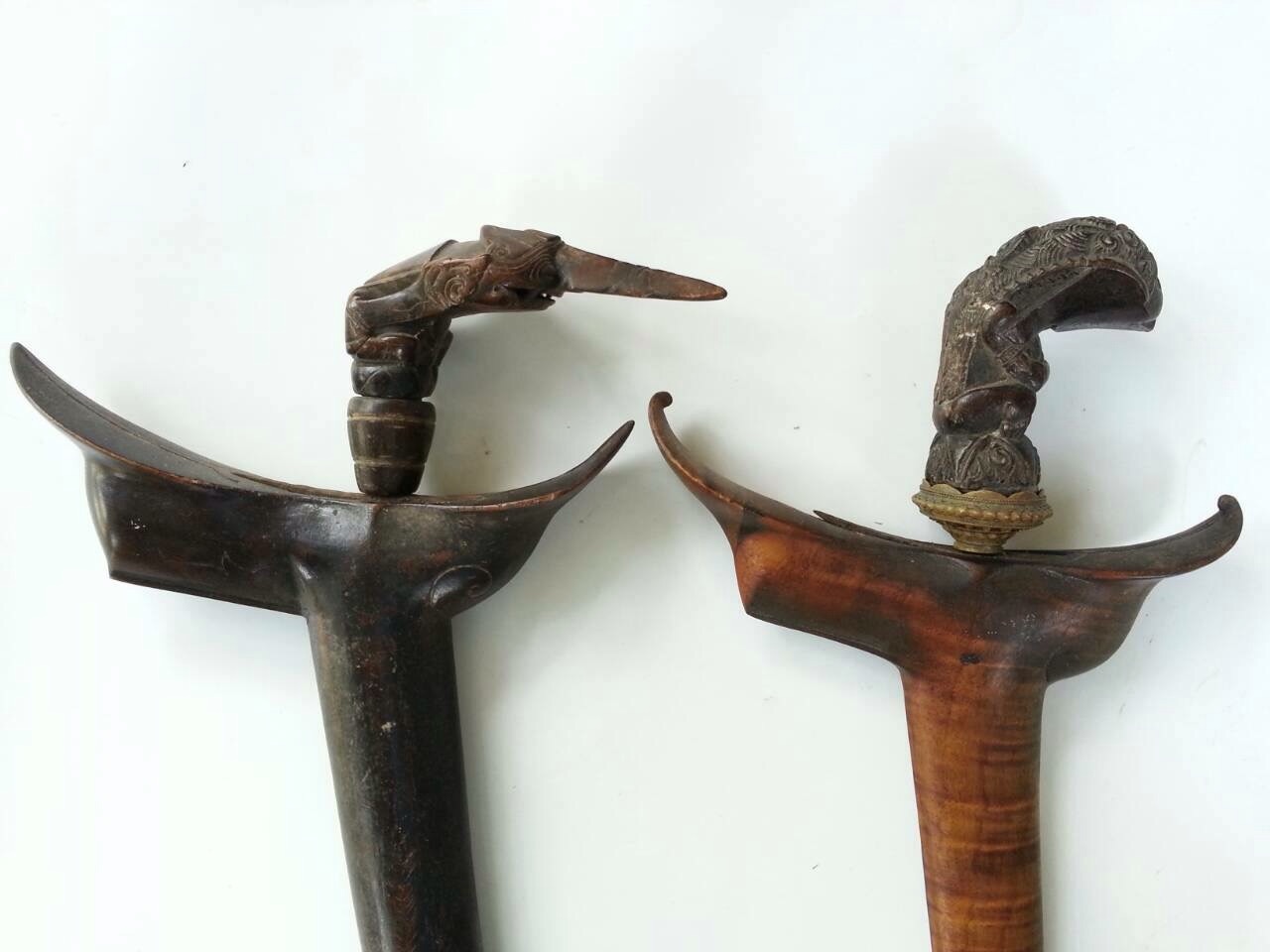

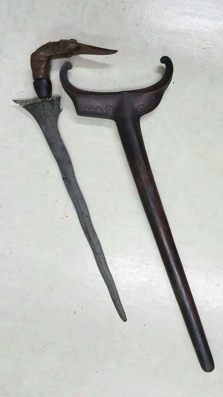

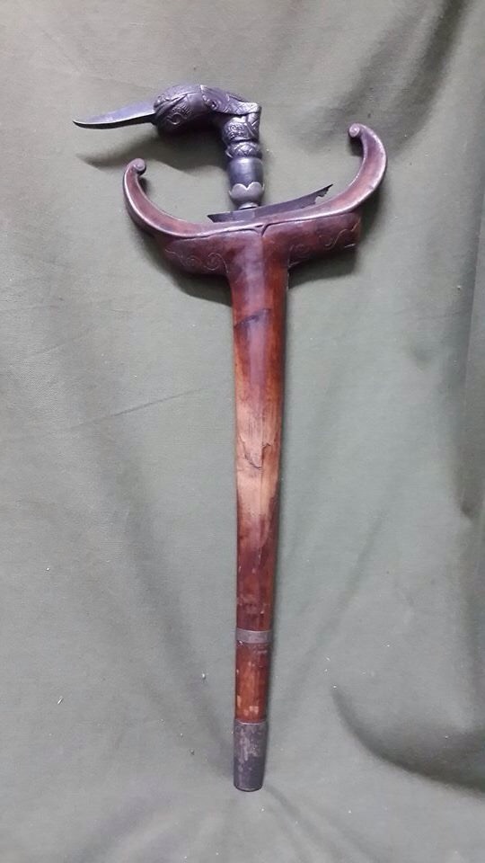

Another piece I'd like to ask about - this coteng came back from Europe. The sheath form is different frm most coteng we see. I associate this sheath form as an older form closer to the original coastal Javanese keris forms from which I think the coteng evolved. What does your collector friends think?
Old 5th July 2015, 06:05 PM   #83
maxbliss888
Join Date: May 2015
Location: Bangkok
Posts: 150
Default Coteng
Yes, it's the old Coteng shield...with the influence Javanese art cirebon.
Old 5th July 2015, 06:08 PM   #84
maxbliss888
Join Date: May 2015
Location: Bangkok
Posts: 150
Default Coteng
Please see below comparison
Old 5th July 2015, 08:43 PM   #85
Posts: 9,492
Hello Max,
the scabbard on the right isn't a Cirebon one but a Coteng scabbard IMHO. Can you post a photo of both from the other side?
Sajen is online now   Reply With Quote
Old 6th July 2015, 01:08 PM   #86
maxbliss888
Join Date: May 2015
Location: Bangkok
Posts: 150
Default Coteng
Hi!
I am not saying that it's a Cirebon one but with Javanese influences..
Old 6th July 2015, 05:54 PM   #87
Posts: 9,492
Hi!
Hi, so it has been just a missunderstanding, soory!
Old 7th July 2015, 04:24 PM   #88
maxbliss888
Join Date: May 2015
Location: Bangkok
Posts: 150
Default Coteng
No worries..

Thanks Francis, for affirming my thinking. The hilt on this coteng has sone really sublime carvings. The form is also extra "rounded". Very pleasing piece.
