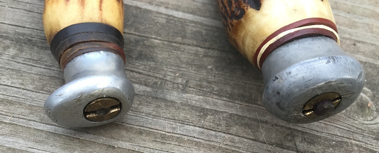

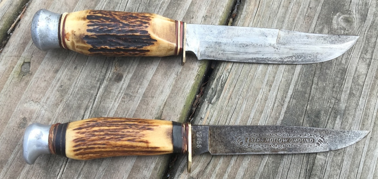

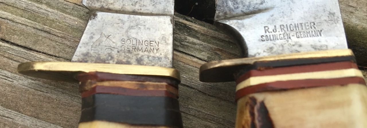

OK, here are some pics. I would love to get them cleaned up to carry. I live in a state where you can carry anything you want anywhere, although I usually carry smaller things. I do hunt though, so they may be tasked for that. You can see the marks, the spacers, and the strangely abused pommels.
You can see that the tang is peened within the brass slot, so to replace the spacers I think I would have to grind off the peened over end and thereby shorten the whole thing by some amount. On the hollow ground knife the spacers look to be horn, but they are plastic on the other one, bakelite or something.

If the spacers, and ferules are out of alignment, the handle is probably loose from stag shrinkage. First, see if the pommel will unscrew with just hand pressure. If not, try wrapping in leather, or rubber and use a vice. Don't use too much force, if corroded, you might snap the tang off. If the pommel just turns around the nut, penetrating oil, and a spanner wrench is needed for the nut. Once you get the handle off, clean the blade with whatever method is needed. Really need some pictures to know how rusted the blades are. If not bad, oil, and steel wool will do the trick. Then, clean the handle components of crud, and re-assemble, using a drop of epoxy between them. Screw the pommel back on. It can be a little tricky, keeping them all aligned. They weren't made that way. Handle components were tightened down with the pommel, and final shaping was done after assemblage.
trenchwarfare is offline   Reply With Quote
OK, so the end of the tang is threaded in there? I had thought it was peened over, but thats good news. Can you not see the amount of rust on the blades? The only one Im only concerned about is the etching on the one blade, its not too deep so I don't want to get too aggressive with the polishing.

You hadn't posted pictures when I replied. Must have been while I was typing. OOOO steel wool, and oil is all you need for the blades, It won't hurt the etching. The pommels look loose to me. There has been some sort of spanner wrench in the slots.
Yes, some kind of tool has gnarled the bejeezus out of the brass. I think I can dress it with a very fine file and then use automotive sand paper the polish it back up. I don't know how much time I will spend on them, but they are nice little knives. Its funny, normally I can find some kind of particular collectors website on any variety of knife, but not these. One thing is, Im given to understand that the "RJ Richter" is the importer, not the manufacturer.

Are the grips all loosey goosey ?
If everything is still tight then you might consider just shaping the spacers back to match the grip contours .

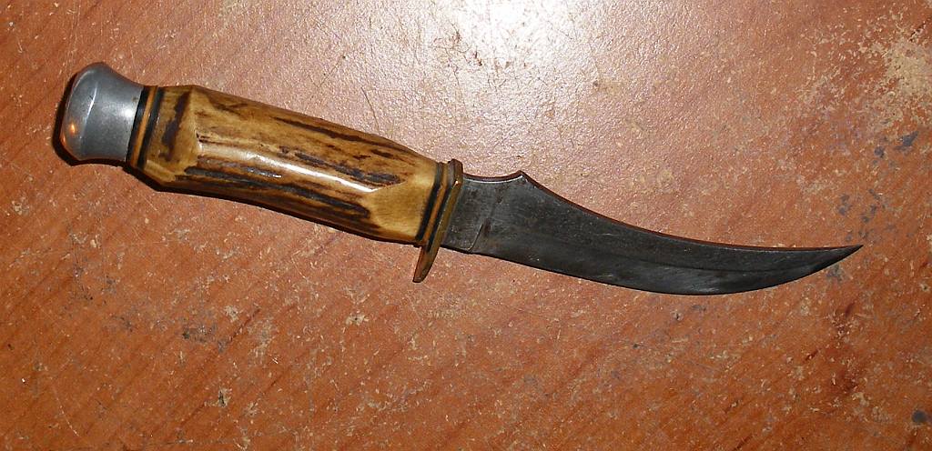

Here's an old Othello that has been cleaned up .

Not terribly loose, just not tight…loose enough that the spacers are all at different positions and can be pushed about with ease.

It looks like some of the spacers have been possibly replaced which is probably why the pommels and brass nuts look a bit marred, although I would bet these are no newer than mid 20th century .
Maybe the leather dried out at some point .
Chris, it would be nice if the value of these hunters was worth having a pro restore them; but here in the US I think professional restoration would be more a labor of love .
I like the patina they have; it would be a shame to remove that .
The example I posted was a trade incentive item from a shirt company .
As an observation; I think we are treading more on a modern blade forum's territory here .

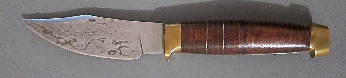

The pic is a knife I made maybe 20 years ago, rip - off of one of the old Marbles patterns:-
http://www.bladeforums.com/forums/sh...rble-Woodcraft
I think this pattern was maybe the most popular pre-WWII belt knife in USA. Great knife. I had an original for many years, some misbegotten mongrel thought he needed it more than me.
Anyway, look at the Marbles, couple of different coloured materials as spacers.
The knife I did has the handle on in the same way, but it is stacked leather, and includes brass shim.
I like old Solingen knives, I've got a lot of pocket knives, and I never move without one, but probably the one I carry most is a 1930's Dirlam. Excellent design, excellent performance.

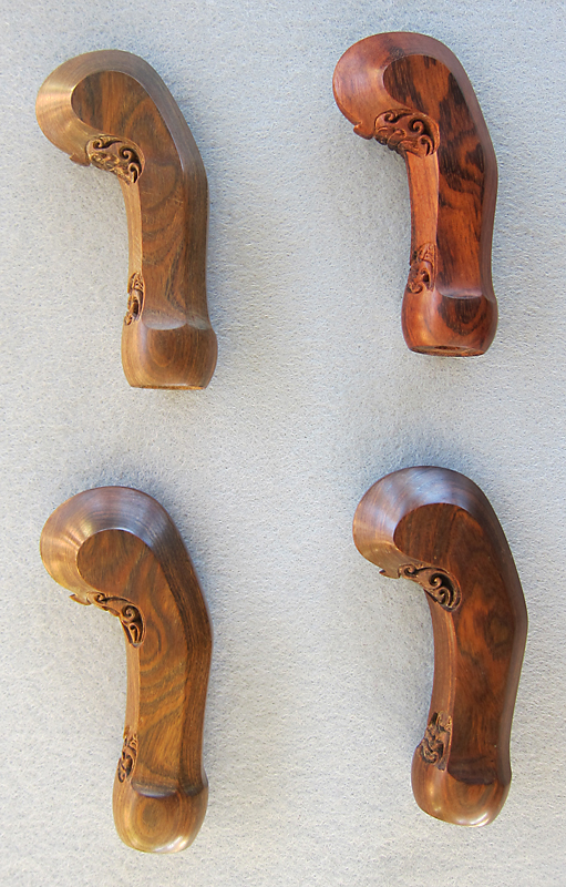

This is what lignum vitae looks like.
Old 8th May 2015, 01:21 AM   #25
Posts: 6,441
I have a good sized LV carver's mallet; you keep it waxed or it will check; it's a heavy bugger .

Turns out I have some LV, I have a piece of propeller bearing, I just didn't know what it was. I am a snitcher and hoarder of wood from way back, I have a million pieces of wood from all over. After. Working over the metal on these knives, I doubt I'll use wood, there are just too many irregularities and it seems from inspecting the old examples that the stuff just compresses into form.
Would it be correct to say that the fiber material just replaces leather or other organic material in a very old method of fashioning grips?
S.Workman is offline   Reply With Quote
