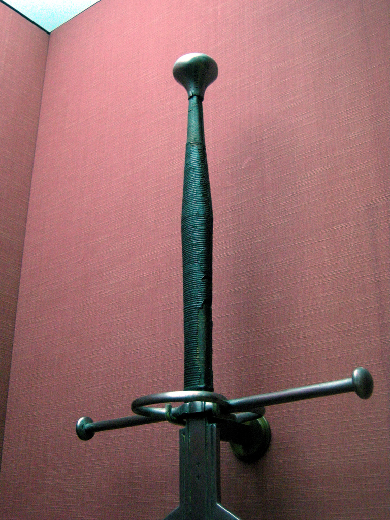

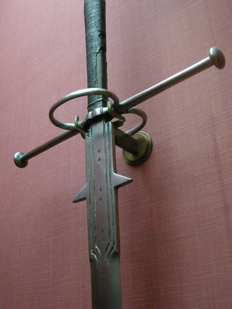

Two handed swords (Montantes) are often mentioned in chronicles of the Portuguese discoveries period, for one.
They were used by nobles, those educated to train with such weapons.
Not many around presently, though ... or they are well kept in private collections.
A couple examples can be seen in Lisbon Military Museum; including those having apparently belonged to notable fiugures; Henry the Navigator and Vasco da Gama

Thank you very much, Fernando. These swords are beautiful!
My understanding is that a montante lays somewhere in between a longsword and a great sword in length and weight. A longsword would be around 120-130cm in length and 1200-1800gm in weight. A great sword is 3-3.5kg and up to 170cm in length. A montante is somewhere in the middle? What are the measurements of the known montantes, such as the ones shown above?

One is 157 cms and another one 175 cms.

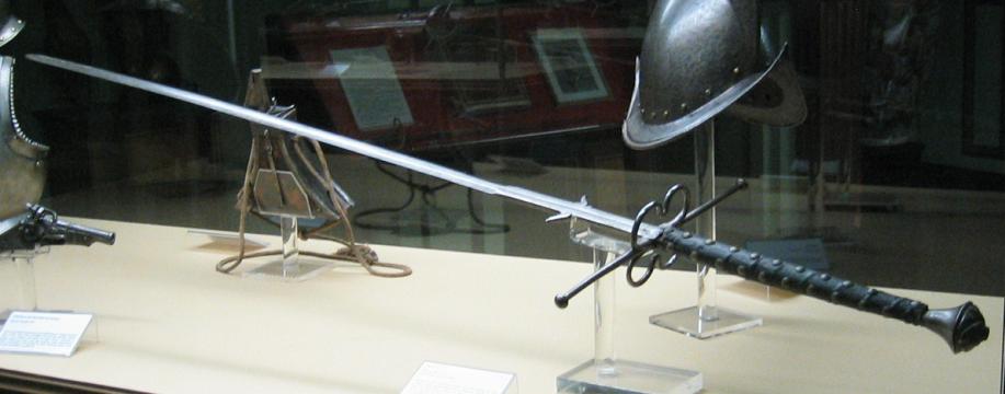

Old 22nd March 2015, 01:13 PM   #6

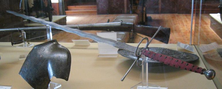

Browse the web with term Mandoble (double hand). You will find many offers for replicas, like that of Carlos V, which means there were also originals. With some insistence and a bit of luck you will find images of the real thing.

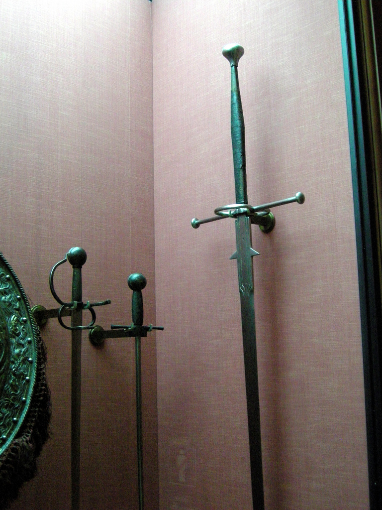

Thank you for your suggestion, Fernando. I was able to locate a couple of more Iberian two-handed swords here:
http://www.esgrimaantigua.com/node/68
It shows several swords made in the early and late 16th Century. These swords are located in the Army Museum of Madrid, according to the captions.

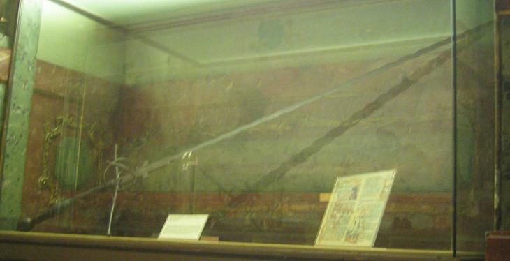

I also found a sword allegedly belonging to Fernando el Catolico. This is a typical longsword of 15th Century Europe. So there's some tangible proof of a longsword use in Spain at that time:
http://www.gutenberg.org/files/47878...ill_010_lg.jpg

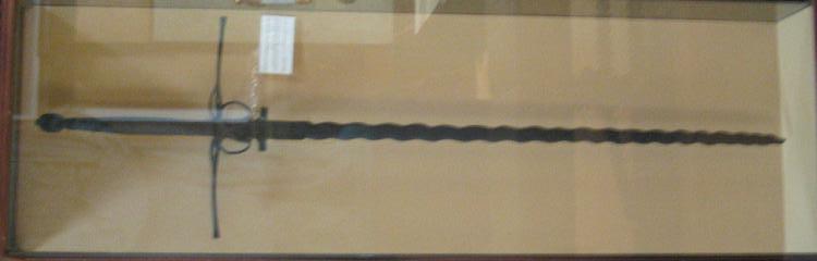

ulfberth
Join Date: Jul 2014
Posts: 447

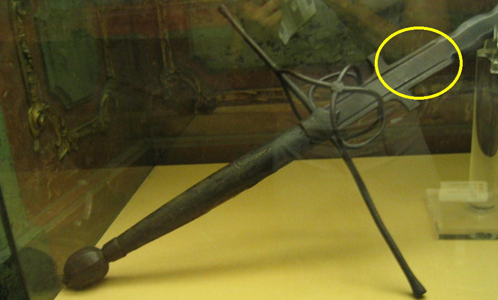

This one is in La Real Almeria in Madrid Spain, it is in the same style and probably of Spanish origin
Kind regards
Ulfberth
