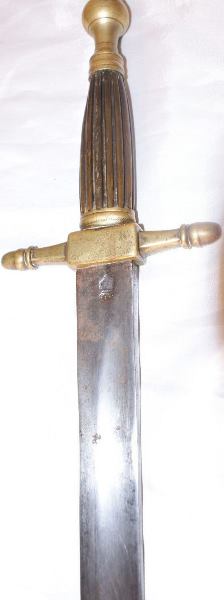

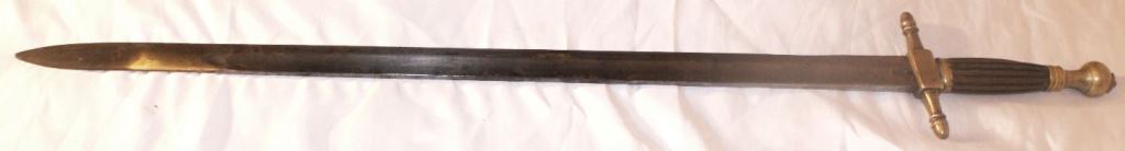

I wondered if anyone can identify this sword? It's a curiosity that puzzles me, because the hilt grip style reminds me of a late 18th century English or Continental Spadroon, yet the blade is more akin to an straight bladed infantry hanger. The brass cross hilt quillons don't look 'military', so my thoughts are tending to think this may be 'hunting' sword composed of parts of military swords, or a heavily modified sword fashioned for theatrical use etc.
Has anyone seen a hilt and blade configuration like this?

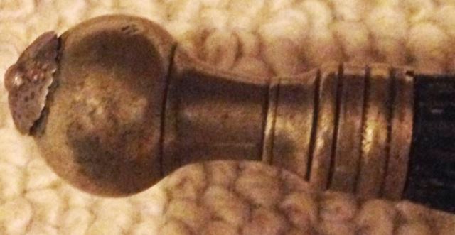

At the end of the brass pommel is that a square nut or?
Hi, it's a circular nut, or finial with scalloped edges. It's not a modern machine nut etc. I'll see if I can get a good photo of it close up to post.

Default Pommel nut
Pommel nut

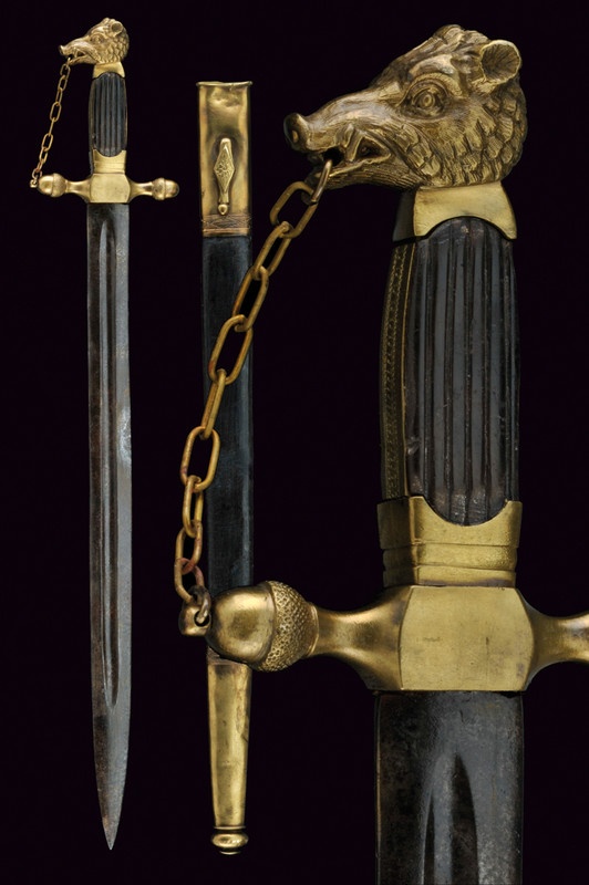

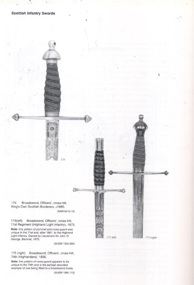

Here's something stylistically similar in hilt configuration, (apparently from an Czech source?)

It has some similarities with the Scottish Officers cross hilt broadsword of the later 19th C ( see Robson pp184 / 185 ) although I do agree the grip is very 18th C .

I would guess early to mid-19th as well. Grooved ebony and fluted ivory grips were popular c. 1780-1820's (see naval dirks from the latter period). The hilt pattern is usually more seen on either non-military or dress type swords of the period (band swords, fraternal or officer's dress, Thin Red Line's excellent example of a Scottish claymore with the basket removed and the 'dress hilt' in place, etc.
Just a note-With the Scottish dress hilt, that particular sword had a screw nut at the pommel, allowing the basket to be removed and the cruciform hilt to be put in place. Your hilt seems more permanent, with the peened pommel cap. What's throwing me is the blade on yours, which is, as you pointed out, functional. Perhaps the hilt was replaced, again as you suspected.

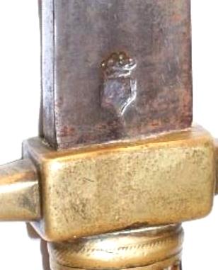

Question- what is the stamp on the blade? Maybe if we knew more about the maker, country of origin, etc, we might glean more?

Default Stamp
Here's a better close-up of the marking.
