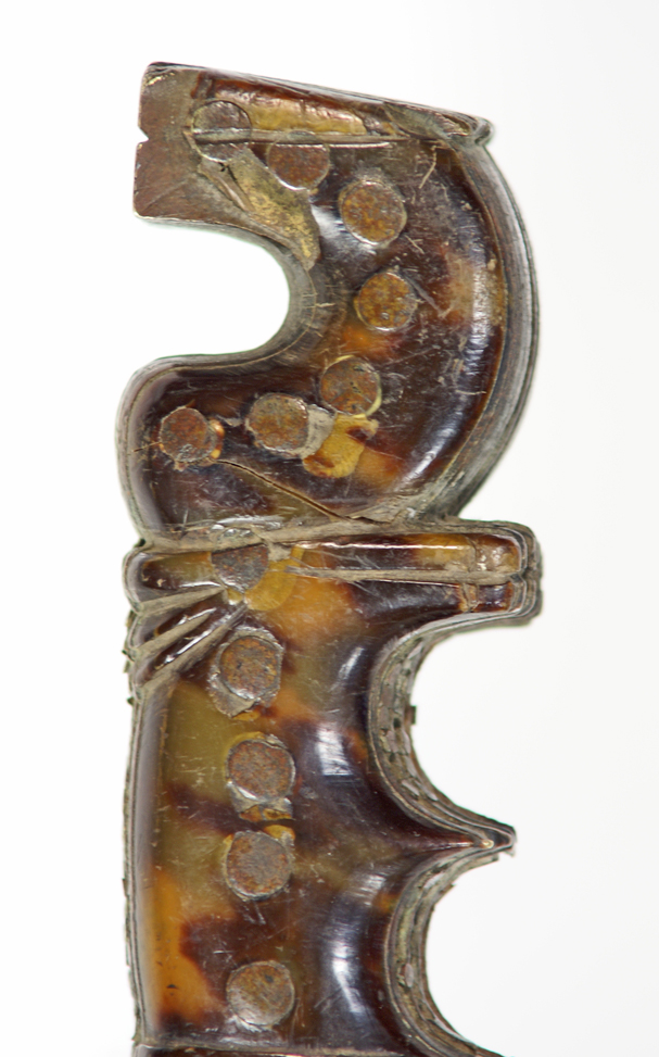

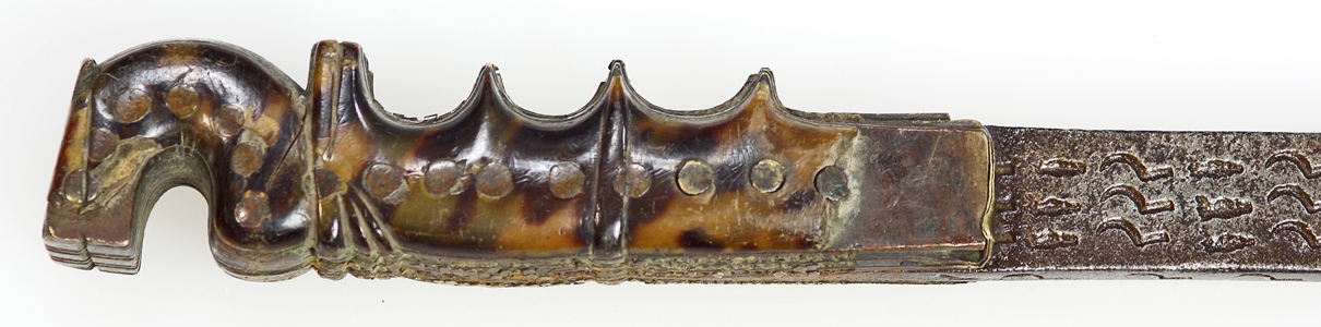

I bought this “rare Philippines sword” some time ago, but I have no idea where it is coming from.

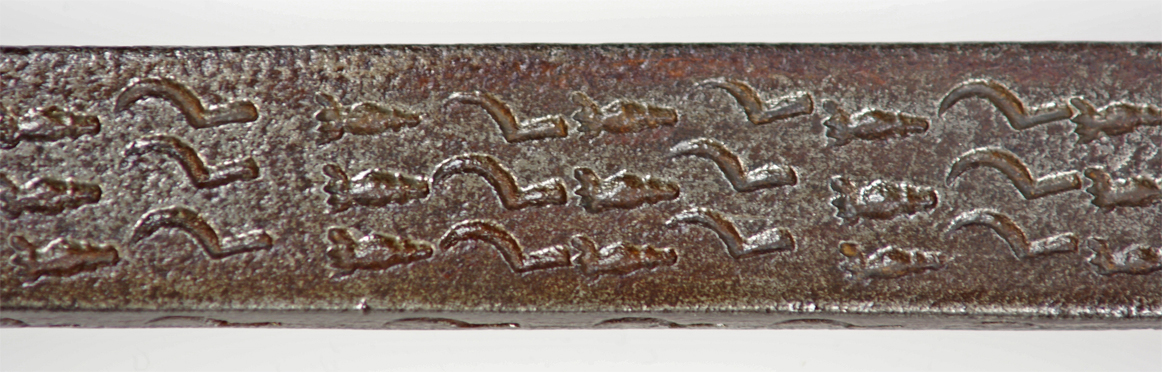

It is a single-edge stabbing sword with a long thick shoulder and spear point. The shoulder is deeply impressed with alternate groups of three sickle marks and three arrow head form (?) marks. The blade has a crusty brown patina.

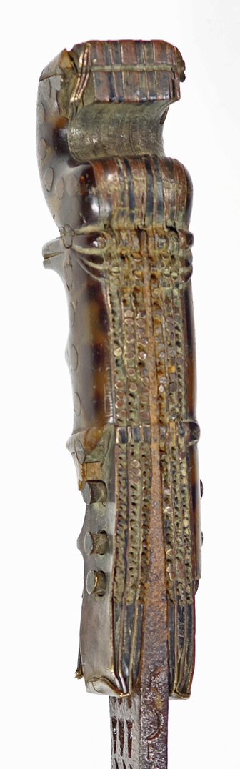

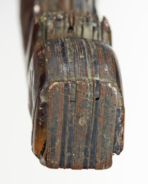

Very interesting is the handle, it is elaborately built up hilt with broad finger stalls and hook form terminal. The broad tang is flanked by an alternate horn and copper lamination, three each sided. The horn strips are inset with tightly spaced copper hobnails, most of them lacking. At the pommel where the tang ends are some more layers. At the outside of this construction are finely formed thick tortoiseshell scales. The whole grip-tang-construction is fixed with a row of 16 brass rivets. The grip bottom is deteriorated at both sides.
Total length 65,2 cm; blade length 49,9 cm / 19 1/2"; max. width 2,6 cm; max. thickness 0,7 cm.
For me it is absolutely impressive sword with a handle like a Naga.
Every comment would be very welcome.
Udo

This is a Spanish-American War era Cuban sword and not Visayan or even Filipino. There has been a lot of confusion on this type of sword.

agree with Jose, not Visayan/Philippine but Cuban, see the link David R has provided.

So it seems to be that it is used by the “Chasseurs del Rey”, a kind of gendarmerie in Cuba already 1803 based on a proper description of handle and blade (but without illustration). By regular troops in Cuba it was a service sword “Modelo 1891 para la Infantería del Ejército de Cuba”, typo Deguanabacoa, based on an article of Juan L. Calvó in an auction catalog 2007.
There are still some questions: Is the rare form of handles really based on African slaves? In 1803 the Viceroyalty of New Spain was still in existence, could it be a Mexican / Aztec / Maya motive? What is with the row of deeply incised sickle and arrow motives in the blade? Perhaps somebody will find an answer.
Thanks again

I don't believe it has Aztec/Maya characteristics at all. I see more Spanish influence than anything else. This may explain the Berber attribution, since Spain ruled the Spanish Sahara (and still has a presence in Morocco).
Yes for sure Caribbean (Cuba, etc)
