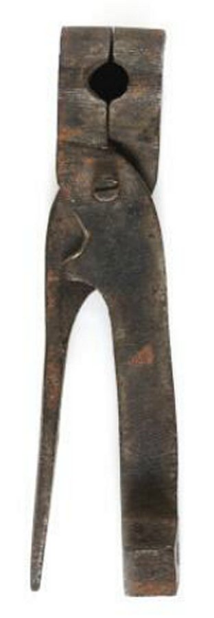

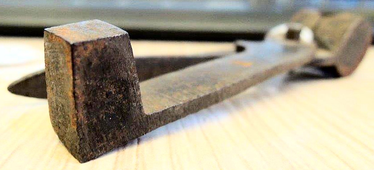

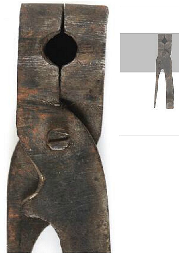

Hi Nando,
Thank you for showing us this specimen.

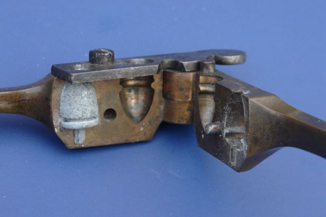

I think it is notable for contrasting to the earlier stuff on the one hand, and at the same time closely connected with the U.S. ball molds posted above.
Yes, it sure bears witness of heavy use, and I especially like its charming rich patina.

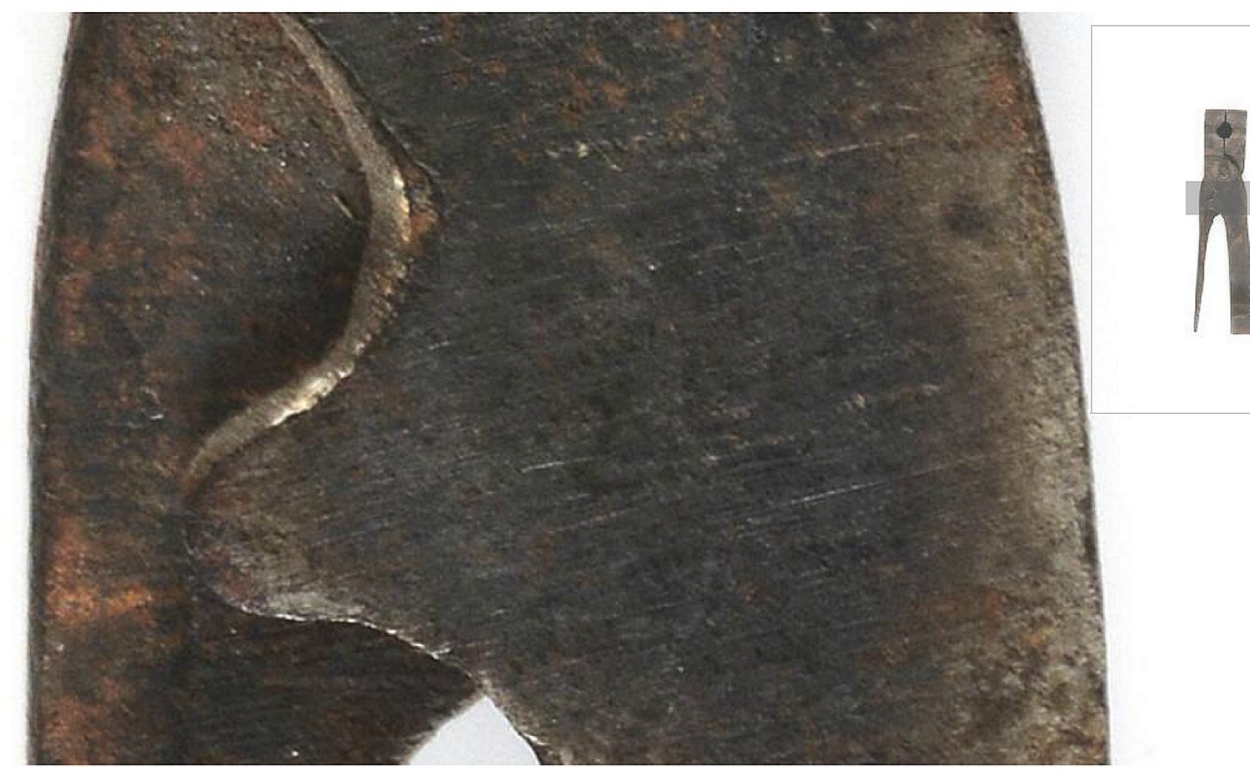

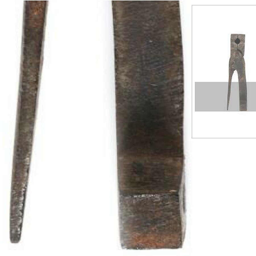

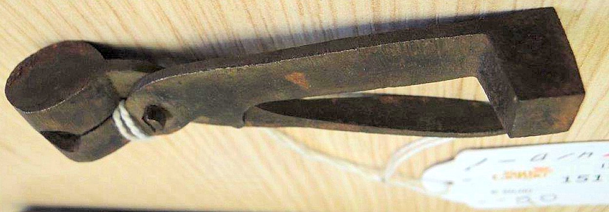

Please allow me to add that the two sharpened scissors right beneath the head were for chopping off the founding nozzle from the ball; this is a remarkable fact because balls keeping that nozzle made binding them to paper cartridges easier.
I reckon that the only kind of fireams which balls retaining their founding neck could not be used with were revolvers.

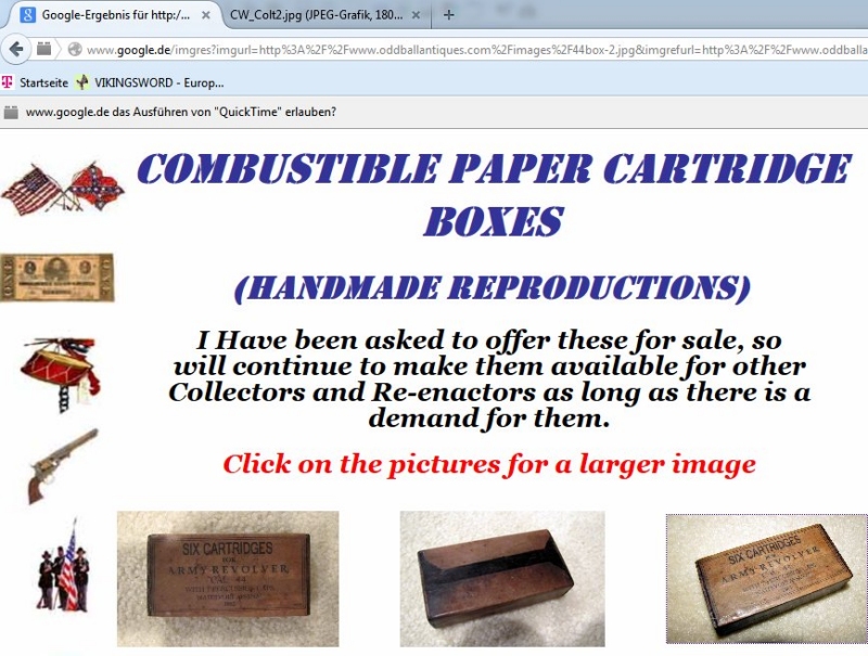

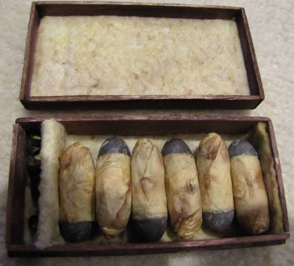

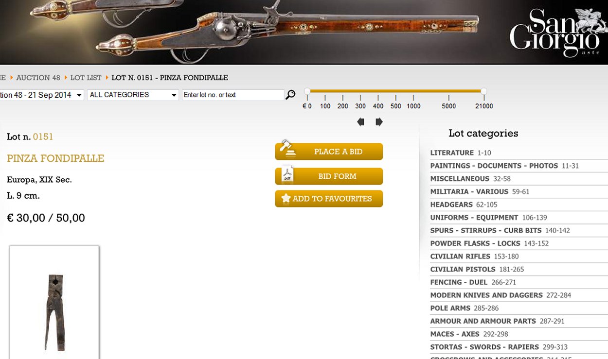

In the catalog of the latest auction by San Giorgio, Genua, 21 Sept. 2014, I found another mold featuring those scissors.

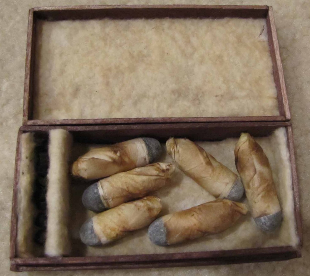

Attached are images of a rare chest contintaing original paper cartridges for 19th c. U.S. revolvers.
Michl

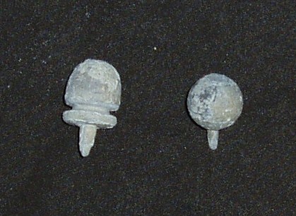

The usual English term for the founding nozzle is the sprue. When I am casting balls for my muzzleloaders, the sprue cutter in a modern mould is a rotating plate which is knocked sideways to both cut the sprue and unlock the mould blocks. The scissor moulds displayed here would require shears or pincers - even just a sharp knife - to remove the sprues.
As you note above the sprue cone would be ideal to allow a cartridge to be tied off with thread. Another innovation of approximately 1850 by Robert Adams of London for use in percussion revolvers, was to cast a spike on the ball as pictured, and place a greased felt wad on the spike. It was intended that these wads and projectiles be thumbed into the chambers rather than using a larger diameter ball and force it in with a lever rammer. In practice this was unsatisfactory, as the recoil would leave the bullets projecting from the chambers. The innovation was abandoned, then superseded in a few years by cartridge revolvers.
